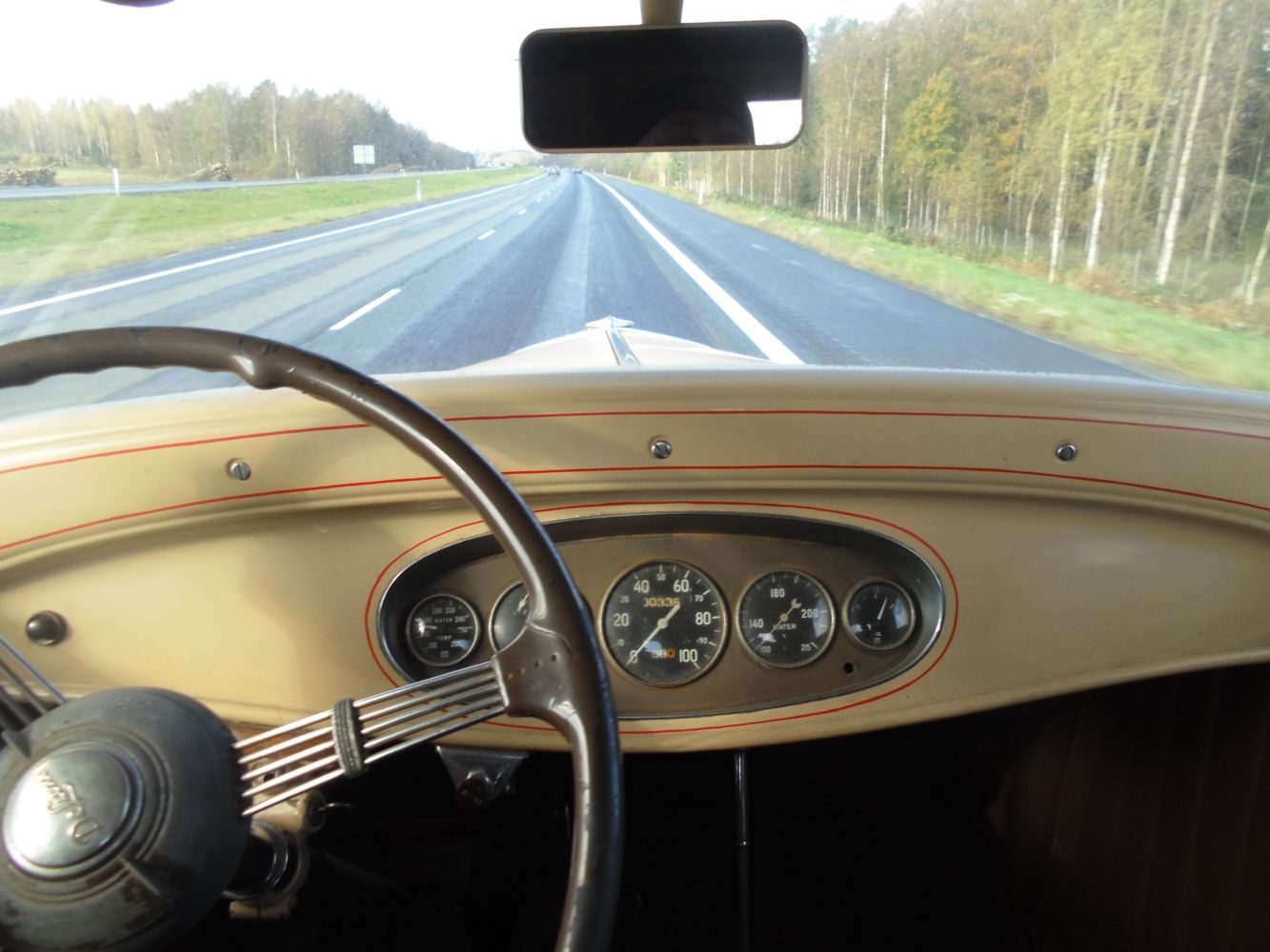

    1932 Cab arrived yesterday to Finland and I drive it home 200miles.
    Runs great and hard to belive how good condition body, fenders, runningboards etc are.
    No rust at all.
    Need to adjust those old 97 carbs, learn Nash Twin-8 distributor etc. before winter and snow is coming.
    1932-33 studebarker roaster SW gauges work good, and car was even better than I expected.
    Maybe not "cut" windshield frame, and not shop top. Too good car to change it too much.
    60´s hot rod, interior brown truck´n´roll, cromed pedals, steering column (39 deluxe) etc.
    Cylinderheads are made by ex.owner. He cast 3pc and now I have one "semi-ready" head in my working room and I bolt it on the wall. Maybe needs better camshaft, I have 3-4 old cams waiting for use.
    Original rear must open and change 3.25:1 ring and pinion, make all machinery jobs what that change needs and drop springbrackets, so that frame/body is 2.5-3" lower than now. Car was very good to drive, original steering box feels good when have speed 60-70miles hour.

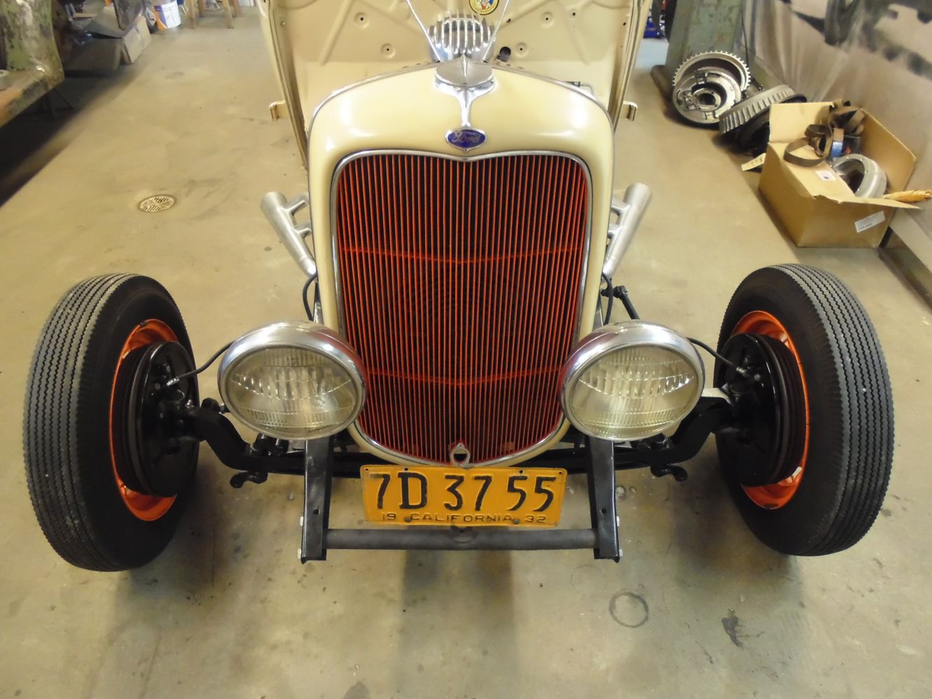

    I opened Autolite-Nash twin-8 distributor and Ernie (ex. owner) was installed there Ingitor elecr.modules.
    One positive suprise again. I was order for this car 3.25:1 ring and pinion. It takes 3-4days to fit it inside of orig. 32 rear, but now I desided o leave rear end like it is. Runs great 60-70miles/h and very quiet, no extra backlash,....
    Maybe turn ends or turn backing plates bolt circle to the horizontal or only change rear spring. I have one orig. 32 rear spring which main leaf (we say here in finland = norra) is turned, so rear drops approx. 1"-1.5".
    some detail pics.
    I have never seen as good original 32 V8 radiator like this !
    Aulis
