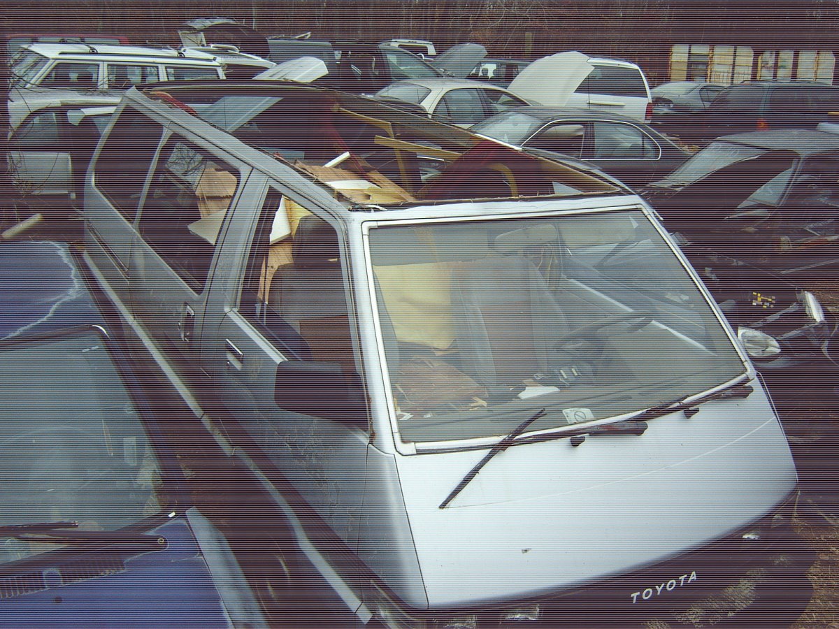

  16. Instead of asking what fits, do like I did and make a plywood template; one edge matched the stock roof’'s lengthwise crown, the other followed the lateral crown….
    I took the template to a local junkyard to shop for a matching donor roof ~74"” x 43"” with no lengthwise ribs. I was looking for a Volvo station wagon but found an ‘86 Toyota minivan matched perfectly.:)
    I left the stock A tack strips in place so I can cover it with Ford vinyl for a stock appearance.:cool:
