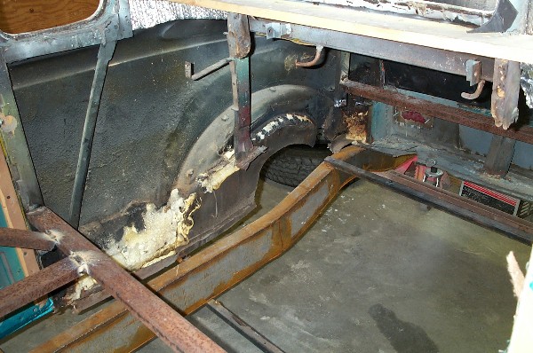

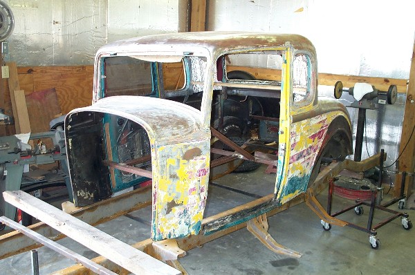

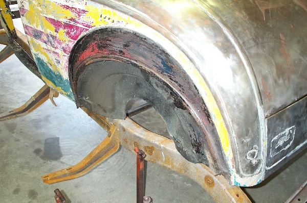

    Well I finally started my 32. I gotta get going on it soon if I plan on driving it before I die. So here it is. first we drug it home and it's been sitting in my garage for about 6 months. [​IMG] [​IMG] [​IMG] [​IMG] [​IMG] So this is what I started on first. I have no floor that is all gone. The rocker panels are gone along with all the rest of the panels on the bottom. The body has a peice of sheet metal screwed to the side to hold it together. The question is where do I start?? After thinking about it for a while I figured that I would get the body muonted on a moveable frame so I took the wave runner off this trailer and used that so I can move the body aruond. I mesured every thing and got it mounted strait so it dose not rack around. next I will mesure the frame rails and order the patch panels. [​IMG] [​IMG] [​IMG] [​IMG] [​IMG] [​IMG] [​IMG] [​IMG] [​IMG] [​IMG]

    I wouldn't start on the body other than to tack some supports into it so it doesn't move around, I would get your Frame together and square ( so you have a good foundation to repair the body on,.. assuming your going to keep the car a highboy), then get some sub rails from McPherson and get your sub structure fixed first, maybe set shims in your door jambs all the way around ( for equal spacing) and tack the doors shut during this process. get the body square and plumb on the new sub rails and tack everything together, after you measure the crap out of everything and your sure the body is in proper position, you can weld it all up,... than move onto patch panels, dents etc. ( this is just the way I would do it,... good luck looks like a fun project)
  5. All of the sheet metal shapes you need to rebuild the floor are available from Brookville Roadster. Shop I hang out at used their stuff to "un-channel" this old East Coast hot rod.

    The subrails from Brookville only need to be tweeked a little in the B Pillar (rear door post) to be used. We used them to unchannel a 5w project here and the body turned out super.

    I have a 32 frame and will mock up the body to that once I get more garage space. as you can see in the pictures I don't have a lot of room. I mounted the body on this jus to be able to move it around by my self. I don't allways have 2 people around to help me move it all the time.
    I plan to tack weld a temparary structure to hold the body together so I can start the rocker inner structure and patch panels.
