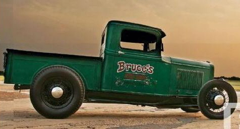

    hi. wanting opinions on the swage on a 32 chassis.i have jw rod garage repo rails.i are starting to think about putting it under a 34 pickup body.
    build outline-283 chev,manual,quickchange rear,artillery wheels with cross plys,fenderless,4" drop i beam/split bones/mono leaf/tubular shocks front
    my questions-
    -where should the chassis swages line up?
    -the front to pretty much the cowl-hood side point?
    -the rear i kinda like the idea of it being at the back of the cab as i want it a bit shorter than the usual-(as short as in the attached pic i stole from the hamb and did an average photochop on)if i do this the front swage ends up further forward than usual(i am intending on chopping off the front horns)so i perhaps need to take 5-6" out of the middle section to get the front in the right place and the rear where i want it.what looks right and what just looks wrong?

    Joined: Oct 7, 2005

    i marked on the rails where the cowl meets the hood sides (after checking this position from a 32 tudor,which puts the "reveal" pretty much at this same point) then positioned grill where that will go (i have a 34 commercial hood(and grill) that i are going to trim the bottom of the front to eliminate the angle that the grill is set on,but leaving a minor angle as it will have some slight rake due to tyre sizes which should leave it upright).then with the cab on the rear "reveal" extends past the cab approx 6",which is what i was unsure about.the other thing i wanted was between the back of the cab and the front point of the rear tyre i want a distance of no more than 1.5 x the size of the tyre from its outside diameter point in to the rim.
    i was just looking through some saved photos-the green "bruces" truck is very similar to what i want except with a shortened bed and a roof chop(last photo i've chopped/mangled).looking at the rear "reveal" it lines up with the swages on the bed and doesn't look out of place.and the cab to tyre distance looks good too.i'd like the bed to have similar proportions in front of and behind the tyre-perhaps slightly bigger behind.
    in the photos of the green and blue pickup i like the gap between tyre and bed better on the green truck rather than the blue one but this is perhaps due to the green one having larger dia rear tyres? does anyone know if this truck is on a standard 32 passenger chassis?

    If you are going to monkey with the reveal any, I might suggest you line up the rear upright point with the bead that goes over the wheel. I guess you would be pushing that portion of the reveal backwards an inch. I think if you move the upright towards the back edge of the cab you will have a big expanse of blah between the cab and the tire.
    Since 34 pickup hoods will leave a gap above your 32 frame, how about giving the frame a slight wedge cut (not much) at the cowl band? Just so's it's maybe an inch higher at the grille. Then I would section an inch out of the grille front-to-back, not up and down. To make it look a little more in proprtion with a 32 passenger grille.

    thanks-all real valid points for me.the reveal lining up with the bead on the bed i think is important(the "bruces" truck does nicely)i also like the way the rear tyre matches that bead so well -does anyone know what size tyres are on that truck?
    i hadn't thought of just seeing a plain chassis behind the cab and how "blah" it would look.point taken.
    also i didn't realise the 34 hood left a gap-i think i will just alter the hood to suit the chassis.
    i knew the commercial grill was different but couldn't quite put me finger on it as to how,i will definately look at sectioning it vertically.
