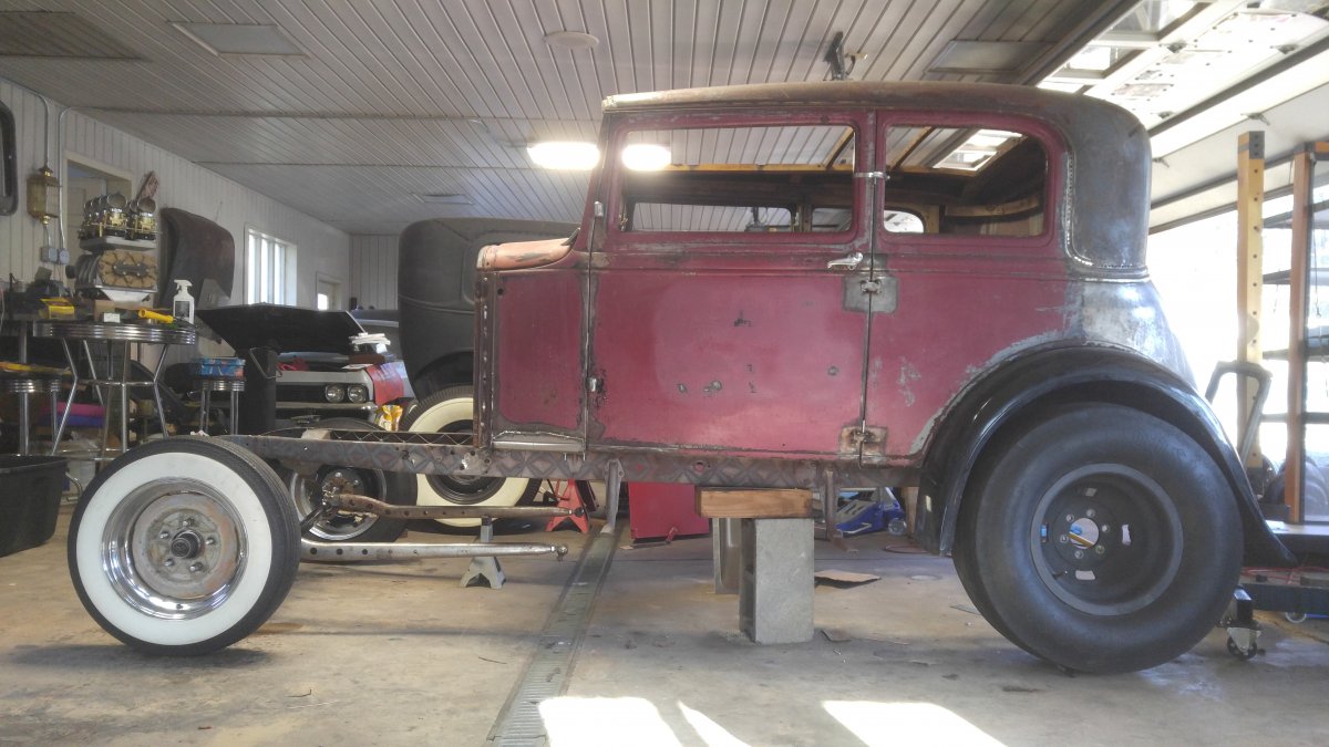

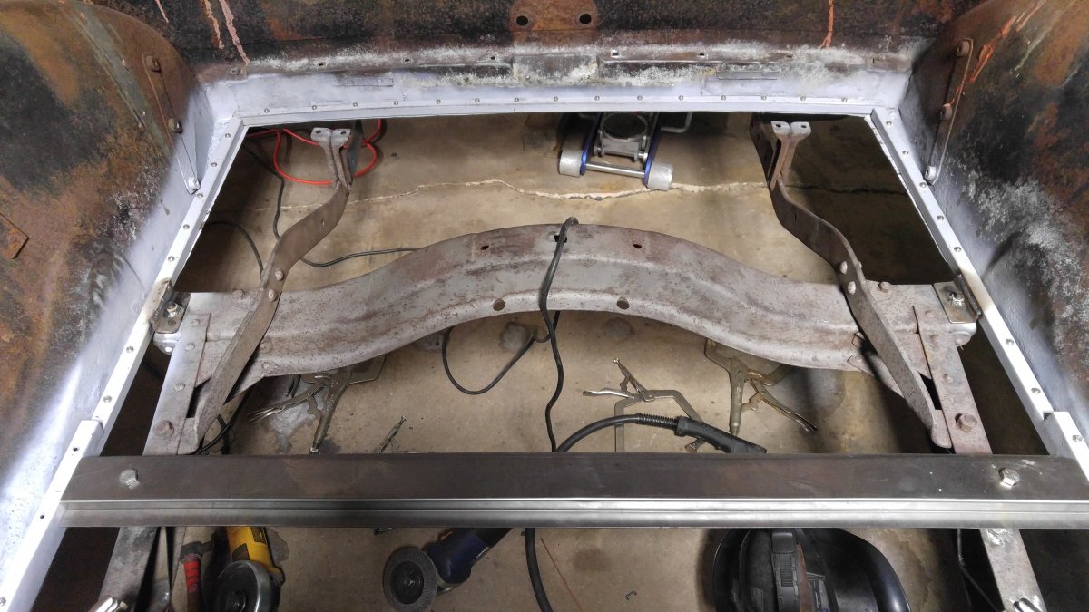

    20160221_232943.jpg The rear floor needs to come up a few inches to cover the bumper brackets.

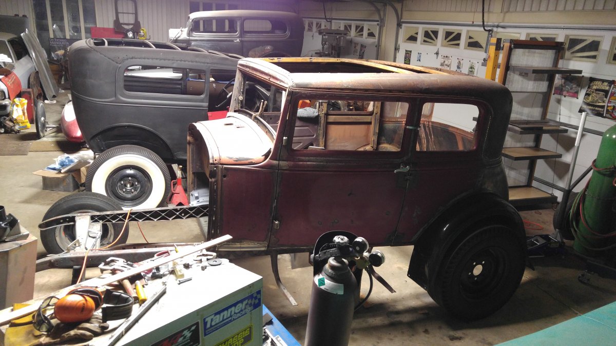

    20160223_214504.jpg Mikey i would need the snowman to run blocker : ) thanks guys for the kind comments. Lets see whats next? Here she is bolted to her frame for the first time in a long time. 10 mounts so far and several more to come. Up front and rear is solid mounted like a 32 but the middle is on urethane biscuits

    20160227_155518.jpg About this time i borrowed some slicks from Tony for a look. I was sure these would be the perfect size. Until i got them in the fender. They look a little small to me
    Dog_Patch and elgringo71 like this.

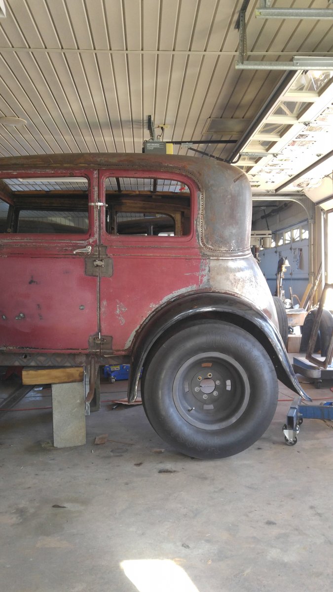

    20160228_160938.jpg Now this is what im after! Fills up the fender perfect. Ok so now we know what size slicks she will wear. There will be some hanging out in the wind but thats old school.

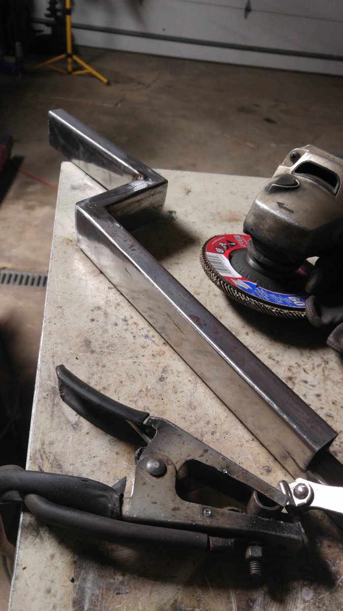

    20160301_201125.jpg Mmmmm i wonder if i flipped the tubes on the bones? What the hay... Lets cut em up!

    20160304_152050.jpg Thats the ticket! Now they are only 4 inches under the frame! I can live with that. Time to pie cut the ends for some caster. I ended up with about 8 1/2 degrees at 4" below the frame
