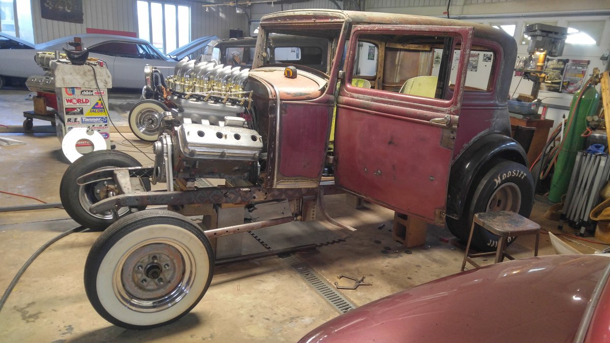

    Message_1516647467944.jpg Time to mock up the engine again

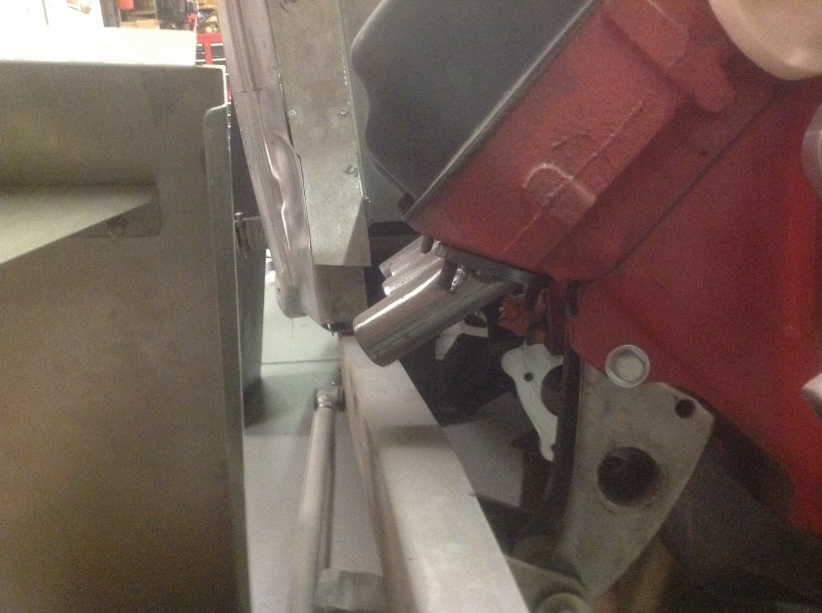

    I was happy with that until..... I realized theres no room for the headers! Damnit!

    Message_1516674617054.jpg Well i cant go down for headers clearance so that leaves up as the only option... How bout this?

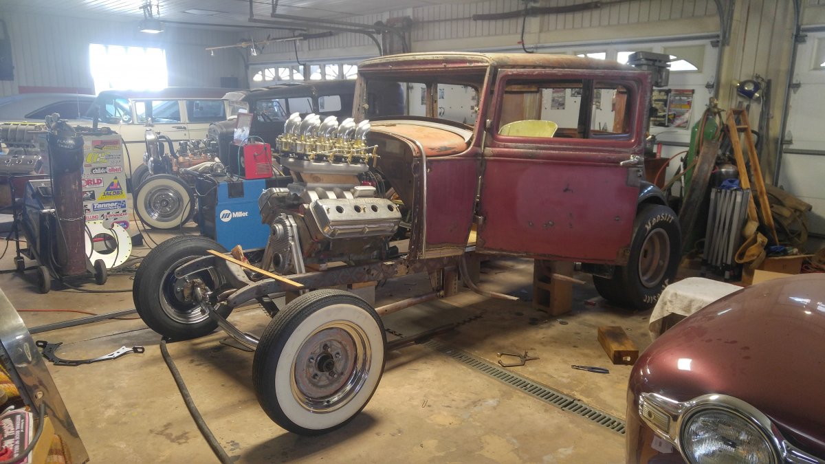

    20180123_152639_HDR.jpg Im really liking this.... A little bit of winged express adittude never hurt right???

  12. If you can get your headers in hand - zoomies or 40 Willys headers - then bolt them on, that will tell where the block can sit.
    loudbang and allwilly like this.

    Make sure the crank center line isn't too high if they have that in the rules.
    Sent from my Moto G Play using The H.A.M.B. mobile app
    loudbang and Spoggie like this.

    Nhra tracks have 24" max...berting a few seg cars are above that. Low as possible for better handling on top end also

    There's a min. for SEGA, 16" I believe but the sky's the limit!!

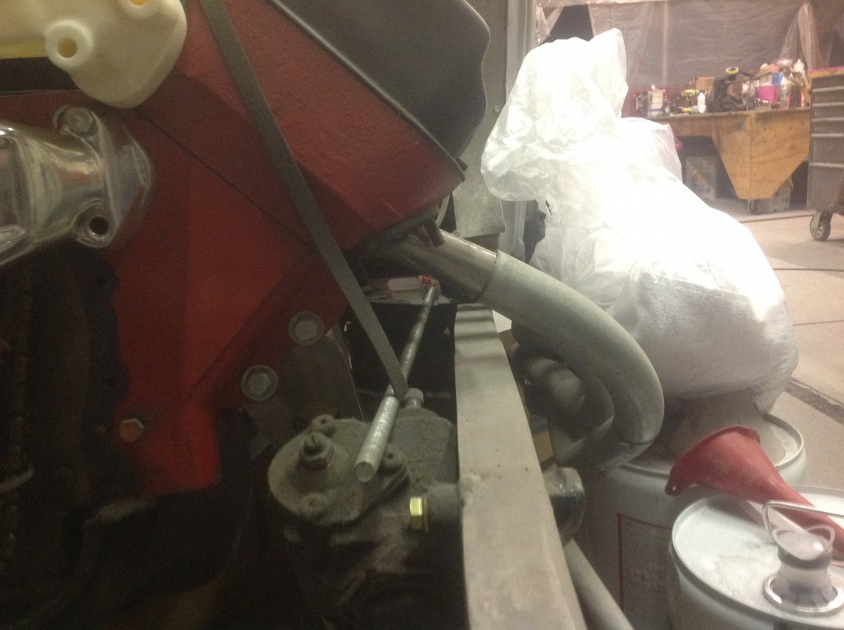

  19. There is a big problem with hemi headers.
    See page 4, https://www.jalopyjournal.com/forum/threads/truck-into-a-coupe-my-next-pet-project.850807/page-4
    Almost every one of them ever made wants to start out square off the header flange.
    For one, That's not the direction, flow or shape of the exhaust port. So the next fitting is an elbow then another elbow and it still hits the frame. It's asinine stupid.
    Start the header flange at the direction of the port and all your problems go away. But it's more work and not easy. Starting straight is easy and everything has to be easy.
    It might look off, but this in line with port shape and direction

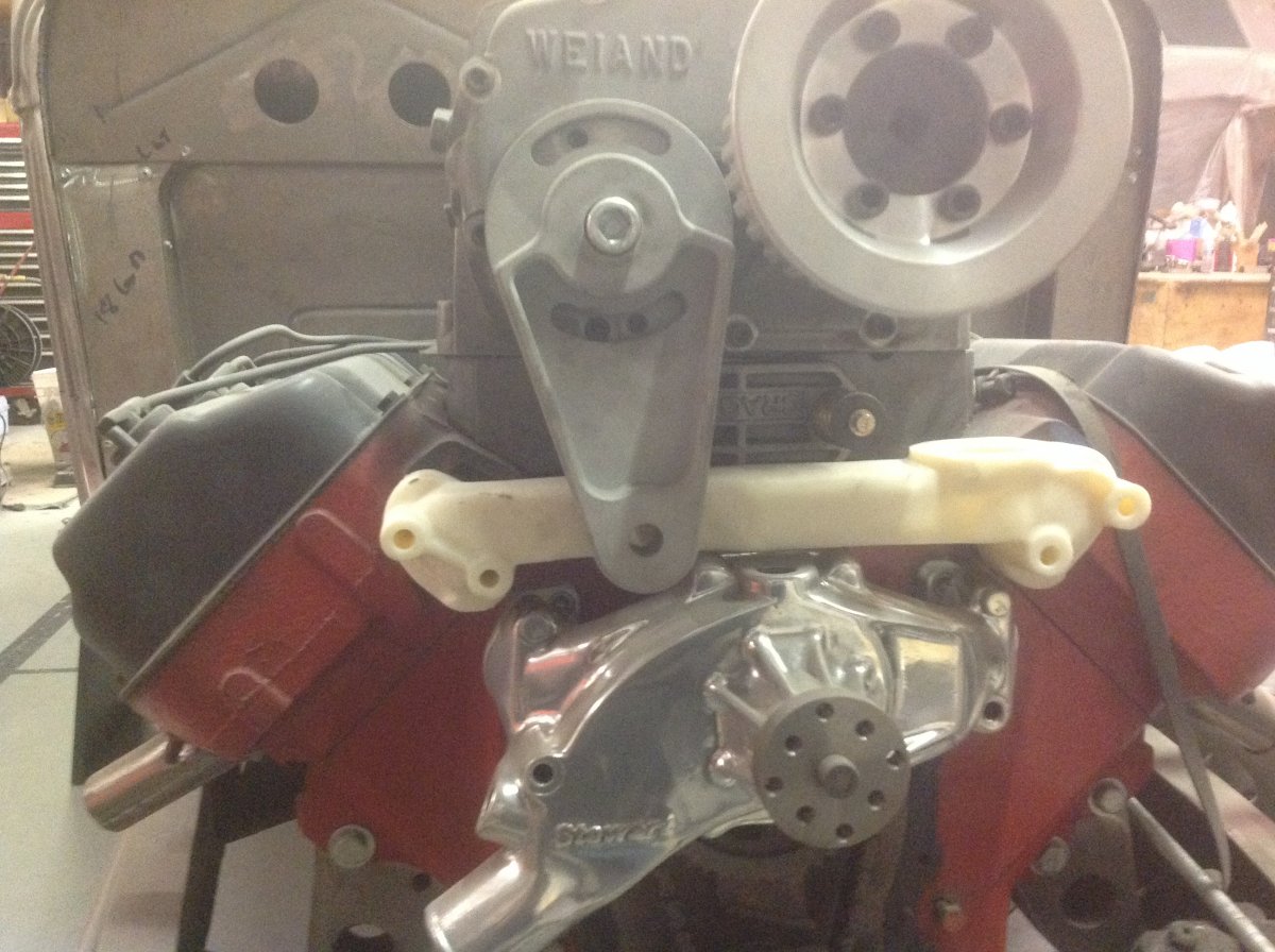

    What's your plan for the water crossover ?
    loudbang, catdad49, Chucky and 5 others like this.
  20. Where did you get that plastic cross tube tween the heads? Where do you get a real cross tube like that? I don't need a plastic one!! Also is Hot Heads the only place that sells the timing front cover that works with the BBC pump? I am leaning heavy towards a stock cover and pump but maybe it won't work with my blower - I haven't gotten that far yet. Thanks, Josh
    loudbang and PBRmeASAP like this.

  22. The water crossover -
    https://www.jalopyjournal.com/forum/threads/as-seen-on-tv.1070255/
    It was an adventure getting that far.
    Still a bit to go on the endeavor
    loudbang, Dog_Patch and Tudor like this.

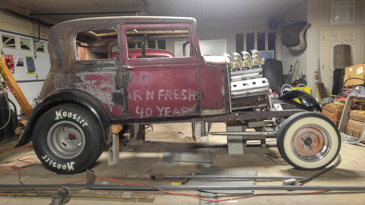

    Message_1517254226917.jpg Ok still playing with engine placement. The crank centerline was outta control and looking kinda scary so i adjusted it some more.
