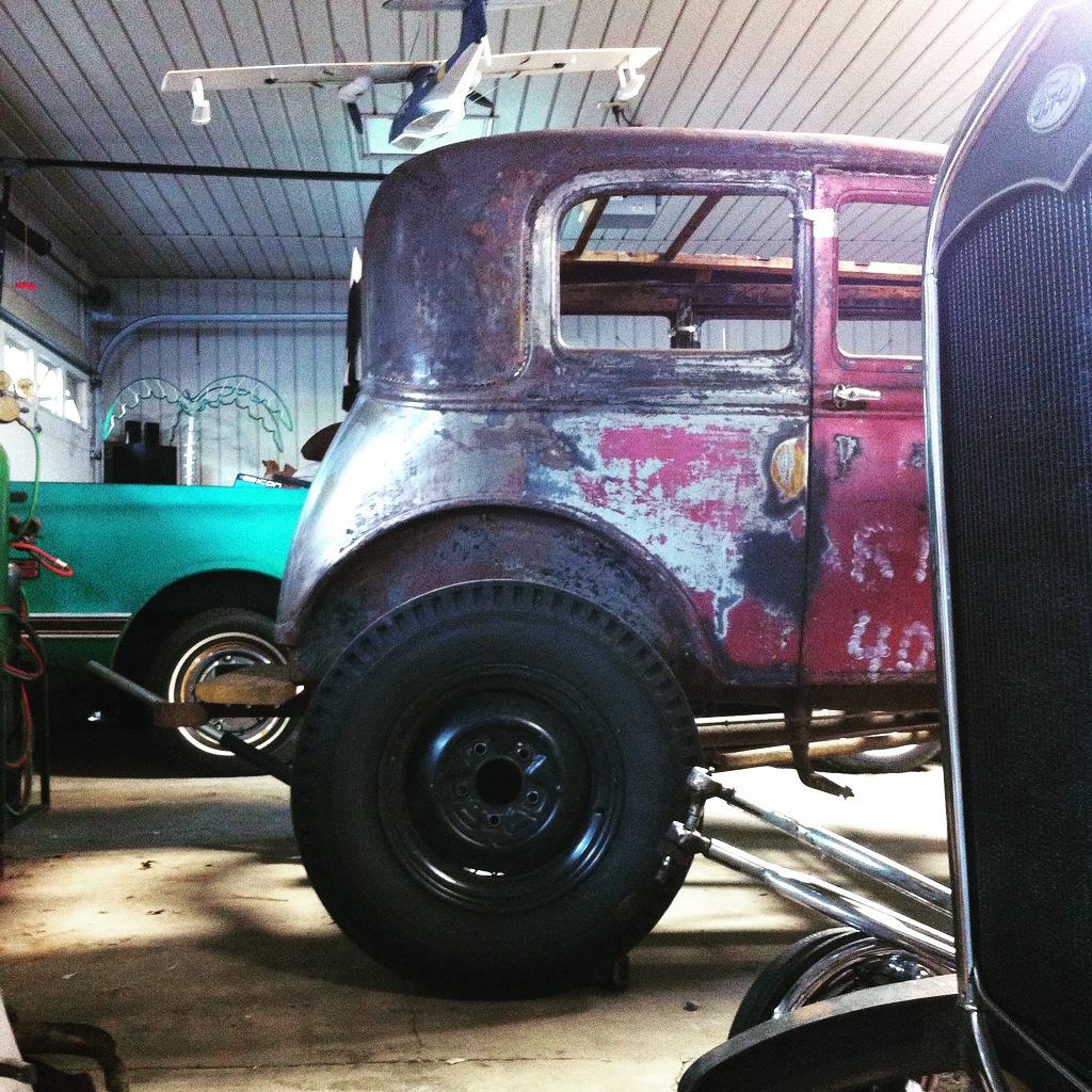

    We struck a deal and we brought her home! First thing I did was roll a slick up beside for a look

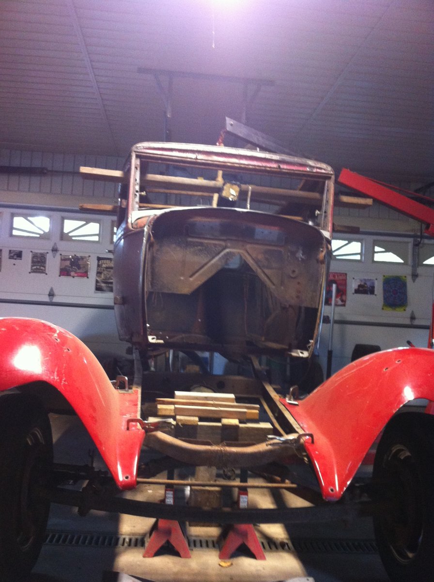

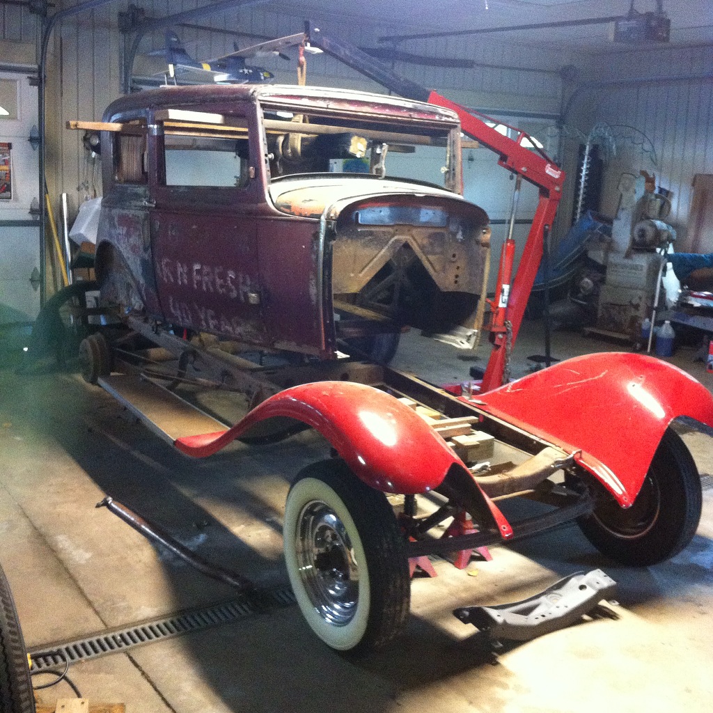

    so now the work begins.....gotta lift her off the frame n get down n dirty upload 1-15-16 096.JPG upload 1-15-16 097.JPG

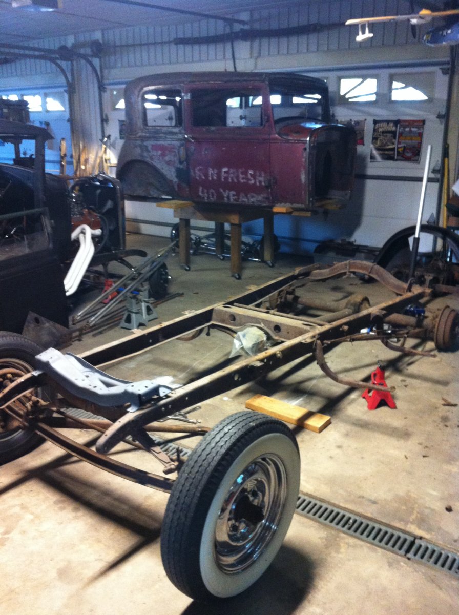

    body off... lets see what kinda shape this frame is in upload 1-15-16 098.JPG upload 1-15-16 099.JPG
    mgtstumpy, Mtn Goat, hipster and 5 others like this.
  8. Cabbage
    Joined: Apr 17, 2006
    Posts: 728
    Cabbage
    1. S.F.C.C.
    The Vic"Tori"a chassis is stone stock original and unmolested. Lets see what we can do about that. Hey whats that extra front Xmember doing on the front? More on that later.....

    lets loose the stock rear and center Xmember upload 1-15-16 107.JPG upload 1-15-16 108.JPG

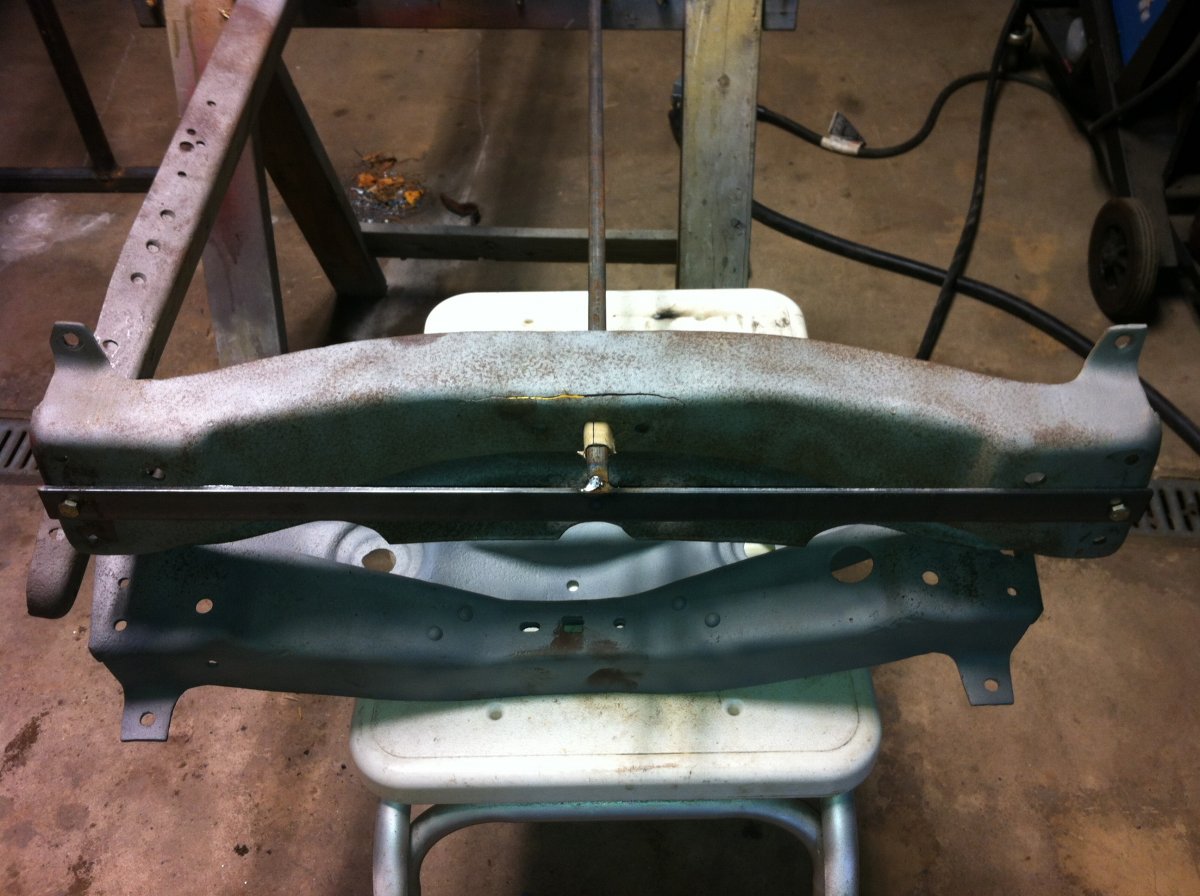

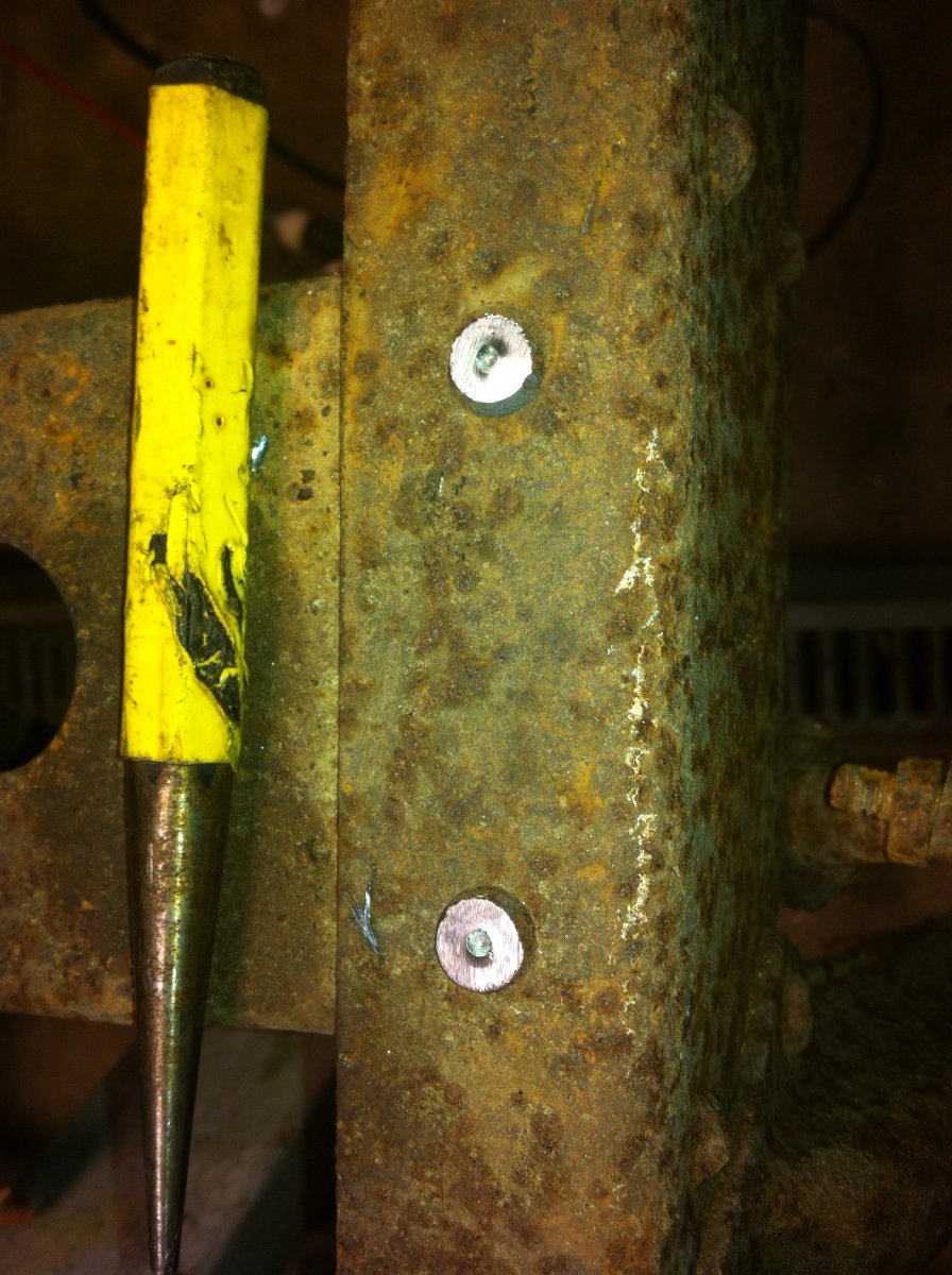

    Now we are getting somewhere... fresh clean old ford steel. Wait wheres the front Xmember? Oh yea ive been thinking bout this.... We are building a Gasser here so more nose height is always better. Hmmm this 32 front Xmember has been hanging around my shop for a few years. Now heres where things start to get weird folks. See most people change out the 32 X member for model A X member cause it lowers the front of the car. Well I'm thinking if we put a 32 X member in the A frame we can gain some altitude? Sounds easy........... lets see upload 1-15-16 141.JPG
    mgtstumpy, wingnutz and mad mikey like this.
  14. Cabbage
    Posts: 728
    Cabbage
    1. S.F.C.C.

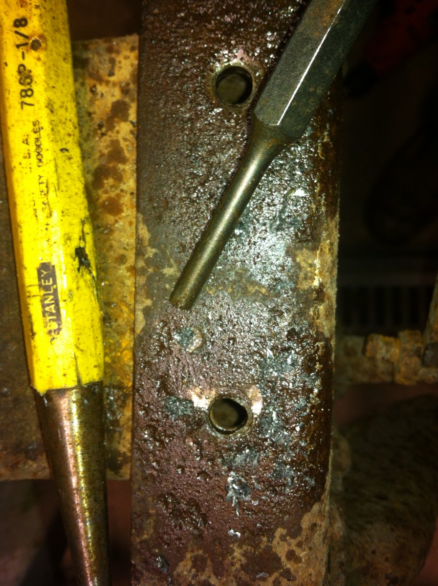

    I made this snazzy little jig using a couple holes in the frame to locate the spring bolt. We gotta keep the model A dimensions and wheelbase for the desired look

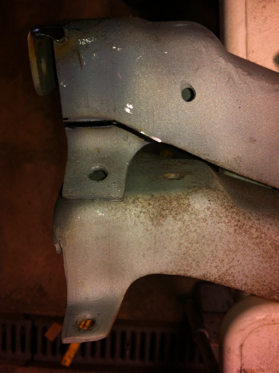

    and the modifications start.... the 32 looks like an easy swap, but oh nooooooo
    the feet have to come off and up because the frame is smaller

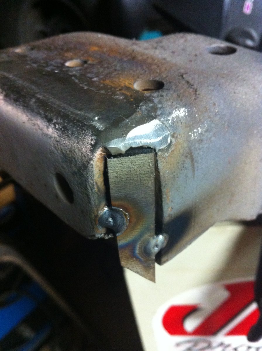

    also the 32 is narrower.... more slice n dice upload 1-15-16 142.JPG upload 1-15-16 143.JPG

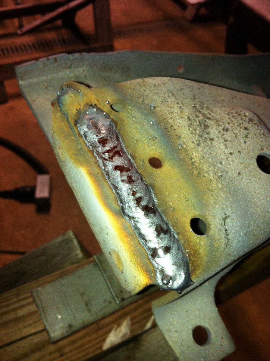

    I boxed in the corners for strength....wheelies are part of the plan :)

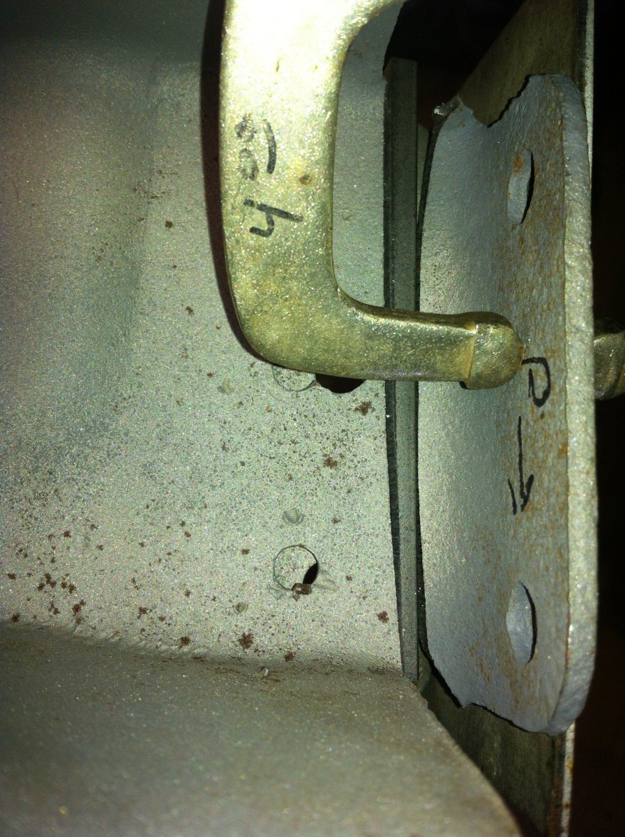

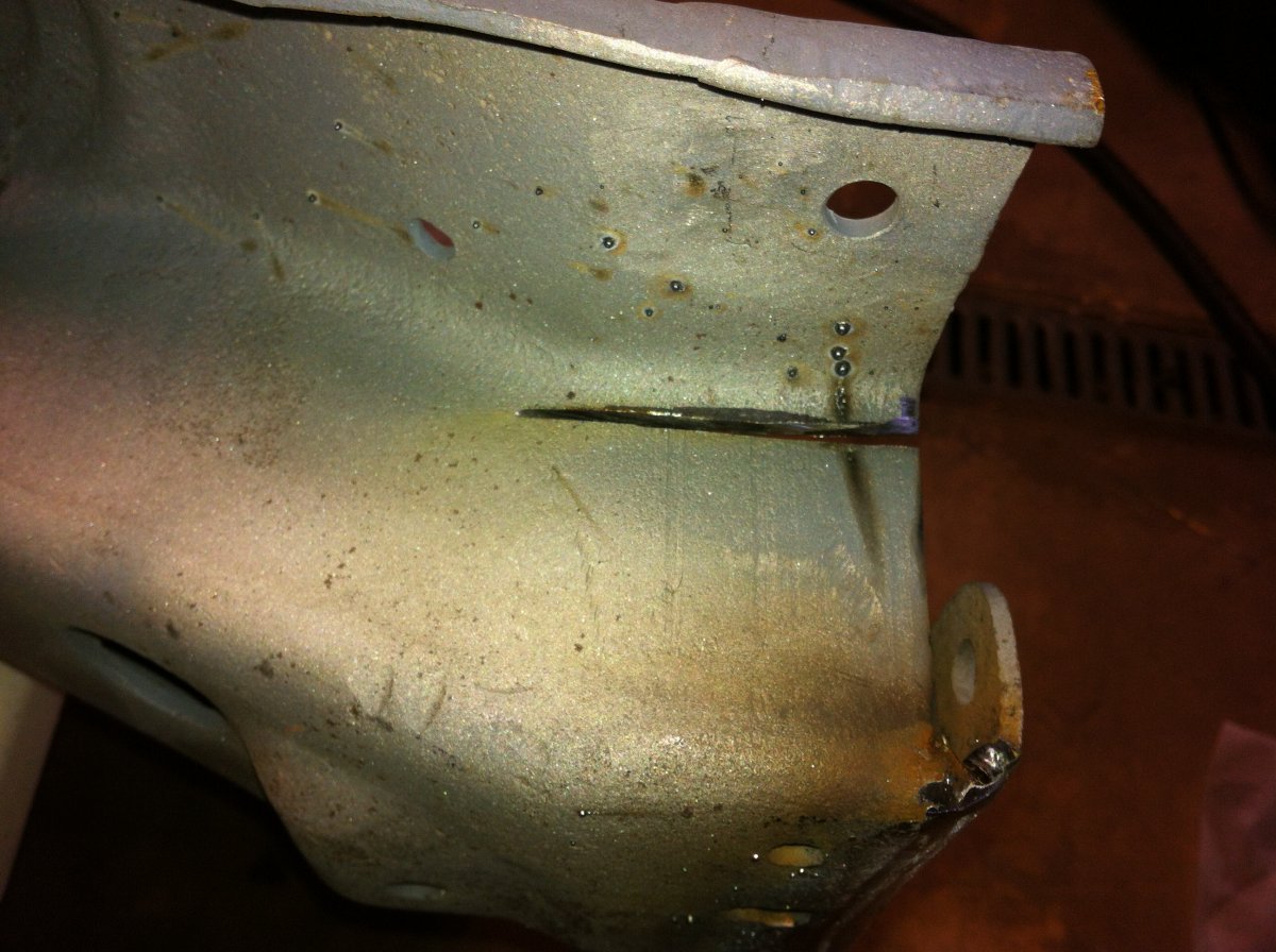

    why hasn't someone done this before? oh yea its a royal PIA!!!! upload 1-15-16 149.JPG

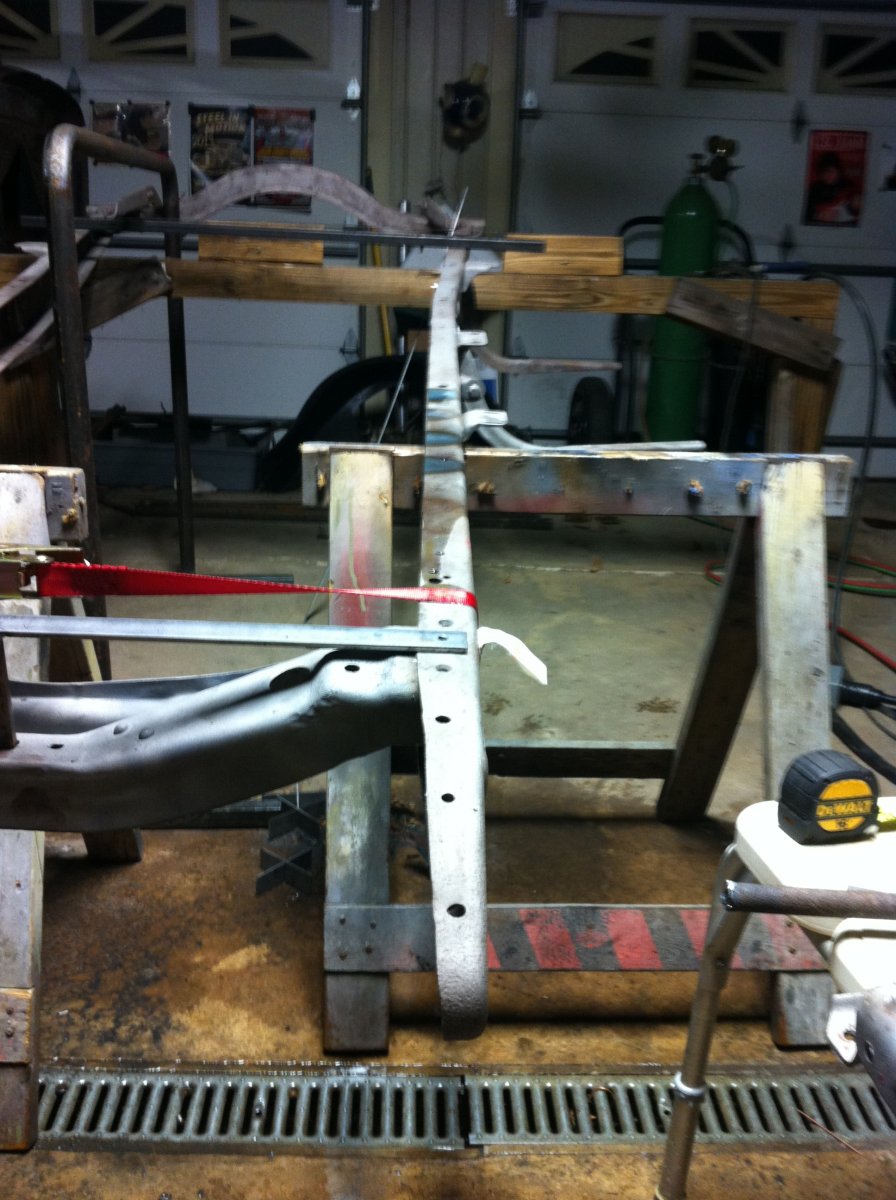

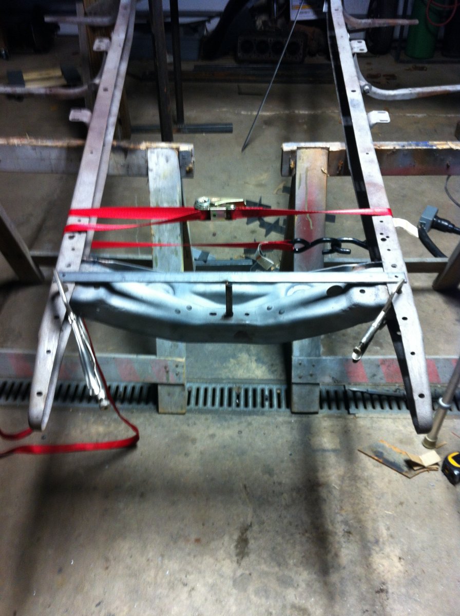

    Now before we burn that 32 Xmember in the 31 frame I noticed a slight bow in the drivers side frame rail. I mean slight, very slight but I'm picky. upload 1-15-16 150.JPG
    mgtstumpy likes this.
  26. Cabbage
    Posts: 728
    Cabbage
    1. S.F.C.C.

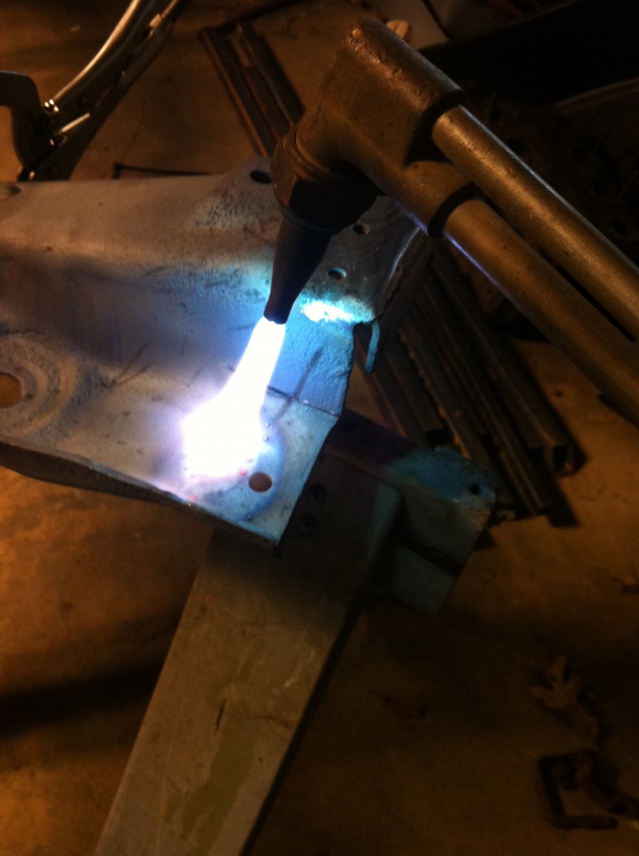

    you gotta squint a bit to see it but its there, bowed out maybe 1 degree. Out comes the blue wrench again, I saw this once on TV. Easy as pie. Heat n Quench....
  27. Cabbage
    Posts: 728
    Cabbage
    1. S.F.C.C.
    I'm just gonna pretend I know what I'm doing. Here we go..... upload 1-15-16 151.JPG
    mgtstumpy and ProEnfo like this.
  28. Cabbage
    Posts: 728
    Cabbage
    1. S.F.C.C.
    Well sumbitch!!! It works like a charm.... :) upload 1-15-16 152.JPG
