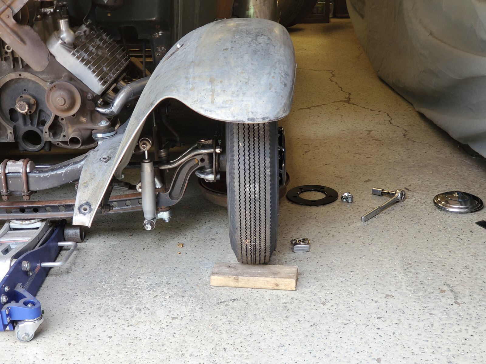

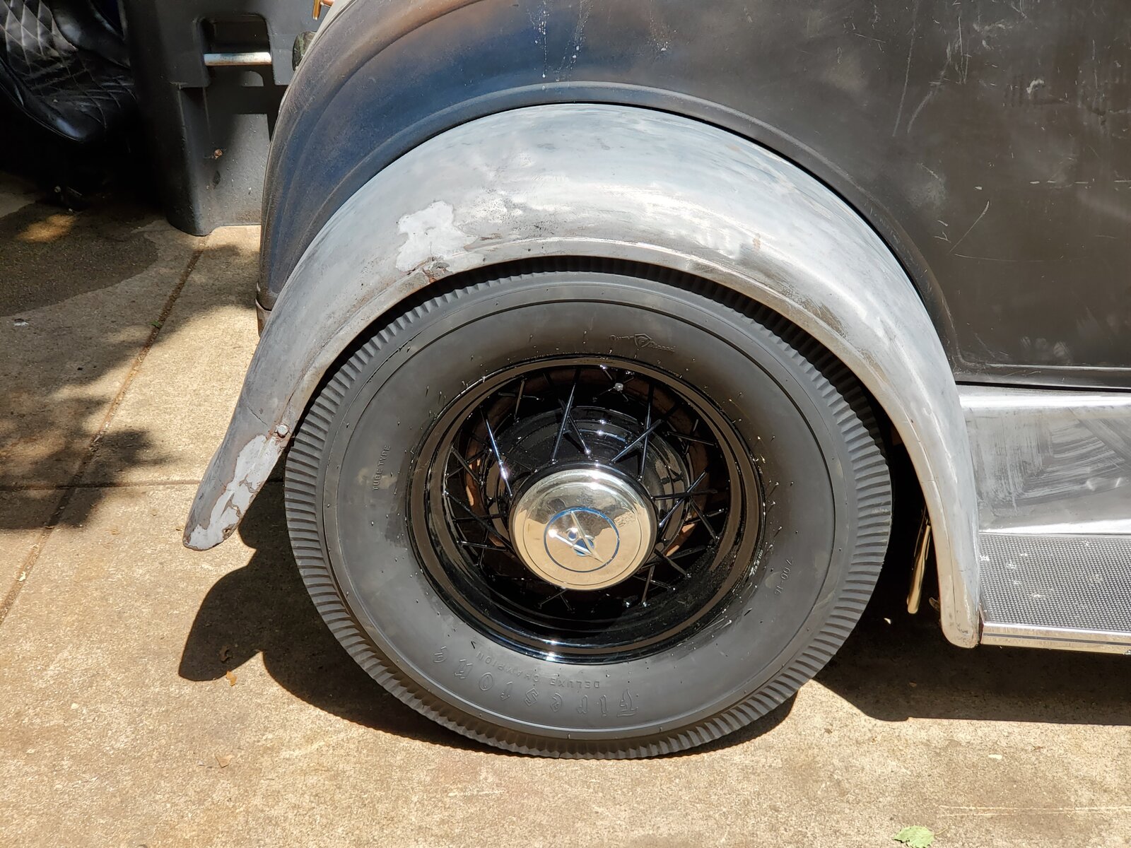

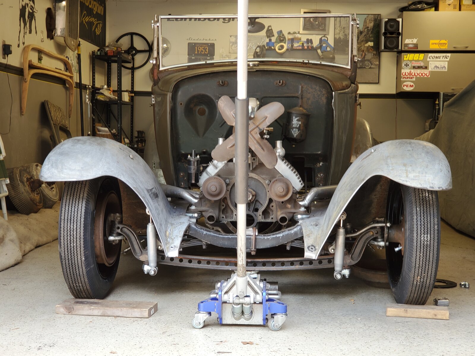

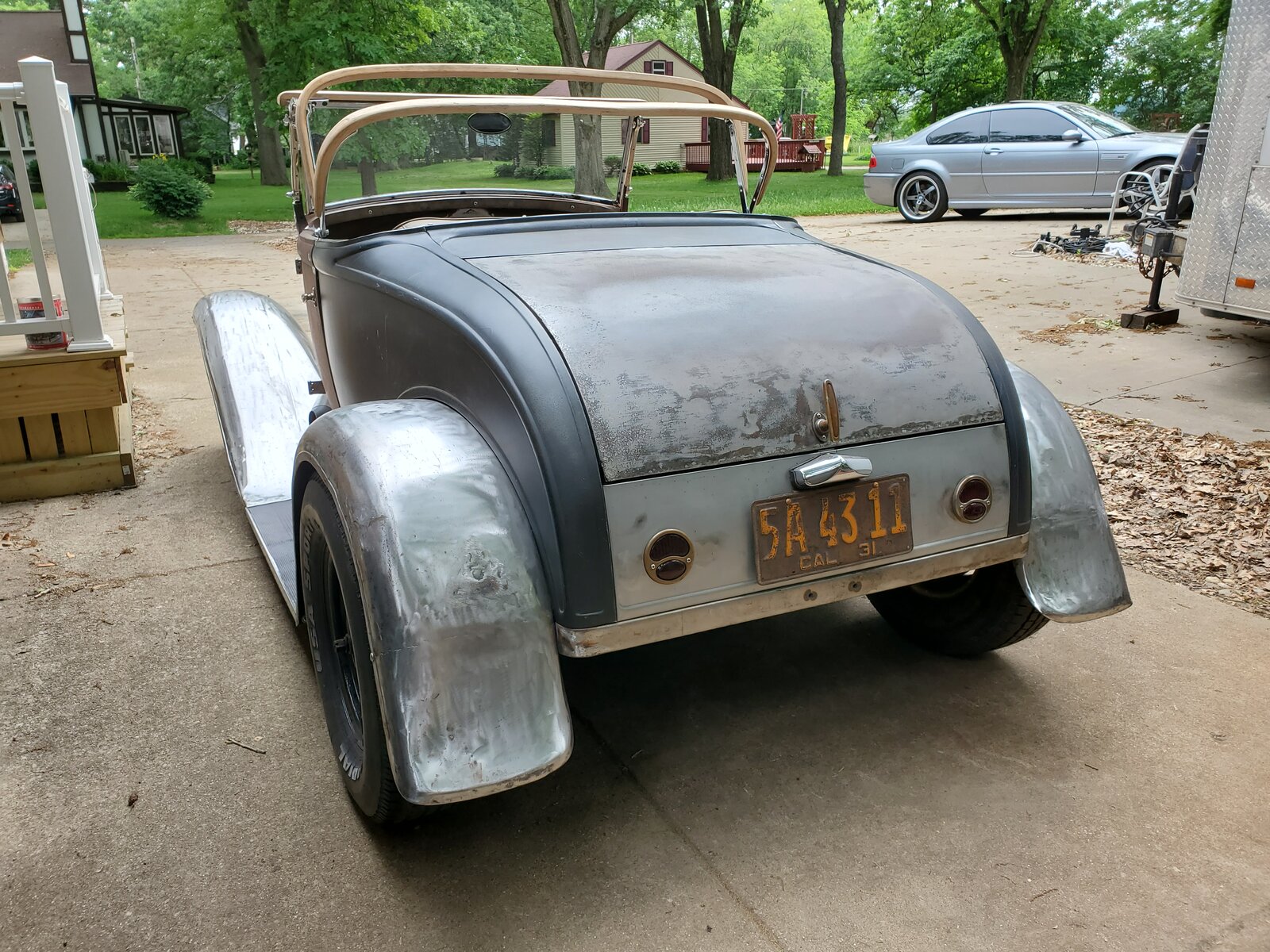

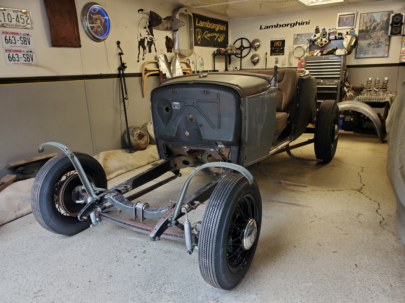

    Well here it is with its new shoes. It's going to take a little time getting used to. 450/475 x 16 front 700 x 16 back. 4" kickup in the rear with T rear spring 4 leaves removed. 4" drop front reverse eye 2 leaves removed. I think the stance is pretty good for the first try. The rear is a little tight to the fenders at the fender brace and the front tires look too far inboard for my liking. 20210615_150237.jpg 20210615_151641.jpg 20210615_150221.jpg

    What do you guys think? Good or bad

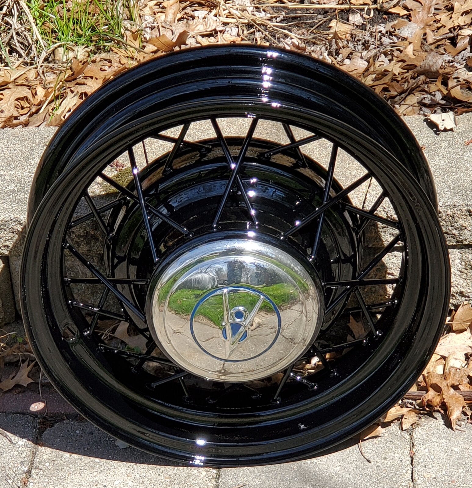

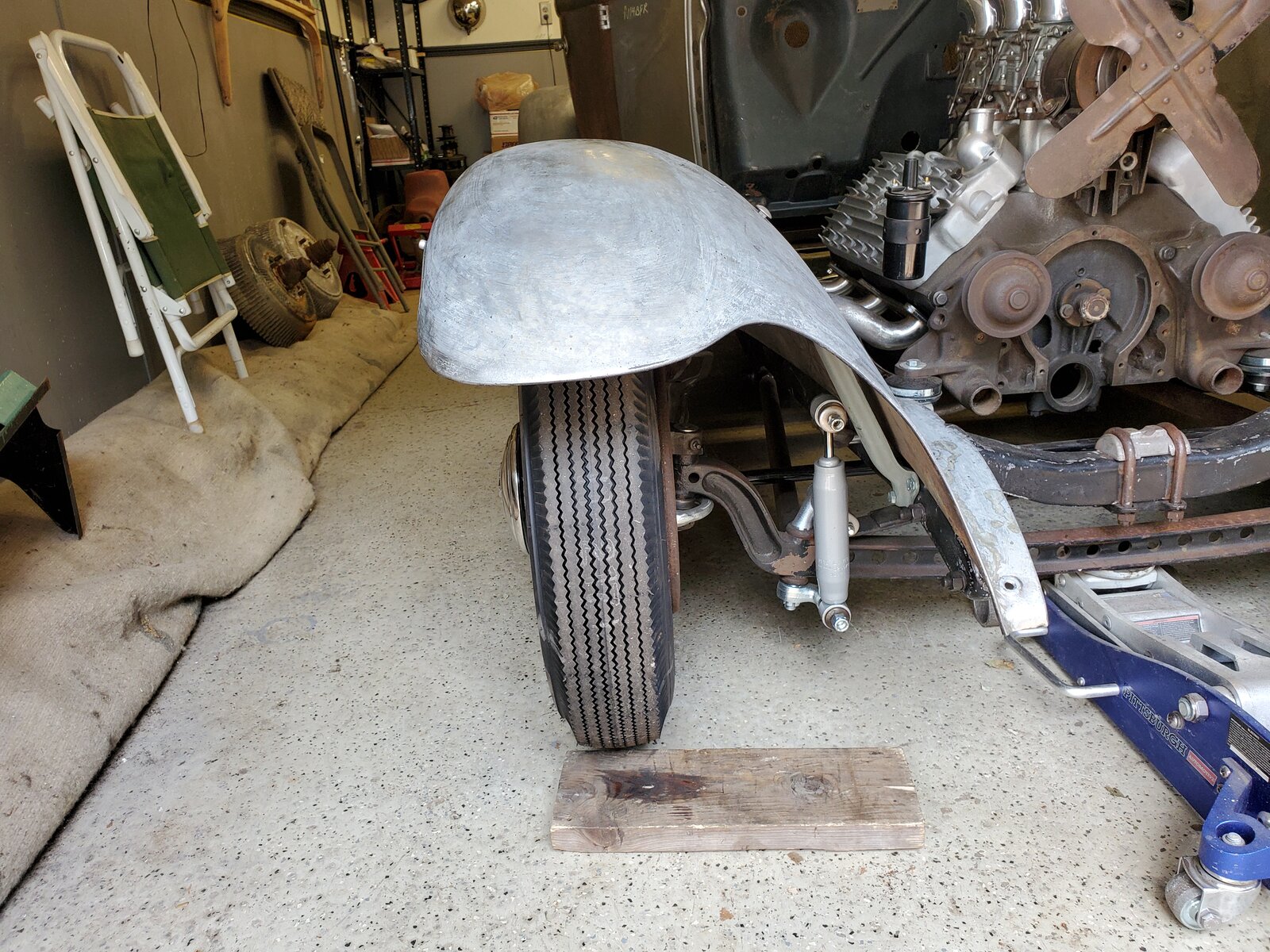

    I moved the front tire out 1.5" closer to the fender. I like the look better. I might have followed the Vern Tardel book too closely. Being an open wheel roadster it wouldn't be an issue. Also the 4" wires are not helping any. 20210617_095127.jpg 20210617_094911.jpg 20210617_094617.jpg Not sure my next move or just live with it. Any thoughts.....

    I think it looks great narrow like you had it, but also looks good spaced out. I’m struggling with this now as I’m using a 32-36 axle with wishbone, so narrow like you had is out of the question. As for the rear, I did a spring behind setup to Model A wheelbase and it looks exactly like yours. Everything was just tacked up, so I cut the crossmember loose, shortened the TT (again) and I ended up taking close to 1” out of the wheelbase.

    I guess that is why we mock this stuff up early on. My options would be a wider dropped axle or do I dare say spacers?

  26. Looks good to me narrow... centers the tire in the fender.

    bet the tires will rub alot less with the axle being narrow...
