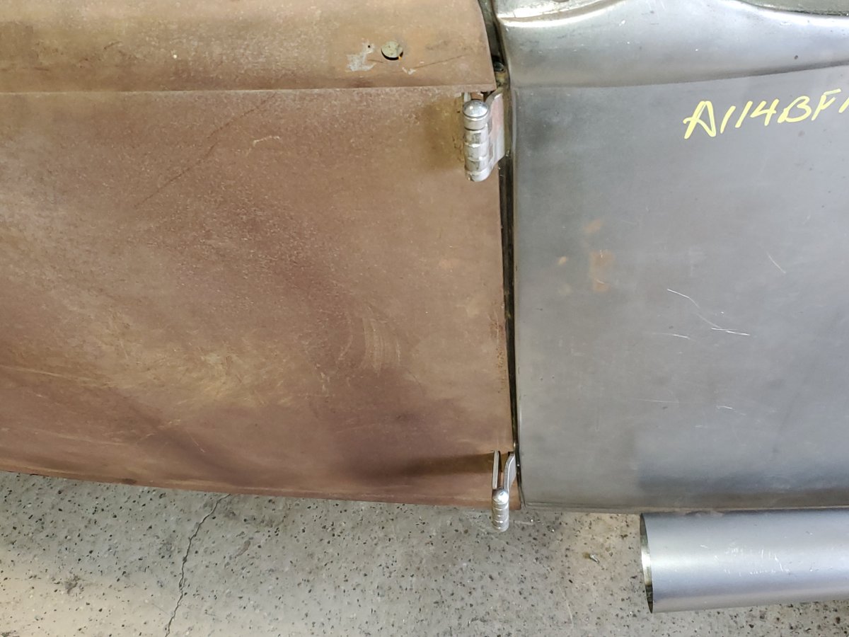

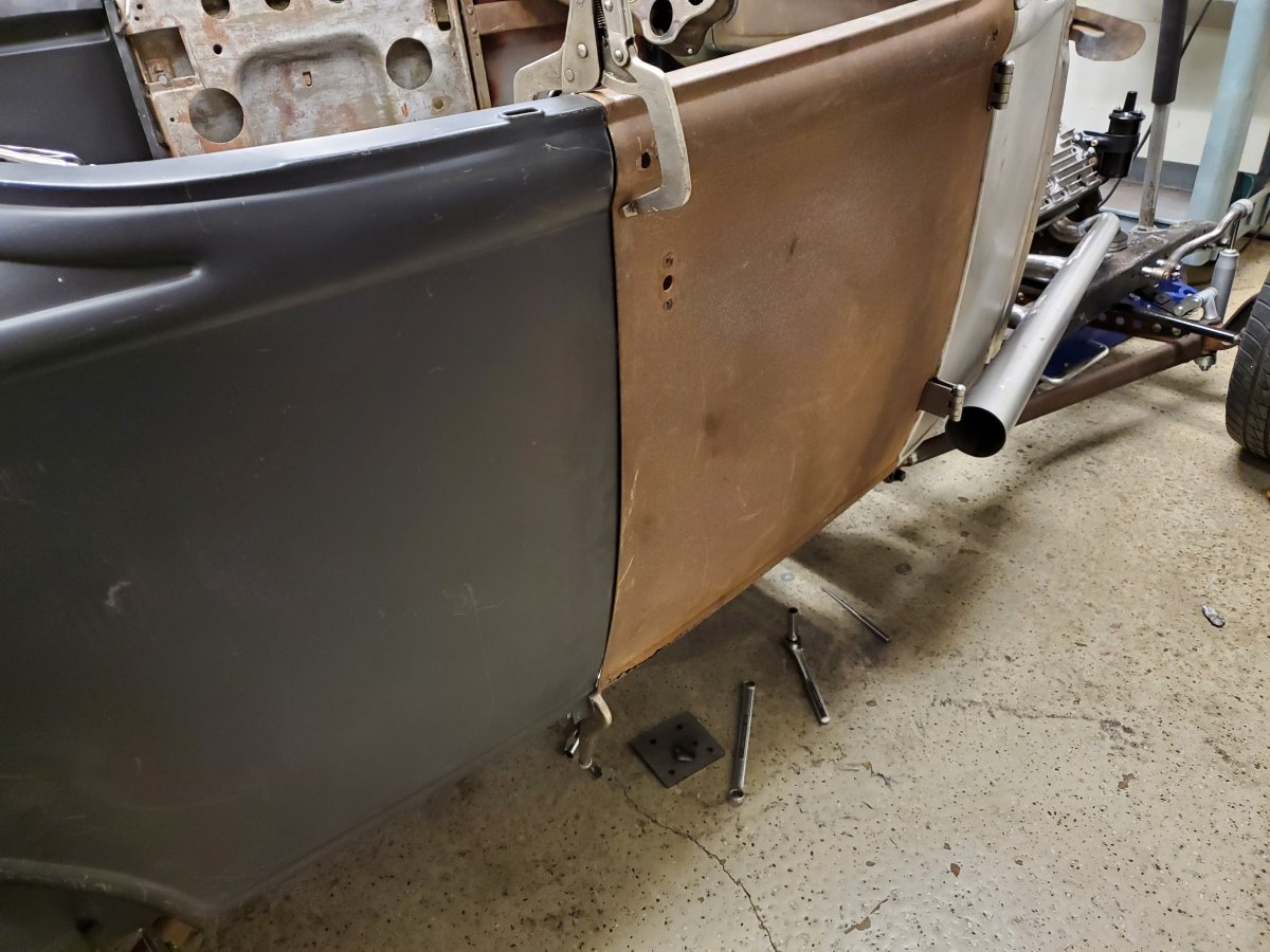

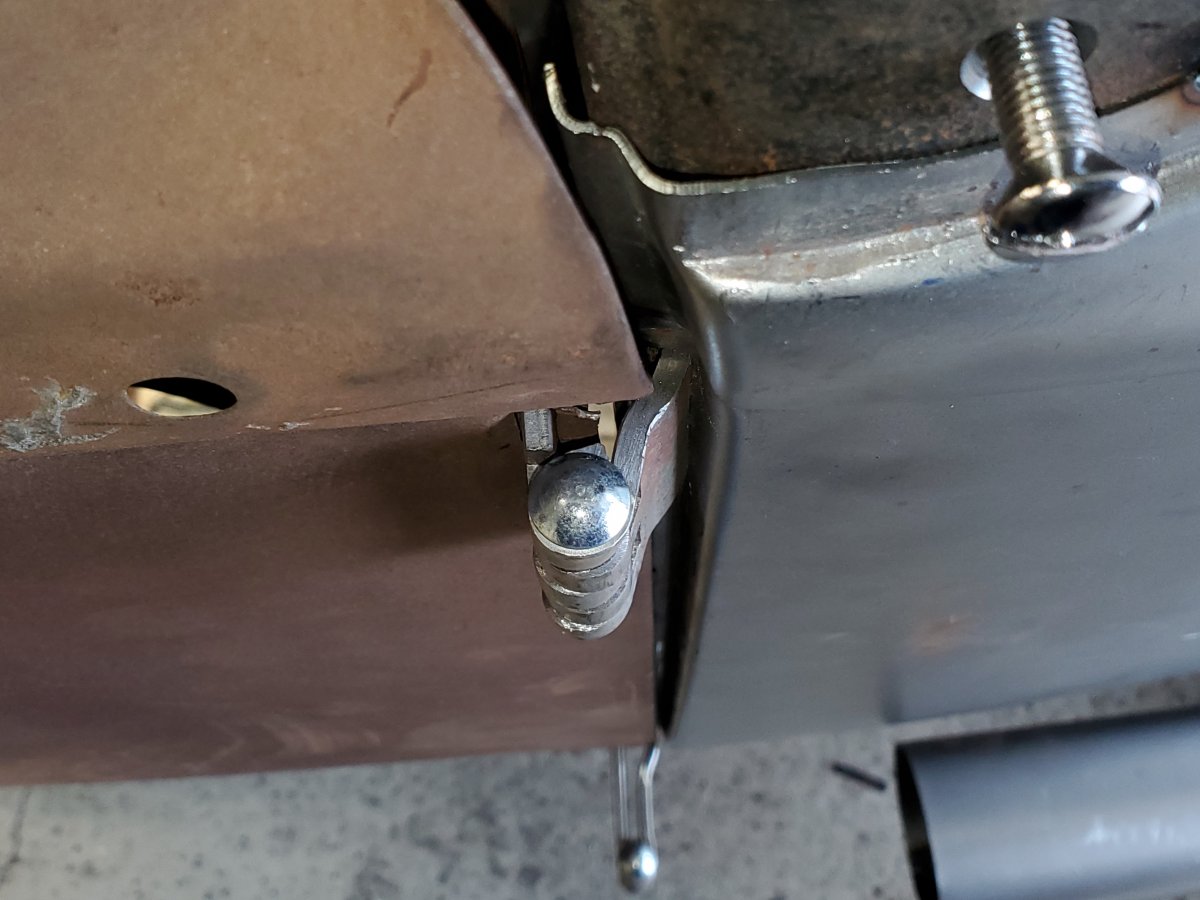

    just looking at page 2 pix... could the top hinges be upside down, [or on the wrong side] ?
    try flipping one, reinstall the pin and see if it closes the upper gap...

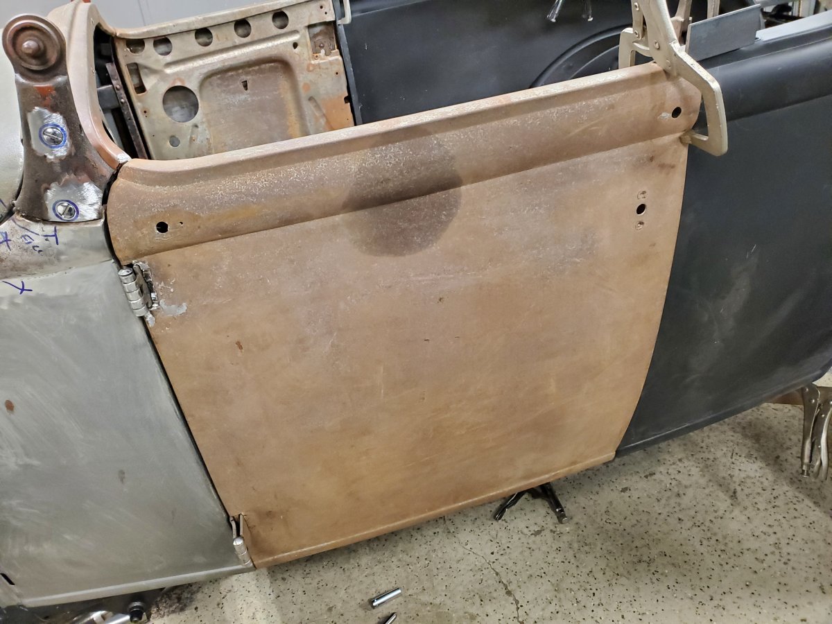

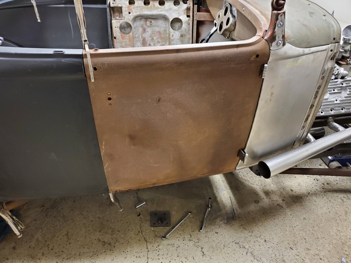

    Well everyone's advice worked on the drivers side. It wasn't quite as bad as the passenger's side.
    1. Increased the cowl spacer from .75 to 1.125.
    2. Cut both hinges to bend them easily to even the door gap. I will weld back up when finished.
    3. Added .125 spacer under the cowl a-pillar.
    Looks pretty good. I am happy. Now on to the other side. 20210416_172257.jpg 20210416_172209.jpg 20210416_172406.jpg 20210416_171919.jpg

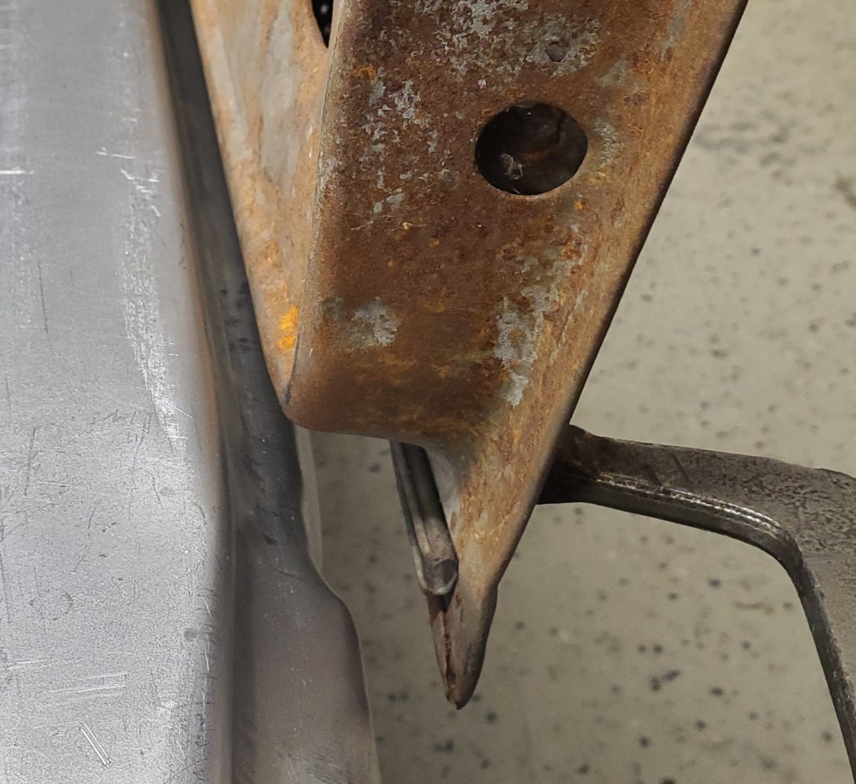

    Here is the channel required to hold the tee shaped seal. 20210415_162926.jpg

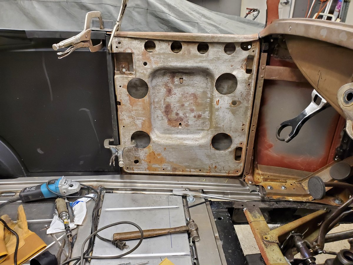

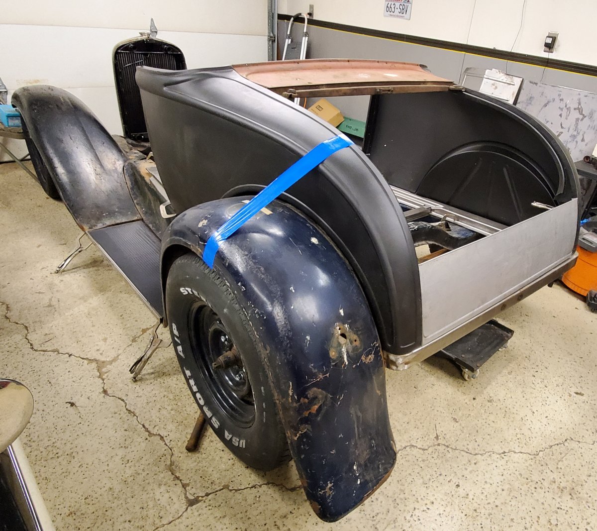

    I rough clamped the quarter panels in place today. Door gaps needed more adjusting by raising the cowl yet again. But it's getting close. The door bottom from the inside need to be perfectly parallel or the quarter panel to door height will be off as well as the gap at the top and overlap at the bottom.
    I will show a detailed welding process for Mike on how I see it by folding the flanges to the subframe and welding. 20210420_161341.jpg 20210420_161327.jpg 20210420_161253.jpg 20210420_153224.jpg 20210420_153203.jpg 20210420_153203.jpg

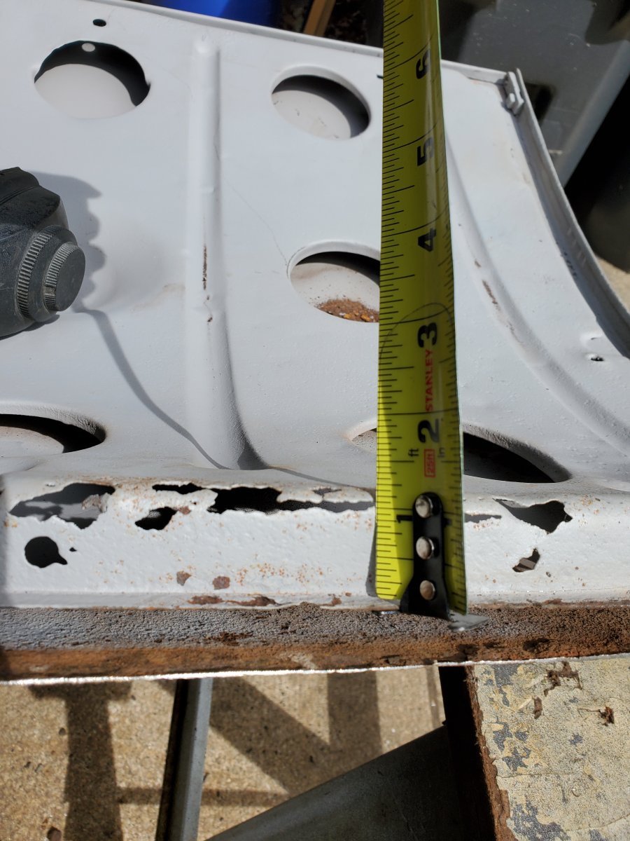

    I started on the trunk lid yesterday. It has the typical rot at the inside bottom. I wasn't going to spring another $300 for a repo inside panel so I decided to fix my rusty one. I used 1.25" 16ga angle and welded it in with a fabbed up latch housing. Not original but certainly not all that noticeable inside the trunk. It sure stiffened up the lid. The outer skin was butt welded. No folded flange. 20210425_143114.jpg 20210425_144042.jpg 20210427_130357.jpg 20210427_130402.jpg
