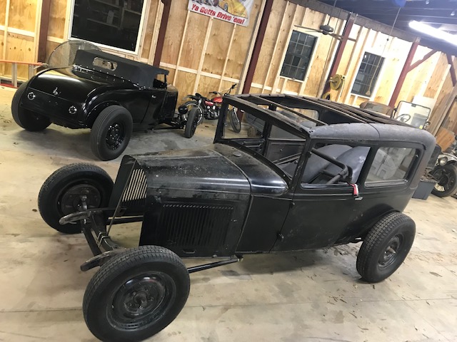

    Here is my newly aquired model a sedan. It was a stalled project that I took over. It is channeled 4", wheelbase is extended 5", 40 ford truck rear end, 1951 truck flathead with side shift trans, dropped front axle. This body is really solid, came with all the fenders, boxing plates, steering colum (F1), seats and other random parts. Let's see if we can make this into a hot rod. IMG_9776.jpg IMG_9777.jpg

    First thing is to put the size tires I will be using so I can decide the direction I'm going. 750-16 and 550-16

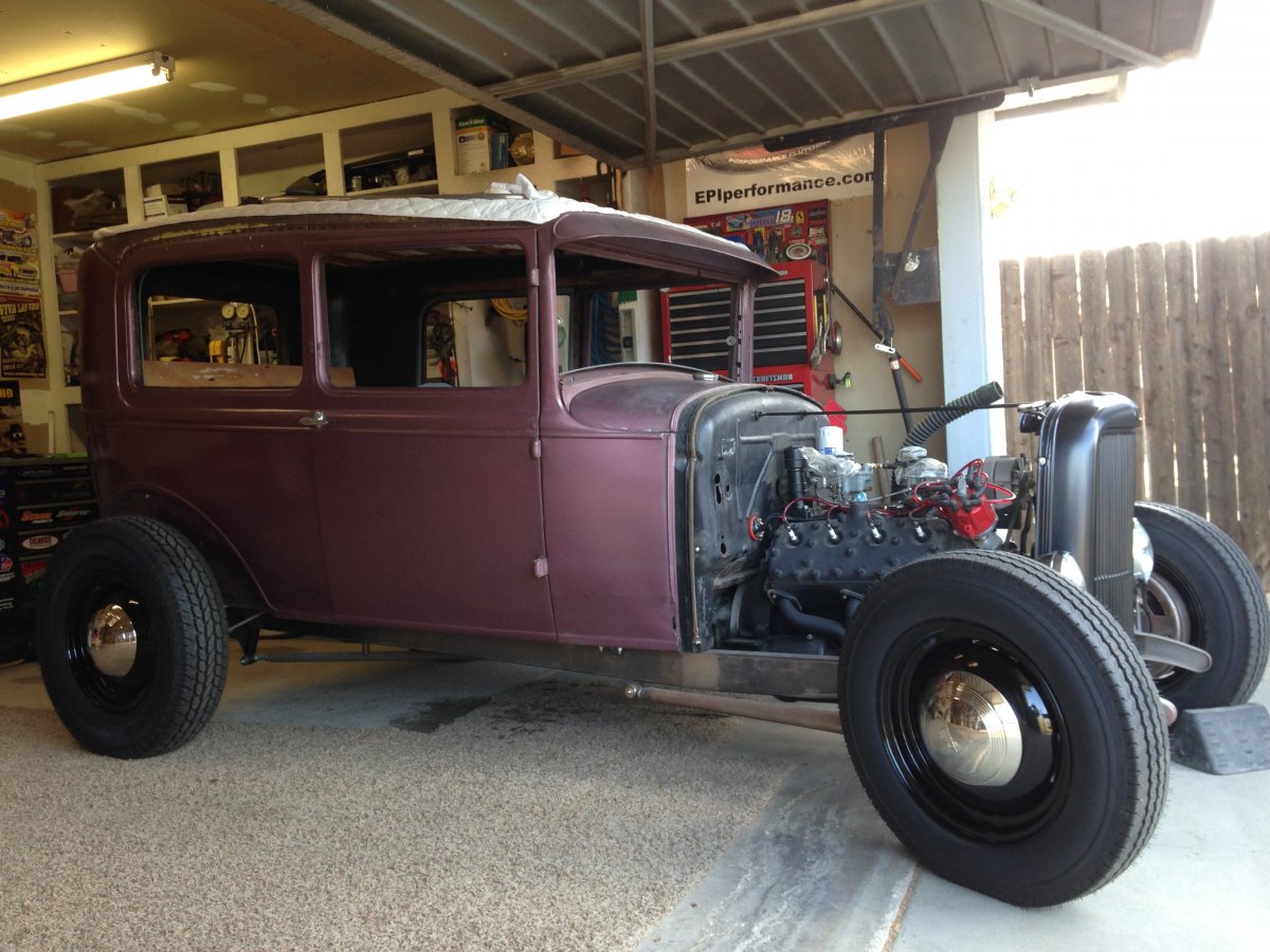

    Very cool project,nice clean body.Im also building a 31 sedan that is 4''longer frame,uncut firewall,flathead and a T5.Mine is not channeled or chopped and probly will stay that way.I did the 5.50 and 7.50 combo also.Yours looks really good with that channel. IMG_0847.JPG IMG_0848.JPG
