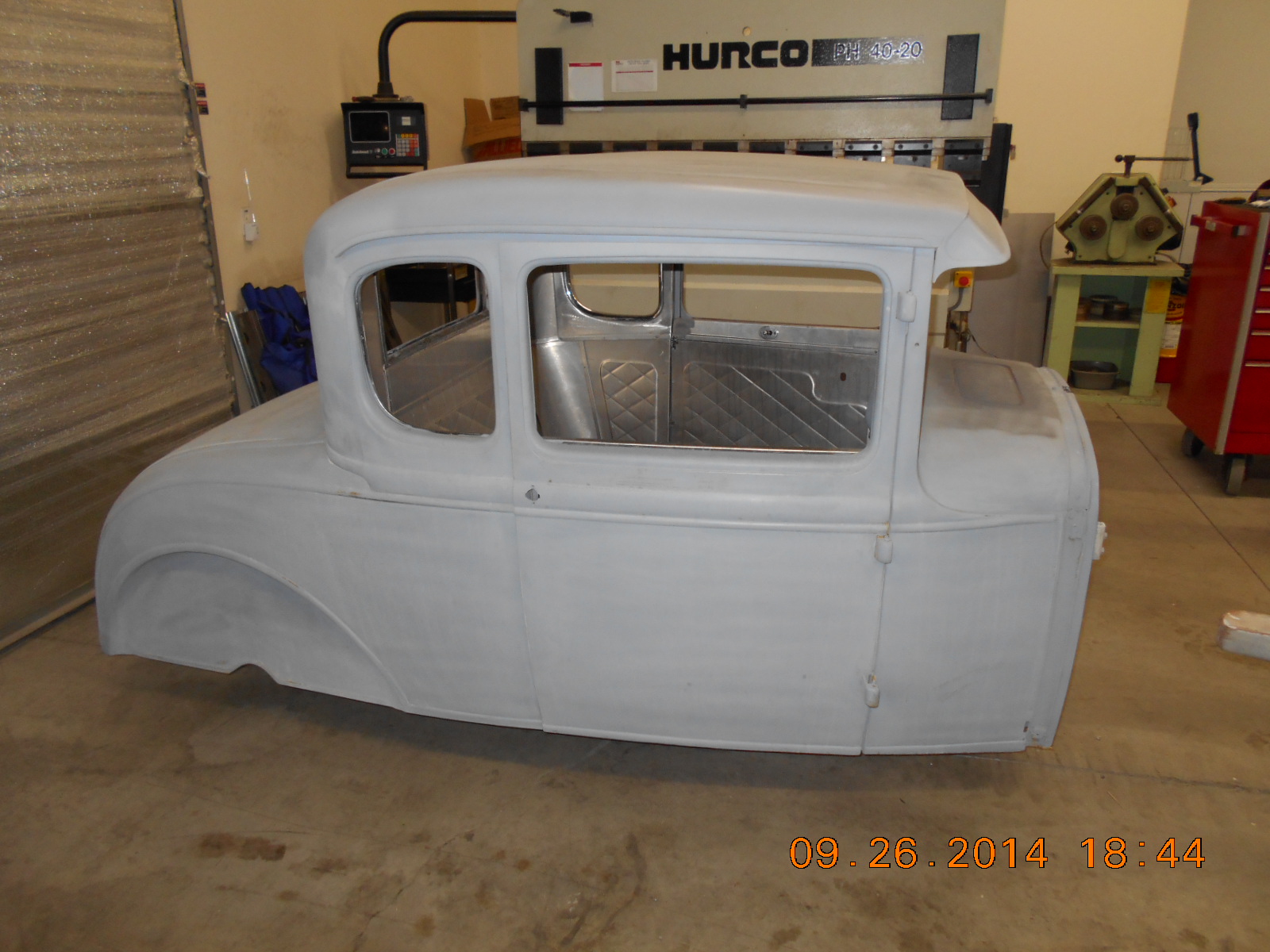

    Nice, notice the slice on the bottom. Bob
  2. lines look good Justin.
  3. Man what a kick ass build, very nice metal work too.
    -Chris
  4. Thanks!, yes I had to taper the bottom a little, should only be about 5/8th of inch when done.
    Thank you!
    Thanks man!

  10. Got it pushed out in the sun today, perfect timing too because I wanted to get a good view of the hood lines. Ill get more pictures up this week.

    Justin, Can you take a shot of the hood side and frame area? It looks smooth to me, not like a Rolling Bones build that has a bend 3/4 back in their '32 on '32 rails.

  15. ill try and get a picture for you. there is a bend in the frame just like the rolling bones guys do to there frame

    So nice to see you are making new top pieces for the hood, just adding to an existing piece never works. I can almost see the frame bend in that photo that I mantioned in an earlier reply. Bob

    Always good to roll them outside. Stance looks perfect. Nice job!
  23. Thanks Bob, Ya I hoped it would but there would have been to much slicing and welding that it wasn't worth it. heres a picture of the frame from early in the build showing the bends.
    Thanks Roupe!

    Thanks for that frame shot! The A bodies on '32 rails just look better to me, the bend is less drastic when you use the Spencer/Bones front setup. Bob
    laidout53 likes this.
  25. I agree, If I did it again I wouldn't pinch the frame. I would have started the tapper to the front from where the cowl is to make it smoother looking.

    Ok, That is good to know, '32 shell, stretched hood, and '30-31 cowl wouldn't need the bend midway under the hood. Bob
