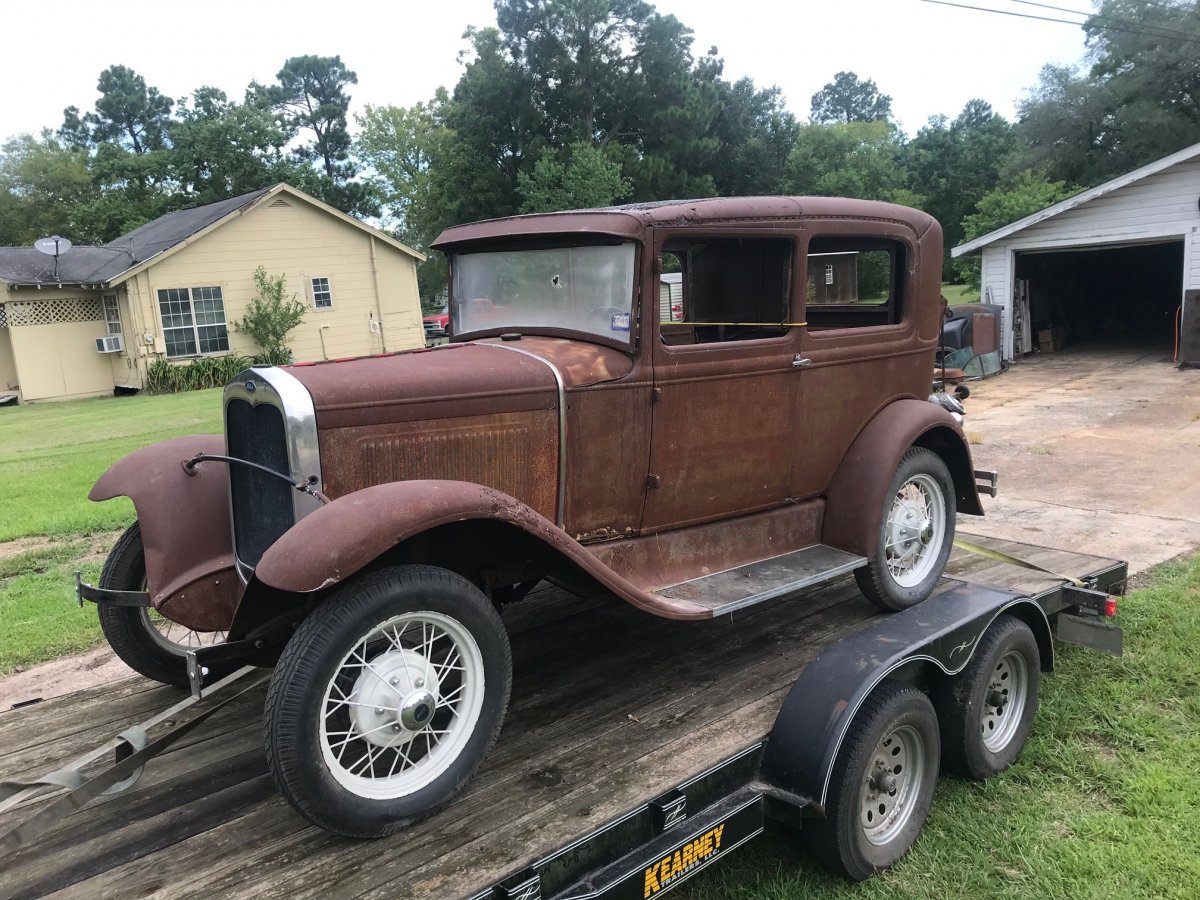

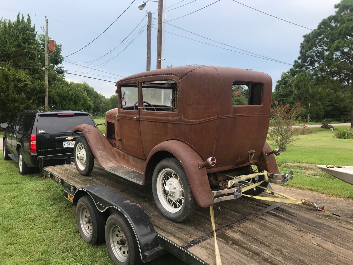

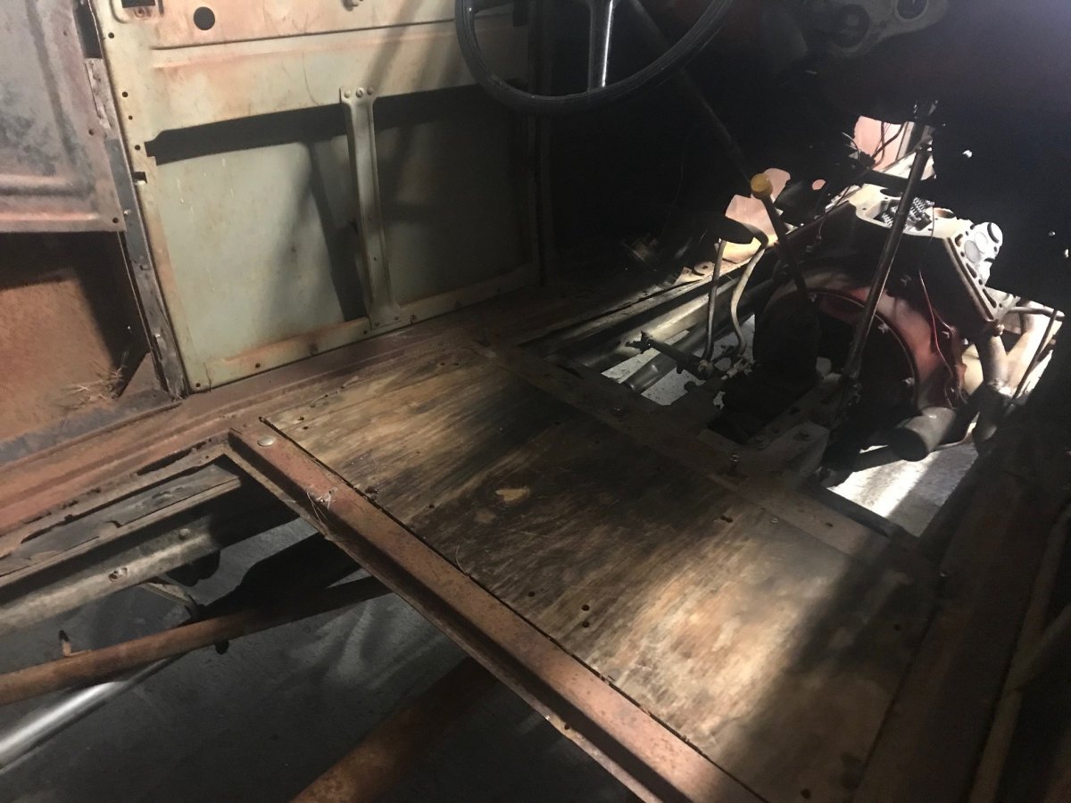

    So last week I changed gears, my drive for having something real vintage and cool came to light, After alot of soul searching, life searching, and some browsing on the internet I found a car that made me serious and made me pop this thing called life into 3rd gear flat footed. On this last friday I went to look at it and put money down on it, sold my 1953 bel air that I resurrected from the dead that night. Picked this bit of history up saturday. So here we are.

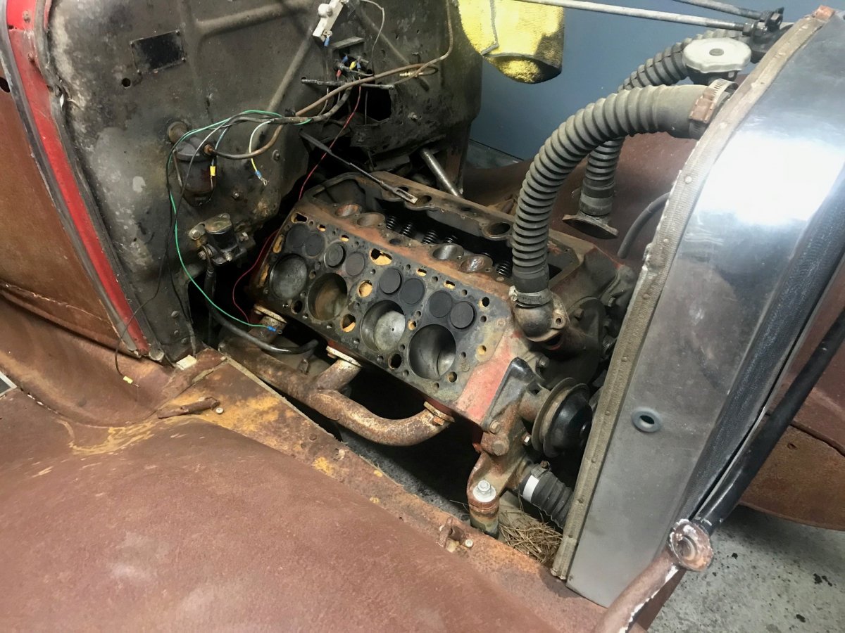

    And here is what makes it cool, its swapped with a 8ba already, all the work is old looks like it was done with a stick welder for sure. Not bad work, but still functional and looks like it will hold fine.
    Motor from all I can figure out is a 239 flatty. Guy said it was a 1951... and toploader 3 speed.
    Last driven in 2015 so should run again,
    So here is the game plan as of right now.
    Pulling the fenders off to make room to work on things easier, they will probably stay off.
    Lapping valves as one cylinder was lower on compression, might as well do em all for good measure.

    You might want to consider cleaning the oil pump pick up screen. Hate to see the engine fire but not get oil pressure due to a clogged pick up. If the 8ba has a truck pan with the large clean out cover its an easy job. If not you'll have to drop the pan. JMO

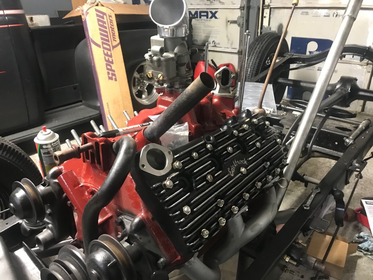

    So lapped all the valves for good measure since I am waiting on head gaskets... fat fingers in that lifter galley sucks.... But some progress, pulled the fenders off to make work easier, kinda digging the new look...... Hmmmm.
    Mating surfaces cleaned up ready for heads, and new posies super slide spring installed, lowered this thing alot just by a spring...sourced some backing plates locally and few other small pieces for the front brakes. Ordered some new pieces for the brakes as some of this stuff was worn out, but shoes look stellar.
    How about some crusty headers?

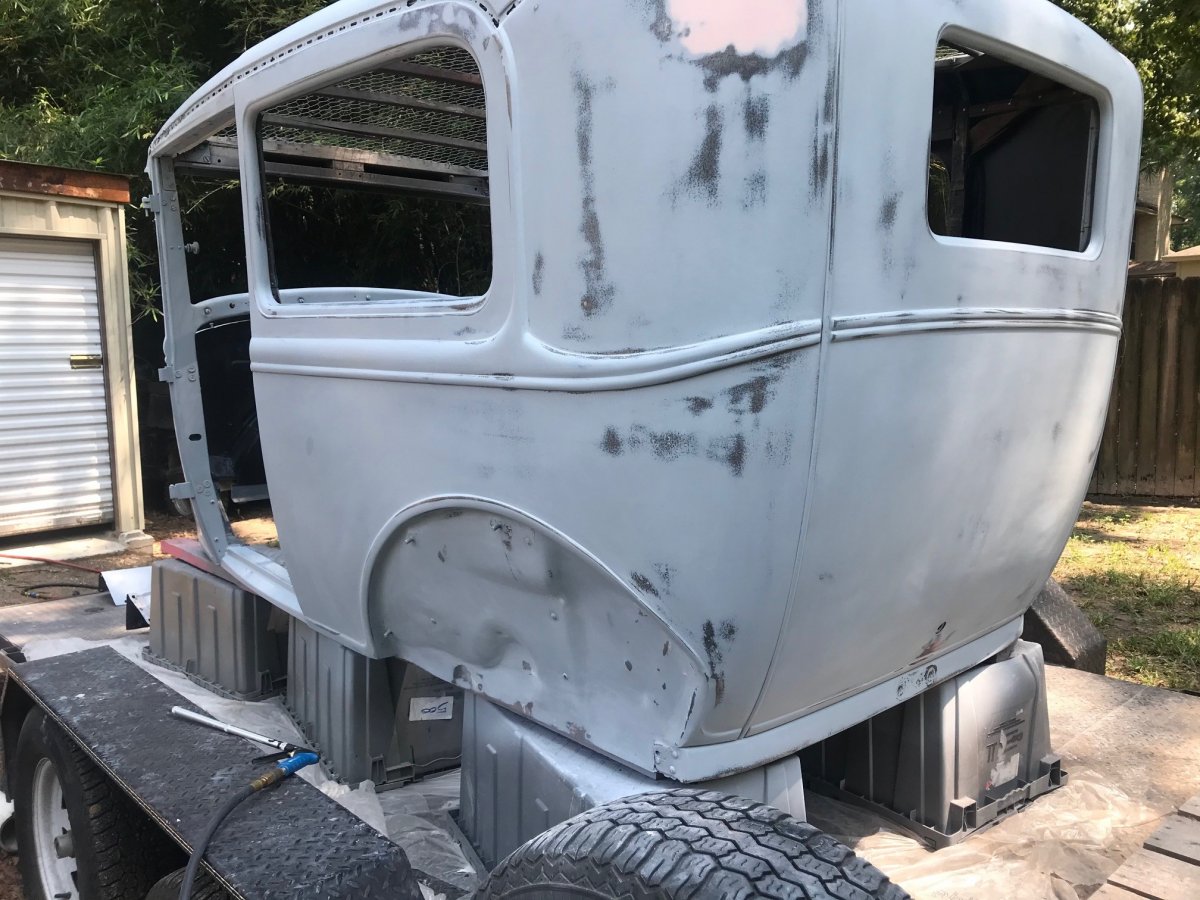

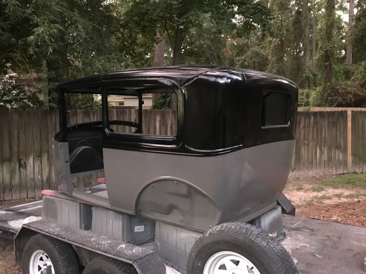

    So after a week of slave labor.... Lost 4 lbs sweating in the 90 degree weather but here is where we are right now.
    Working on buttoning up the chassis right now... Motor is burgandy but in my shop the lights make it look red... uggg... But you get the idea... 31-27.jpg
    So here was a week of body working, come together and done.
    Backyard painting just like it was done back when...
    Here is the finished product, letting the enamel sit and cure before wet sanding and buffing.
    Its been alot of work to this point, the last week tried my patience and sanity for wanting a shiny car but we have it going in the right direction I think.
