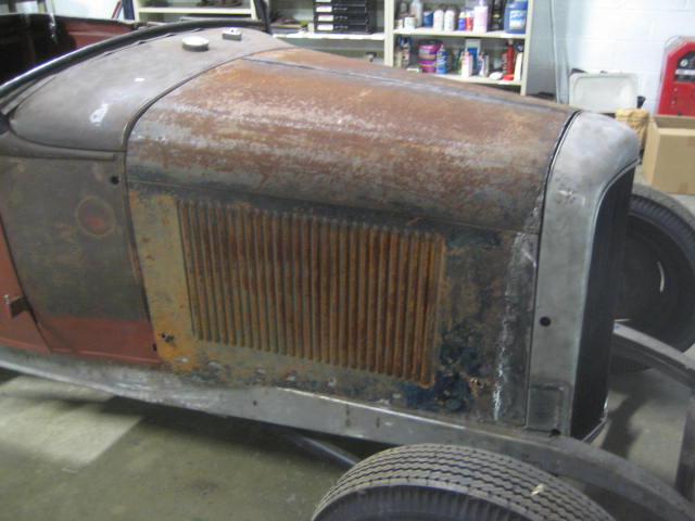

    Found a hood that somewhat works as the stock model A hoods are 4 inches too short. The hood was off a Packard (subject to verification from the HAMB) and didn't look all that close to working. The side panels really hit the mark, so I decided to go for it. I really liked how the side panels had a sort of dip to them in the rear that could be made to mimic the '32 rails.

    Here is after a half day's struggle:

    Finally got the hood sides to fit:

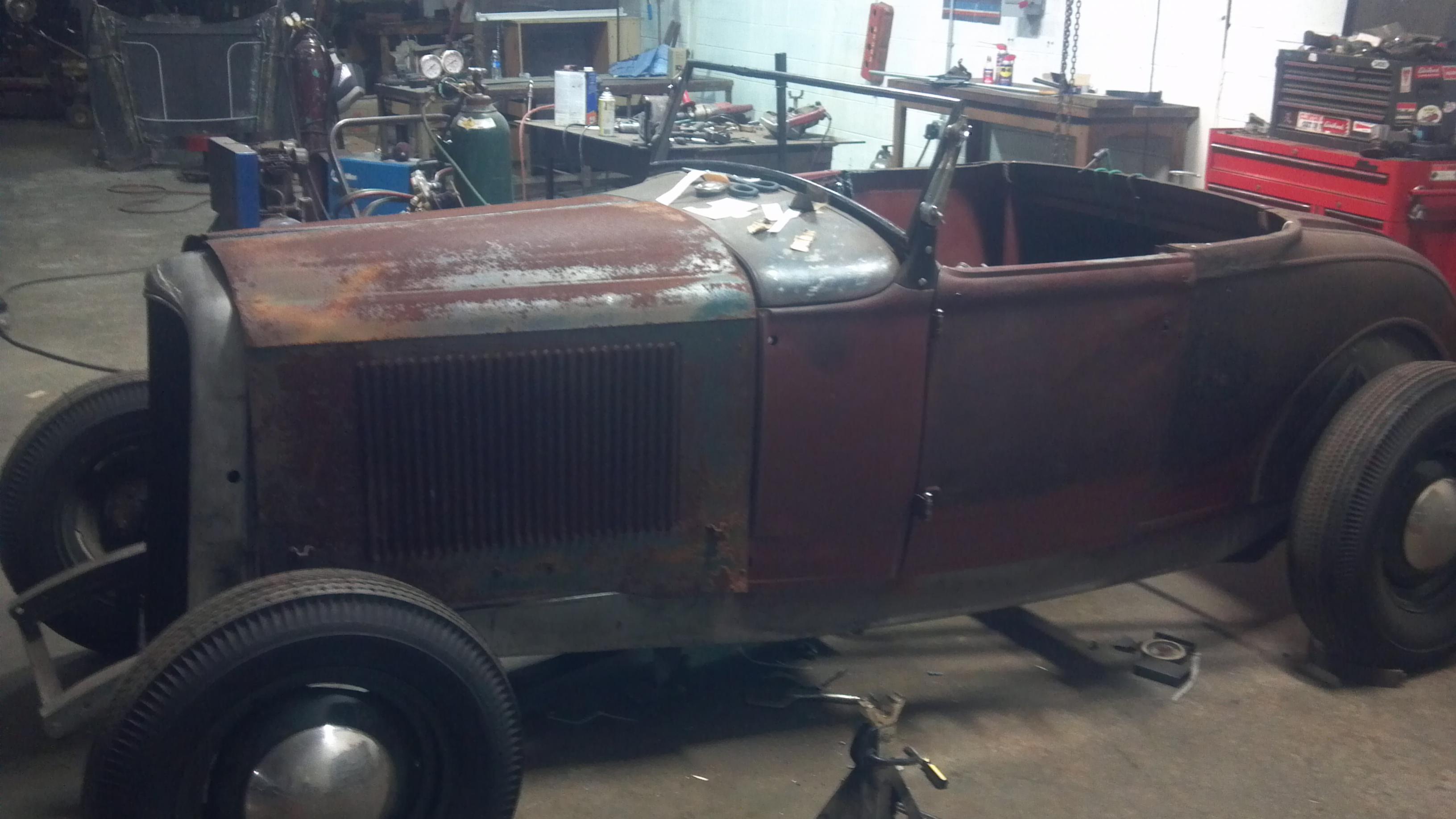

    And here's a few I took last night as well. totally blown away by this car, it's perfection really. Stance and the 2" added really makes it for me....

    This is a very nice build. The added 2 inches does a world of difference for the body.

    Wow, I really really love the proportions of this! It's like a '32 but doesn't look so chubby. Great work.

    Looking great Curt. Lke everyone else said the 2" reverse section did so much for that car.
