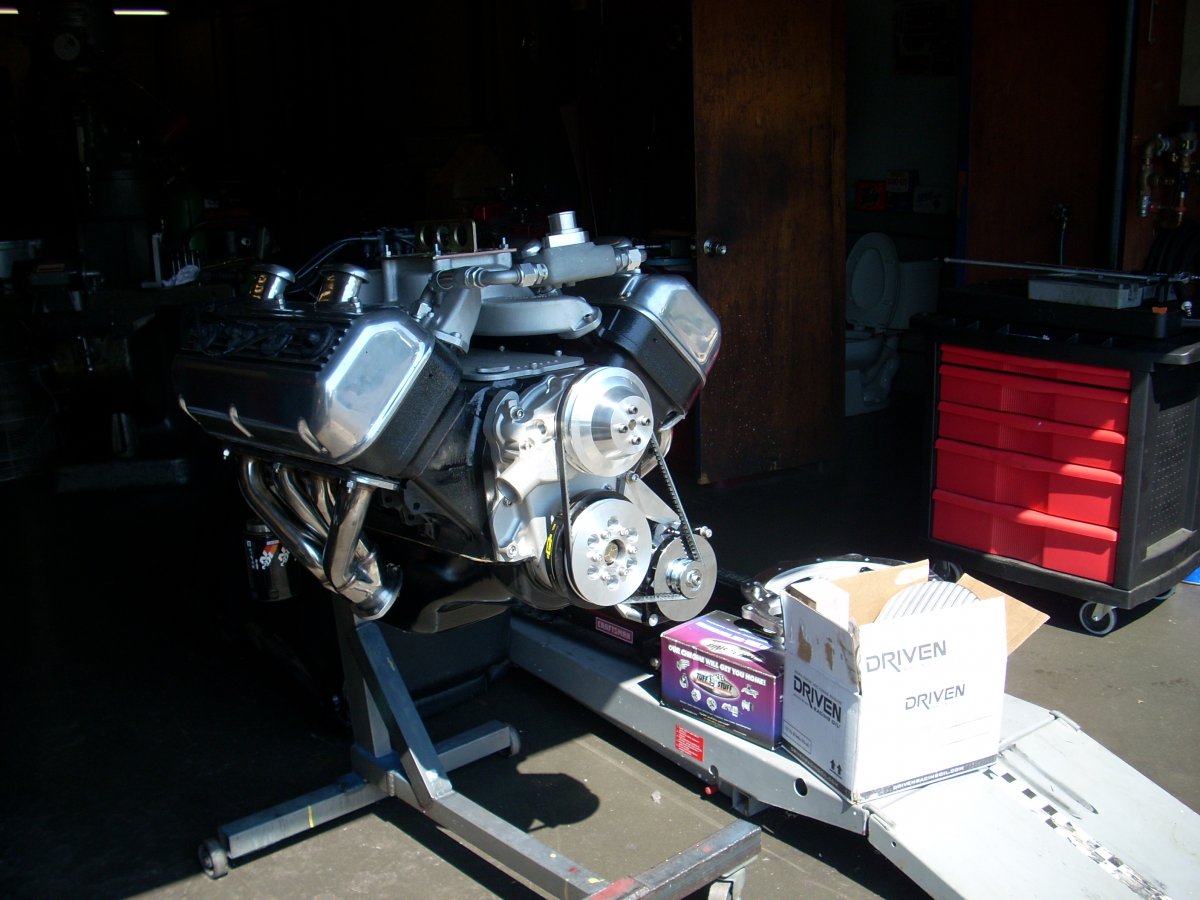

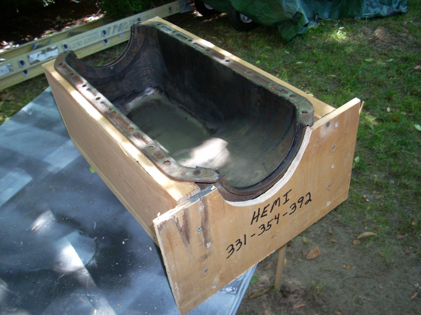

    DSCN0778.JPG I made an engine cradle to pickup the built hemi soon then off to the dyno. (Hopefully next week). I marked up the motor mounts today and went through a bunch of boxes of parts from when I had to clear out all my stuff from the shop (in 2days) that went out of business that was suppose to do my chassis.

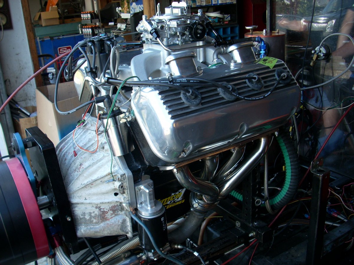

    I picked up the built hemi today and I'm really happy with everything Dana and John has done. I brought it over to Dennis' shop for the Dyno, Hopefully soon. I couldn't use the wood engine cradle It wouldn't fit between the headers and around the alt. so maybe I'll get another motor to put on it.
    Added some recent photos of the engine.

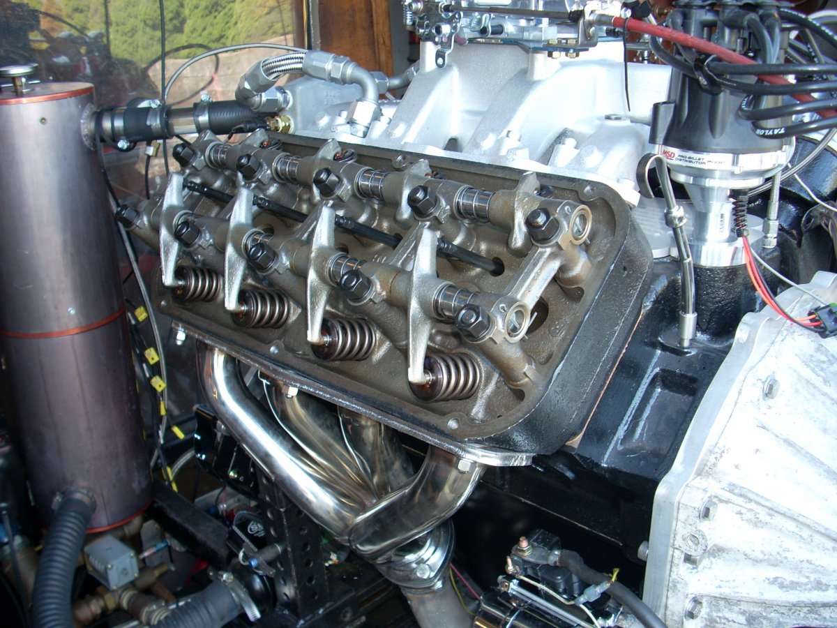

    331 hemi was hooked up to the dyno today and broke it in. Had a couple of small issues. It took a very long time for oil to reach up in the heads, so the valve covers were pulled off and all the moving parts were oiled by oiling can and run until oil came up through. Pressure was over 60 lbs. Small water leak from the bolts holding the timing cover where the alt. bracket was bolted. Going to run it tomorrow to check the hp.

    NO dyno. Going to replace the mystery cam. Doesn't idle well, may have too much lift.

    Brought the engine back to the machine shop. So far he found an oil plug near the distributor that had a hole drilled in it. He's going to recheck the valve to piston clearance. He already checked it with a scope and found no problems. Anyone want to suggest anything i'd appreciate it. ty

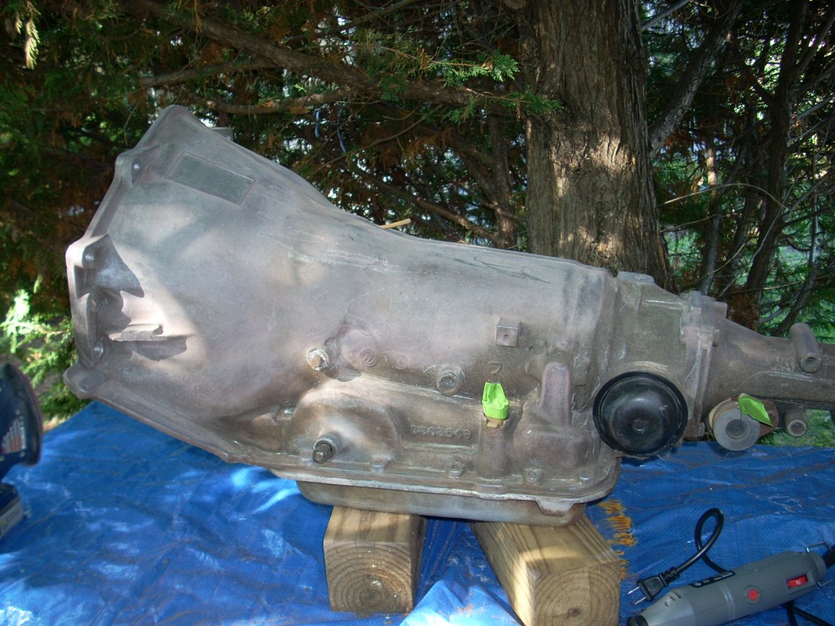

    I moved the engine forward to avoid cutting the firewall and removed all the little screws and such from it and cleaned the tranny and painted it.

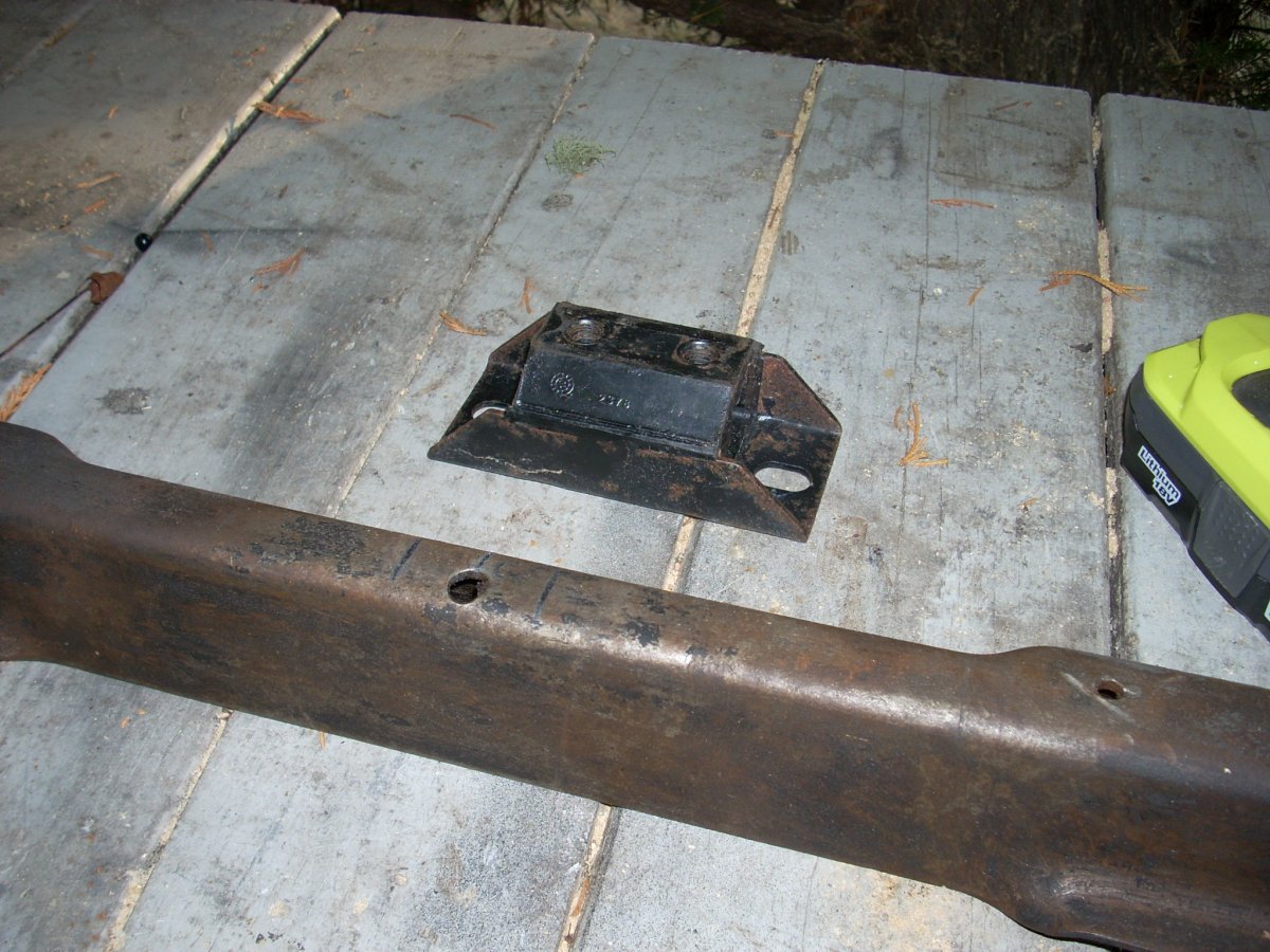

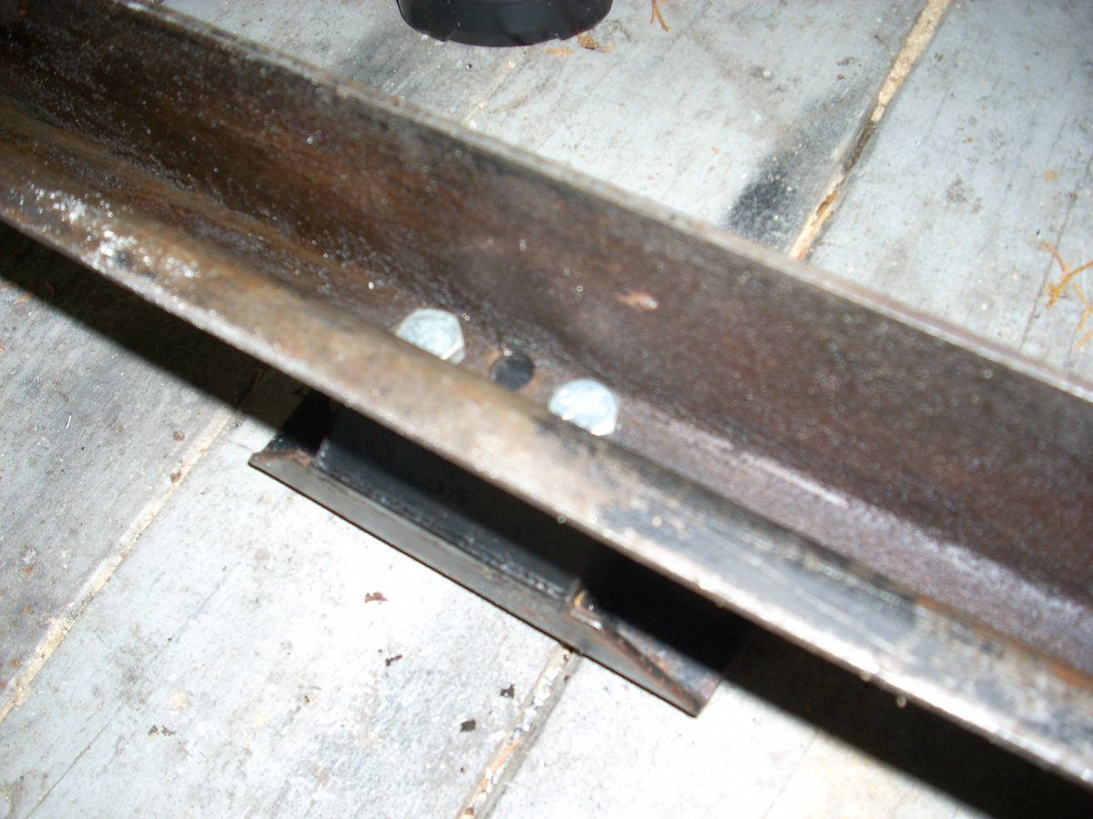

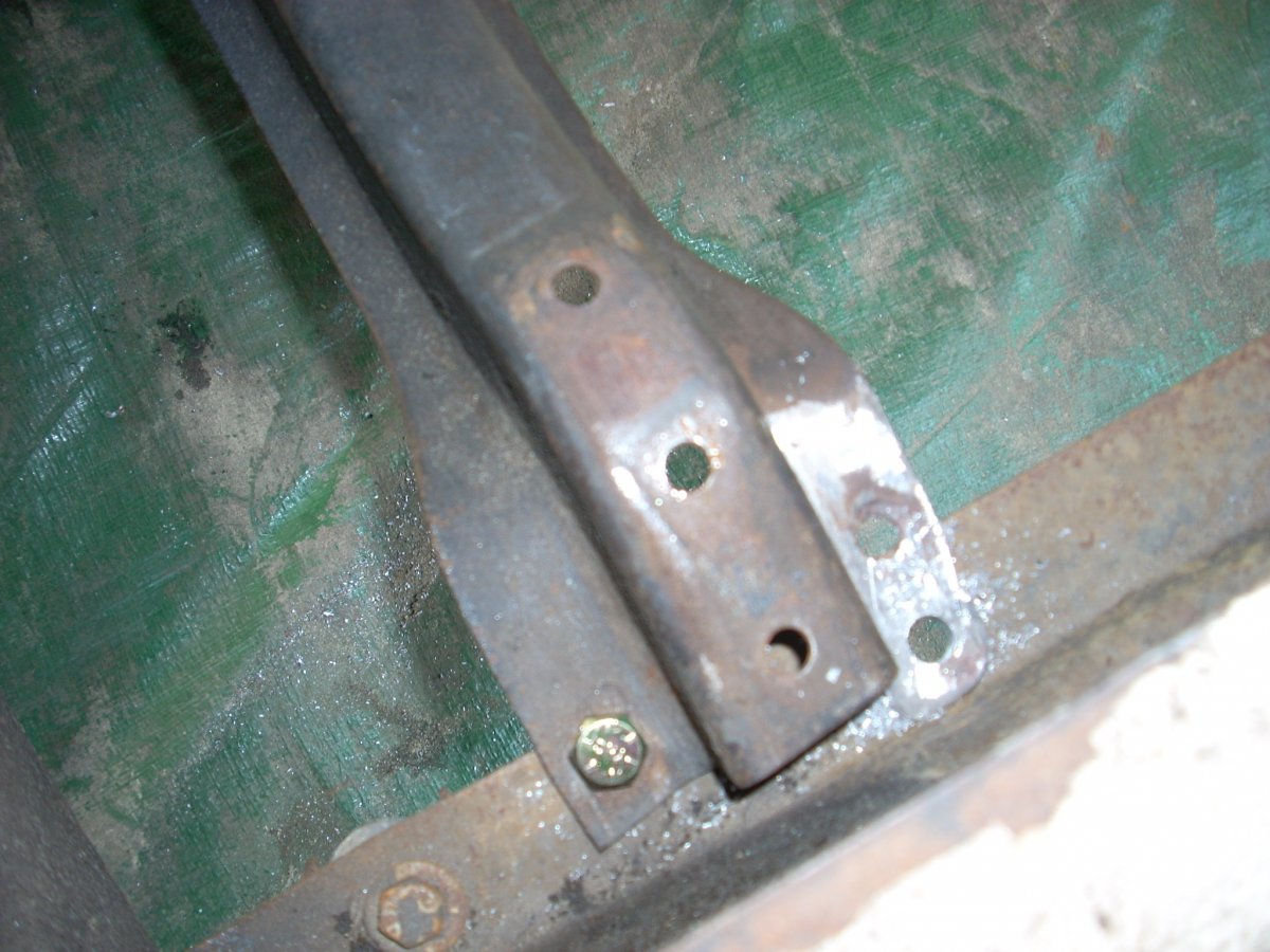

    I couldn't configure the 6 gauges the way I wanted so I ordered a turned gauge insert from Hoodlum. The crossmember ends are on angles so I need to add an inch or so of metal on 2 of the 4 holes to bolt to the frame and I drilled the center for the new tranny mount. Soon I hope to start filling in the holes on the firewall and fit the kick/front floor/tranny tunnel. I bought a wire welder (H, F) A friend of mine recommended I heat the metal first (torch) before welding. Hope I havn't lost my touch. Its been over 25 yrs since I've welded and I mostly used oxy/acetylene braze back then.

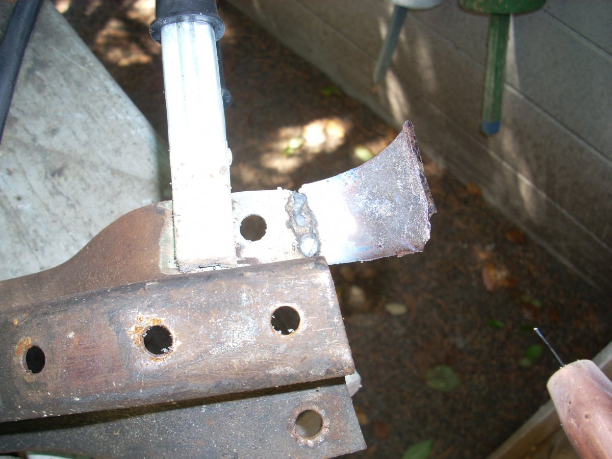

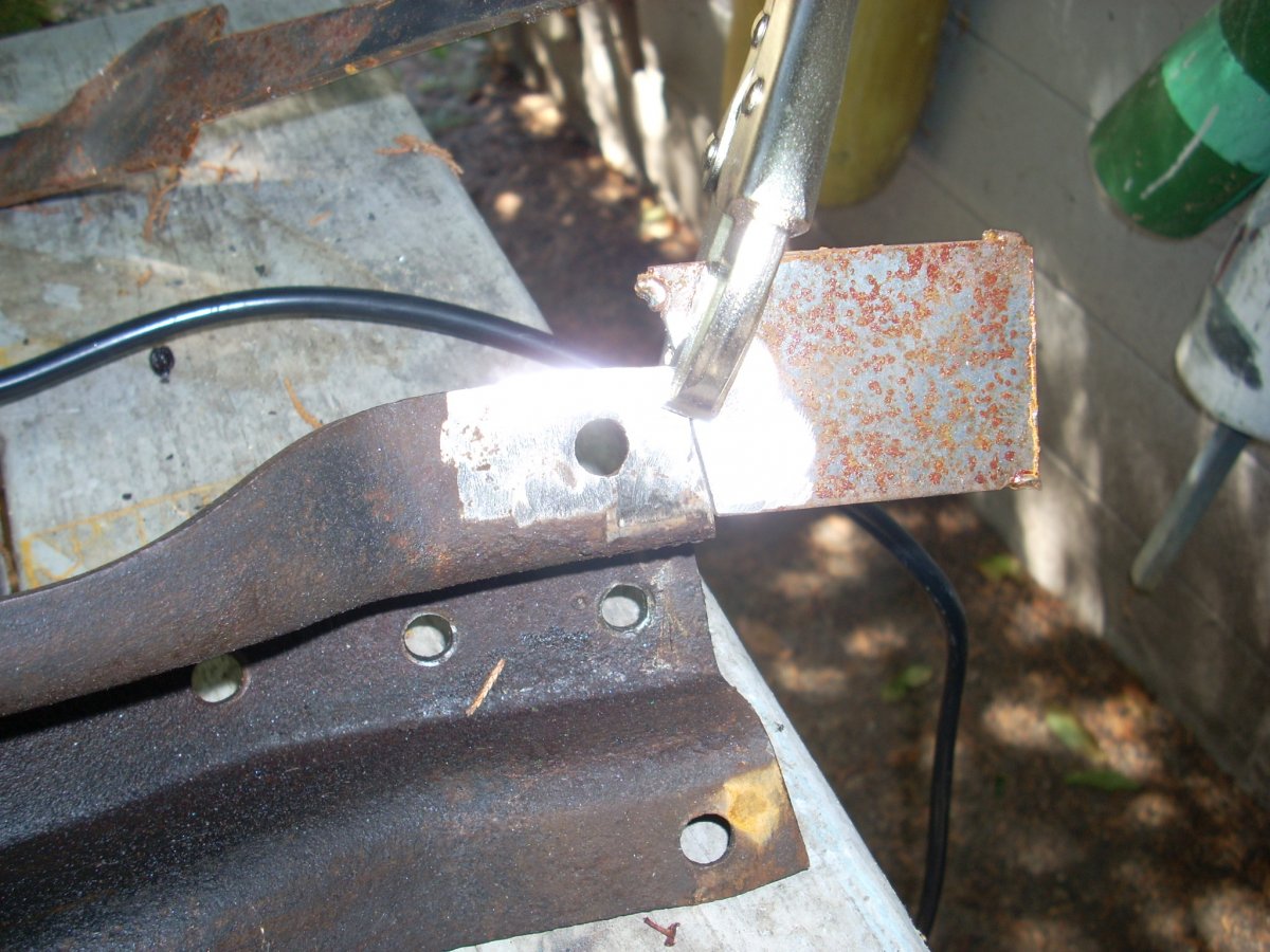

    Worked on the crossmember today adding some width to it. The welding went better than expected. I suppose I didn't forget everything I learned in high school. I also disassembled an original taillight stand I got from Dodger for the right rear of the car so i'll have a pair. I soaked the screws with pb blaster but ended up using a cut-off wheel. Now I have to find the new reproduction taillight n lens I got from Dave at Dodgecity.

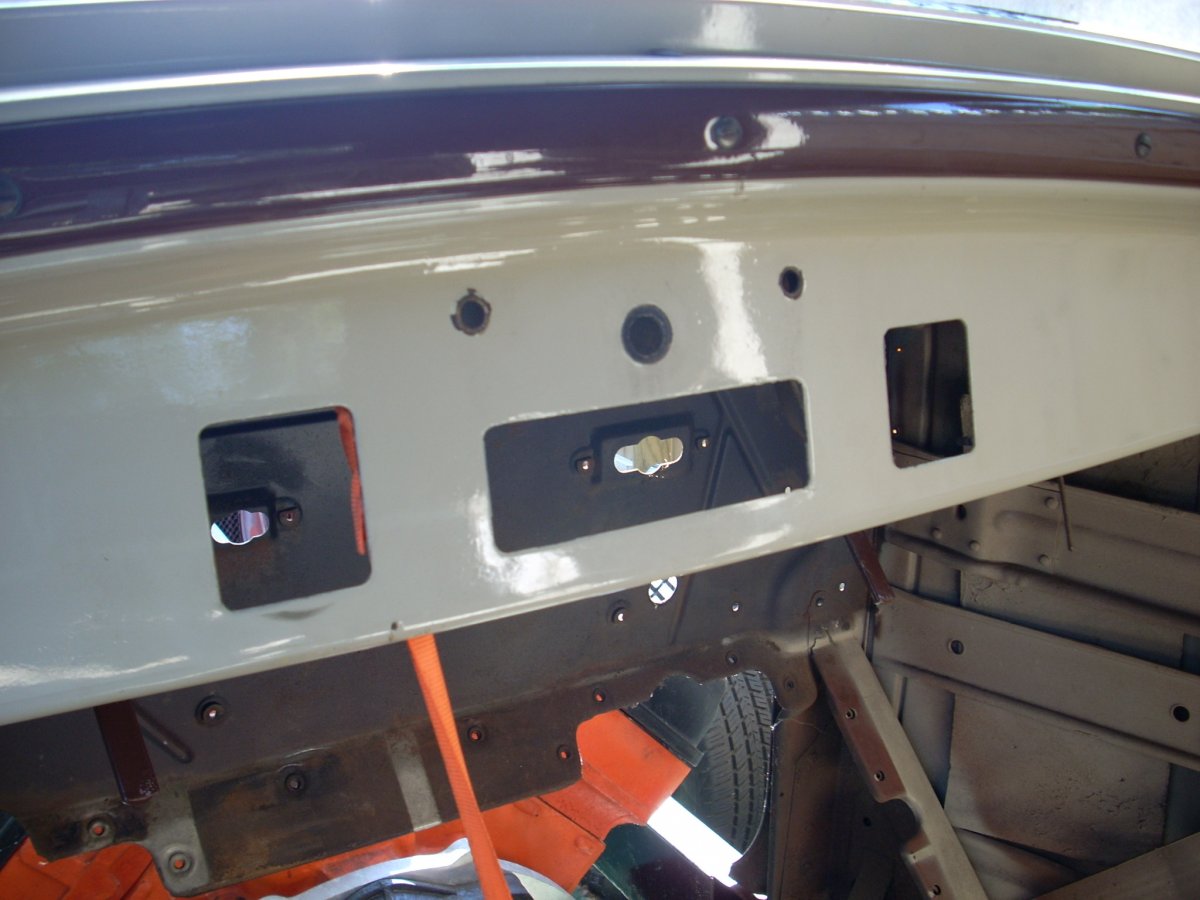

    I was able to do a little more today. I hung a header and used a piece of 1 inch pvc in place of the steering shaft and I will be going under the motor mount probably when I get to the steering. I grinded the holes on the firewall in prep. of welding them closed but I will run some bolts through some of them first and weld them as my friend Jim encourage me to do so I'll have a place to bolt to under the dash.

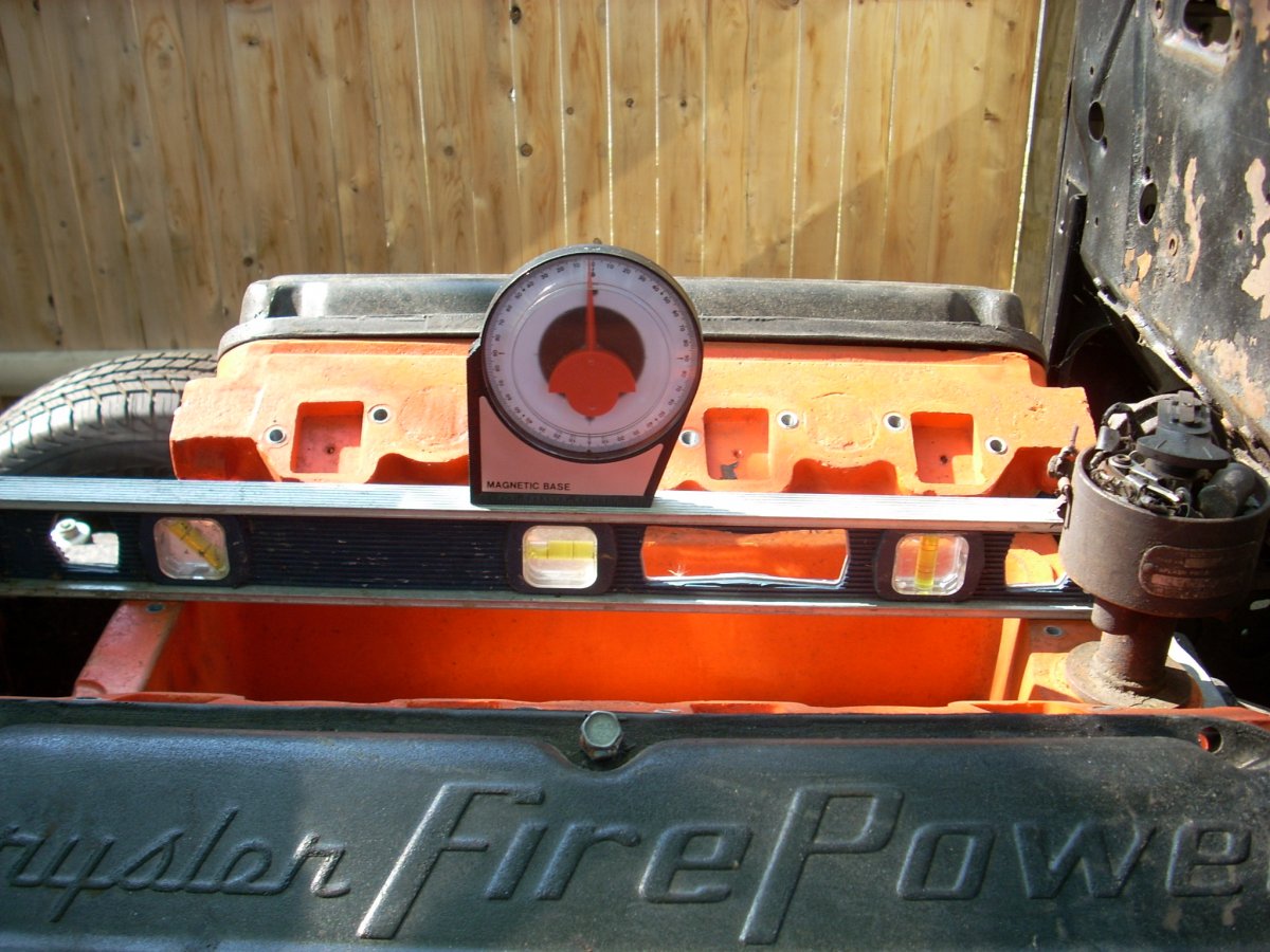

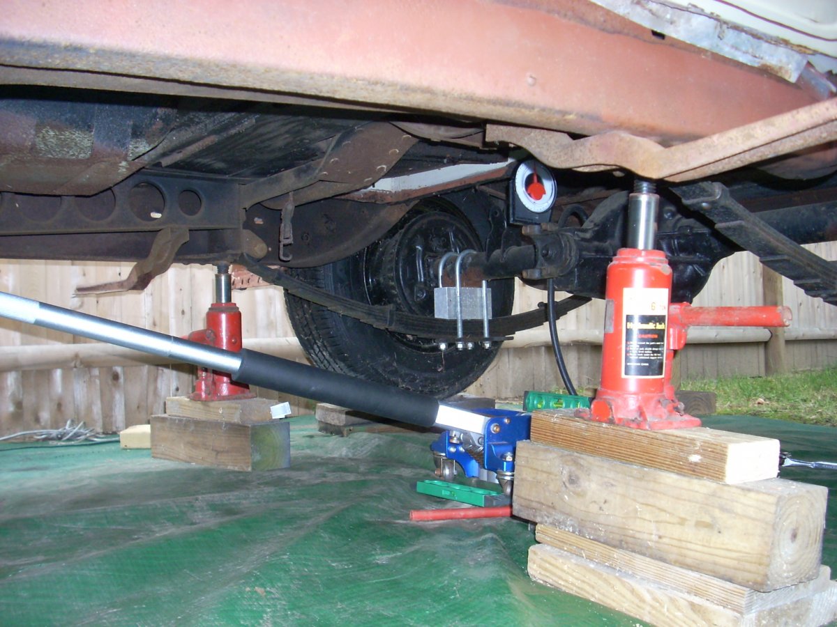

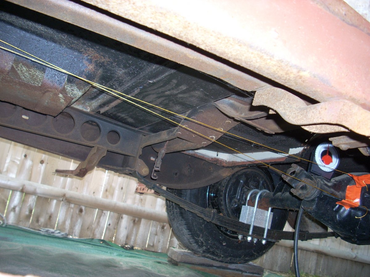

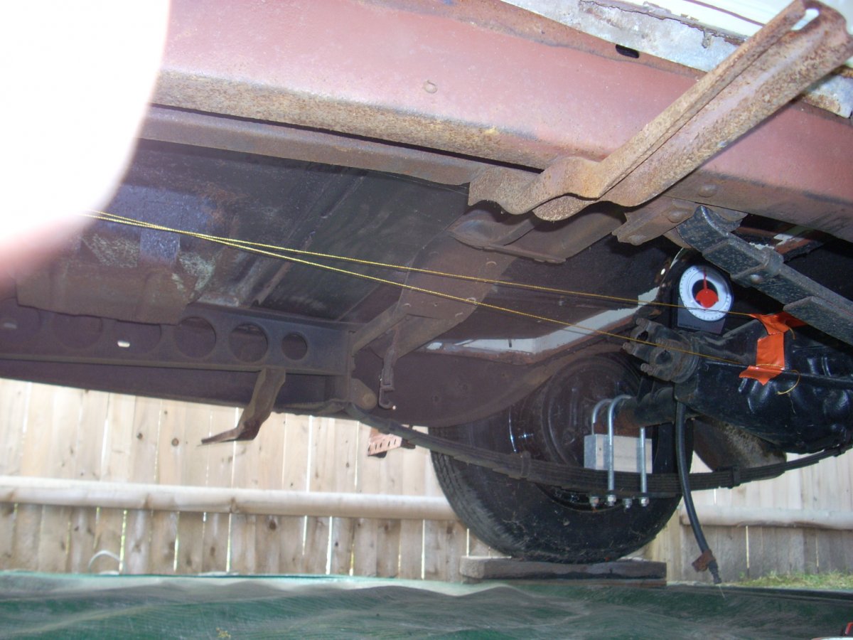

    Finished drilling out and installing the transmission crossmember today. Now I'm trying to get the right angles between the transmission and the rear end but I'm not quite getting it. I read all the posts a few times but for some reason I'm not there yet. I ran stringers to check the angles. I have the tranny down 3 degree and the rear end up looks like 7-9 so the bottom stringer from the rear end crosses the upper one from the tranny 3/4 s of the way toward the back of the tranny. I don't want to tack weld the spring pads until i'm sure its right. Should I point the rear end down? and how much?
    I would appreciate some input ty.

    I had a good morning. Thanks to FJ for a detailed explanation of driveshaft angle and another big thanks to 31 Vicky for a simplified clear version.
    I jacked up the frame to take the weight off the rear end, then was able to tilt the rear end easily to the angle needed placing the gauge in the yolk straight up n down. It is now just about where it needs to be. I will check everything again before tack welding everything in place. While I was working on the rear end I figured it was a good time to contour the lowering blocks to match the leaf springs.

    I began trying to fill in the holes in the firewall but didn't get very far. Its been raining (seems like everyday now). On a more positive note, I believe I have all the parts now to get the car together and drivable except for the wiring.

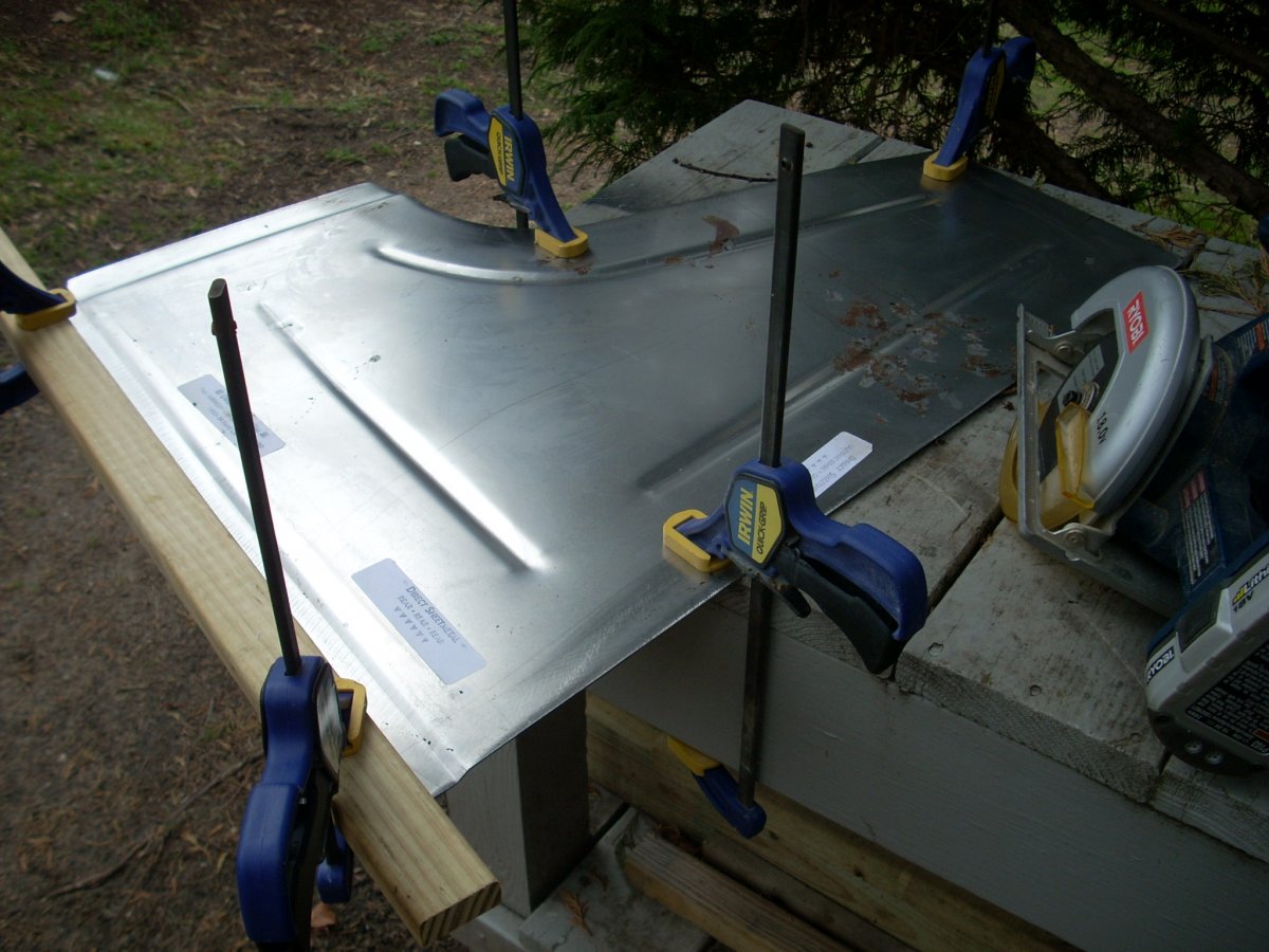

    I started fitting the template of the front floor. The next job will be to layout the metal and trans. tunnel, mark it up and cut it. I'm hoping I'll be able to reuse the bolt threads around the floor.

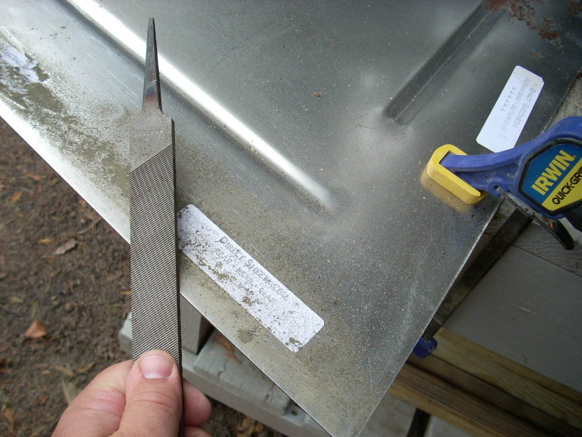

    I've continued on the floor measuring cutting. Those edges get really sharp so I filed them a bit.
