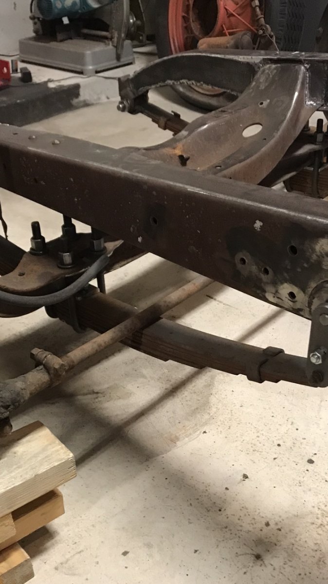

    I have a 31 Chevy 2 door sedan that I am building (build thread to come at some point). I have the front suspension bolted in and now need to notch the cross member for beam clearance. How much space should I leave between the beam and cross member for travel? With no engine installed and the frame holding its own weight, I was thinking 4" minimum distance from the frame to the axle would work, however I am not 100% sure about that number.
    The front end is a solid axle from a 1952 Chevy half ton truck. I am using stock 1952 springs with two leaves removed. I flipped the axle to sit on top of the springs. I have a 283 and three speed for the engine which is not installed yet to give an idea of engine weight as a factor.
    See the photo for how it currently sits. This is still work in progress. I need to trim the u bolts a bit but that will come later.

    Right now it seems you have a couple inches of clearance, with no engine or body weight on it. I'd guess you will need a six inch notch through those frame rails.
    The engine will lower it an inch, the body another inch, and all the rest of the car another inch. How much clearance is left after those three inches are gone?
    (All measurements are estimates because nobody has exact data for somebody else's project)

    I agree with the 3" of settlement once fully assembled, so after that, how much should I expect this to travel...maybe 2" more, then add an additional 1" just in case? So in summary, 6" from current location? That makes sense and seems realistic. I know this is hard to give exact info but I want to open up my plan to others to confirm I am on the right track.
    It's hard to see in the picture so I added another that is zoomed in. Once I trim the u bolts, I will have 3" clear from the frame to the u bolt. The axle has about 1.5" clear to the cross member. I have some HSS tubing that I will cut the bottom out to make a U shaped member. The plan is to notch the frame 4" and carry that out through the cross member which hangs lower than the bottom of the frame.

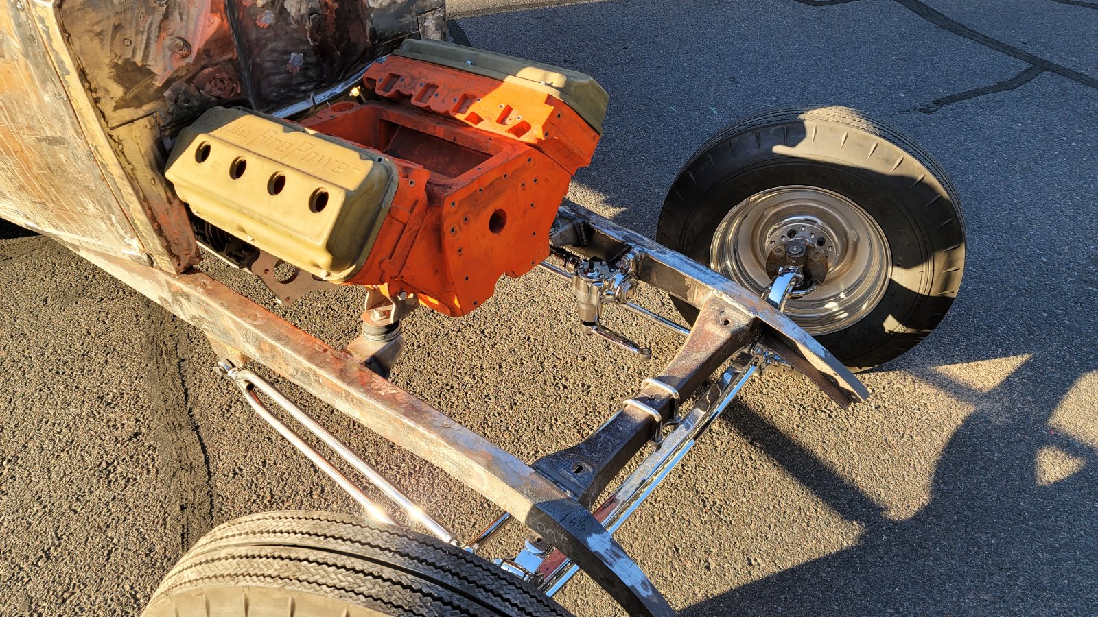

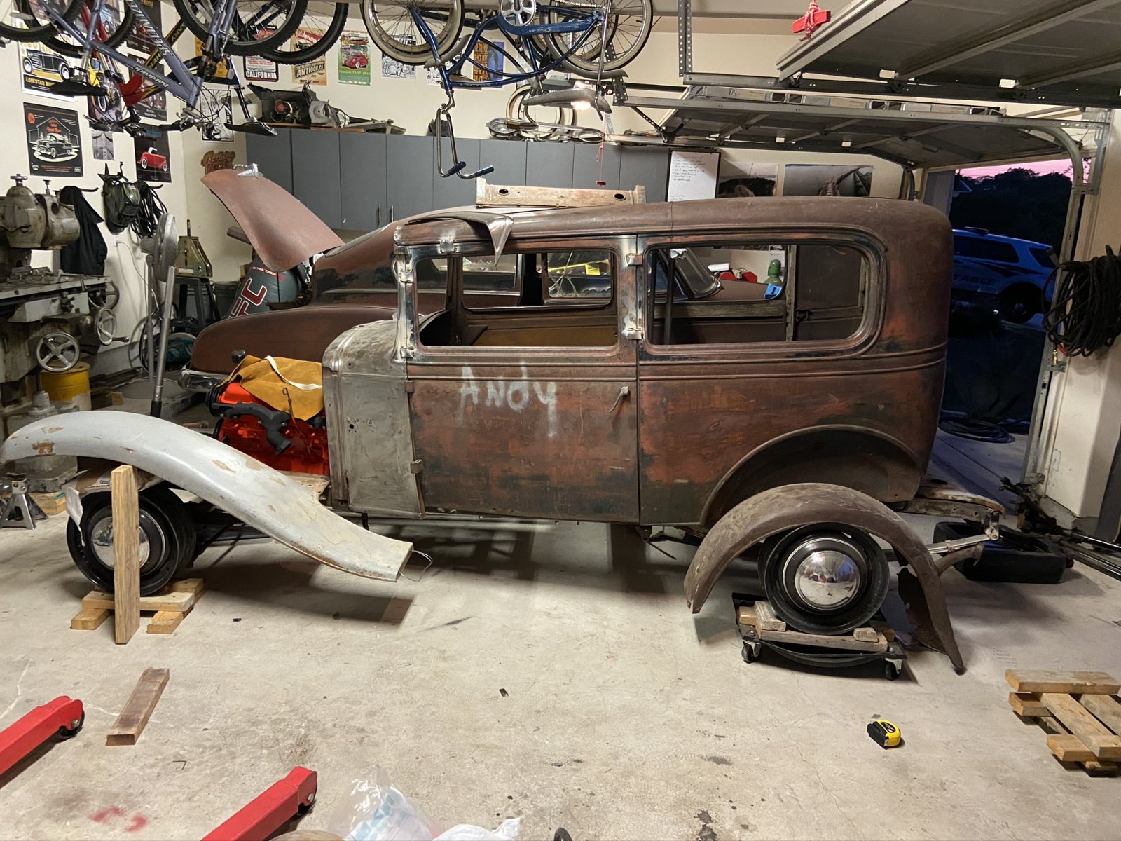

    I am building a 28 Chevy roadster with a 49 Chevy 3100 axle and a 331 Hemi (build thread coming soon). I have 3 inch axle drop by nostalgia Sid and left the axle under the spring like stock. With that heavy motor and no fluids, I have 4 inches of clearance to the frame. I might pull 1 leaf to get a little more drop but going less than 3 inches of clearance is pushing it in my opinion.
    Obvious statement but check the scrub line going axle over spring.
