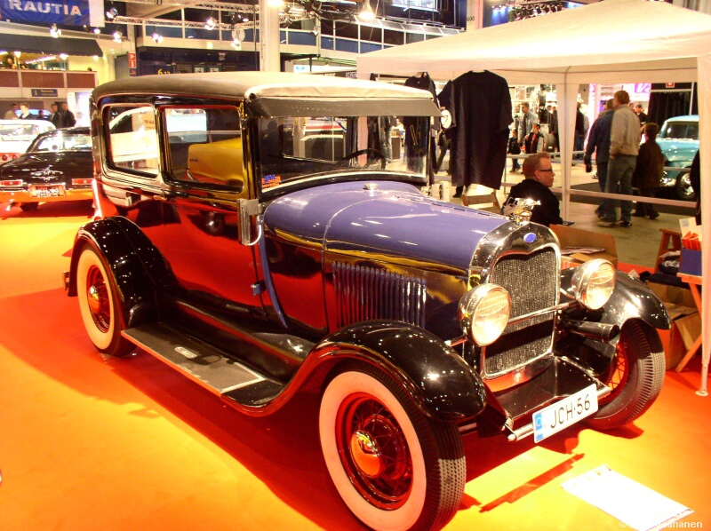

    If you're going to use fenders it takes much more planning and measuring than fenderless car does. Wheel width and backspace, tire widths, brakes, axle length all have effect to total tire outside to tire outside distance.
    I have done many A's all different and all with fenders. I like my front wheel center to be at the highest point of the fender and rear tire sidewall to be at or little out of the fender.
    48" front axle works if the wheel is narrow or has more backspace and brake is narrow or the 46" axle is good with wheels with small backspace or wider brake.
    About 56" wide rear axle is good for up to 8" wheels with stock inner wheelwells.
    I have used late fifties 9" and 8" axles from Mavericks and Granadas. Early Nova 10-bolts are close to that width too.
    This car <- has Heidt's Superide IFS with 15x6, 195/65-15 and 16x8, 265/65-16 on Maverick 8".
    If you're after old style search Hitchhiker's coupe build. IMO it can't be better.
