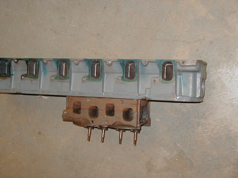

    Ford Australia does indeed have several itterations of crossflow cylinder heads - but none of them will fit the big 300 six. They are for the smaller 144 - 250 six (about 3 inches shorter) and are not good for the 300. Mine is a rare cast iron factory experimental prototype.
    I am a retired Ford engineer - I worked in the Engine Performance Development Group - and as such I was able to convince the SVO guys to let me have one of these heads, which were originally developed for improved emissions and efficiency, to try it out as a candidate for the SVO Performance Catalog. The reason I am rather tight-lipped about the head is every time I mention it I am deluged with requests to "get me one".

    Here's a typical Aussie head - an aluminum, canted valve, crossflow two-valver:
    and here's the 300 iron head. Note how high the ports are raised vis-a-vis the stock head and the crossflow design vs U-flow:
    stock sectioned head:

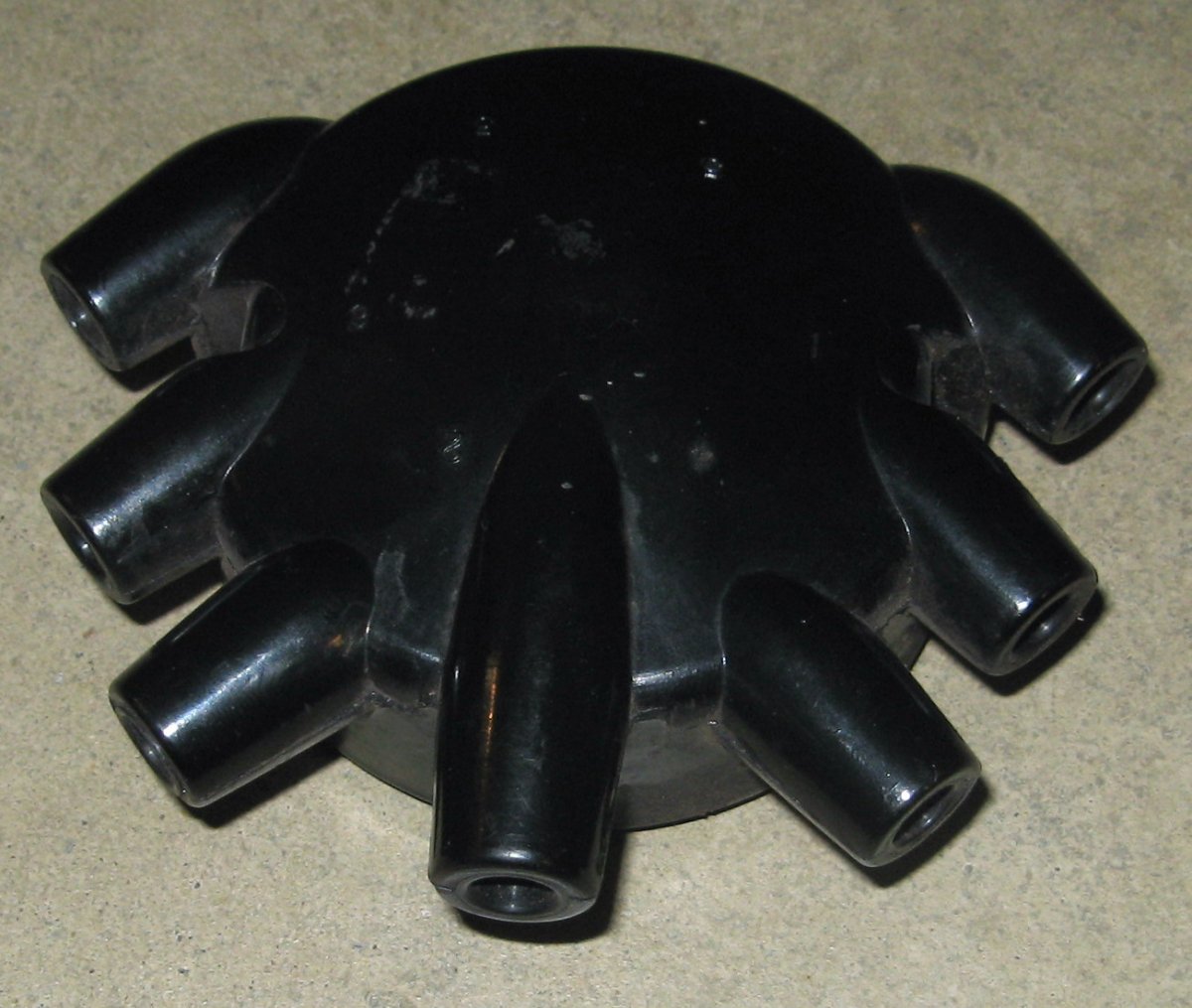

    dist cap 01.jpg distmount 01.jpg dist cap 01.jpg I found a nice crab-style distributor cap last weekend. I plan to mount it on a dummy distributor off the end of one of the cam towers. It is a six cylinder cap of unknown make. Anybody have a clue as to what it originally fit? I made a simple base for it and will run a cloth covered wire to it and maybe an external brass capacitor a la Mallory.
    Originally I was going to use a flattie cap, but this one works better (Thanks Jacin, I'll get your flattie cap back to you at the Thopmson Gasser Reunion). I may have to blister the hood to fit it in there. Or just mount it on the rear of one of the cam towers. We'll see.

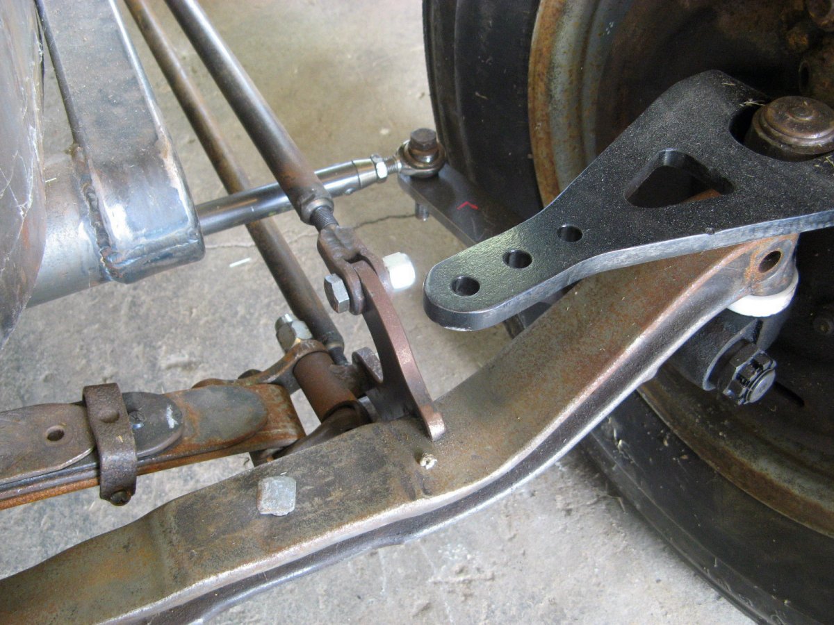

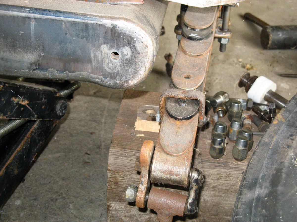

    Thank you for your interest and support. I've turned my attention back to this car and will allocate more of my time to it. Yesterday I disassembled the front axle assembly and cut up the spindle steering arms and lengthened them so they will clear the hairpins and leave me enough room to add a panard bar in the front. I also want to make my own lever-arm shocks - I added a weld nut inside the ends of the front crossmember so I have a place to bolt on the lever arms.
    I have a few car builds going on at once but something about this one makes me giddy with excitement every time I turn to it. Maybe it is the uniqueness of it. Dunno. But I'm likin' it.

    Here are shots of the modified steering arms and shock mount hole:

    I fitted up the spindles, made a new tie rod and mounted the "distributor" off the cam cover:
    Now I can mount the steering box, make a drag link, a front panard bar, and lever shocks.

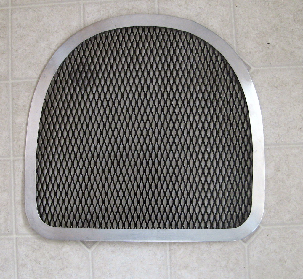

    Another silly little detail job - a stone/mud guard to go in front of the front axle. Most stone guards were crude "chicken wire" affairs. I made this one and ran it through the beader to offset flange the edge, then powdercoated it black and put a brushed aluminum framework around it. I'll stencil the car number on it later.
