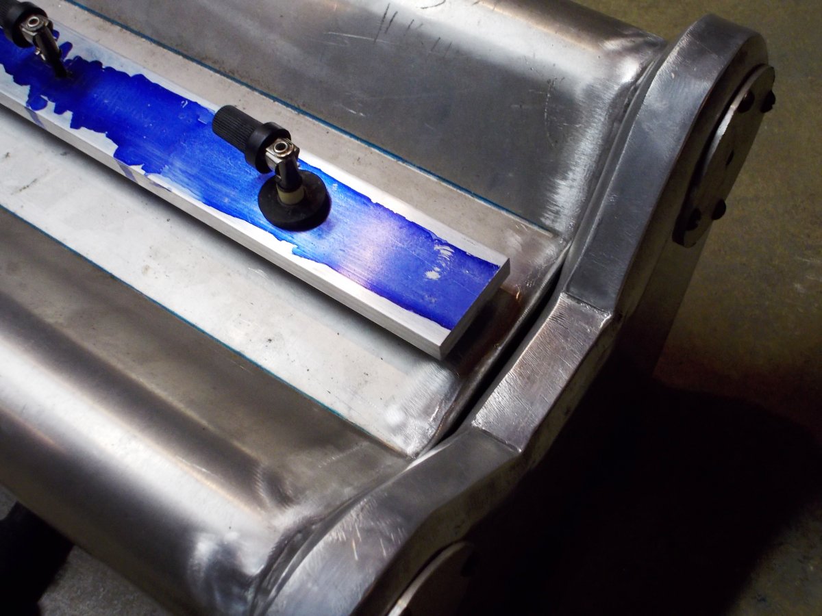

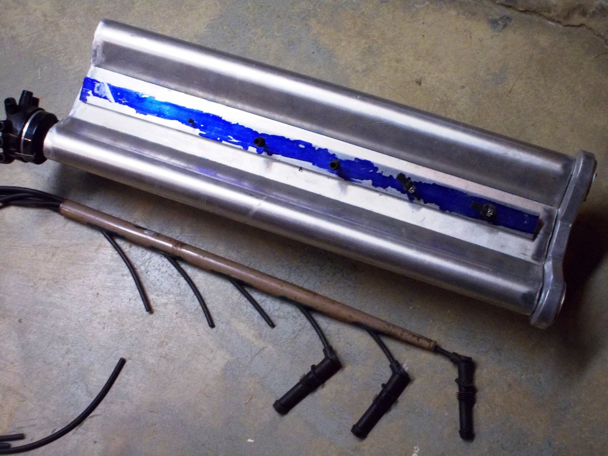

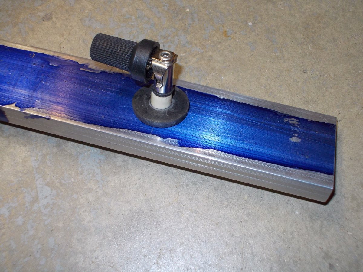

    I made another bit of a trompe l'oeil detail intended to place the spark plugs between the faux DOHC cam covers.
    I smashed six spark plugs to get the center electrodes out. Cut them down and threaded the end (10-24) so that they would screw into a flat piece of bar stock. That will in turn be bolted to the cam cover using the plugs protruding out the backside of the bar stock. To add realism I used a piece of white plastic (the outer tube from a BIC ball point pen) to simulate the plug porcelain and added a rubber grommet to cover the plug well. Rajo clips will be used into the plug wire bundle going back to the distributor.
    spark plugs OHC 01.jpg spark plugs OHC 02.jpg spark plugs OHC 03.jpg spark plugs OHC 04.jpg

    The manual distributor advance will make the car a bit more authentic to the era. I think I'd use a choke cable to adjust it -- should stay in any position. Adjusting advance while driving is definitely a "lost art". That hasn't been done since... what... the last model T???

    That's a good idea farna. I'll make a better looking lever for the distributor and even if I don't employ it to start the car it will add a bit of authenticity. Thanks
    On my hi-compression race motors with a locked advance I have a mag kill switch next to the starter button so I can spin up the engine before energizing the mag. Maybe I'll add one of those switches too. Most of those race car dash panels were pretty sparse - some only had an oil pressure gauge and a kill switch - so I am trying not to mess it up with too much instrumentation and stuff. I may put in one of those modular cluster gauges and a tach to keep the visual noise down.

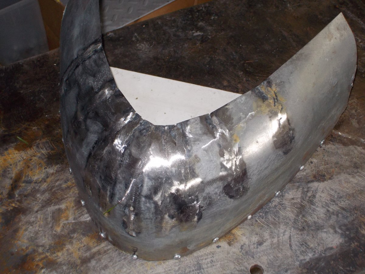

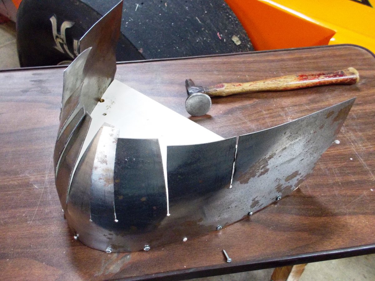

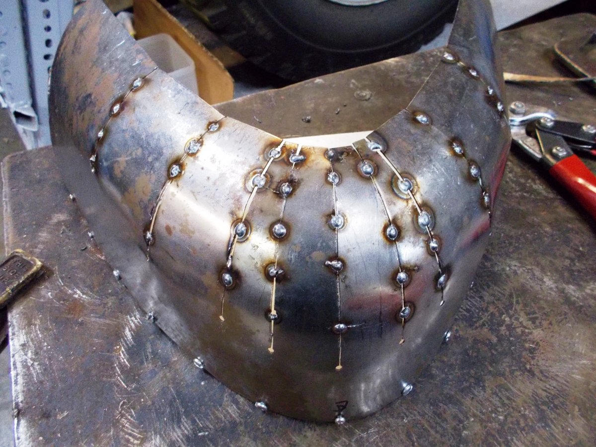

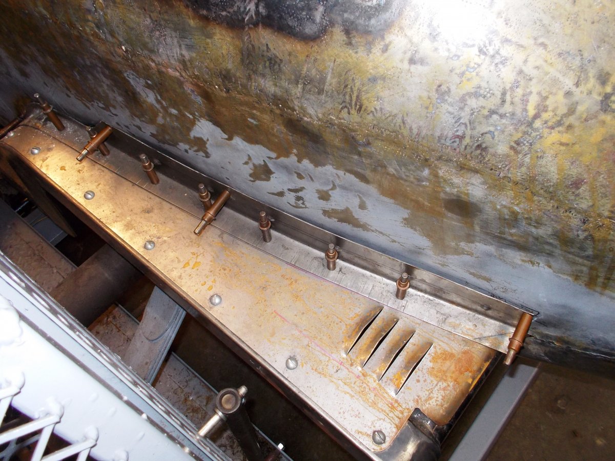

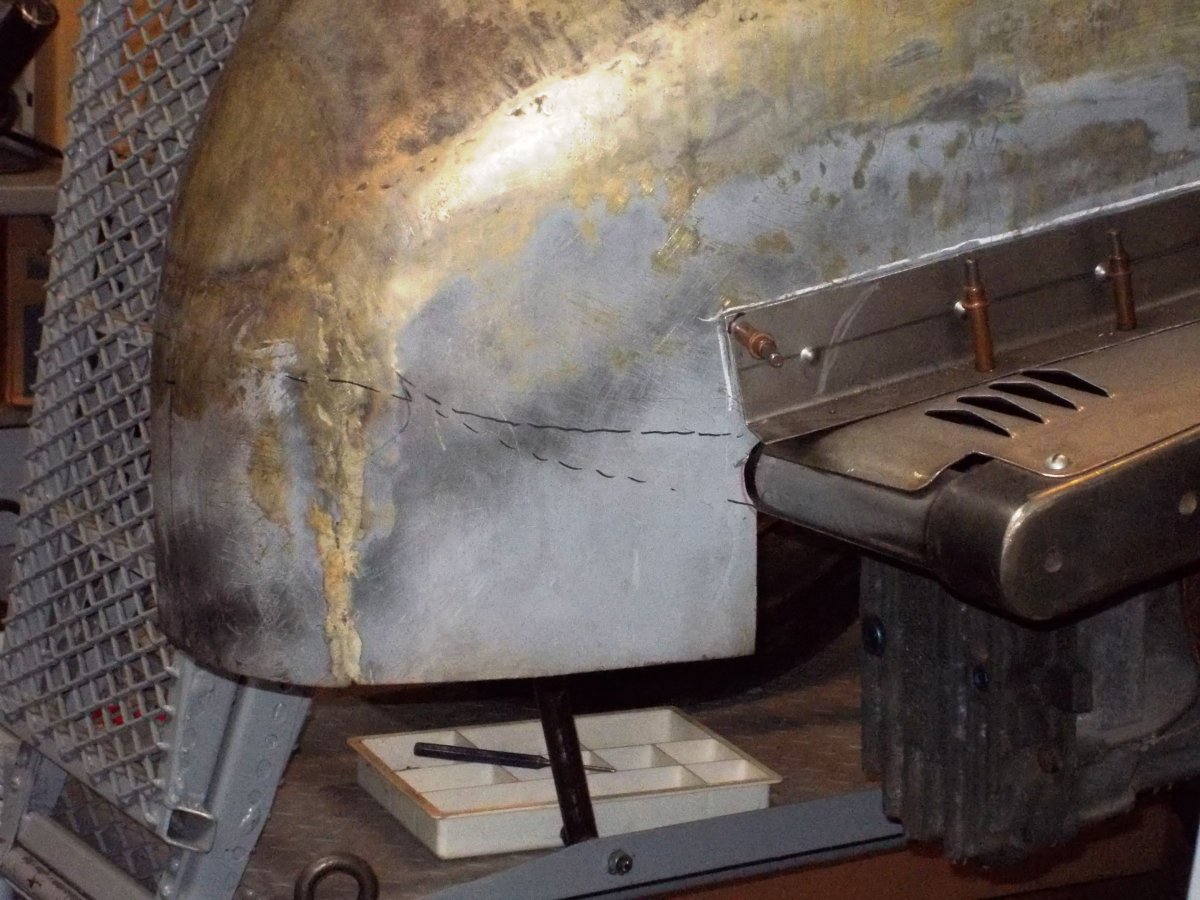

    I HATE PIE CUTS. (Although I love pie.) Every time I see a top chop that has a dozen pie cuts and attendant filler strips I think the job would be so much cleaner if some of the metal got stretched and shrunk into its final net shape instead of slicing and dicing in a bunch of long dagger-like fingers that need to be joined together with miles of weld bead.
    Having said that, I turned my attention to completing the bottom edge of the rear bustle shape. I want it to roll under in an ever decreasing radius that looks pleasing to my eyes. I also decided the tail section hung down too low and I decided to raise it up so it would be easier to see the "quick change" rear axle. So I pie cut lots of fingers in a blank and proceeded to hammer and weld it into the rounded piece you see here. Since it is a pretty tight radius and a rather large piece I was not sure I could shrink it in with my tools and ability - so I opted to pie cut it into submission.
    sr_shell_19.jpg sr_shell_20.jpg sr_shell_21.jpg sr_shell_22.jpg sr_shell_23.jpg sr_shell_24.jpg

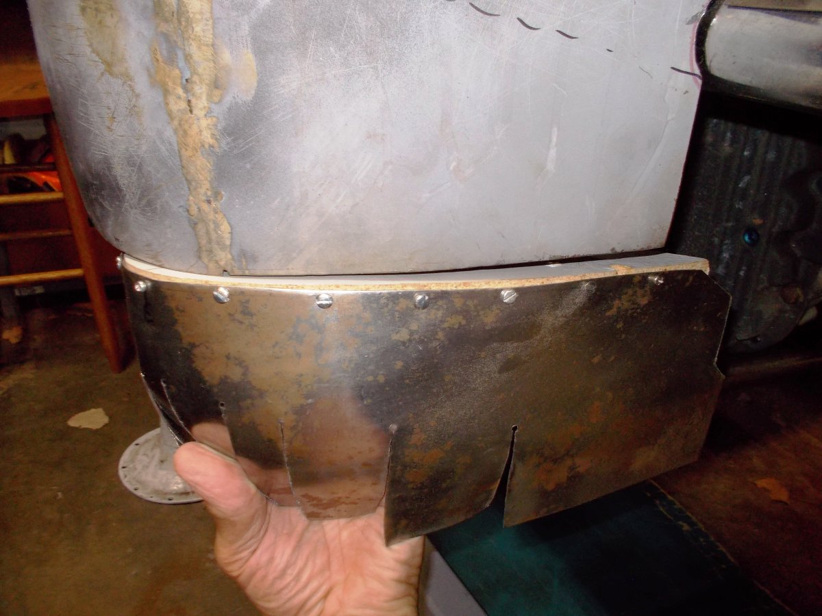

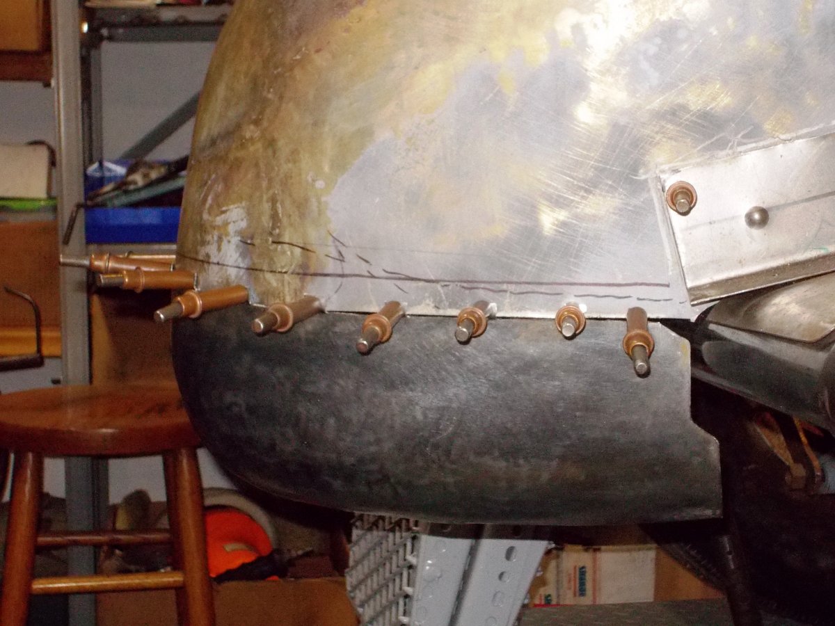

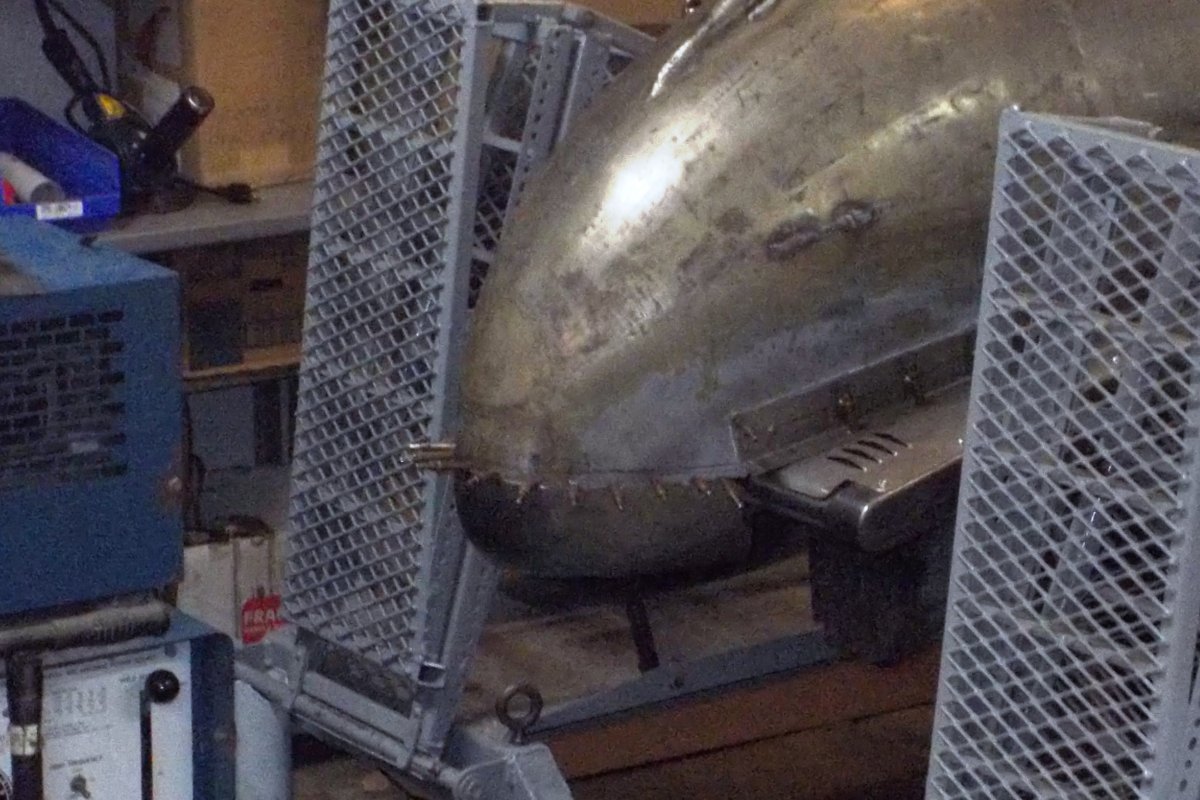

    Once the part was formed I proceeded to join it up to the body using the offset tab technique I had used elsewhere in the body construction. Tomorrow it gets welded on.

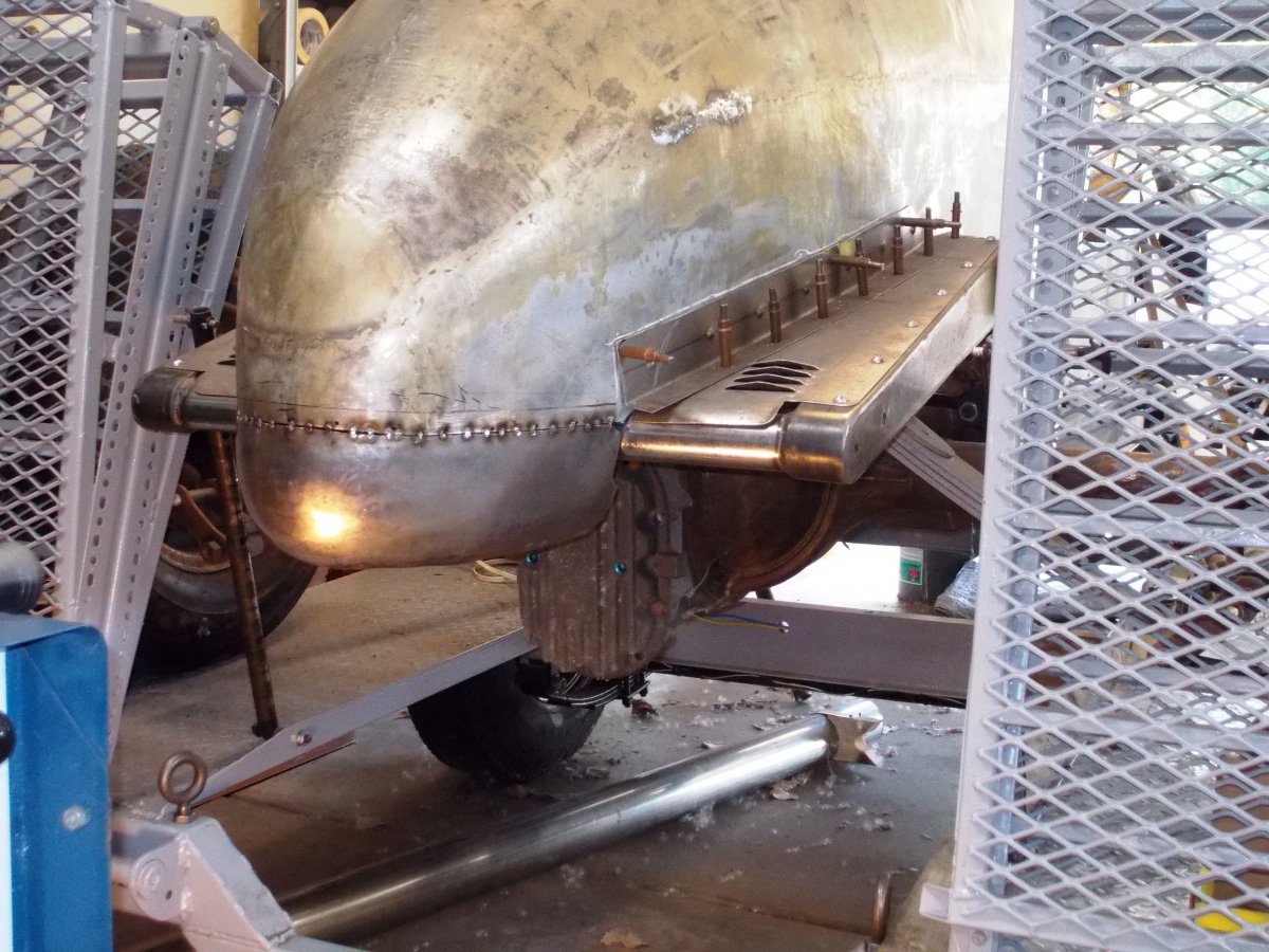

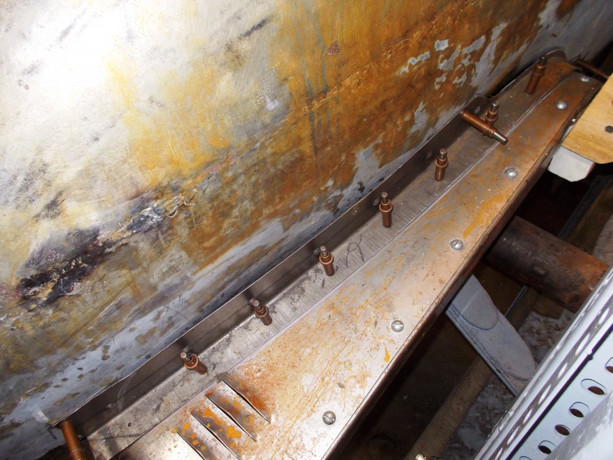

    Tacked in place. With the lower six inches removed from the tail now the quickie will be visible. Next I'm going to remove the complete tail and finesse the skin and affix the side mounting angle flanges permanently. sr_shell_29.jpg

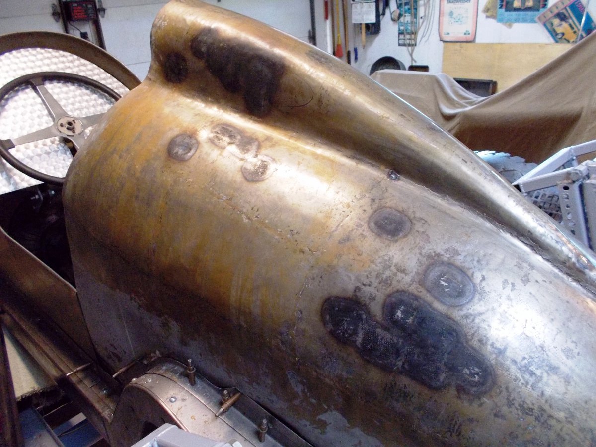

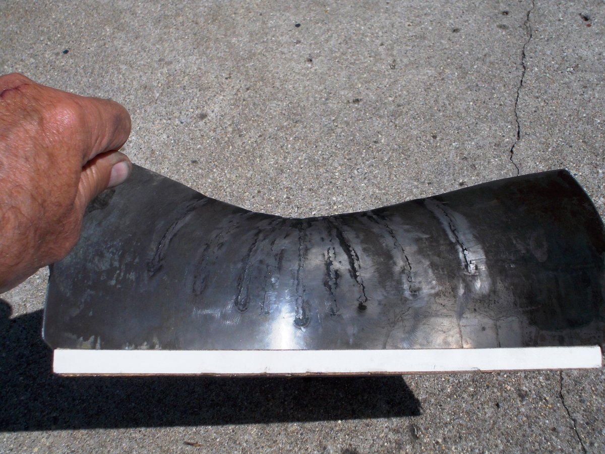

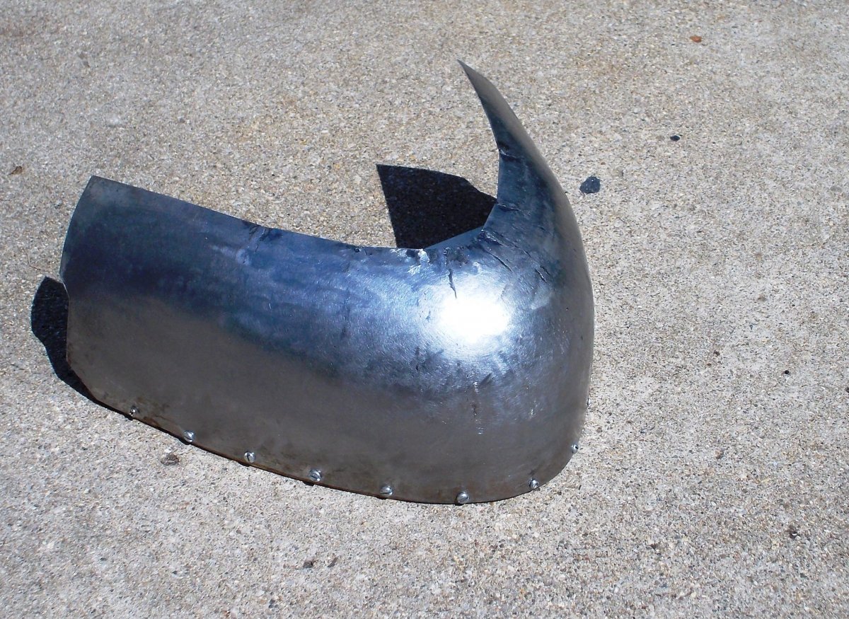

    I did some shrinking on the tail. There were high spots so I heated them and tapped them down a bit. Actually, I did the tapping while a buddy held the torch and another buddy applied a cold watered rag to the hot area.
    Question: How many hoodlums does it take to shrink metal? Answer: Three.
    sr_shell_30.jpg sr_shell_31.jpg sr_shell_32.jpg sr_shell_33.jpg sr_shell_34.jpg
    The bottom edge needs to be stretched slightly so it will conform to the mounting lip more precisely. I wish this thing would fit inside the throat of my English wheel.

    Really like the hand cut louvers! A little work and they will look good. At least that's what I'm assuming those four cuts are going to be louvers...

    Thanks farna. I have a Roper Whitney bench press that I made a set of 4" dies for, but the four inch was too big so I made a smaller male die and a drop-in insert for the female die and used it to make that space more interesting. I was going to leave them as-is but now you have me thinking about expanding them a little. I may put led stop lights in them too.

    Have you thought about using a shrinking disc, only one set of hands needed. A buddy just did his beer barrel doors with his SS disc, wow.

    I have a shrinking disc - homemade - but have not had a chance to use it much. I should try to finesse the minor flaws with it.
