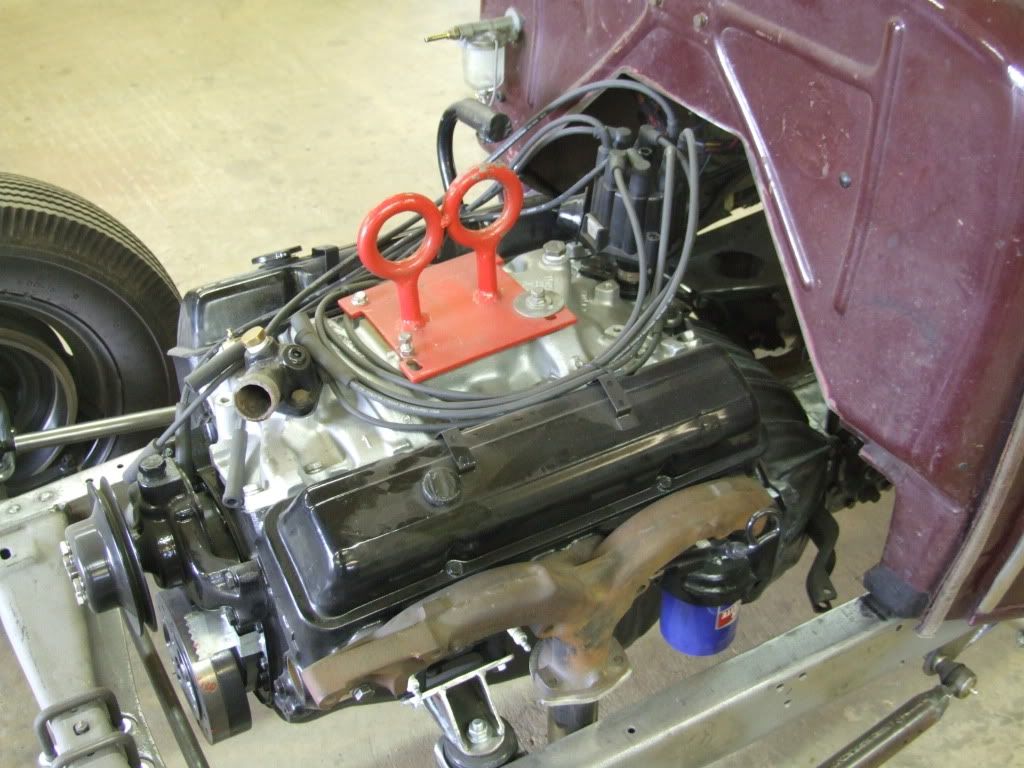

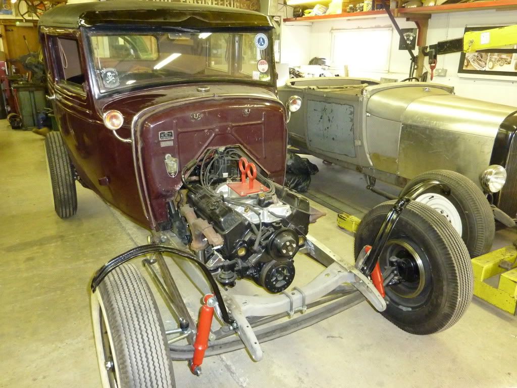

    Well the ol girl has gone away for some surgery some of you will like it and some of you wont but hey...
    She's having a 350 slightly cammed and old style heads (no accessory holes)four speed muncie,8" back axle,53 Ford drums up front on a 34 ford axle,LHD landrover box and keeping fully fendered.
    Hopefully it should be pretty quick !
    So it was sent off to Buckland Automotive for some major work that I cannot do myself .
    The engine has been given the once over by Clive at Probuild American
    http://www.probuildamerican.com/category/current-projects/
    Cant wait to get this back on the road for some serious fun.

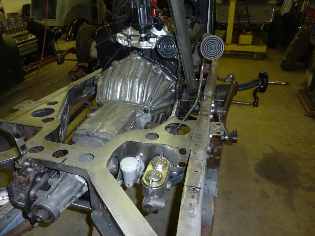

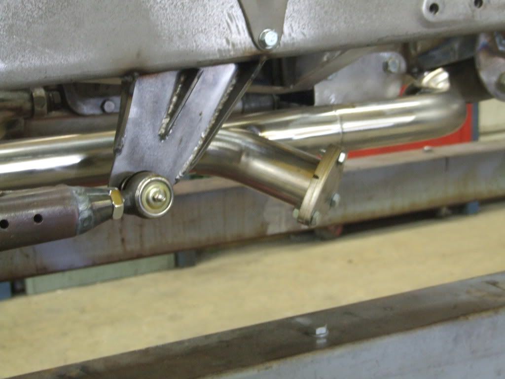

    Heres a couple more pictures.
    The axle is mounted and tourque rods installed.not long now and we will be rolling.

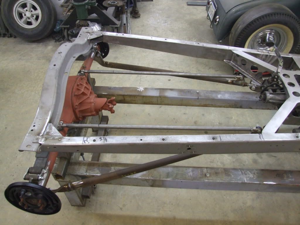

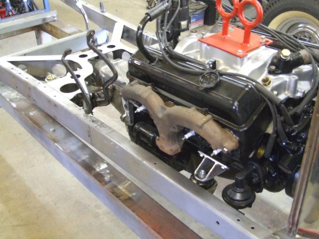

    Heres a few more progress pictures, axle all fitted now and exhaust system fabicated.
    Cant wait to see it on its wheels and off the JIG... with the body in place.

    Looks great...who makes those mufflers?
  17. 1930 vicky
    Joined: Nov 12, 2006
    Posts: 76
    1930 vicky
    from England,UK
    They are made by Adrian Smith the owner of Buckland Automotive they should have a deep mellow tone like smithys mufflers.

    Been over to Adrians today for a fitting! to get the steering wheel/pedal position correct to suit me.
    Body is on and looks good not long to go now.

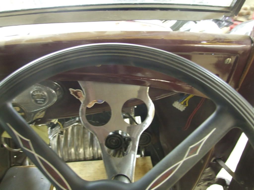

    Firewall recessed,seats all sorted ,shifter sorted along with the handbrake,floorboards/toeboards fabricated and check out my fancy column drop,Body off and chassis painted.
    The firewall is going to be painted cream . Keep up the good work Adrian

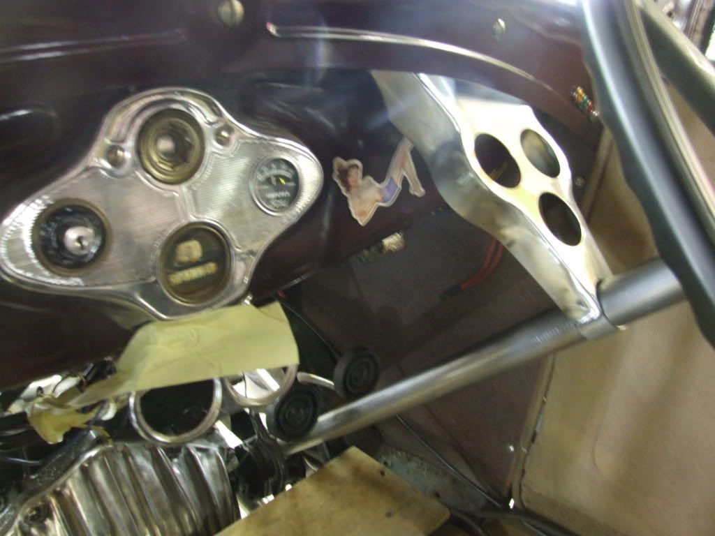

    Put some horns on that column drop! (when I first saw it from behind the steering wheel it looked just like a Texas steerhead!)
    Seriously, though: Gorgeous Vicky! That'd be my next project, if I could find one. I admire your direction here, the car just keeps improving. (brilliant design/execution of the upper torque rods!)
