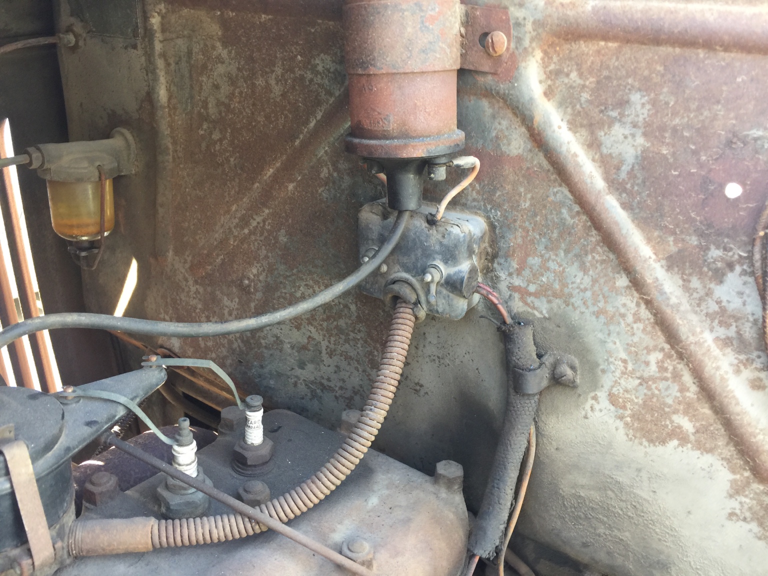

  13. [​IMG]
    It seems I mistook the starter solenoid for the coil box. I'm hoping that by doing all new cables, it fixes this problem! Still haven't had time to break out the volt meter and check, I'll probably be doing that tonight!
  14. The rectangular box attached to the firewall is the junction box for the wires. Some wires pass through but several looms end there and are connected to the next loom. You shouldn't find your problem there so don't open it. You can see this in the wiring diagram for your car.
