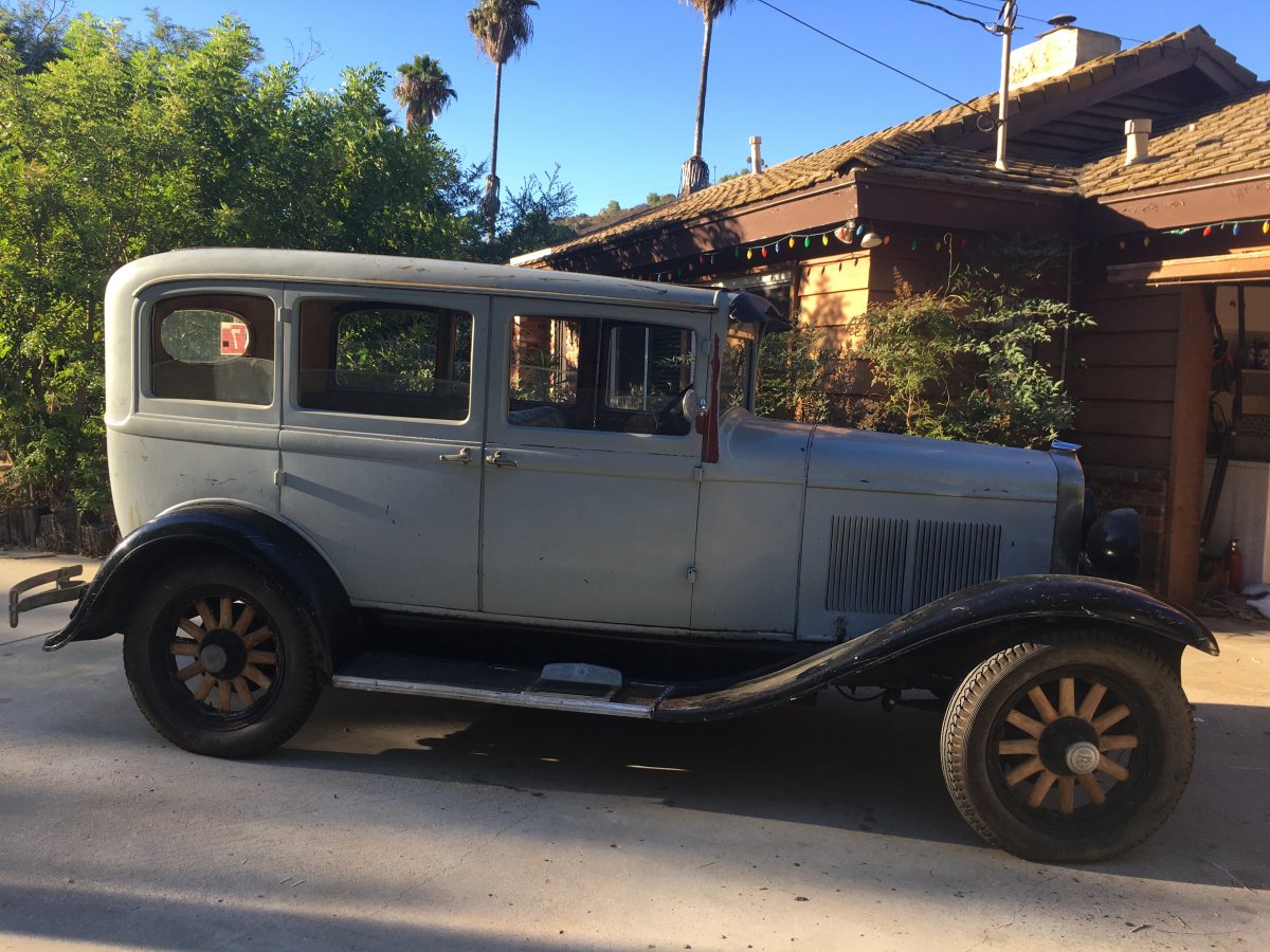

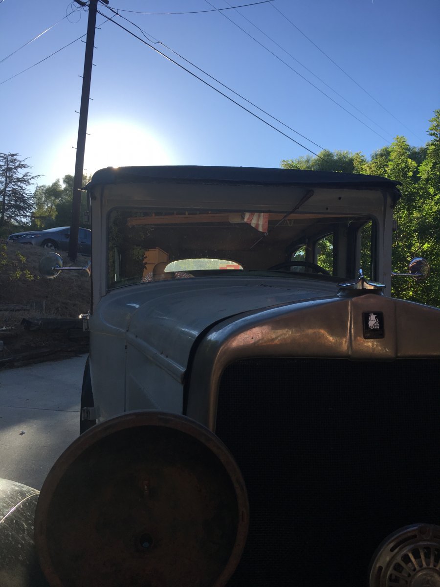

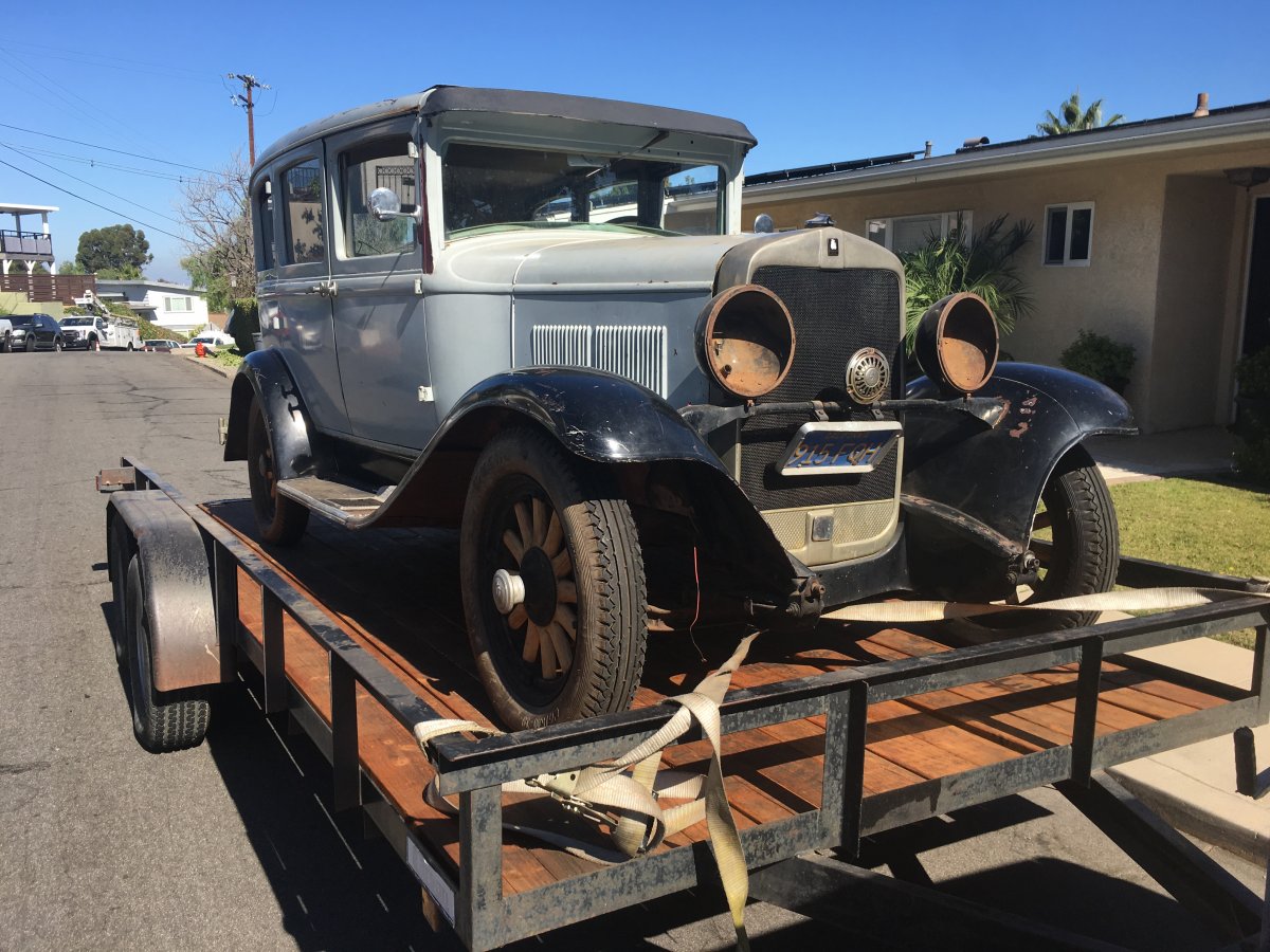

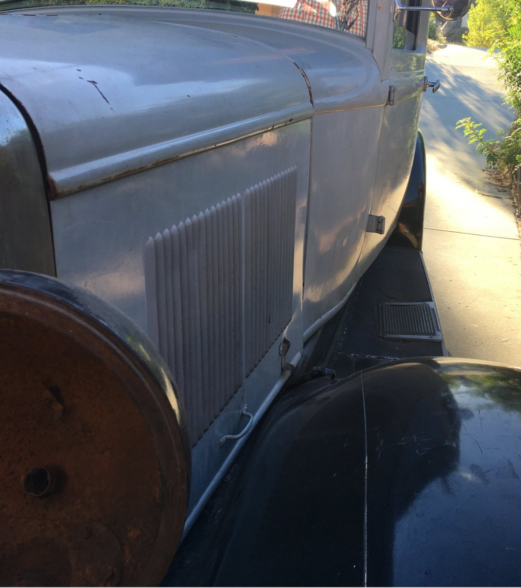

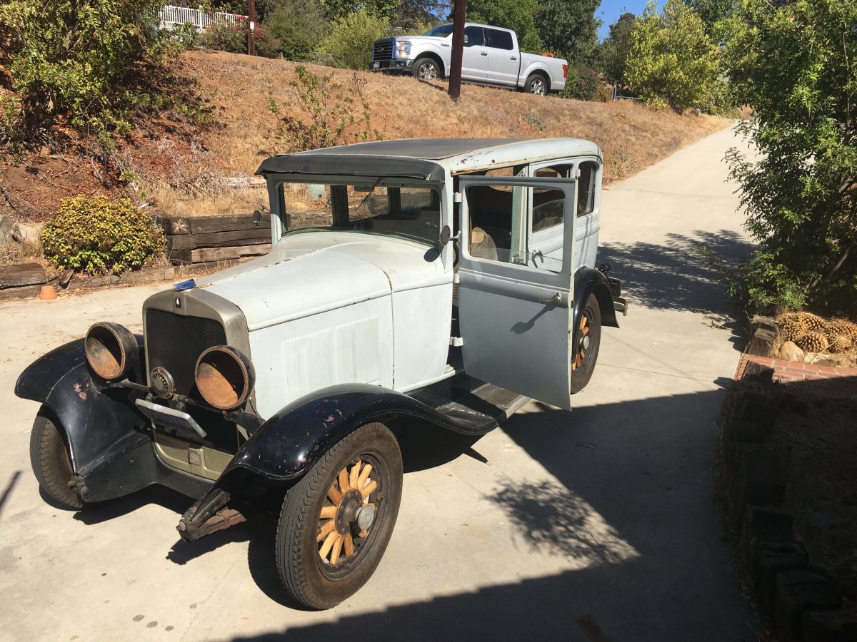

    Good morning,

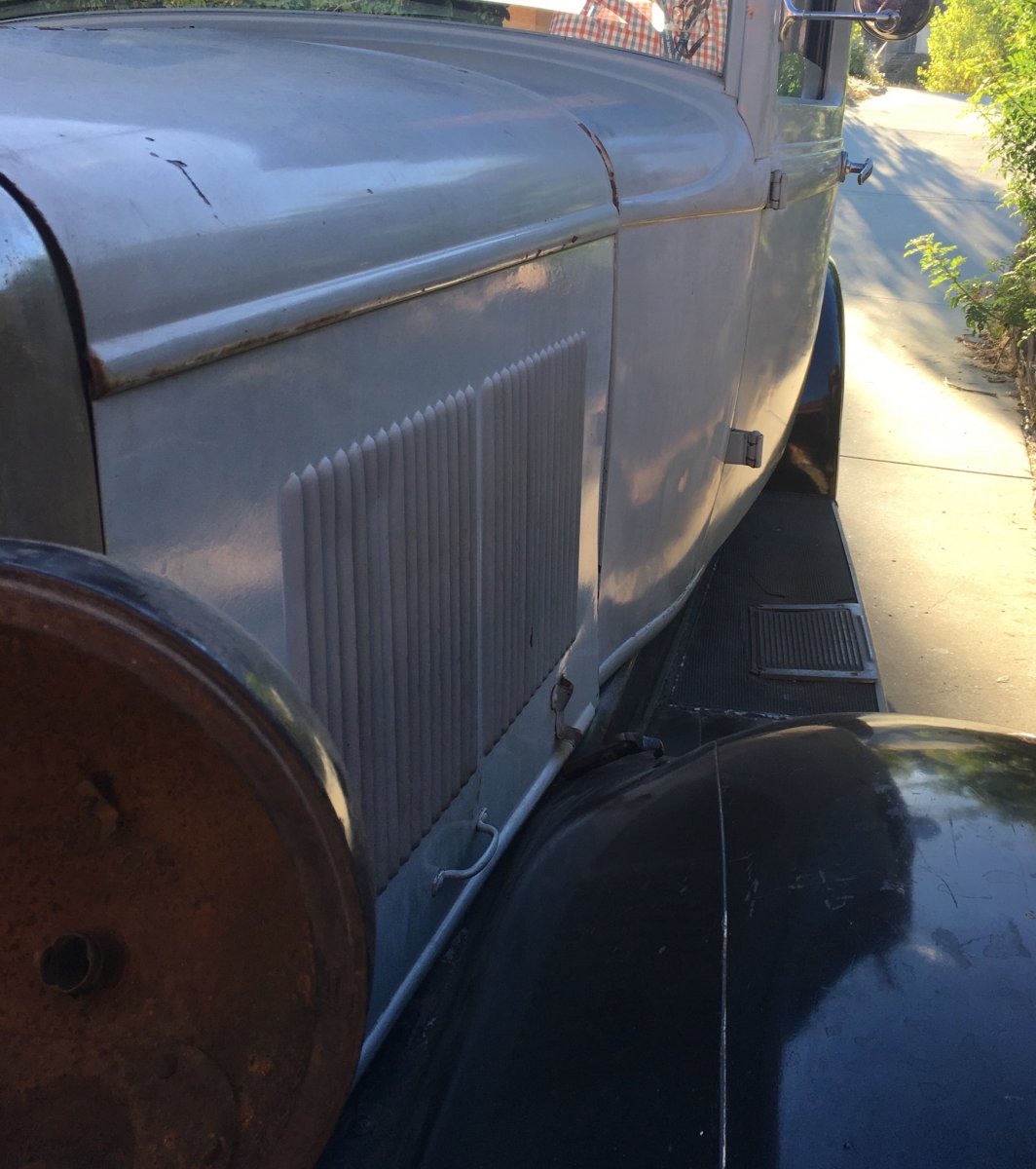

    I wanted to go ahead and start a thread about the Sedan that I acquired recently.
    Drivetrain: I have the original flathead 4, tranny, and rear-end, but at some point someone shoehorned a Datsun L16 motor between the frame-rails using the stock motor mounts. It accommodates what I believe are the original juice brakes and steering box. Both of those systems are in good shape with new brake hoses, and rebuild master/slave cylinders.
    Rear axle: stock standard, Mopar rearend. looks like it is a 3rd member-type of setup?
    Interior: mostly complete. Missing a few handles. Glass is mostly good. have a stock dash that looks to be uncut. Fire-wall/floorboard is missing and a plywood replacement partially covers engine area. Seats are definitely going to get tossed in lieu of a couple buckets up front and a larger more comfortable bench in the rear. I'm thinking of looking for seats from a Chrysler/jeep/dodge rig.
    Exterior: This rig is full-fendered, straight and complete. roof panel and sun visor vinyl are a bit worn-out but that's an easy fix in the scheme of things.
    Here's a few pics I have so far:

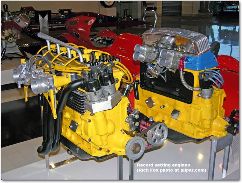

    What you can do with a PA. But a 32 PB is a much better place to start. If you plan a driver I would stick with thw Nissian or go with a end to end modern engines.jpg drivetrain

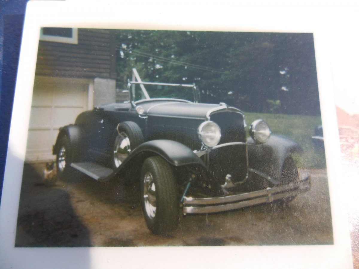

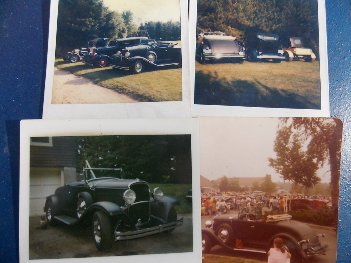

    Ok, here is just about the same chassis you have in these pics taken around 1980. I built this car from random junk body parts left over from restorers. It is a 1930 Desoto model K, but looks like a 29 with the thin radiator shell.
    This car has the stock I beam and spindles, springs leaves removed to get it a lot lower than stock. I did not have a lathe back then as a young guy, but a guy in our hotrod club hooked me up with a local retired machinist that needed a tailpipe for his 68 Chevy pickup and was too disabled to do the work, or pay a shop ...so I traded him... I bought the pipe and put it on, and he machined down my 1930 spindles to work with 69-70 Dart disc brakes.
    I then welded up simple thick steel brackets that bolted to some of the original backing plate holes.
    The owner of ECI brakes in Vernon CT is in that same rod club, (he was just starting the ECI company), and he is probably the person who told me the disc brakes could work on my spindles.
    Then I added a 69 Dart 8-3/4 posi rear to match that 4" bolt pattern. I used that very narrow rear end so I could run deep dish chrome reverse wheels, and have them sit under the fender lips, not sticking out DSCN1910.JPG .
    Pics below show 3 rods that showed up at our Clubs summer picnic on a river campsite. The 32 Ford in the middle was the late Bob Juliano's, (owner of Juliano's Interior Products) the T was 348 Chevy powered. One pic shows my car at the old Sturbridge, Mass mini-nats. I sold it in 1985, and built more cars. It was too breezy/cold to drive year round. It had a 327 4 speed, with a 605 Saginaw power steering box, with "cross steer", not side steer like was stock
    The next car I did was a stock 32 Plymouth PB convertible coupe. I sent the bare block out to bore it 30 over, got new pistons from Egge in Cal, then did the rest of the rebuild myself. But the rear end ratio prevented the car from staying out of peoples way, with their fast driving. I should have put better gears in, as I would probably still own it now.
    So, there you have it...yes you can keep it mostly stock with better gears...or...do what I did to the DeSoto. Your choice, for your skill set.

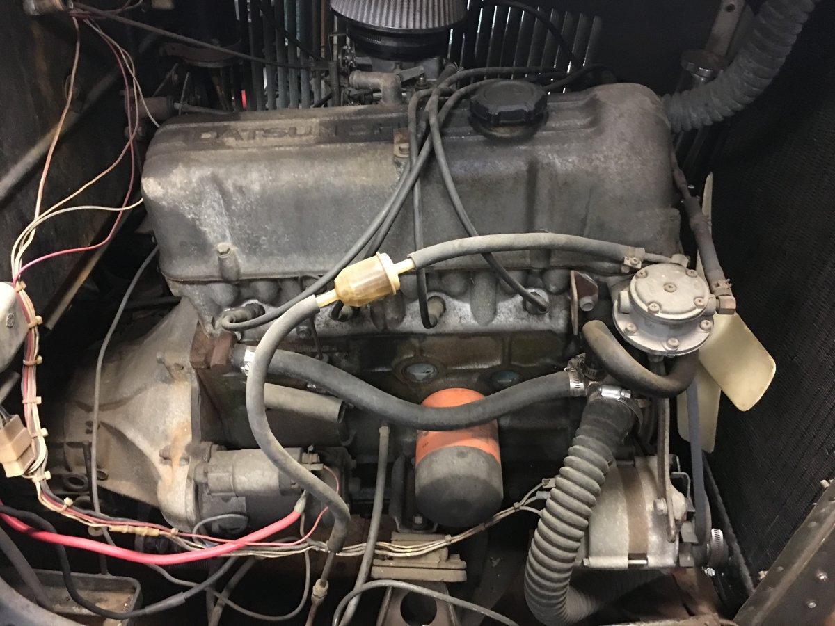

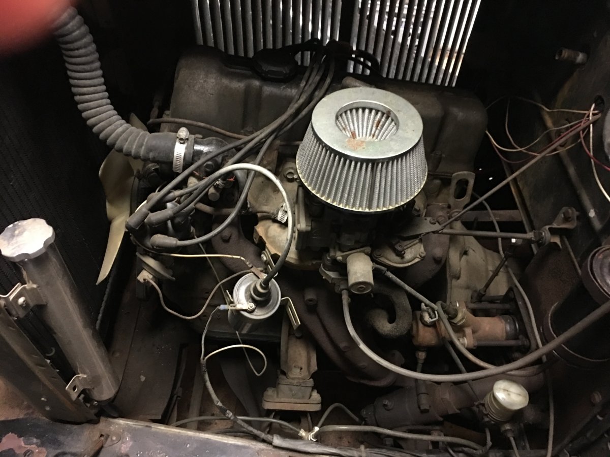

    Datsun motor. Seeminly good shape, fires right up, has pretty good power, might look pretty good dressed/cleaned up a bit.

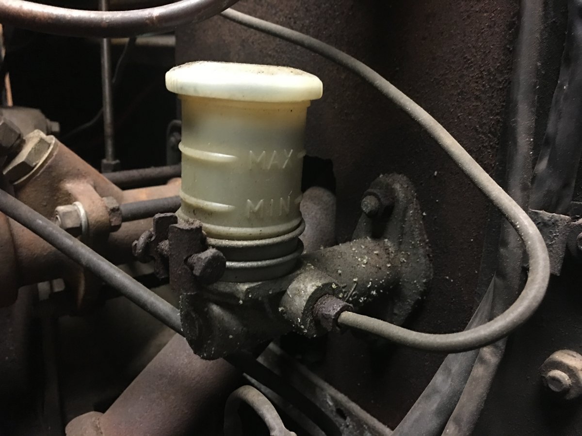

    Brake master with newer switch:

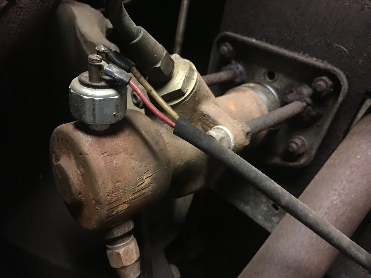

    Clutch master, i believe:

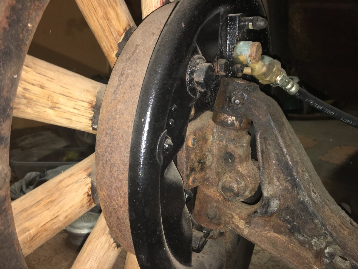

    Front passenger brake (with new hoses evident)

    We are not supposed to discuss modern motors like that...
    I'd try driving the car and see if it will work in your area for speeds.
    I'd drive it as a daily!!
    I will try to look at a wood wheel drum here. I am not sure if you can redrill to a normal wheel pattern, "If" the back part of the hub is not the correct shape. I just don't recall seeing anyone doing it on a wood wheel drum.
    By the way, yes that is the original 31 Master cylinder, BUT it was never on the firewall. It was down low, as the pedal cluster used to be under the floor. The builder moved it, but those two long bolts with weld globs on that plate looks a bit sketchy?? Make sure that master is not flexing/moving if someone steps on the brake while you watch it. It looks like they welded nuts?

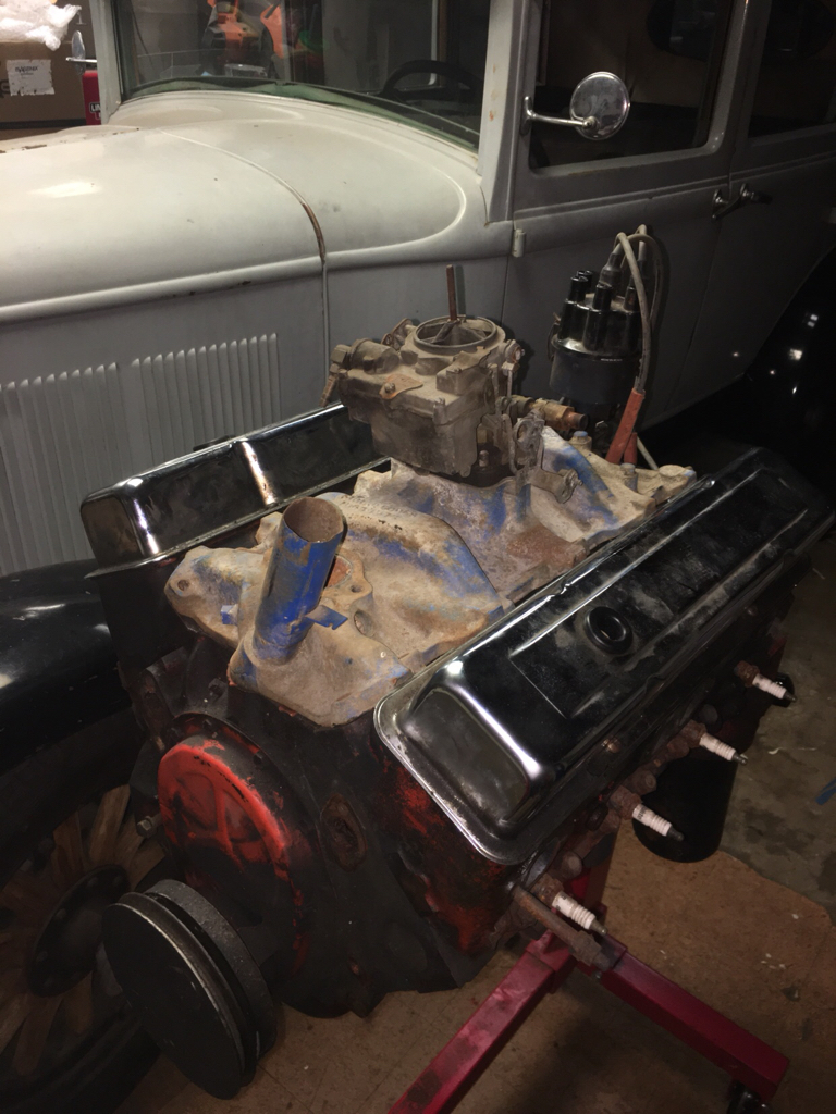

    Well, been chattin’ up my dad in the last few weeks, about his time on the drag scene and his recommendation was SBC all the way. Sooo, picked up the likely candidate tonight.
    1964 283 small block complete, in good shape with a set of “ram’s horn” manifolds which should help a lot with fitment issues.
