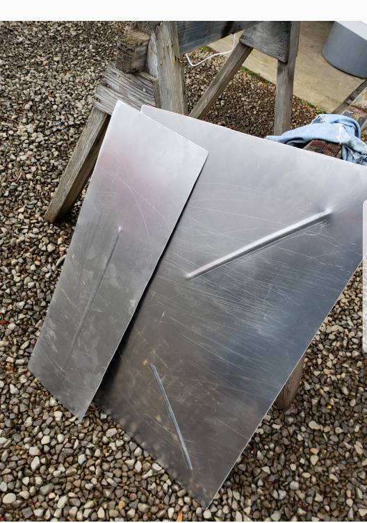

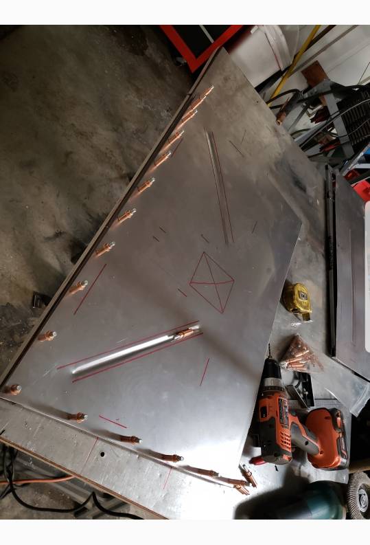

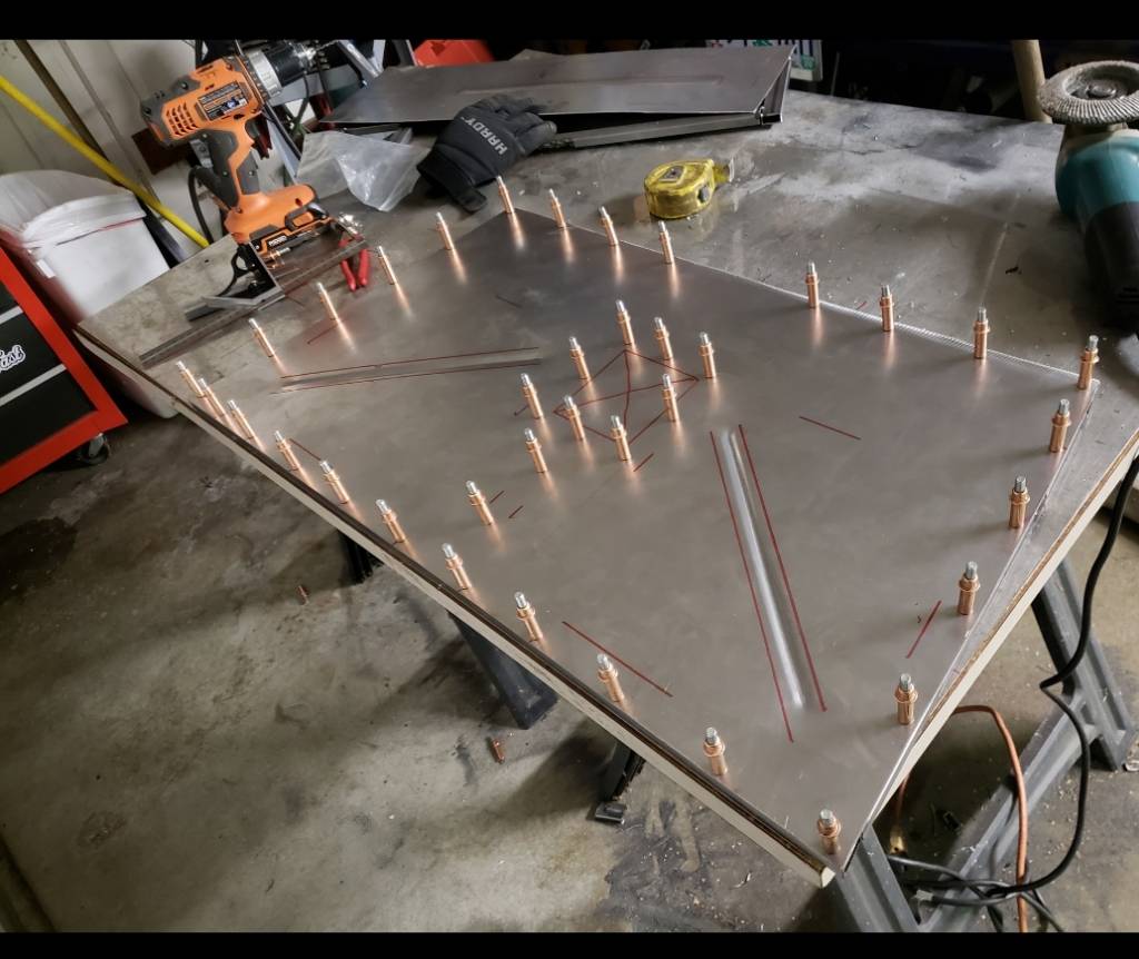

    Hi guys, I decided to build some metal floors for the model a last month.. so far so good. Complete novice at this stuff. So don't judge too harshly. 20190109_065214.jpeg Screenshot_20190109-064937_Gallery.jpeg Screenshot_20190109-064710_Gallery.jpeg Screenshot_20190109-064740_Gallery.jpeg Screenshot_20190109-064645_Gallery.jpeg Screenshot_20190109-064838_Video+Player.jpeg

  8. akoutlaw
    Joined: May 13, 2010
    Posts: 898
    akoutlaw
    I think it looks great.
    jt1949 likes this.
