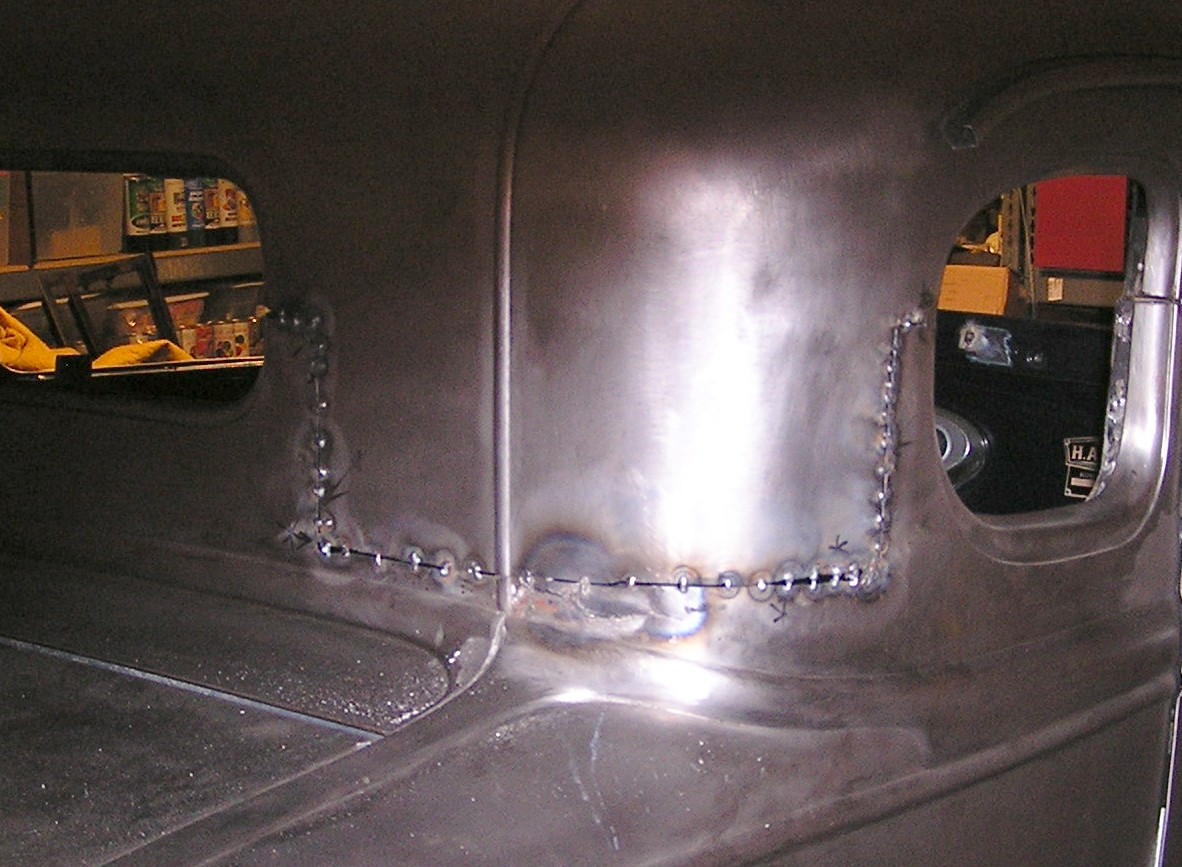

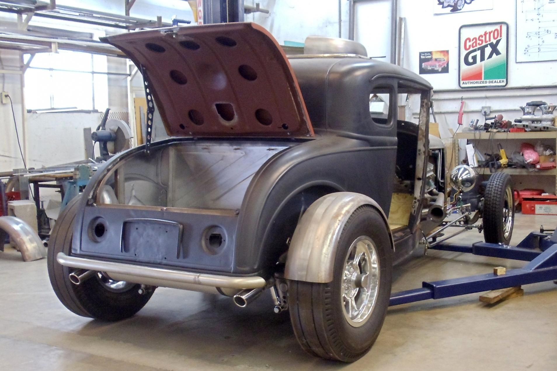

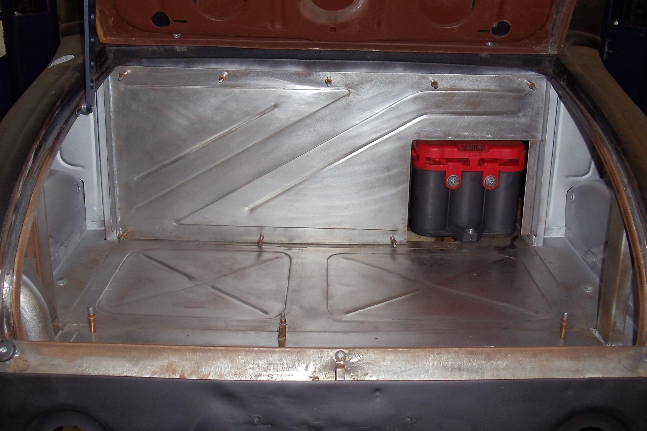

  15. 63dan63
    Joined: Jan 10, 2008
    Posts: 395
    63dan63
    I have taken a lot of pictures since I brought this Coupe home in November 2007.
    here are a few from last week:
