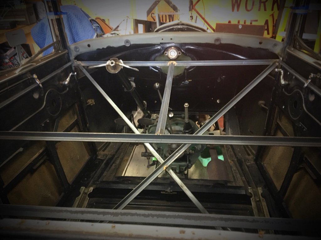

    Going to pick up a tank for gas welding, got my regulator, so in the mean time I figure: use up the crappy flux core on the cage for the stability of the body after the chop. Pretty much ready now, my bro from another mo is going to come over to help in the festivities![​IMG][​IMG]

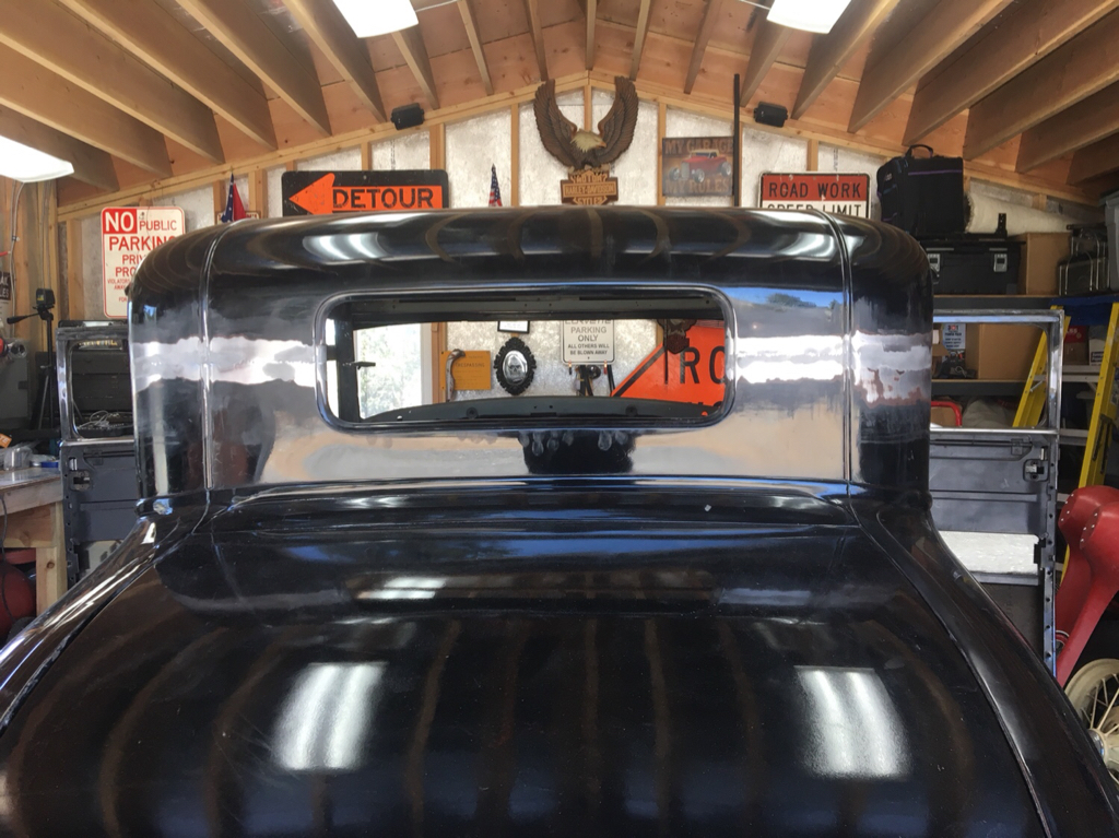

    Well today was the day...so thankful for my bro coming over to help in the chop festivities...happy with the result, next up...welding the top on...[​IMG][​IMG][​IMG][​IMG][​IMG]

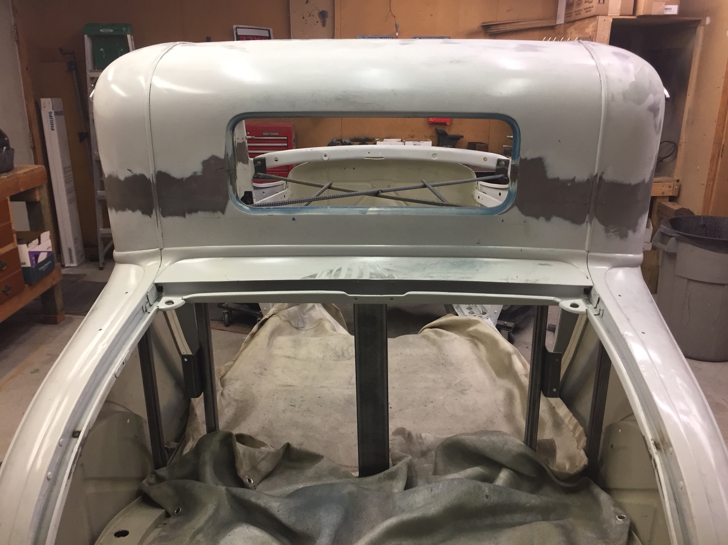

    Ok I’m back...top is welded, sanded, filled, and all window trim and windshield frame is cut and done...next up, the body / chassis separation...[​IMG][​IMG][​IMG]
