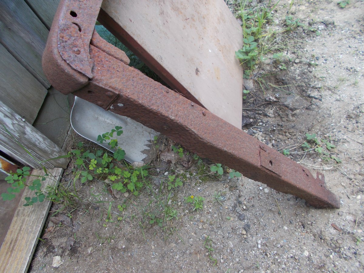

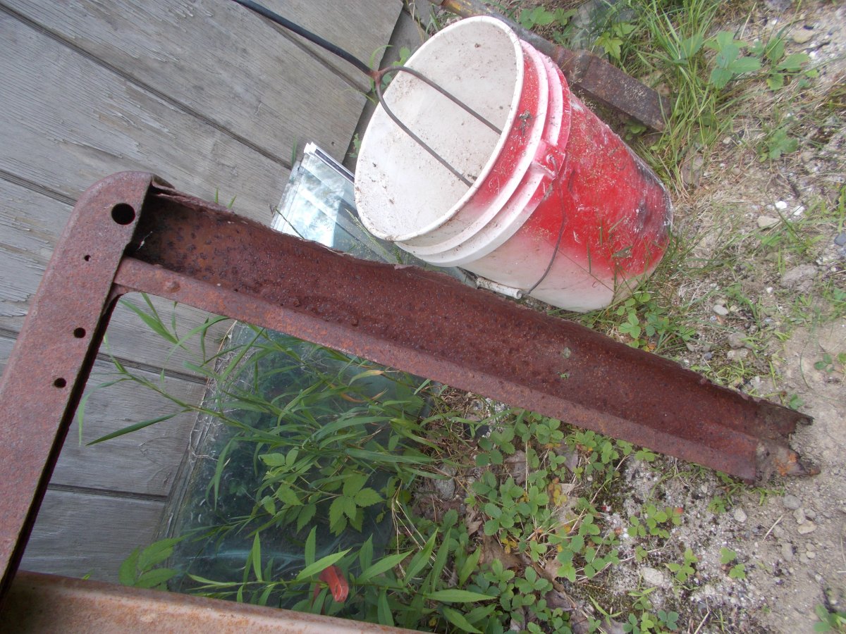

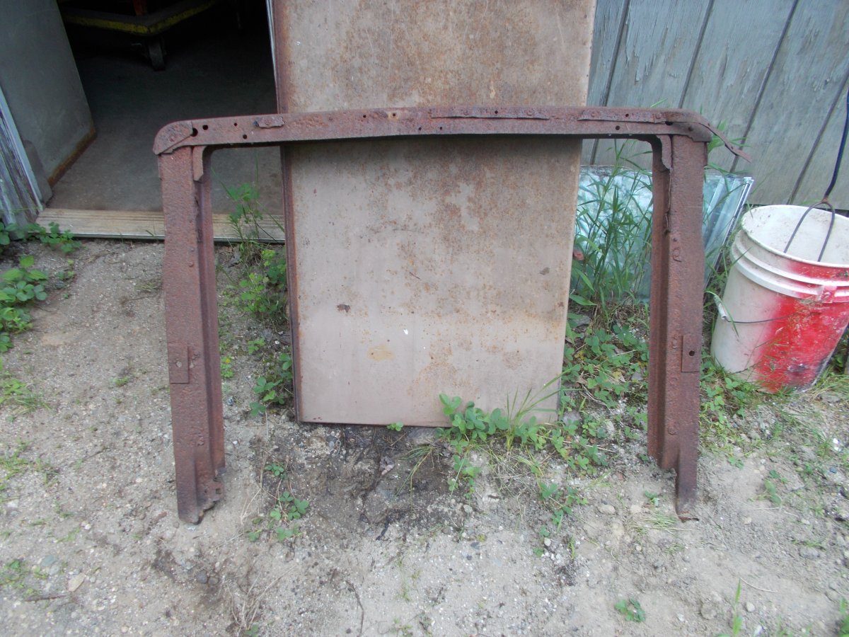

    Here are some photos of the damage.
    [​IMG][​IMG][​IMG][​IMG][​IMG][​IMG]

    the front floor angled panels are called toe boards... the section they rivet to are subfloor extentions...
    I would buy the correct [10] wooden mounting blocks...
    from the cowl back the body will bolt through the sub floor cross rails and blocks not the main subrails...
    make sure your door jams and gaps are ok...
    measure diagonally from different spots and often...
    the rear of the body hangs past the end of the frame by a foot, it is supported by a couple foot long sections of mounting blocks...
    I have a 36" rear subfloor section for a '30 coupe, I will use it, but am sending pix...
    the re-enforced holes about halfway back is where the frame ends...
    will take measurements if you need them as the repops I have are blanks...
    there are no flanges on the outside edge of the subrail...
    slv63 and biggeorge like this.

    If I had your coupe I'd buy the full length Brookville subrails, but probably only use them from the door posts on back. Hard to tell exactly from your pics, but are the originals solid in the door area?
    Do the cross measurements like mentioned above, and weld in some diagonal braces to keep it in shape. Make sure to test fit the deck lid as all these loose rearend measurements will have a huge impact on the deck lid opening.
    Find a nice original rear cross subrail, since the repros don't look quite right. Then measure a few times and cut the new subrails a little long and hold them up into place before making the joint line cut behind the rear door post.
    Be aware that sometimes the wood block kits might not be perfect, and could still need a little grinding to thin it up, or shims to bulk it up for a perfect fit. Hope your frame is straight!

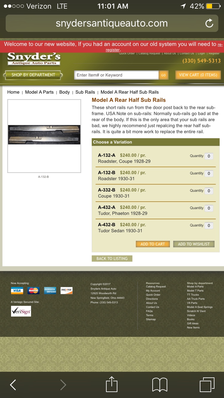

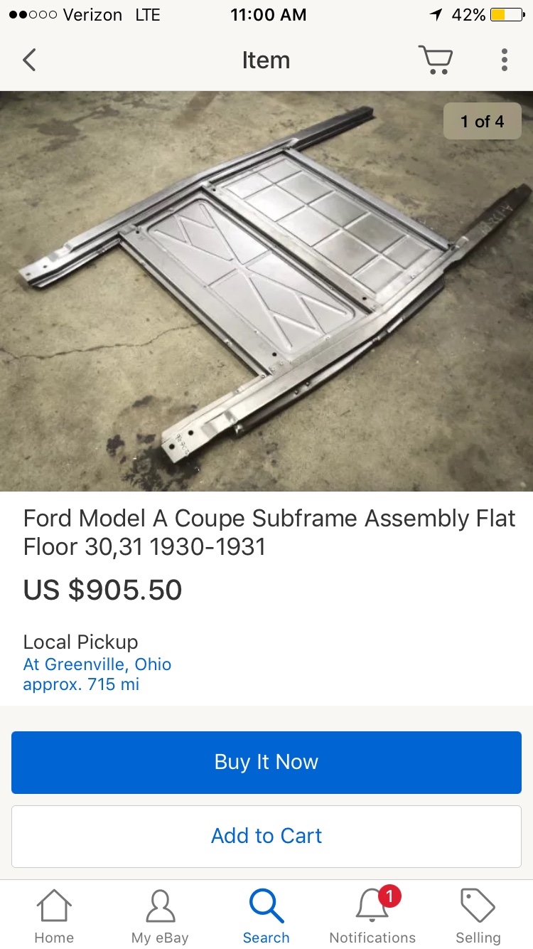

    I am thinking that the rear sub frame replacement would be a setup as the area by my doors and forward of that are in good shape. [​IMG]

    The full floor from brookville is pretty tempting but it doesn't seem completely necessary for my project.
