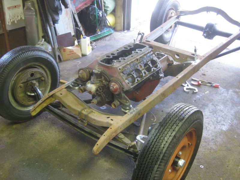

    My pops came by today to work on the car a bit so we made up some motor mounts. I like how they turned out. We made them from 2x3 box tube. We started to fit the rear mount also but he had to leave so we stopped for the day.
    I am waiting on the correct rear mount for the trans to show up, once that is here we will tack in the mounts, put a radiator on it and see if everything makes sense. Looks like I am going to have to lengthen the wishbone by about 7 inches to reach the trans crossmember.

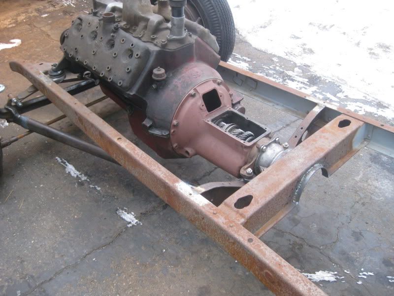

    Today was almost 60 outside so we took advantage of it. Got the front mounts in and dropped the engine and tranny in to see where the rear crossmember would go. After cutting it up a bit, we located it and welded it in. Tomorrow, we are going to fab up the wishbone bracket and work in lengthening the wishbones. Also we need to cut the wishbones at the front and bring them up to retain the 7 degree axle angle. It is starting to look like something.

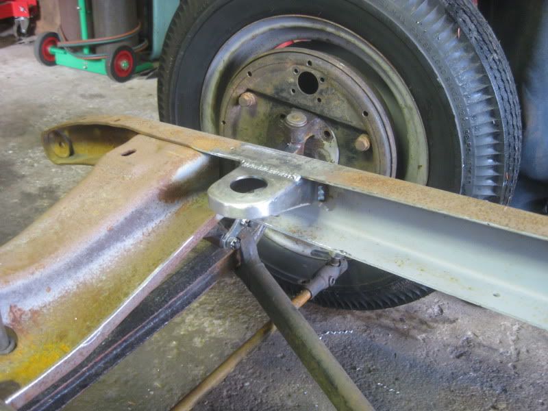

    this weekend I finally got the wishbone finished. I do not have the coin for a 32-34 wishbone so I used a 39 and a Model A to get the length I needed to reach the crossmember. I cut the front ends and yoke off the A wishbone and used the middle from the 39 because they are longer. Welded everything together with 7 degrees so it should go down the road nicely.
    I am also going to keep the A crossmember behind the F-1 crossmember just to add a little more strength to the frame. I had to notch it to clear the torque tube. I may have to notch it for the master cylinder though. I am having my buddy build my driveshaft for me, he has a lathe and I just had no way of doing it myself. Next weekend hopefully the driveshaft will be done and we can finish up the rear end.
