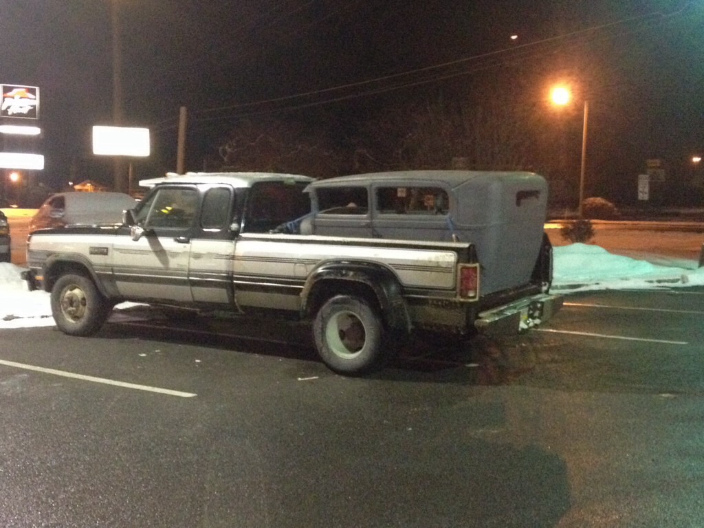

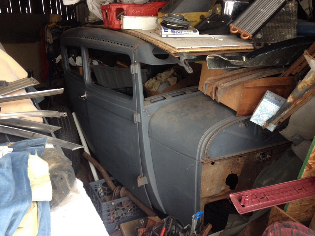

    Very nice start and the chop looks great. How long did it take you to dig that out? Looks like it was a storage bin.

    we bought it from a fellow hamber... he did the work of getting it dug out.. it was just no fun to carry down an ice covered hill to my truck. i found this car in 2012 when i bought my model a. i was on the hunt for a car and i went and looked at a coupe that this getleman had... i wasnt to interested in the coupe so he showed me other projects.. and thats where i found this one.. i have kept my eye on it since... so when the time came for my brother to actually buy one... i took him down and let him see it.. the chop was what sold the car. he loved it... we did OK when buying it.. and with the money he got out of the 31 dodge he was able to afford the sedan, and almost every single part to build it completely.. we are stoked.. big time.

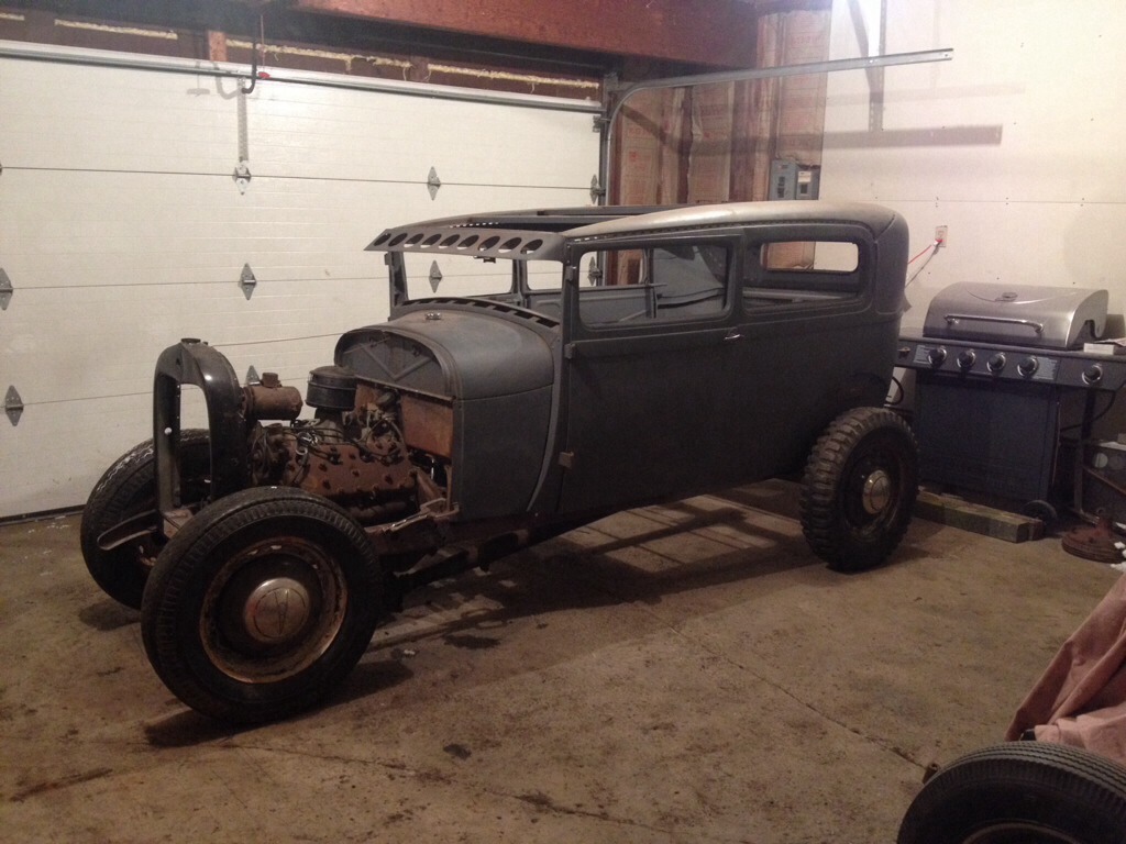

    Day 1:
    We started with a $50 chassis that was in pretty good shape overall. Frame horns were shot. Someone boxed it years ago and never finished welding it.
    So today we decided to dig in. My brother came over. By the time he got to the shop, I had all the boxing plates out and cleaned the frame up from the welds. I've never been a boxed frame fan. I like em bare and original. So after that I decided I wanted to step the rear of the chassis... He about shit when I took a cut off wheel and hacked the back of the frame off .. But I had already planned on this so I made some triangular box gussets at work a few hours before hand. With in 20 mins it was all welded back up and ready to go.
    As I told you guys before, someone did a poor job of sub rails.. My brother decided he didn't want the stock ones back in. Who ever worked on it before replaced the sub rails with tube. And that part was done nicely. So.... We added from there. We built body mounts and added floor braces. Now it's ready for 1/2" thick oak to nicely lay in between the sub rails and lay some carpet on top. .. We spend a few hours squaring the body on the chassis and making it look perfect . After that was all welded up we moved to the front. I trimmed the front cross member to accept the flatty ... I also whacked the frame horns off and fit them back on properly. And wouldn't you know it , after one horn was all done and I moved onto the second one, I ran out of mig wire and gas at the same time .. So off to the welding store tomorrow before work can Continue. Tomorrow we also go pick up all the parts we bought (motor trans and axles). Here is a few pics from today's progress

    We got all kind of goodies.. It was a relief that my wallet would actually fit back in my pocket when we left ! We made it home about 9-9:30 and went right to work . I removed the spring and mounts from the new rear axle, started to get the new mounts on for the model a spring . I split the wishbones , got the f1 steering box trimmed down and almost ready for install, and I located the motor mounts that I fabbed up . We welded them in and set the motor and trans down in . It's 1 am and I decide tomorrow is another day. It's looking like a car. The wide fives are the cats ass for this build !
    My brother is starting to get anxious..
    We will be sandblasting and nicely painting every part for this build once we get it fit up and working good. I want this car to be super nice and last him a life time

    Not to much was accomplished today. I'm waiting on some parts orders to arrive which is holding is up. I got the f1 box all trimmed down for the flanges I put on them. I also opened the frame up for it to slide in. I will have some filling left to do so its a nice clean fit. We also were plug welding some un needed holes in the frame and fitting the front axle to wish bones. We did get the front spring tore down to be reversed. Time to sandblast it and eventually reassemble. My parts will be here Wednesday so that will. And the car a complete roller with steering.. It's coming !
