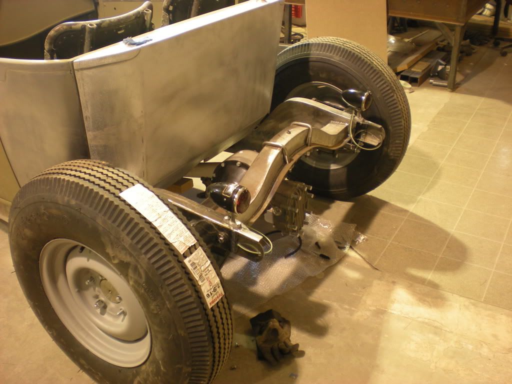

    I got some plexiglass cut for the windshield for now till we get actual glass cut. And I also made mounts for the tail lights, got them mounted, and finished off the rear of the frame so it looks like a bobbed original.

    Very cool build!! I think if the back axle bells were flipped so the rear leaf spring would be in the front of the axle and the rear frame rails shortened it would really showcase that rear end and take the gap away from the back of the frame. But what do I know. AWESOME A+

    Probably showing my lack of knowledge here but what are the brake lights off of? They look really good on there!

    They are reproduction 37' ford taillights. You can get them from a few guys, I believe Sacramento vintage ford carries them.
