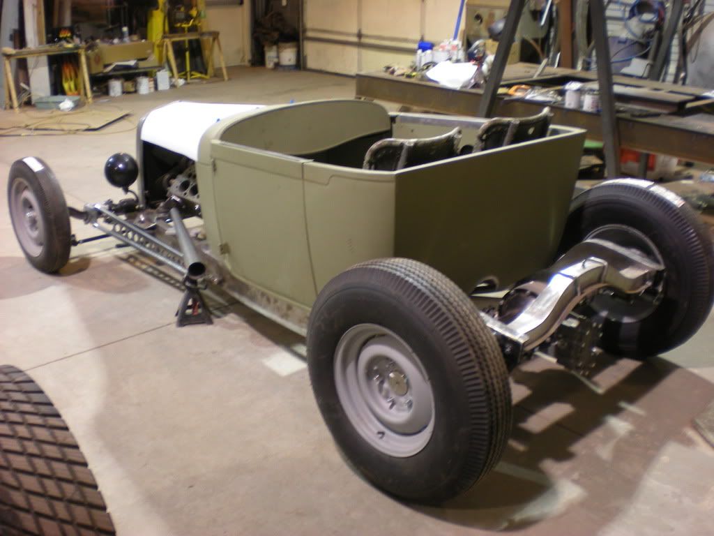

    I also got the rear shocks mounted yesterday.

    I got a mock up hood made to see how it looks. I was blown away how much it improved the feel of the car. Now it all flow's together. So with the owners approval it looks like a hood will be in the mix.

    This thing looks awesome, so many things I would like to do if I had my own roadster build someday. I love the look of the non-dropped axle with the suicide front end, and I always wondered how you could do it without having the spring up front so it would look cleaner. Then I see your quarter-elliptical setup and it just blows me away. Really clean work man, keep it up.

    Wow Chris! Looks amazing, I really dig the 2 hot rod "go karts" side by side.
    Agreed, I think the hood will be a nice look, smoother lookin'.

    I got the hood made today. It defiantly helps the flow of the car. Next I'll fill the top with a bunch of louvers.
