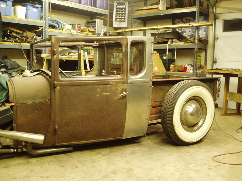

    The doors are the hardest part of the cab to find. All the parts behind the doors are made after market.
    Here is a pic of a '29 I'm working on. 4.5" chop, cab stretched 4" and model t coupe 1/4 windows shortened and narrowed. Flathead powered with 5 speed.
