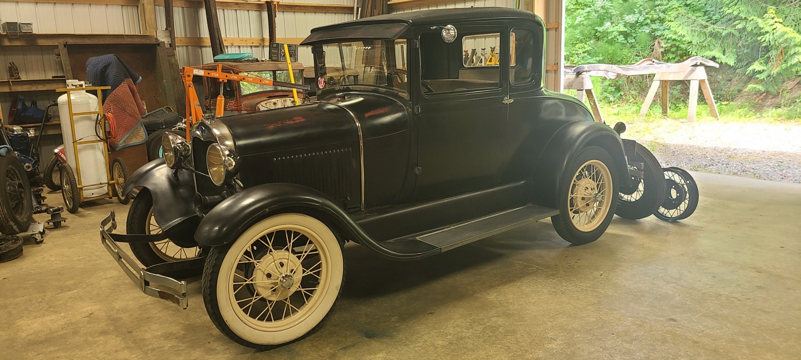

  1. I'm working on a mild banger powered hot rod build for a client. I've been doing a "step by step" on my Instagram and I thought ya'll might enjoy it as well.
    I started with a typical amateur restoration 1929 model a coupe.
    But got a paint job in between me starting work.
    This is how it looked upon arrival at my shop.

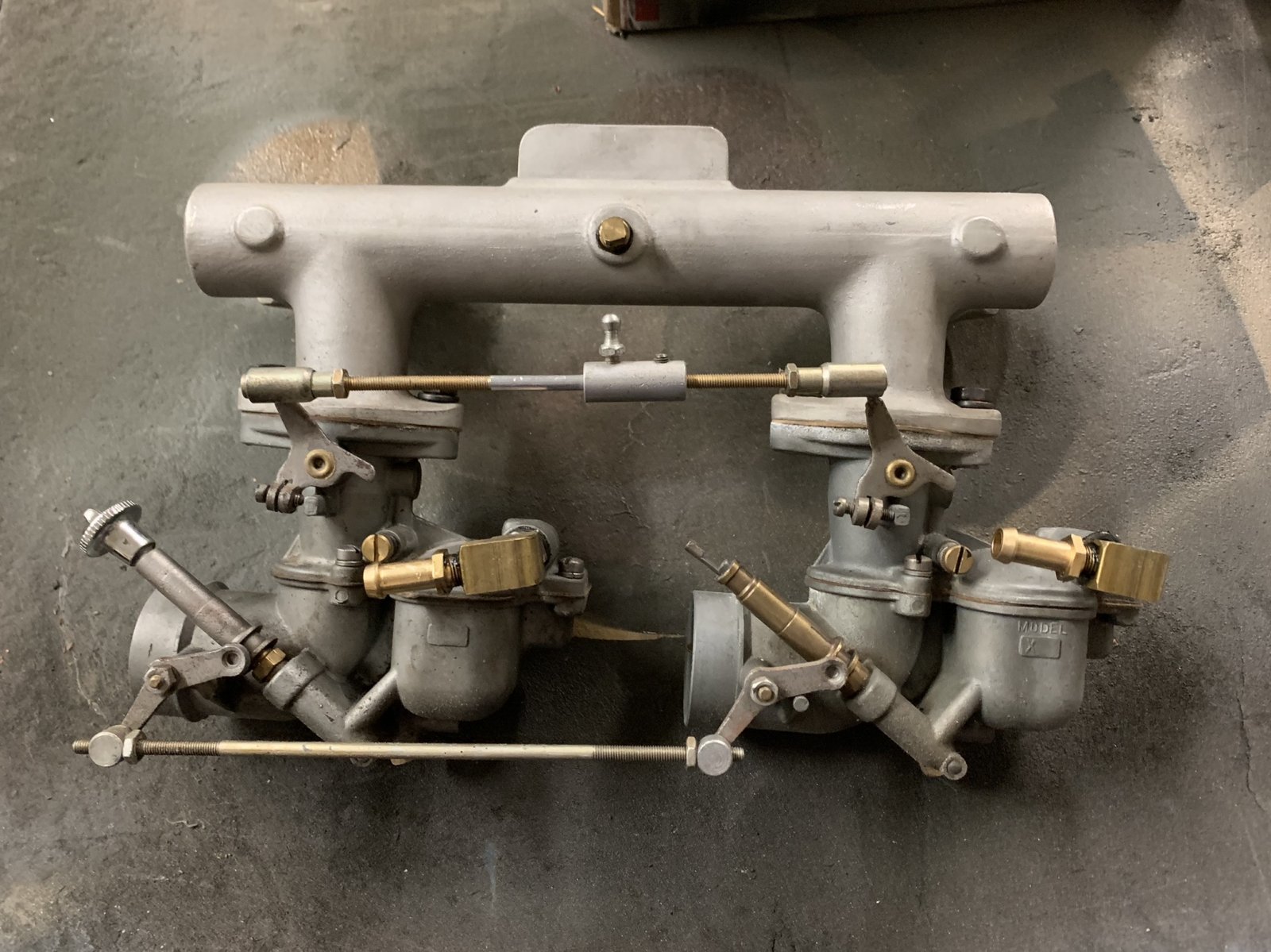

    I have a dual updraft but might put a down draft and 97 on this.

    Giving that new shop a workout...Great subject matter and love the bandaids of the past...I guess nailed it sums it up...:D...I'm in and thanks for sharing it here @Hitchhiker...;)
    brady1929, loudbang and Flootiebuell like this.
  5. It's the coolest. Though...you should know. Lol
    loudbang, Flootiebuell and Stogy like this.
  6. Yeah, It's obvious just looking at the nails that it was done ages ago. The car is super solid. I think it was a pretty original car before the paint that was then repainted again. Most of these replacement pieces were pretty common in my experience and we're gonna get everything just right on it, and then I'll force @Flootiebuell to go cruise with me.

    manyolcars
    It doesnt have a dropped axle! How does it sit so low in the front???

    Snagged this dual updraft set up from @2tall2beahotrodder Thanks for the hook up!
