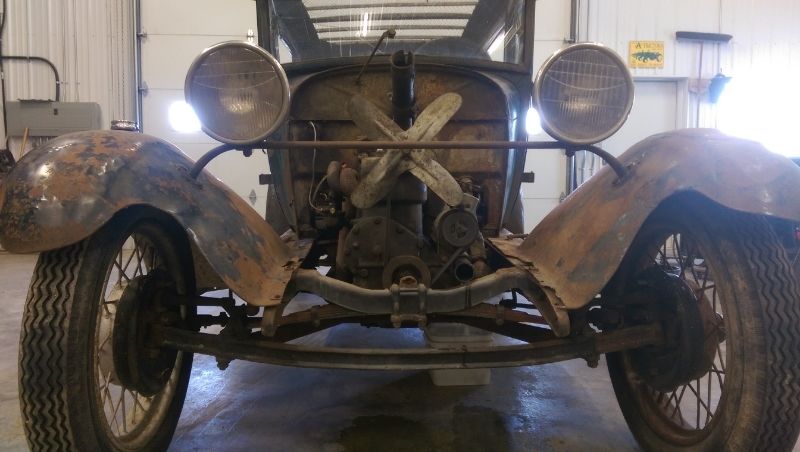

Well I've decided its time for the tudor to receive some love and attention. I pulled her out of a shed a couple years ago so it's time for a build thread! So far I have taken the body and put it on another chassis I had. It was in better shape and the motor already ran so I figured why not. It will save me time and money. I did replace the rad though with the one that came with the tudor. The rad that came on the chassis had a big ugly patch in it haha. She also needed some new rad hoses so those got replaced as well. I really want to keep it looking as close as possible to how she looked when she was sitting in that shed. The body is very solid so it'll stay as is, with an exception of a new leather top! The four banger will be staying in the car and hopefully sometime time down the road will receive some speed parts! The tudor will be getting the 16" wires she came with also. Future plans are calling for a stock interior, dropped front axle, T spring in the rear, and keeping the mechanical brakes. Now for some pictures........

Alright so a little update. Not a big one but it does put me one step closer to getting the tudor on the road. I got a new light switch box mounted and hooked up the headlights! I also put a new horn/light switch rod in the steering column.
Got a few more stuff finished over the weekend. I added a temp. and oil guage just for piece of mind. Especially since I plan to drive the tires off this thing haha. Had a hell of a time trying to get the screw out of the block where the oil pressure fitting needs to go but after what seemed to take forever and a few choice words I finally got it out! I also had to fix the exhaust. It was rusted out behind the clamp and I just happened to find a piece of an old exhaust system that was laying around. The new piece has a smaller diameter but it just happened to be the right size to slip into the stock exhaust pipe. The flange on the end was the right size though! And the finished product. Not the prettiest welding job but it'll do. I definitely need to get some practice in haha! I was going to give it a shot of black paint however it seemed there wasn't any spray cans laying around the shop.
