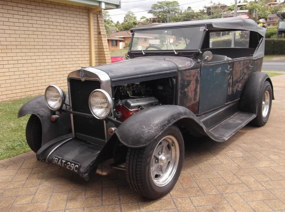

    I have a stock '28 survivor style Chevy, reckon it's different and super cool, but slipping a later Chevy drivetrain and front axle under it, with modern disc wheels and a rubber rake, would make a much more usable car of it. That would almost be a bolt on job and keep it looking traditional too.
    I love the look of the original disc wheels and they will fit later hubs, but the rims can slip round the centers and cut off the valve stems (been there!) so they won't work with any more power, or stronger brakes.
    I've put safety glass in all round, but the wood means it's hard to fit belts for the kids, I'm still working on that problem.
