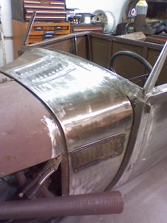

    Since theres a few hambers building rpu's i figured i'd post mine.Its a 28' cowel with prefabbed doors,cab and bed.2x3 square tubing frame,40' ford frontend,Dana 44 rear with 4:00 gears and a Uni-trax locker and with big ford bolt pattern (scored for $100).327 w/350 trans,Cut top of cowel and posts off and sank in a sedan windshield frame at an angle then cut top off. I bought a few sheets of louvers at a swapmeet for $10 and sinking them in as tastefully as possible.I also used a dash cut in half for each side of the bed.It should be fun with the locker and its 92" wheelbase....The small lil booboo was the 1" mis- measurement i did when installing eng/trans,..no room for the radiator...ouch...so after a few beers,and saying screw moving the mounts 100 times to a few friends, im going to mount radiator in bed.....But the real question is should I run the fluid in frame rails or run pipe?and why?

    tfeverfred
    Those are interesting locations for the louvers. Are they functional?

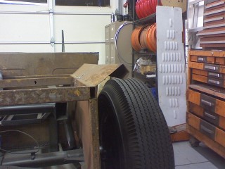

  4. slamchop
    Joined: Dec 8, 2002
    Posts: 273
    slamchop
    from San Diego
    Heres a pic of the bed sides then i cut an old dash in half and just used it to look better from behind,not really a stake pocket,but now you mention it i could make a pocket.The louvers are mostly for looks but are cut into cowel and tank.Im not using stock tank and also cut a door on right side of tank under dash and am using the cavity in the tank as a glove box.

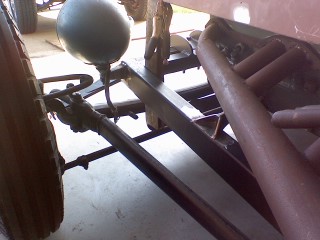

  9. slamchop
    Joined: Dec 8, 2002
    Posts: 273
    slamchop
    from San Diego
    Thanks guys,heres a pic of the frontend,just piecut the outside of the wishbone and pulled the cut shut to keep the front spring.I'll definately call you Jimmy if I run into any snags,gonna hit the wrecking yards this week and look for a radiator.As always its a budget build...I figure when im done i'll have $2500 into this.

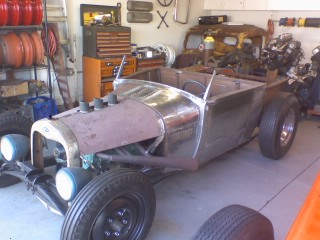

  14. slamchop
    Joined: Dec 8, 2002
    Posts: 273
    slamchop
