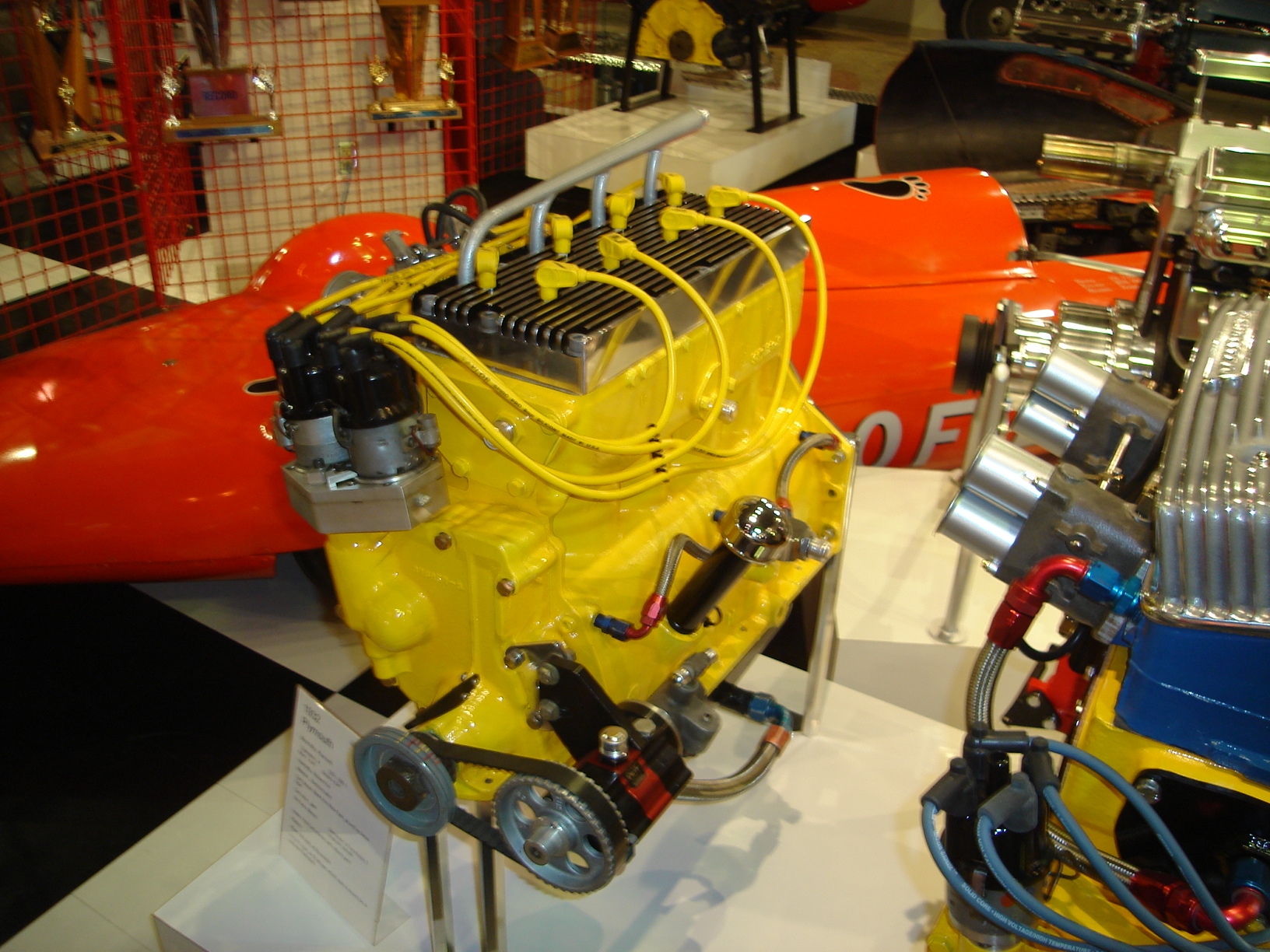

    Joined: Dec 3, 2006
    Posts: 10,020
    RichFox
    Here are pictures of my hotted up 26 Dodge Bros banger (Yellow head) and my OHV '32 Plymouth banger (Blue Y block head). It can be done with a little work. Not a lot of money and some machine knowledge.
