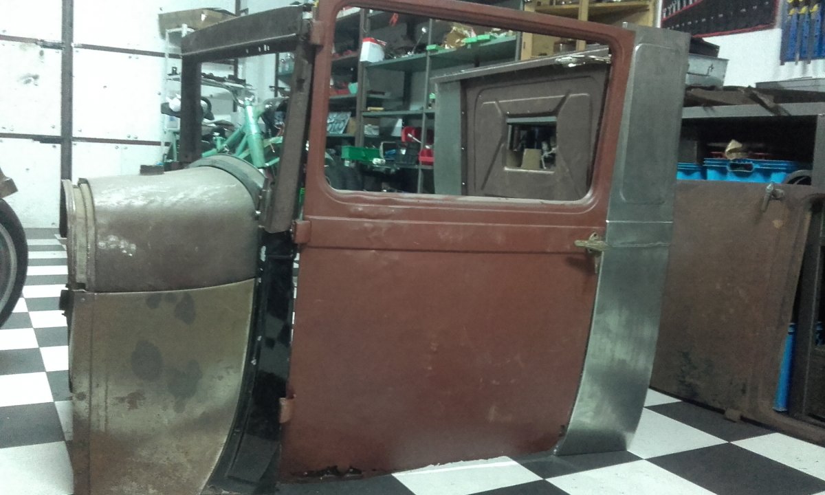

    Hello everyone, let me introduce myself. My name is Lukasz, I live in Poland. I'm not a professional, I just love hot rods. I have been on this forum for several years, that this is my first post. Sorry for my english and not good pics. I read a lot on this forum, watched and learned a lot from you. Before I built some bikes and decided to build a hot rod pick up. It was not easy. I woud like to show you my work, my story. I will be grateful for any technical comments.

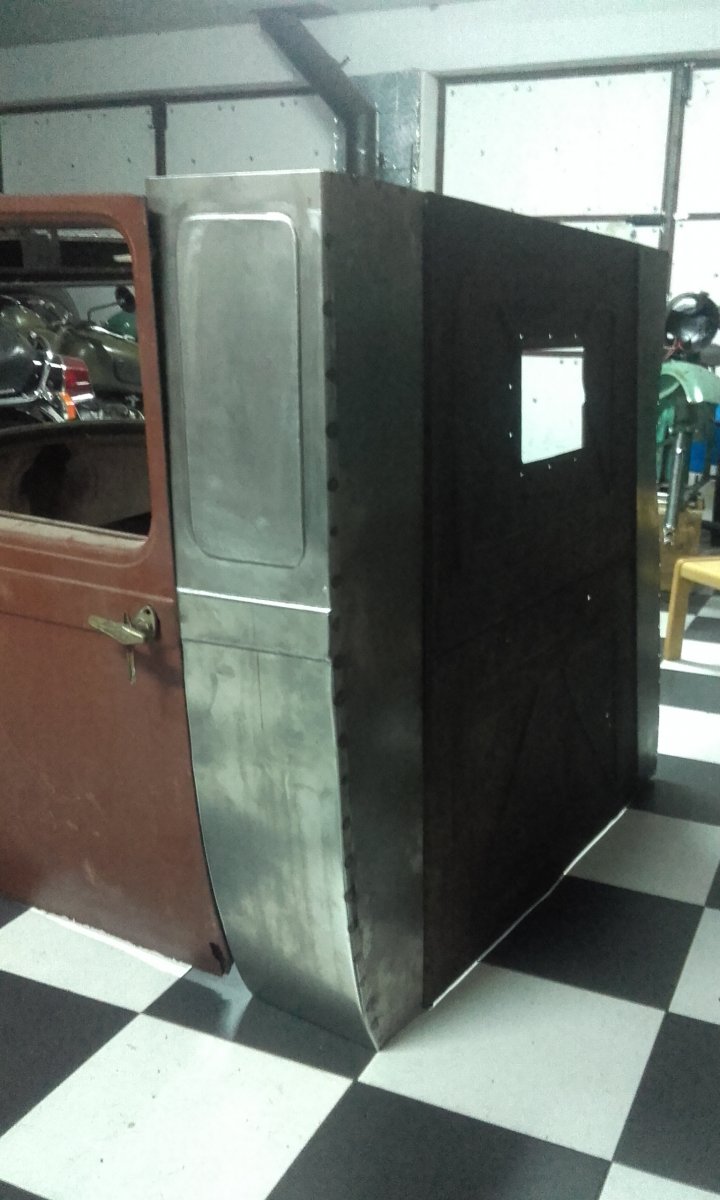

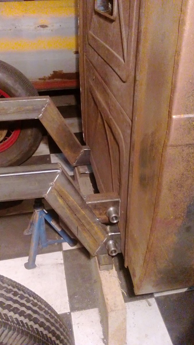

    I think I started in 2010. First, I was buying various Ford 1928 parts on ebay. The first parts were a roadster cowl. Then I bought the door from the coupe model, the rear wall from the pick up. I made corners and did the first fitting.

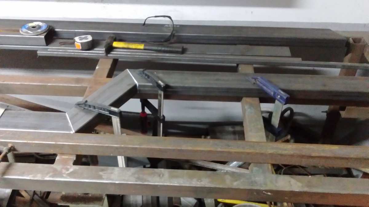

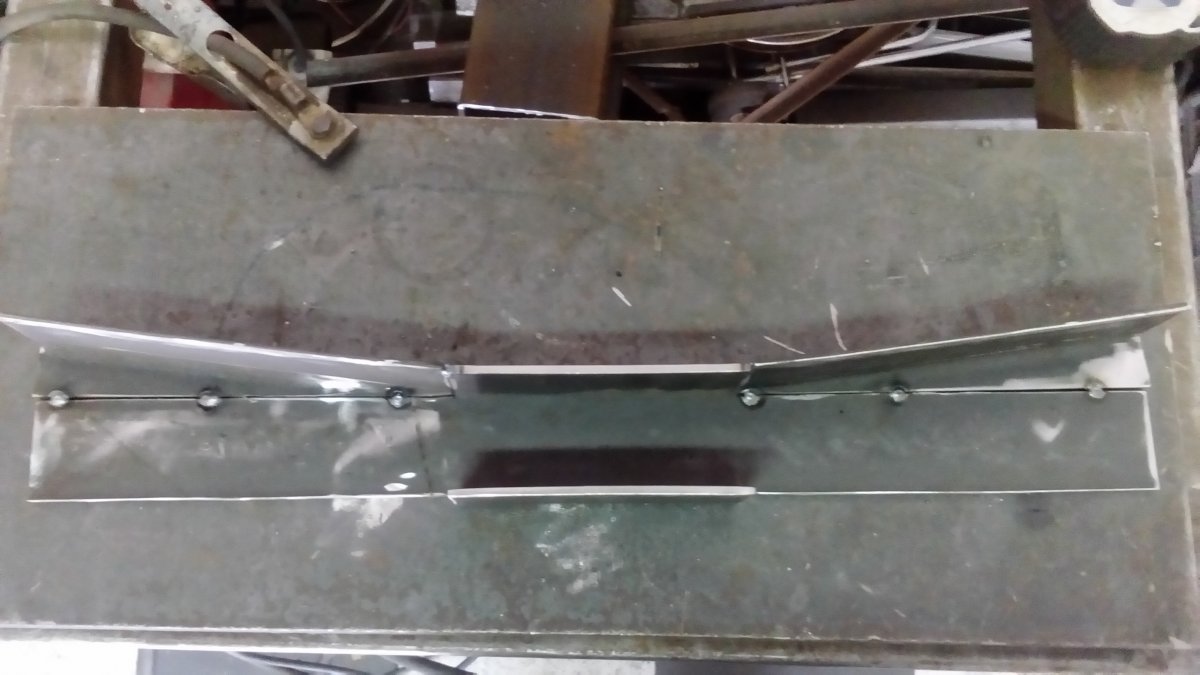

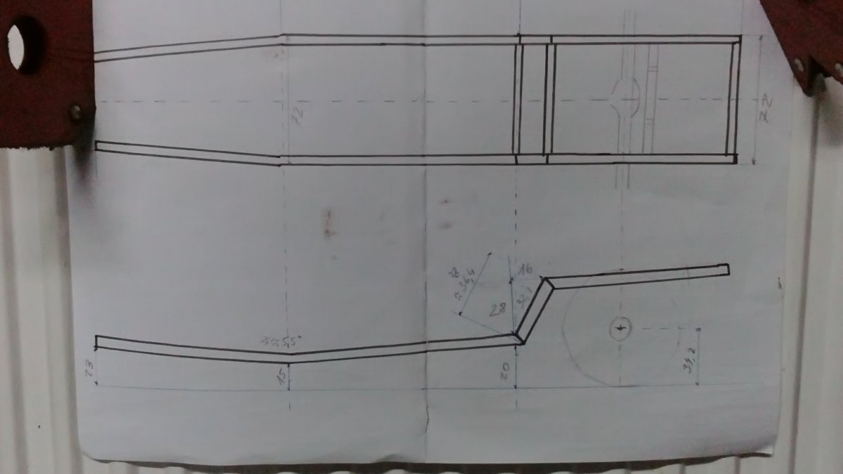

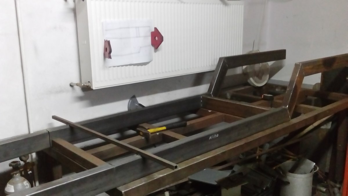

    Next I designed the frame and made it.
  3. el_coyotte

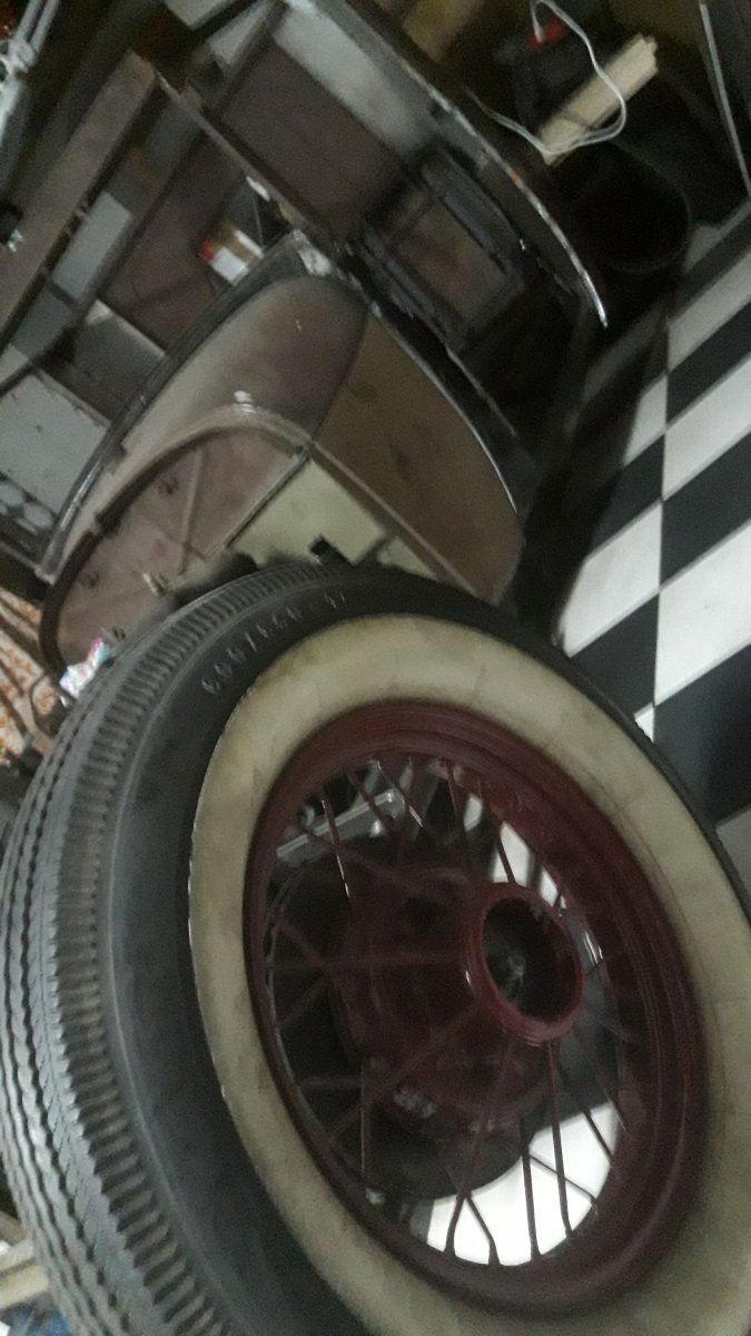

    I accidentally bought 17 wheels from an old Ford. I restored them.
    I was assembling the cabin and doing the first fittings.

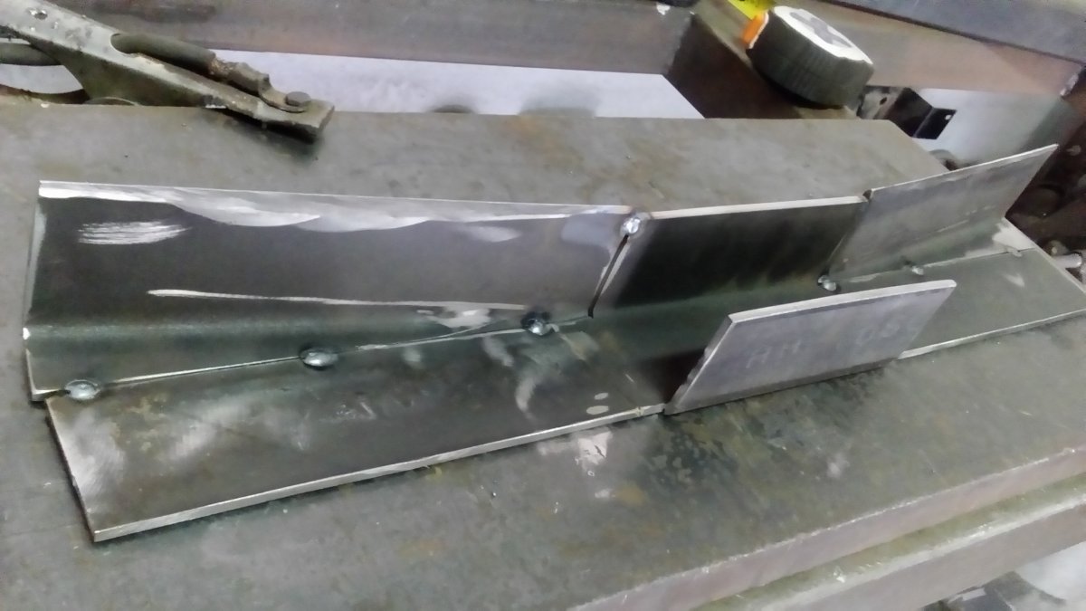

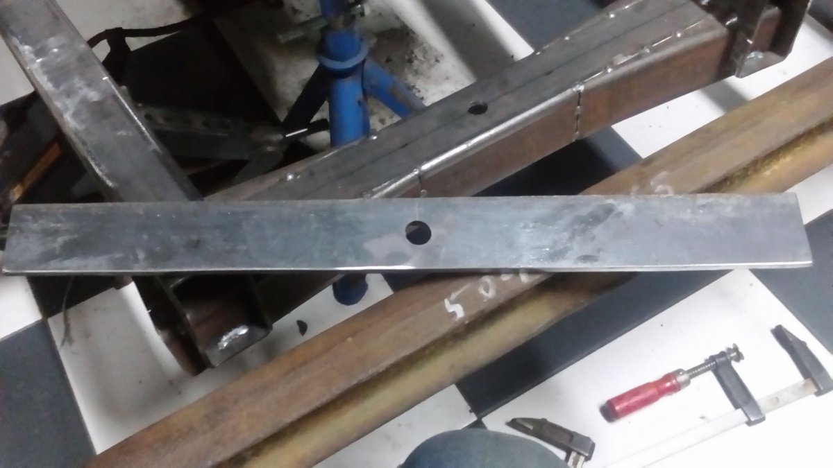

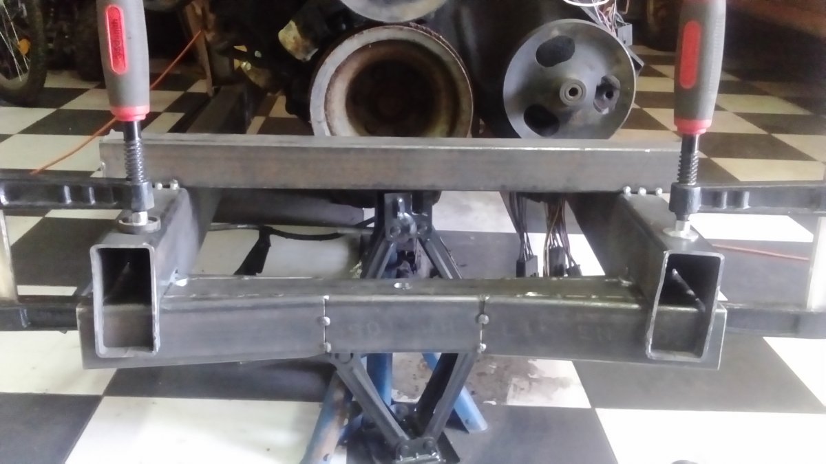

    Then I made a crosmember out of a square tube

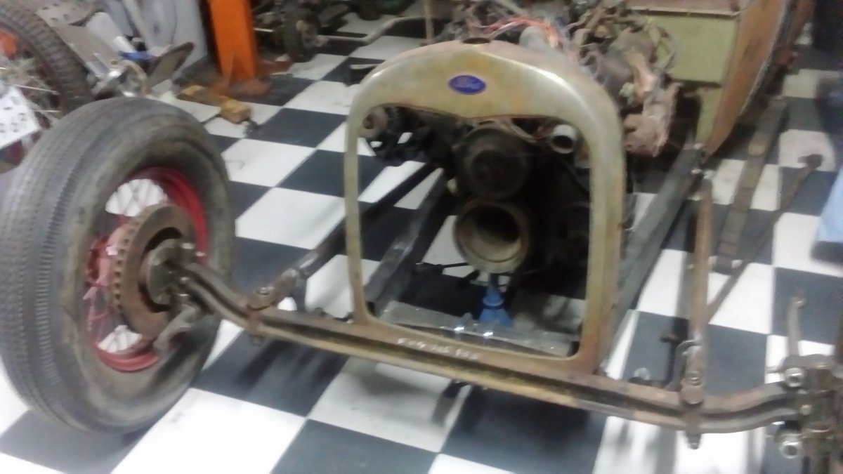

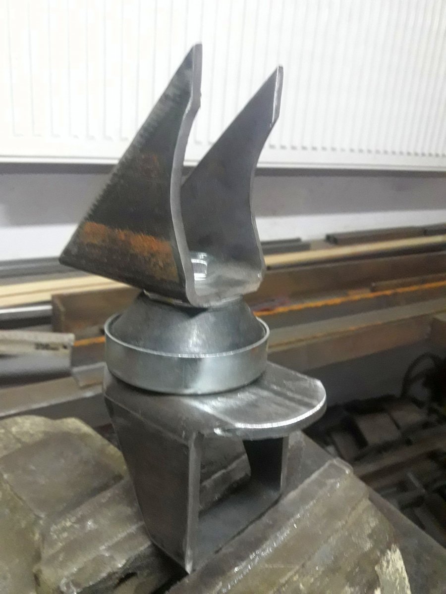

    Thanks anothercarguy! Next I made front spring holder and fixing the spring to the wishbones to suicide front end

    And something like this arose. The work is ongoing

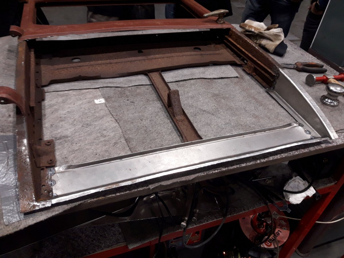

    Working with the door. 2 years ago during The Retro Motor Show in Poznan I was showing how to reapir old door. By the way, I did another job with my hot rod

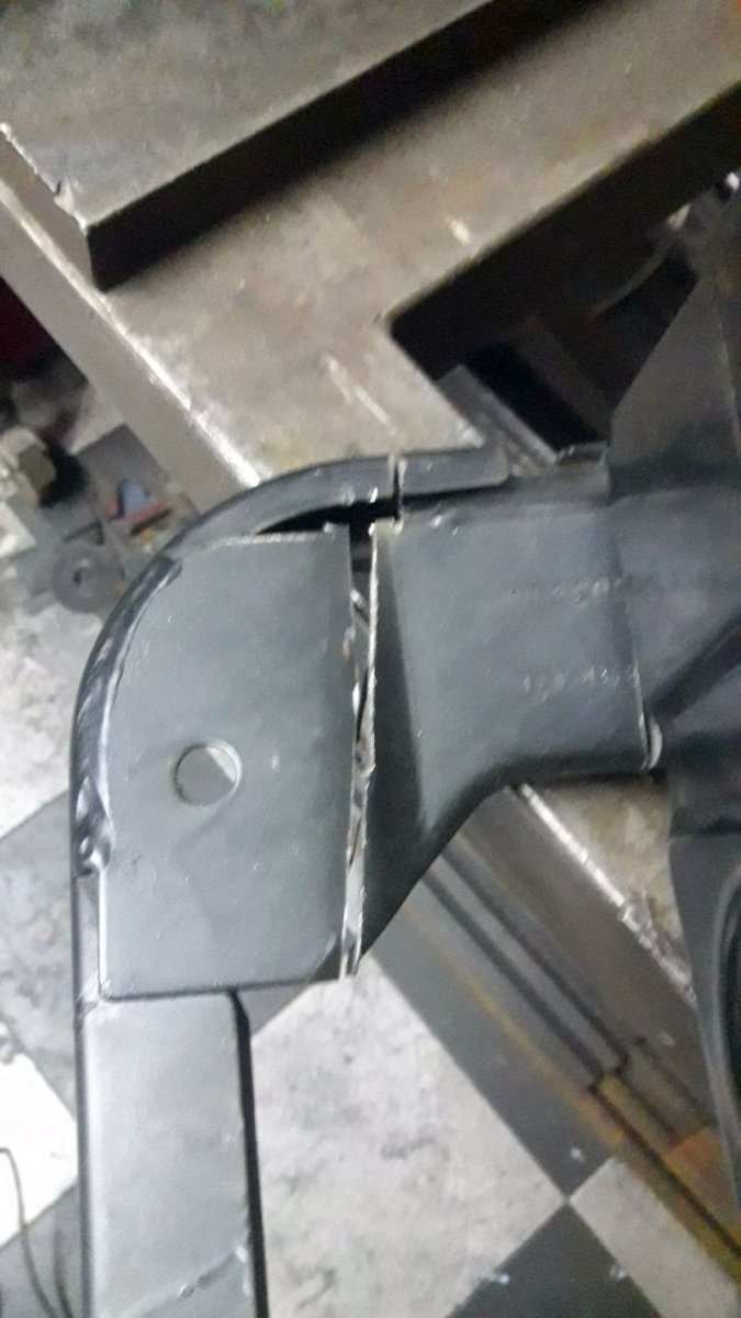

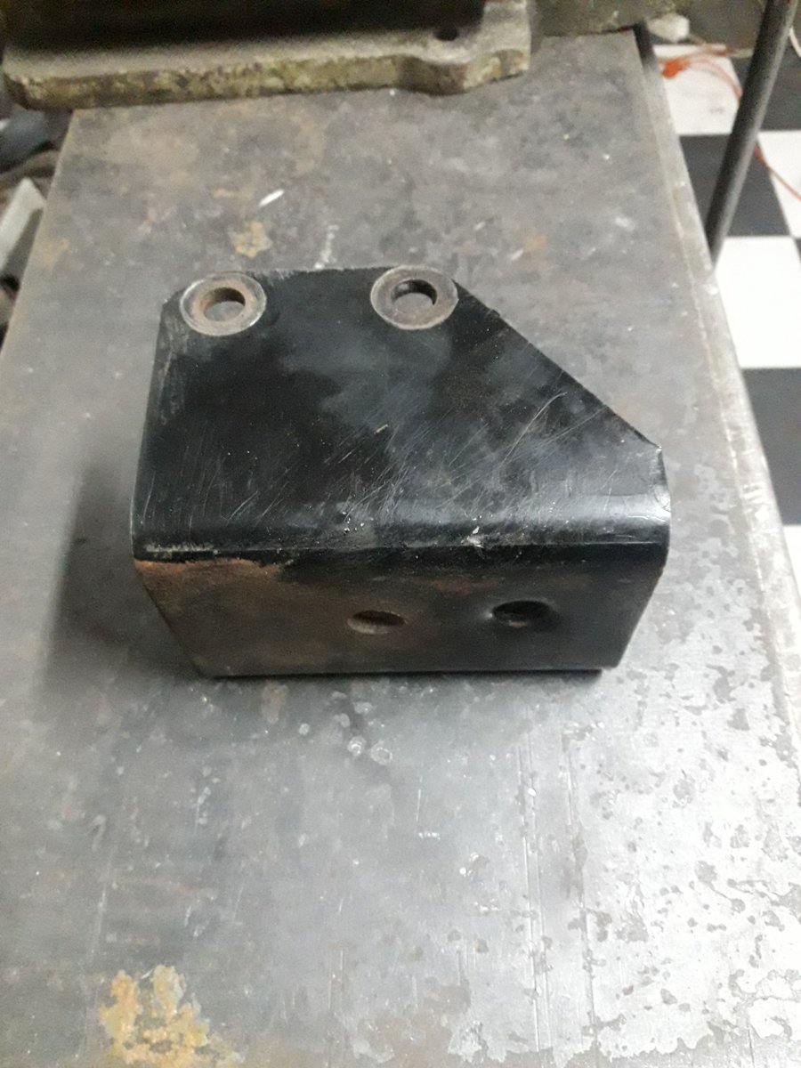

    The heart of my ride will be mopar 318, taken from Dodge Ram Van 1989. I did the motor mounts from original motor mounts, square tubes and engine pillows from russian offroad car - Uaz 469 (I think, it was copied from Ford).

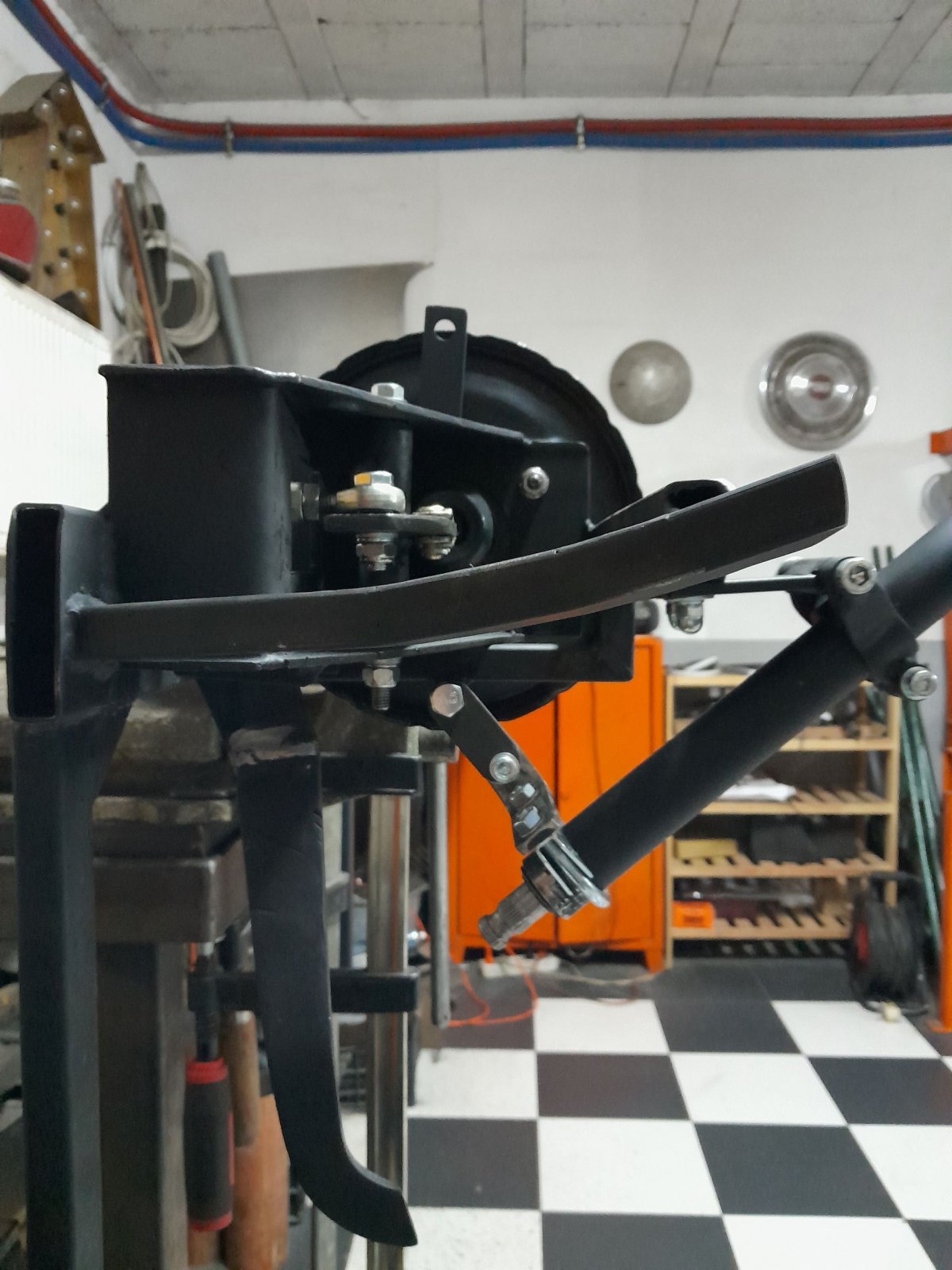

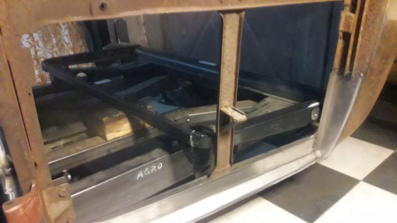

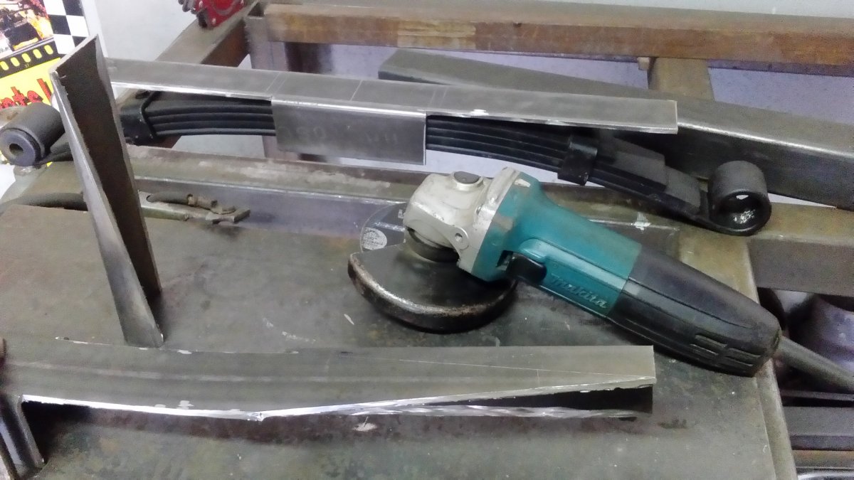

    Easy way to have a seat - modify what you found in the scrap. On the fourth pic you can see left side of seat before modification and right side after work.

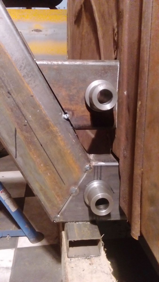

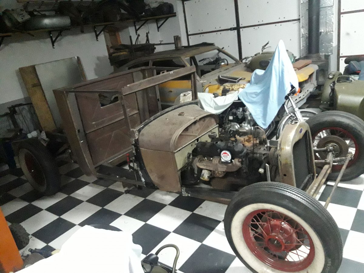

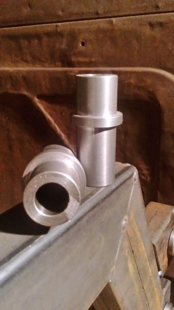

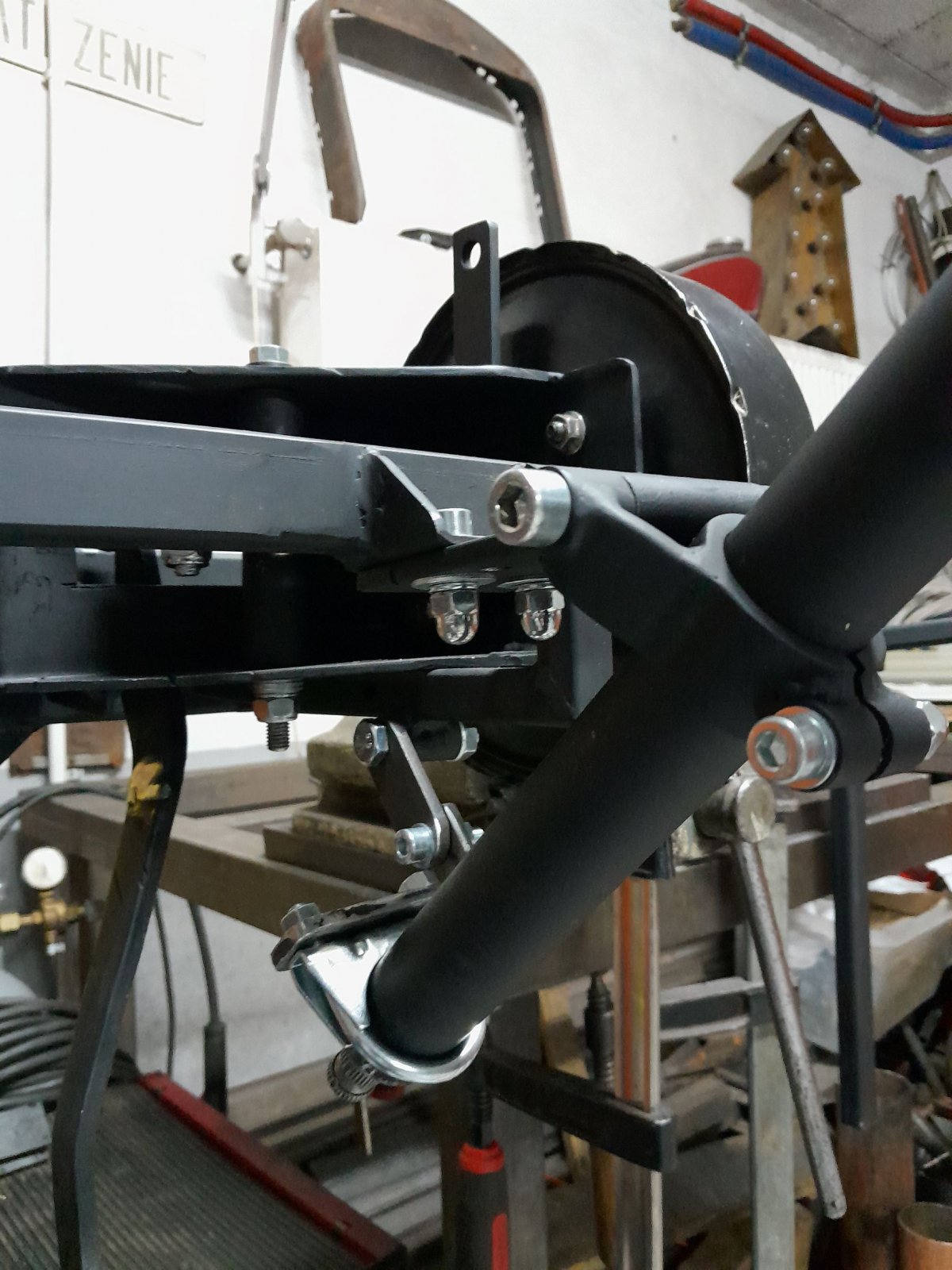

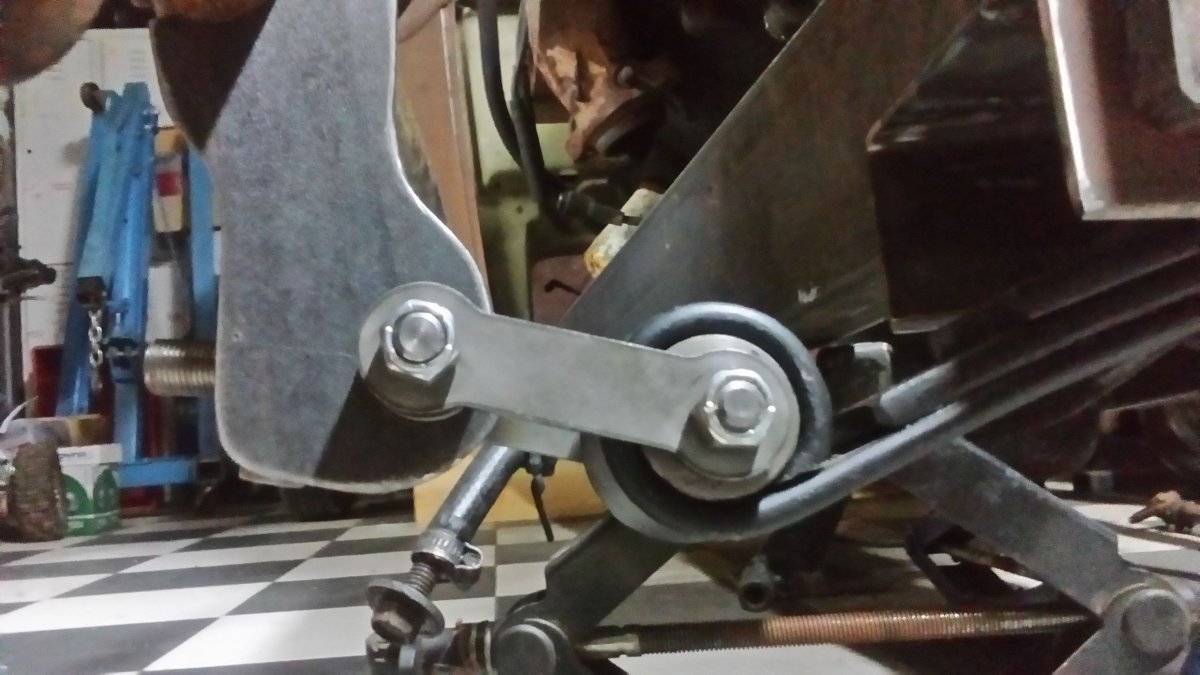

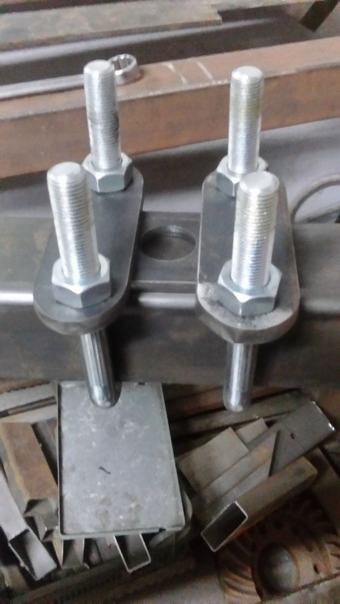

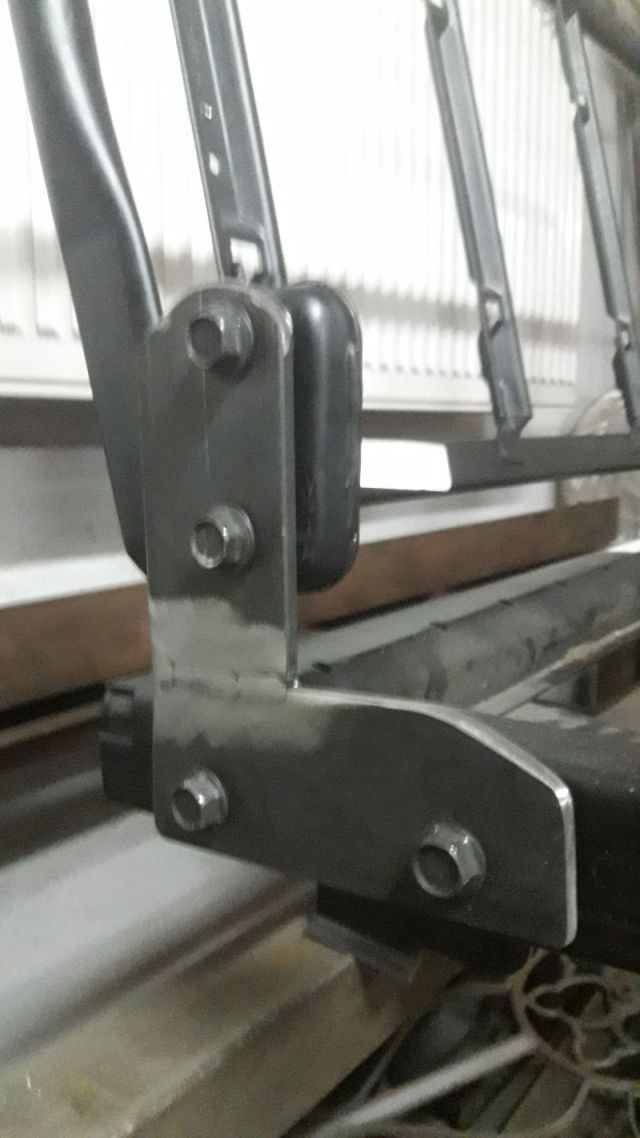

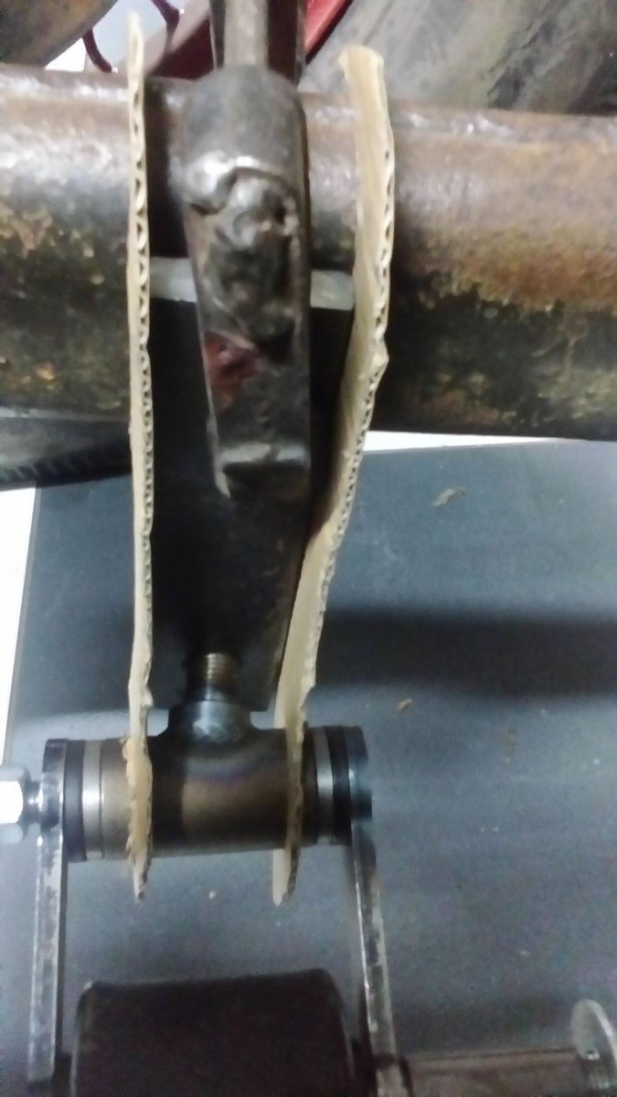

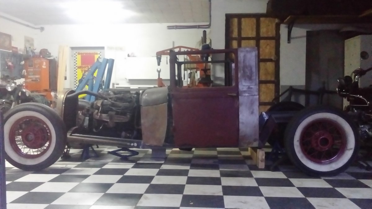

    Today I continued work with rear end, it's not finished yet.
    ....... and I have a problem with rear spring. When I lowered the car with the jack to the ground, the car sat down.. The shakles are not in 45 degree position. Spring is oryginal from Ford T. I think is to weak...
    Before lowering car:
    and after:
    Has somebody any ideas? I also would like to ask, Is this handle strong enough (bought at Speedway Motors) ? What you think about it?
    fiftyv8 likes this.
  22. goldmountain
    Joined: Jun 12, 2016
    Posts: 2,568
    goldmountain
    Looks like you should mount the spring hangers on the rear end further apart. Good thing they are just tack welded.

  23. el_coyotte
    Joined: Jan 23, 2008
    Posts: 24
    el_coyotte
    Thanks for good idea! I'm afraid of the trouble with installing the spring in this case. if I increase the distance between the spring hangers, I think I should make a spreader to install the stretched spring. Am I wrong?
    Another think is - isn't the Ford T spring to weak?? I can remake the spring - extend the last 3 leaves of the spring. It should then be harder. It unfortunately costs a lot..... For me better is mount the spring hangers further apart.
    Can you Guys comment on this please???
  24. Aaron D.
    Joined: Oct 27, 2015
    Posts: 883
    Aaron D.
    Yes, I would mount the spring hangers further out. T spring should be plenty strong. I would disassemble the T spring and mount the main leaf first so it's easier to spread, them reassemble the other leafs on the spring.

  25. el_coyotte
    Posts: 24
    el_coyotte

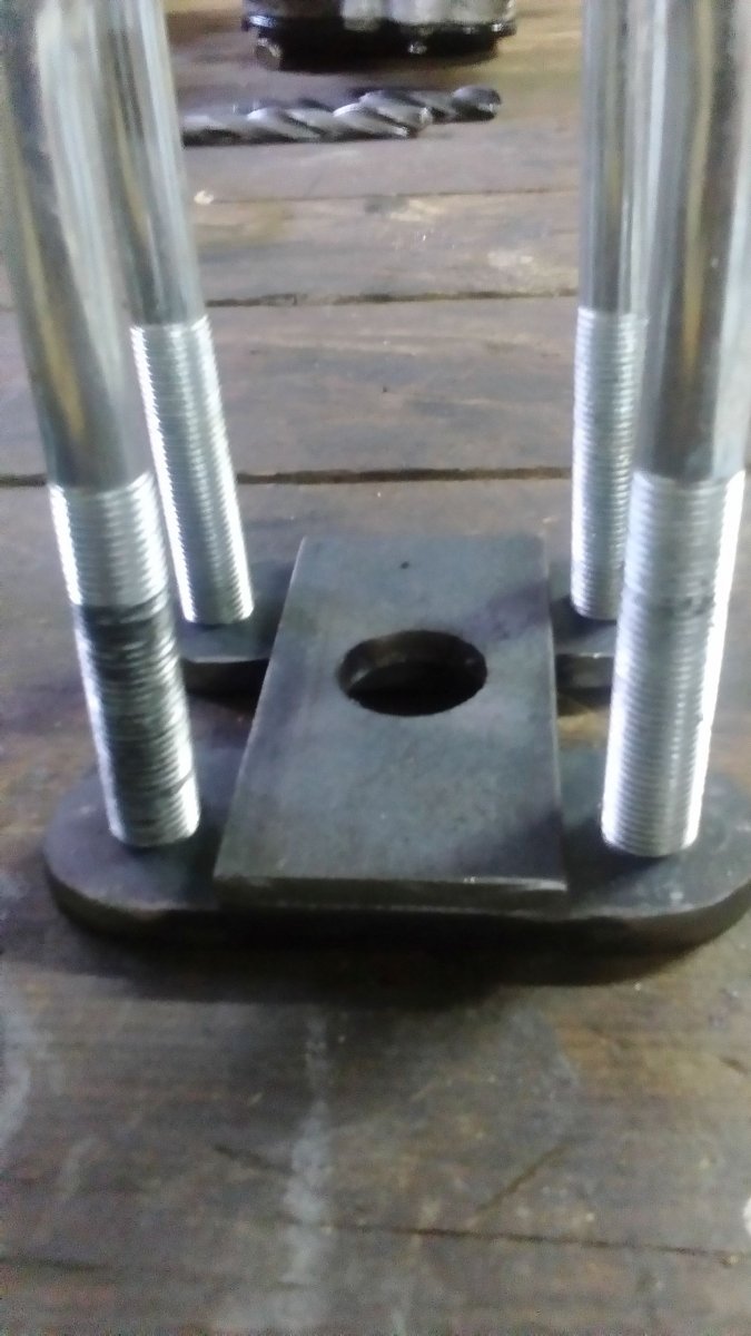

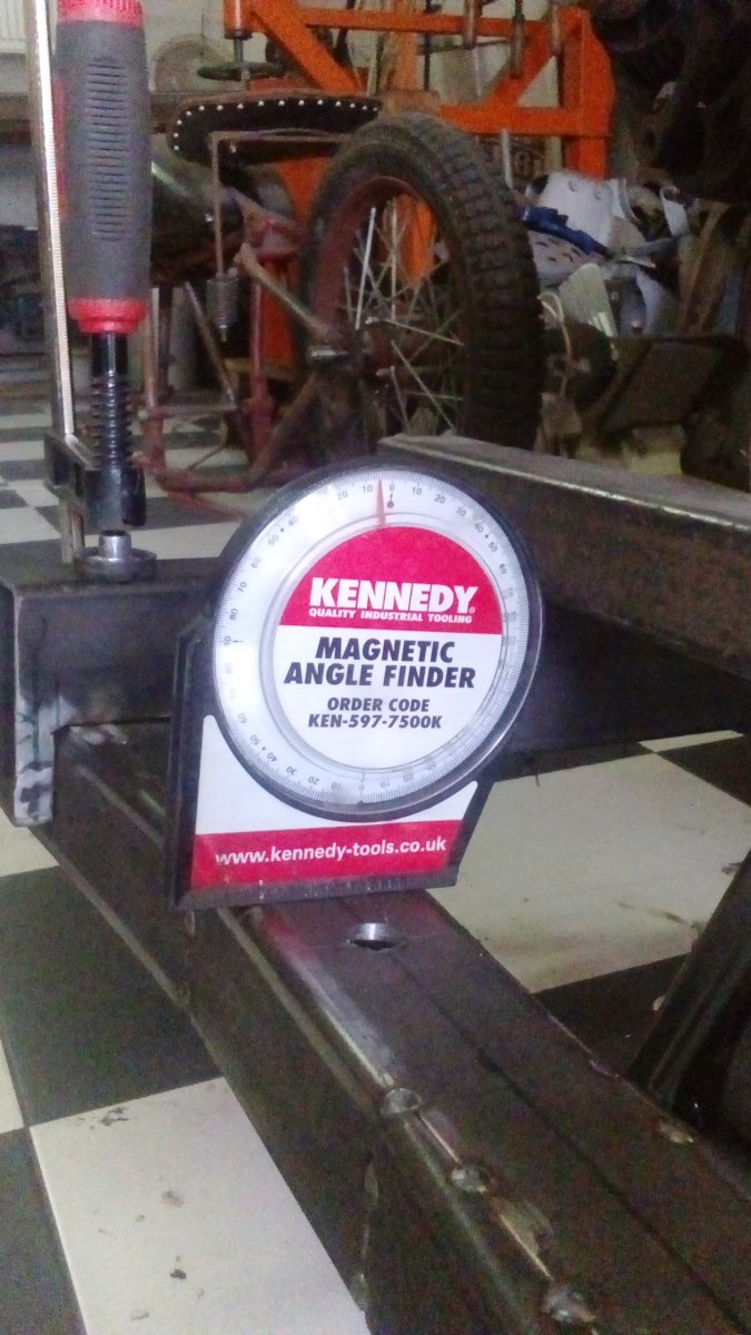

    I decided to make a spreader to stretch the spring. Next I installed a stretched spring. Now spring is in a position as if she were weighted by the weight of the car. This way I can determine the exact height of the vehicle. The lowest point of the car is about 5.5 inches from the ground. I set hhe spring shackles at an angle of about 45 degrees (as under the vehicle's load). It remained to adjust the rear axle with the wishbone adjustment screws so that the spring and its mountings were on one axis.
    I am not sure if it is still possible to lower the vehicle below 5.5in for safe daily driving. Before he welded the handles, I would like to ask what do you think about it? Will it be ok now?
    tb33anda3rd likes this.
  26. Weedburner 40
    Joined: Jan 26, 2006
    Posts: 766
    Weedburner 40
    The brackets (handles) appear to be strong enough but, you will need a gusset from them to the housing to keep them from bending.
