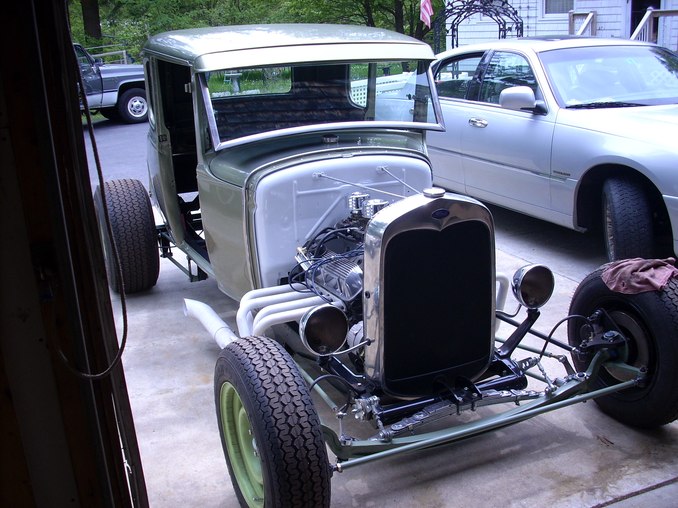

    sheetstock I got ,cut to fit,and painted black.It had tons of small 3/16 holes so it didn't restrict air, but hid the radiator pretty well. I tried a chrome stone guard, but it looked really ugly ( to me anyway) Camera 2-20-09 095.jpg

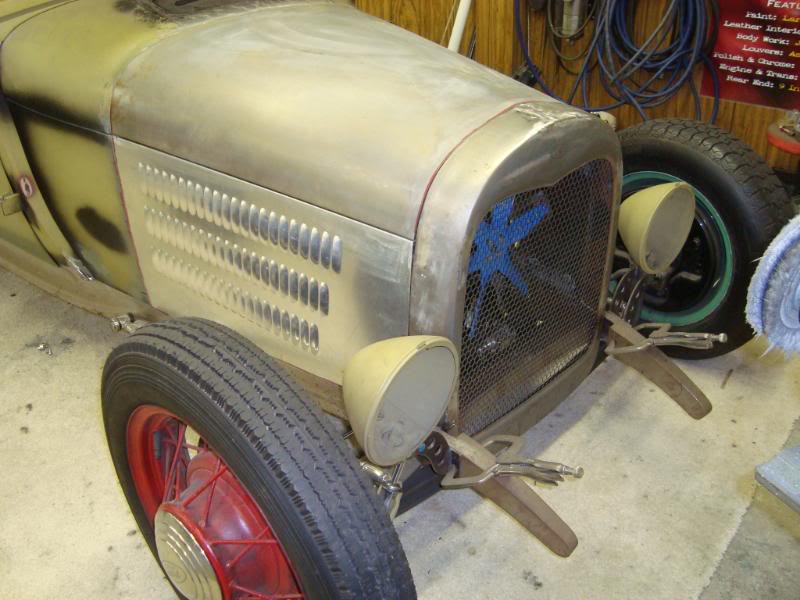

    My '28 Ford grille insert started life as an office building'’s ventilation duct screen. I plucked it from a dumpster during a coffee break, took it home and trimmed it to fit.
    I welded four machine screws to the back of the grill shell to attach the screen.
    ... …and washers to the screen to reinforce it. Locknuts hold it in place and a coat of black rustoleum makes it look good.

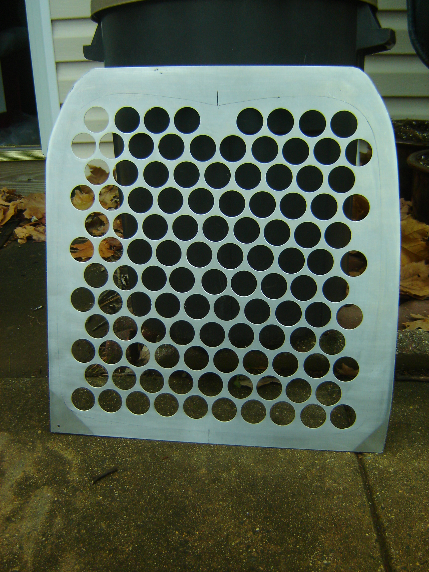

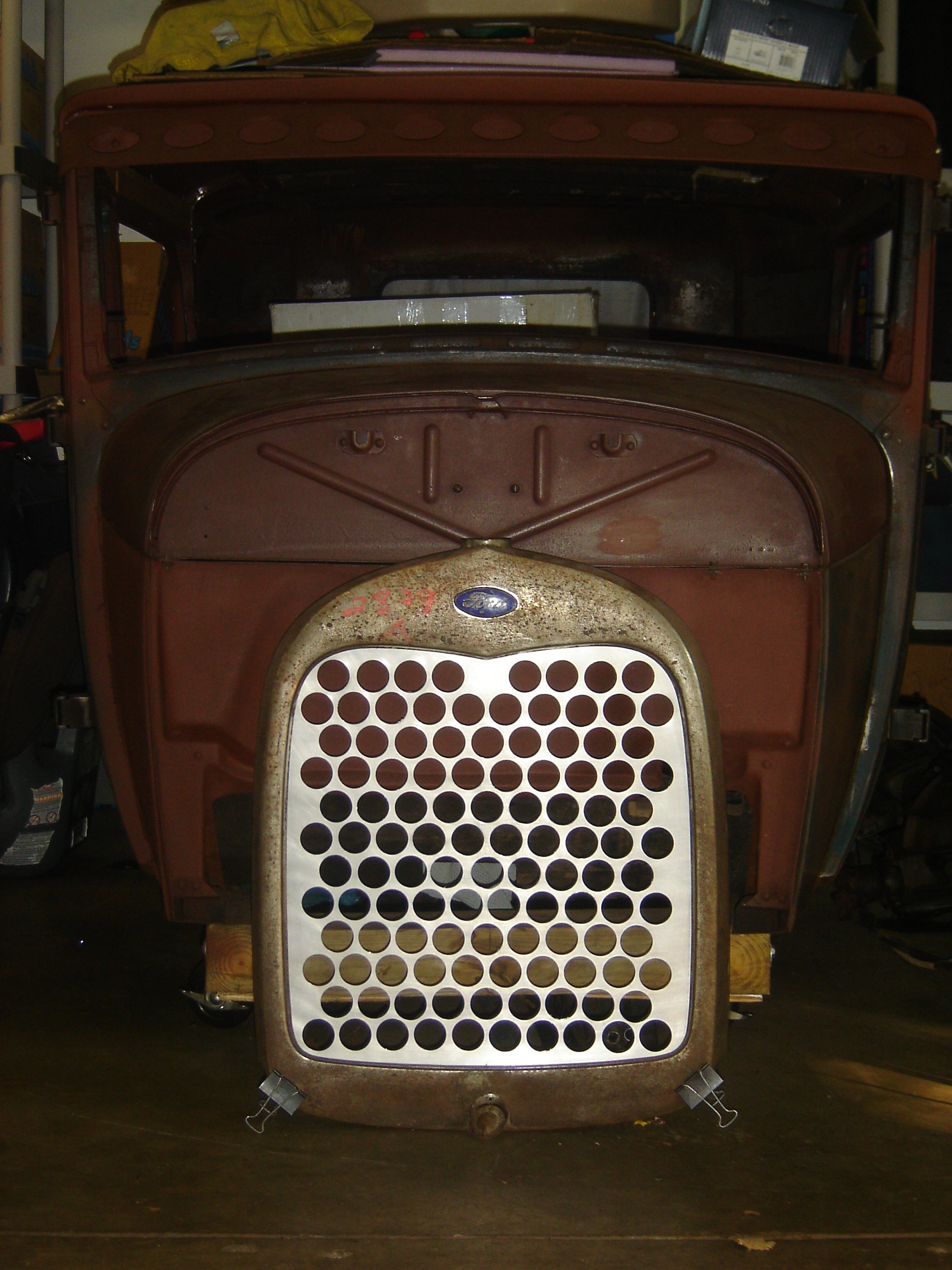

  12. I've also tried the "lightening holes in a sheet aluminum insert" approach, but it won't hide the radiator so well. I think the holes were 2 1/4" diameter. gril 05.JPG gril 04.JPG

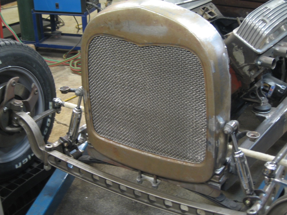

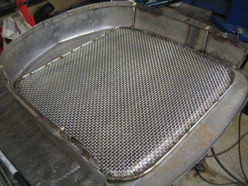

    I made one from #4 stainless steel mesh for my 26 RPU.
    It hides the aluminum rad nicely and I think the stainless mesh will look nice in contrast to the blue paint I'm going to use.
    Plus it will protect the rad from damage.

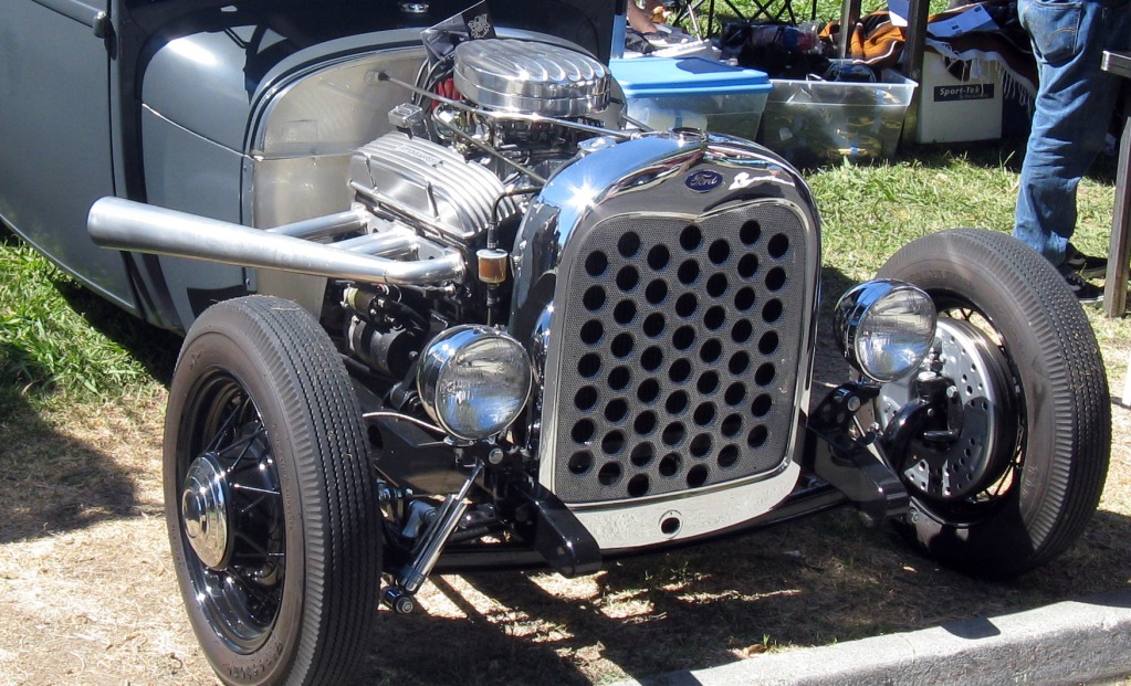

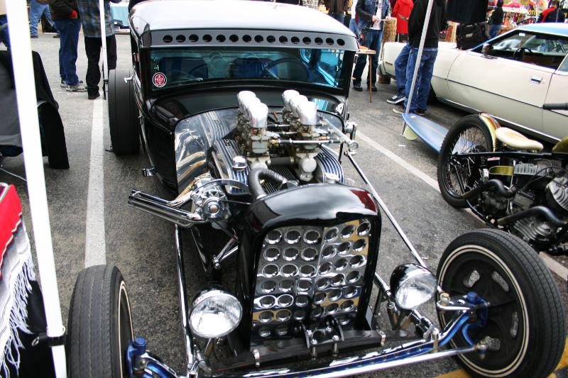

  14. Here are some more ideas I've plucked from the HAMB. Hope they help.

    Super nice job on this one! Gary
