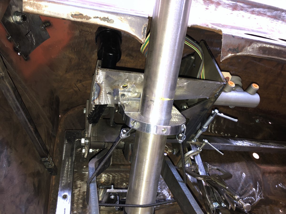

    on the gas pedal location you could try tacking on a plate like this drill holes 1/2" apart and tap the holes.easy then to get the position correct.i say drill the pedals too. I was able to incorporate a return stop as well,

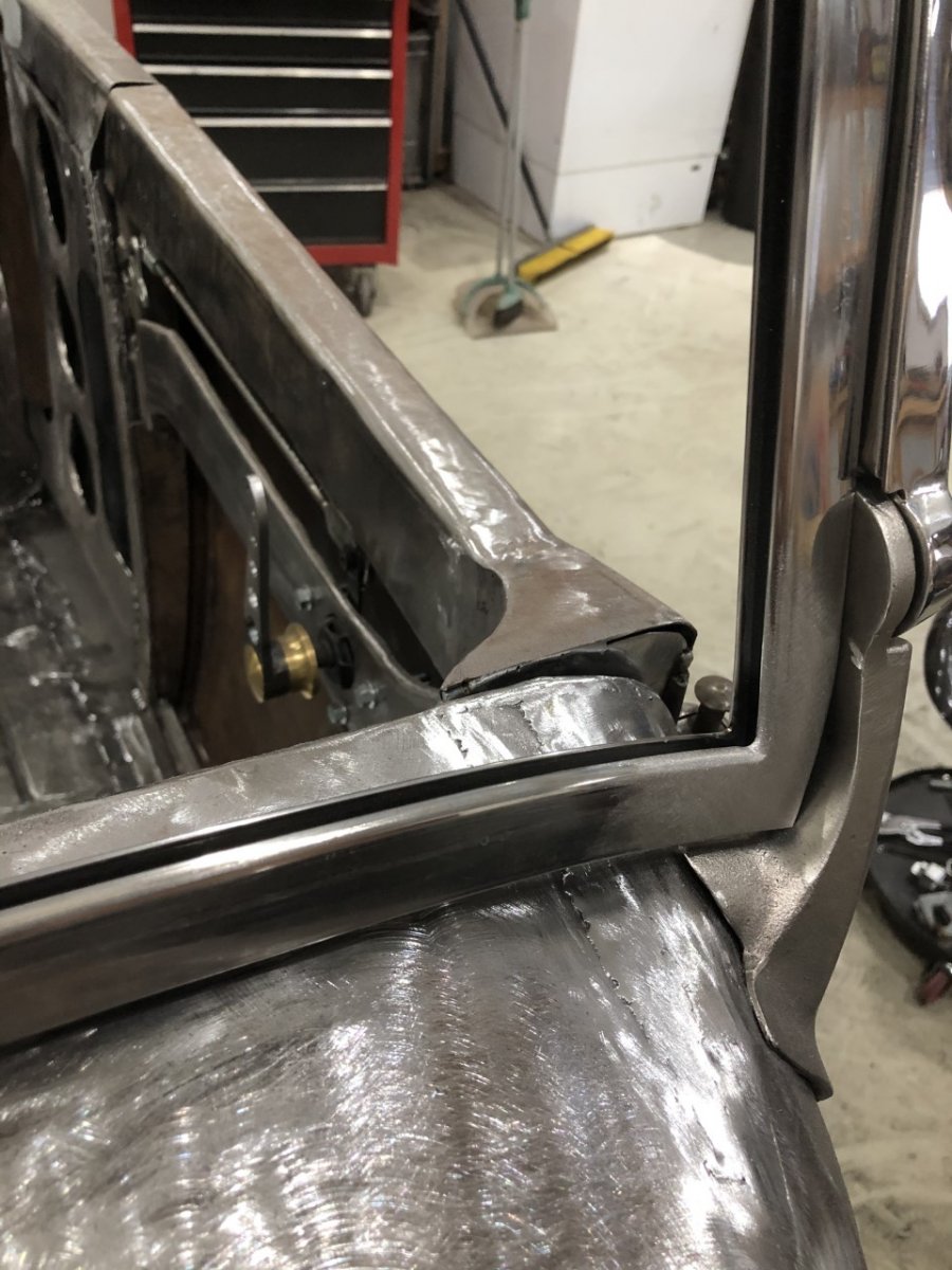

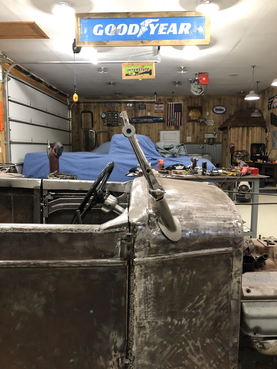

    I wasn't found of the stanchion to cowl to A-pillar transition into the doors so I went after it again. The 32 ford lower stanchions did fit the curvature of the cowl so these new patches had to have the complex curve put into them. At the suggestion of the a fellow Hamb'r, I also moved the windshield. I had to buy a new frame since I narrowed the first one too much. This time, I took .880 out of the width. I re-posted the original position for reference IMG_0208.JPG thumbnail_B197F1E4-4F32-440C-8E54-890195A5BA06.jpg

    Here is a picture of the piece I cut out. Behing the stanchion is a 3/16 doubler plate that is welded to the A-piller. I also rounded our the top corner to get rid of the sharp corner that I had before. thumbnail_08940E7E-8E52-418E-A645-B7C91BBC15DB.jpg thumbnail_79B776CC-E108-4EDE-B016-FCAE4A66D04E.jpg

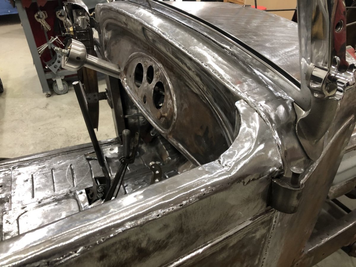

    Lastly, a few shots of the next task. Fix the door blend into the cowl. This will take a little thought as well. I am slow so it'll take me a few days to think about how I am going to do this. The radius ends right at the top hinge so I think this will work out but it could result in a pretty narrow point on the inner most portion of the door where it meets the dash. thumbnail_D407BFB6-02EF-41EA-BEA3-90EC50733D79.jpg thumbnail_69B1768F-6676-440E-9E4B-74EBDE2FED29.jpg

    I spent a little time fiddling with the door top this evening. I cut the old out and rebuilt it. Here is the before and after. The top cap is only tacked in place so there is still a fair amount of finish work to do. What do you think? DSC02598.JPG DSC02626.JPG

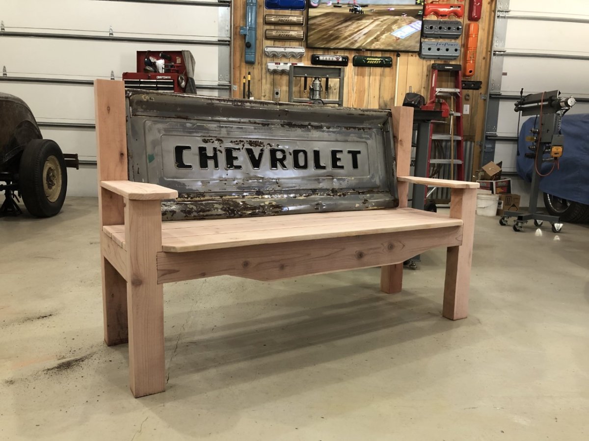

    Well not a ton of progress on my project. Between work, tuning up motorcycle, and some honey-do projects, I've gotten very little done. The wife had me finish a tailgate bench she wanted. The isolation thing has made it a pain to get the sealer I want so that'll have to happen whenever its delivered. bench.jpg

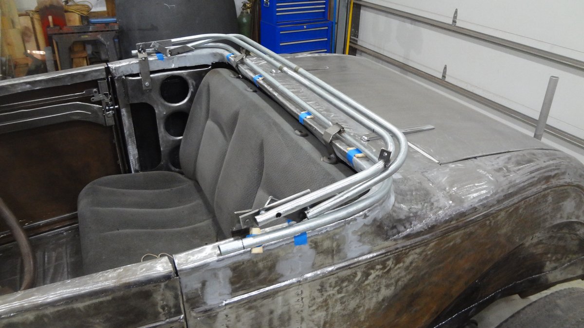

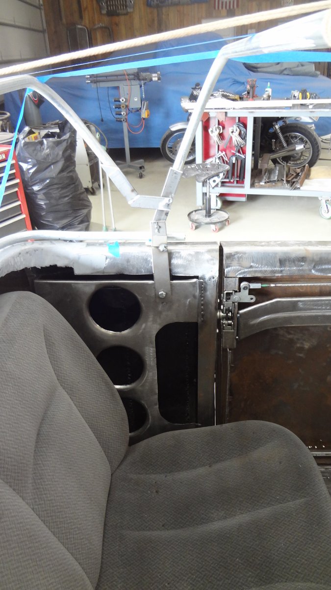

    I really do no enjoy working with wood but I figured since I had all the tools out, I might as well work on a folding top for the chevy. I know this is way out of order for the build but in my case since everything is scratch built, I wanted to make sure I had all the mounts in the proper place before I got into serious bodywork. The top bows have slip fit in the center and fold rather nicely so I think the fold and stow will work just fine although I really have no plans on ever running with the top up...... its a nice option to have just in case. DSC02630.JPG
    Tim, Nailhead A-V8, brEad and 3 others like this.

    A couple more pictures of the roughed in top. I still have a lot of finish work to complete on the brackets and front header. The header is Poplar and is slotted for the window and clearance for the upper stanchions. I still need to add the pins and latches. The bow across the back is mounted in four locations and I am planning in running a simple wing nut for easy removal. DSC02638.JPG DSC02637.JPG DSC02632.JPG

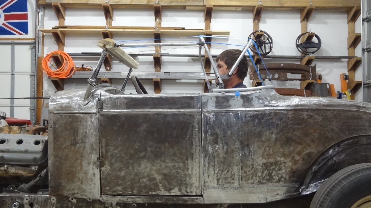

    Here is a side view with a driver. The head room is still pretty good and the top lines aren't too blocky. I might end up tweaking the bow lengths a little more. once I start the finish work on the top bows and header. DSC02636.JPG

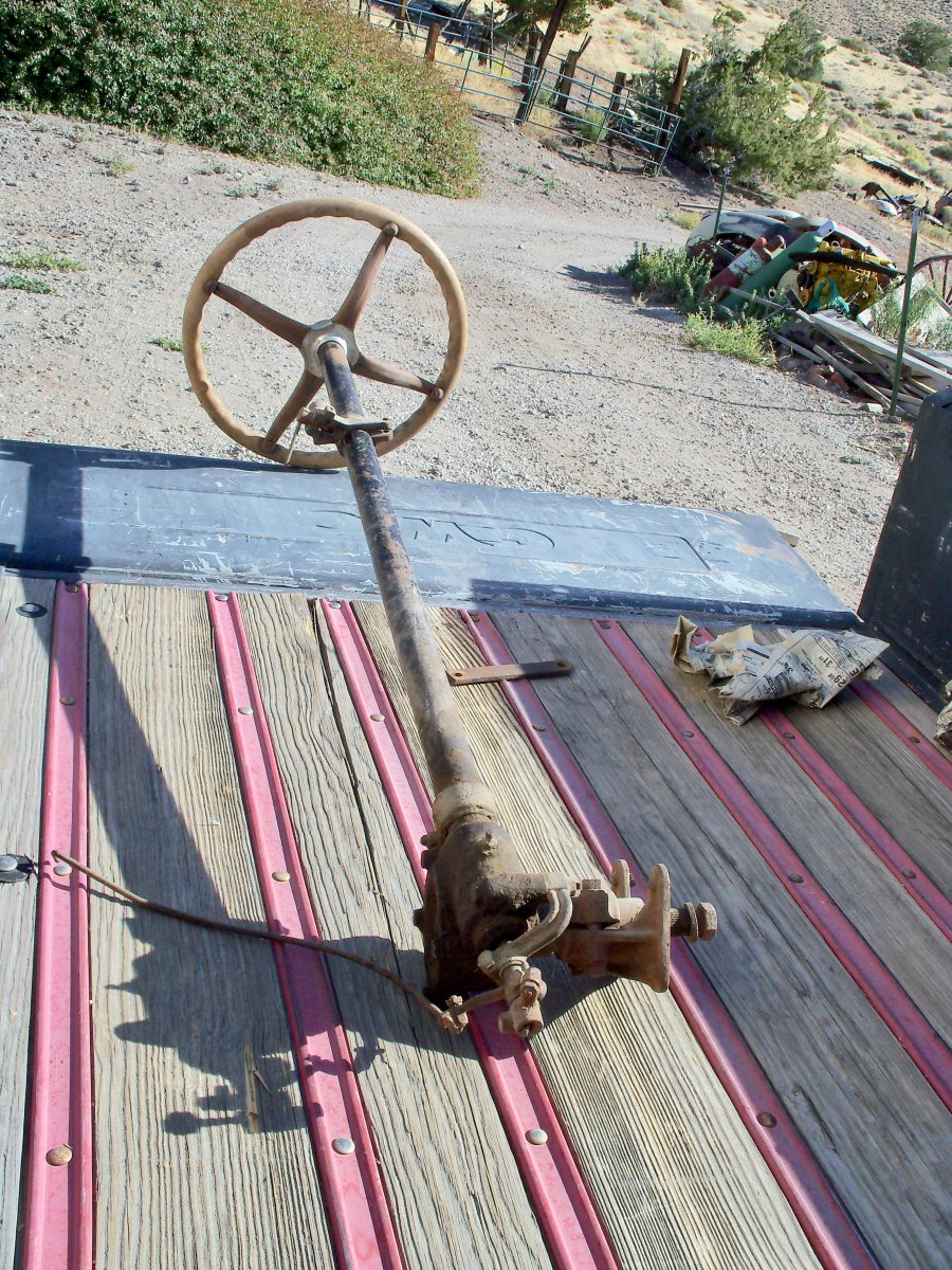

    I'm not exactly sure what year this Chevy steering box is but it fits the stock mount on my '25 frame, which is also the back of the left front spring perch. The original mount for this box is still on it in the pictures. With this mount system the box can swivel in the mount for some adjustment. Since '28 was the last four cylinder but they lengthened the frame in preparation for the six cylinder this box and columns is obviously a '28 or later. Your original may have been much the same. The '50s truck boxes are big and heavy. I had planned to use one too.
