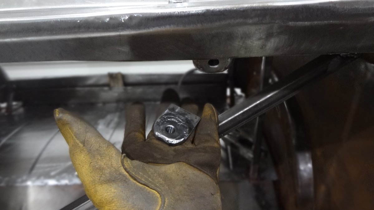

    I also made some quarter panel bracing. These might be overkill but I wanted those B-pillars to be rock solid. I also decided that I might want to make a folding soft top someday so I wanted some non-evasive provisions on both the sides and back rail. These tie into the square tubing along the rail and the sheet metal bracing.....if that makes sense. DSC02608.JPG DSC02607.JPG DSC02605.JPG DSC02604.JPG
