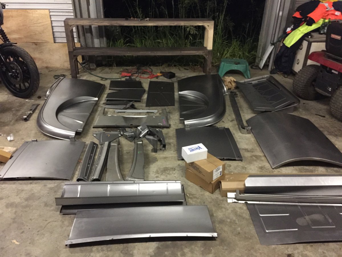

    Hi
    I’ve recently purchased an un-assembled brookville 28-29 body, and am about to start assembly. I have a good straight chassis and plan to build it off that starting with the sub frame, I’m struggling to find any information in regards to doing this and most of the posts previously posted about doing this pretty much all have the photos disabled,
    If Anyone out there has photos they took whilst doing there’s or can give me any direction to take in doing so that would be great.
    Thanks in Advance,
  2. I have done this with a 32. I have a bunch of pics but not near them
    Start with the sub rails and cowl
    Hang the doors and start working on the qtrs.
    I used a laser to center the parts with the frame. Plumb bobs work too
    I aligned and temporarily brased with tubing as it was fitted.
    It's not as difficult as ya might think. The cool part about building it like this is you have control of all the fitment.

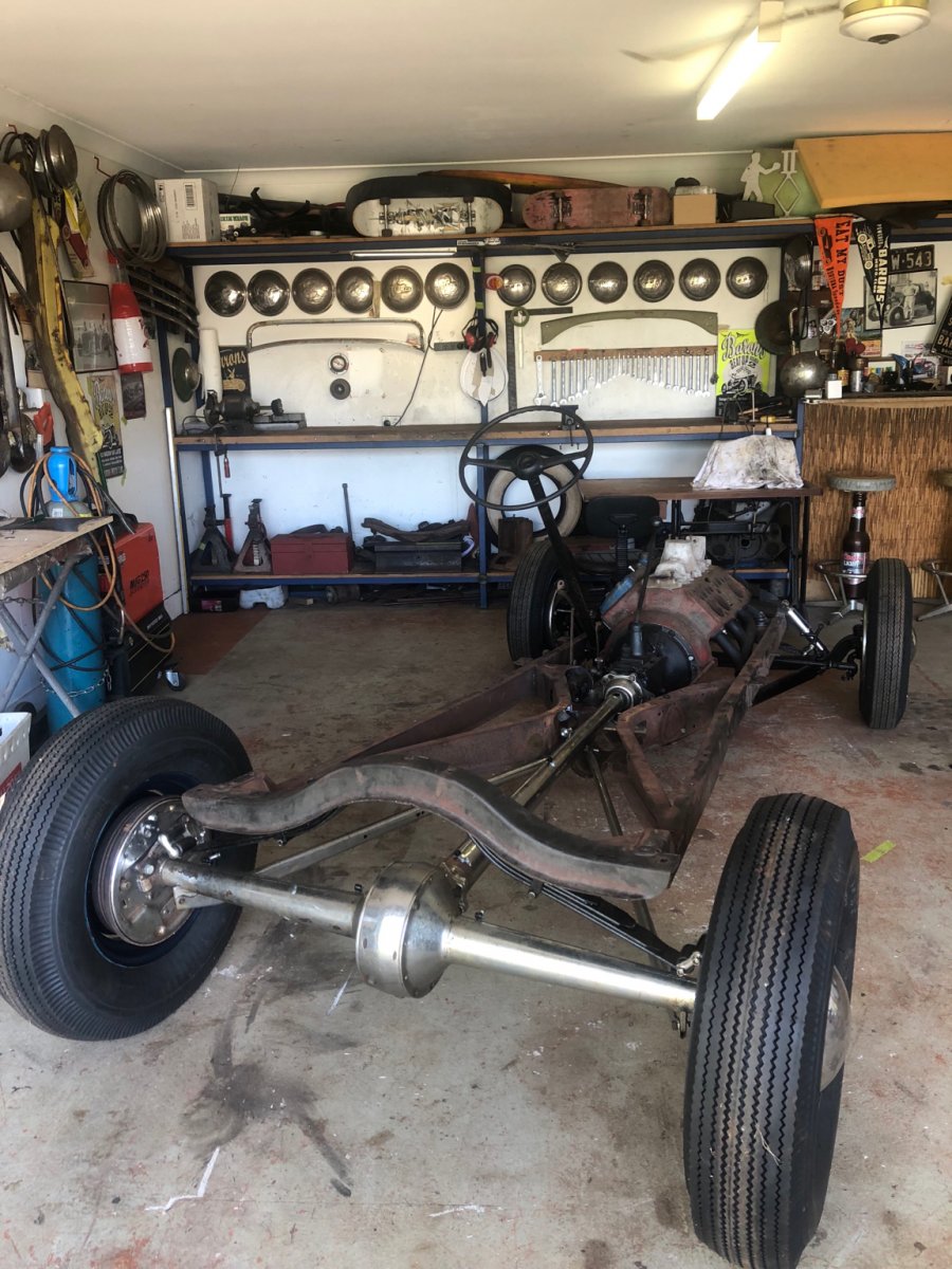

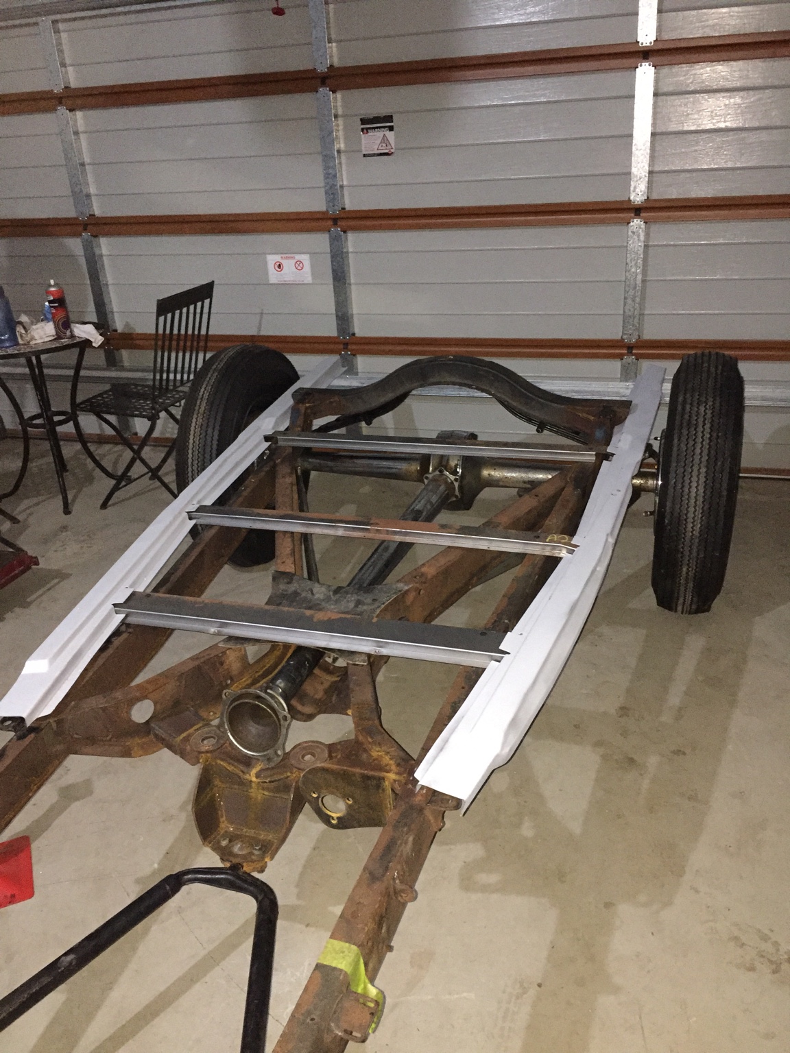

    Thanks everyone for all the responses and suggestions, Wheeldog57 your build thread helped a great deal. I got to the 5th page ran out to the shed and come up with this... will have to modify my subframe for the step in the rear. I feel like maybe that first initial bit was the hardest.
    My thoughts from here have been to just screw the subframe together & go from there, Thoughts? [​IMG][​IMG][​IMG]

    I was lucky to have an original pile of subrail parts the front was cut just behind the door, and the rear was about 2 feet long. I traced the outline of the rails on the table top and was able to get an exact outline of what I needed. Hope someone can trace an original 28-29 for you so you have a foundation to build from. Build it factory stock before you modify things. Bob

    Don’t put the floor pans in until last . Way easier to build with them out . I think I’ve built about 10 brookville cars .
