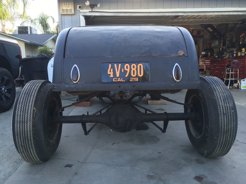

    HI All, Just did a little trade for this little lady... about 95% there... needs to be wired, brakes need to be plumbed, some floor work, and some seating, but I am hoping to have this ready by the spring... a LITTLE too high in the rear for me, so that will need to be addressed, and it really needs some wires and black walls for me.. but she is all mine, and I love her!! I have heard pull a few leaves? or get a T Spring..?
    patmanta, wheeldog57, waxhead and 5 others like this.
  2. Petejoe
    Joined: Nov 27, 2002
    Posts: 12,264
    Petejoe
    from Zoar, Ohio
    Neat car.
    Great project. I'd change out the brkt setting on top of your pumpkin. Looks like you'd gain 4-5 inches alone before removing any leaves.
    I like those wheels and tires. I wouldnt change that look at all.

  10. AV8 Dave
    Joined: Jan 3, 2003
    Posts: 680
    AV8 Dave
    X2!
    3340 likes this.
  11. Atwater Mike
    Joined: May 31, 2002
    Posts: 11,625
    Atwater Mike
    Get a '25-'27 T rear spring. ...and your taillights are on upside down...

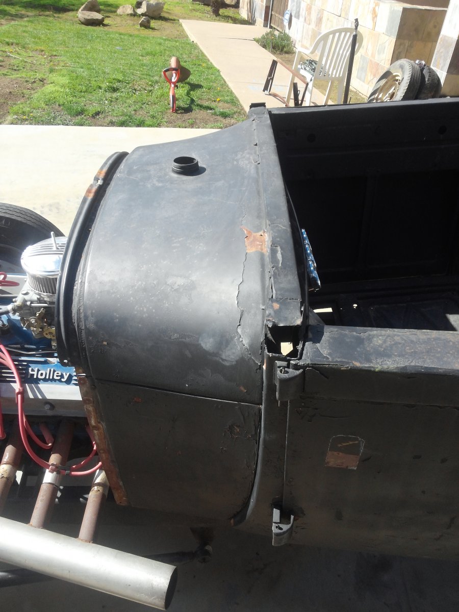

  15. STUNNED MULLET
    Joined: Sep 10, 2012
    Posts: 178
    STUNNED MULLET
    from Fresno
    Good Morning All, thanks for the advice and comments. I am definitely going to break it down somewhat and make it my own design that I have in my head. I REALLY want to keep the rumble seat for the kids, but I just don't like the way it sits in the rear.. I like my roadsters low. and I need the space for the tank, battery, spring/coilovers idea, etc.. I will try to figure a way around it, but I think there is no sacrifice in that department... going to chop the windshield and lean it back for sure. I like the bench seat look over buckets, but once I start messing with it I might change my mind.. want to change out intake and go 3 deuces, and maybe throw some new valve covers on it. and the exhaust needs a change as well. I am going to do all the body work myself. for some reason I see this as a really nice metallic silver, with a Porsche red interior... but I am sure I will change my mind on that a million times!! its coming home tonight, so the fun will begin this weekend. progress pics to follow.

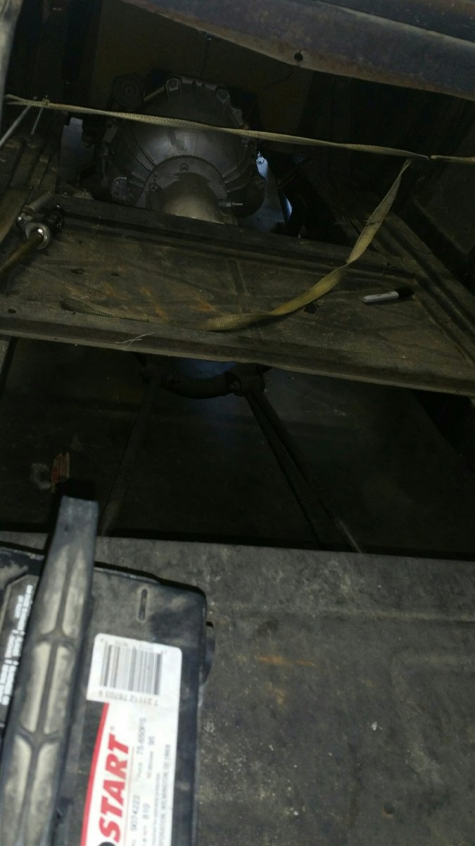

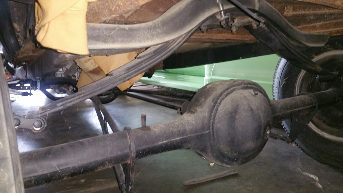

  16. you could get a reversed eye spring to get that rear down some, but that will only get you 1 or 2" you need more. the spring perches may be a little wide, looking at the shackles, but you may want to see how it sits with more weight in the car. (fuel tank, battery etc...)
    good luck looks like fun!
  17. wheeldog57
    Joined: Dec 6, 2013
    Posts: 3,182
    wheeldog57
    Nice ride Mullett! Many ways to drop the rear; you can put "spring behind axle" perches. They are found on 35-40 Ford (and later maybe). These perches mount low on the backing plates. This will require either another rear crossmember welded to the existing one or extending the frame back 7.5inches then welding crossmember on extensions. This makes a big difference in height. You could also get a T spring and pull a couple leaves out. Check out some build threads on here, that's where I stole-err-got a lot of my ideas from. Don't be afraid to ask questions. Good luck, Ron 1487356099165.jpg

  20. Squablow
    Joined: Apr 26, 2005
    Posts: 17,390
    Squablow
    Way longer shackles in the rear along with a reverse spring eye should get a lot of the height eliminated I would think. But the rear suspension arms seem awfully close together, that's an odd design I think.
    And were they going to cut a notch out of the firewall sides to clear that "exhaust", or ? I wonder what the overall plan was.
    It's got potential for sure, I just wonder about some of the engineering.
  21. STUNNED MULLET
    Posts: 178
    STUNNED MULLET
    from Fresno
    yeah.. I thought of the same thing? that's why those homemade lakesters gots to go... I have one of my buddies coming over this weekend to see what we can do. this is just 1 of the many things on my "to do" list.. need to do brakes lines, wiring, floor, gas pedal, seats, door latches, gauges, steering needs to be mounted on dash area, posts needs to be cut and glass installed, gas tank plumbed and mounted... etc etc etc...

  24. sloppy jalopies
    Joined: Jun 29, 2015
    Posts: 5,256
    sloppy jalopies
    Use care where you cut the posts, as they lean back the W/S frames lower rail's radius changes and of course now won't seal with the cowl...
    Notice that '30 -'31 used a flat faced filler panel [between W/S and tank] on most models,
    but the slanted W/S cars had taller filler panels and those [4 models] also had a tapered grove in that filler panel to help match the tilted W/S frame...
    or just get wet once and a while, oh, and maybe fuse the electricals...
  25. wheeldog57
    Joined: Dec 6, 2013
    Posts: 3,182
    wheeldog57
    I'm running a banjo but you can fab brackets to do same 1487455107745.jpg 1487455126386.jpg 1487455141478.jpg notice frame kicked up and extended to make up the difference from spring over to spring behind

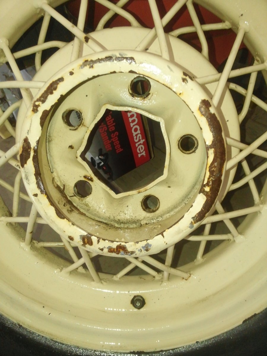

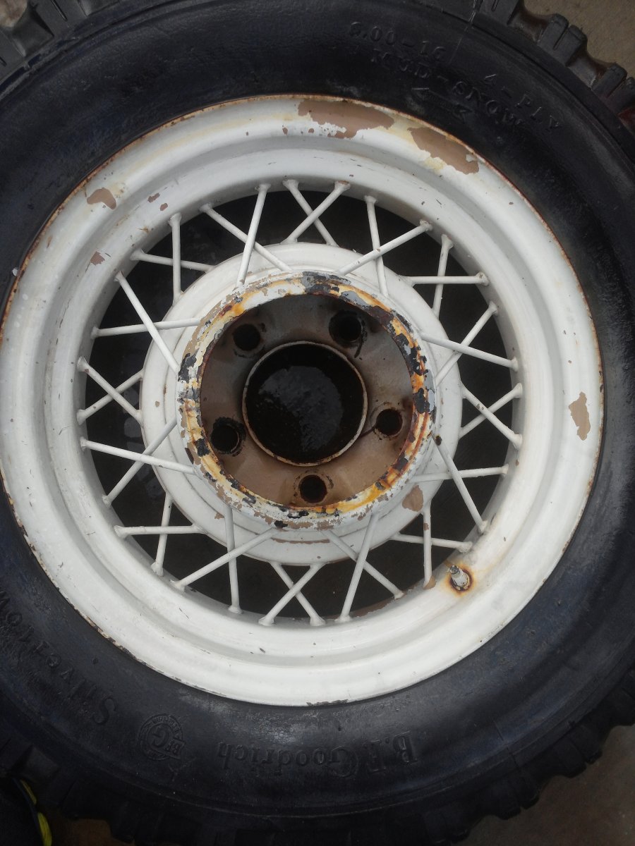

  26. STUNNED MULLET
    Posts: 178
    STUNNED MULLET
    from Fresno
    Well folks!! Its home and in the garage... the windshield area is hacked to shit.. its gonna take some work to get it back in order.. needs lots of bracing to get doors to shut correctly. LOTS of bondo where they cut.. oh well... its a project in works.. he gave me some wires. 2 to be exact. Both look like 35 era, but one has me scratching my head with the shape of the hub hole.. anyone know what the heck these are?
