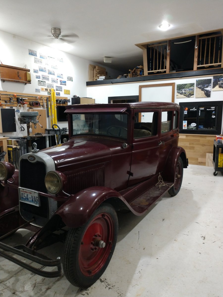

    This is my first Pre-War car. I have owned and/or restored quite a few newer vintage cars back to 1950's era. Including some ground up rebuilds. So, that part of this doesn't intimidate me. But, this car has a lot of things that are foreign to me.
    I decided I wanted a mid 20's to mid 30's car. No preference to model. After a lot of searching and rejecting possibilities I found the 1928 National and started researching what I was getting into before I went to inspect it.
    I went into it with no expectations whatsoever and after looking a the car it is mostly there, in decent shape with no rust out and the wood is not a complete basket case.
    I had no carb on it it, a pile of misc parts in the back seat and the rear roof off and in the car.
    The widow I bought it from knew absolutely nothing about the car. She even thought it was a 1929. But, as I said, I had no particular model in mind. So, that wasn't a deal breaker.
    So, I made an offer and bought it. I am plenty happy with what I paid and even after I found a couple of other issues as you always do when you bring a car home, it's all good.
    About the car.
    I have spent a couple of evenings just going over the car and digging through the receipt folder I got with the car.
    So far this is what I think. It is an amateur restoration from some time in the 80's I am guessing. It's been kept inside since then I believe. It looks like someone had decided it needed some work and started unnailing the roof. Thus the rear top being off.
    The wood needs some repair. That actually doesn't bother me in the least. I have been a cabinet builder/millworker my entire life and have access to plenty of Ash, so that's just my time to rebuild all of that.
    The doors will have to be completely rebuilt, they are complete but very soft on the tops and one is actually rotted away on the top bar.
    As far as I can figure on the mechanics, it was probably a running/driving car and then maybe sat and then was sold to the owner I got it from around 2007/8. All the brakes had been rebuilt, lots of new parts and receipts to back it up prior to that. Other misc maintenance items done.
    That's where the problems must have set in. What I have found is a rigged up ignition switch, a fuel line running from the back of the car with an electric fuel pump. I am going to assume they couldn't get it cranked and started monkeying around with it. The carb is gone, which makes me suspect it was taken off and likely crumbled apart if someone not familiar with old carbs tried working on it. Thus it being missing. The rigged ignition switch doesn't actually energize the ignition, so I also suspect they were fighting a losing battle. It is hooked up the starter and I suppose if a person didn't understand vehicle ignitions they might believe turning the starter was going to start the car.
    The worst thing I have found is they also left water in the block with no antifreeze and I have a 3" crack in the water jacket on the back driver side of the engine.
    So, now some questions.
    I am torn about the engine. It is an original April 1928 engine. But, I am faced with either tearing it down and having the block repaired, finding a new block and rebuilding, or doing an engine swap to a different engine. My issue is since I don't have a carb, and the carbs are very expensive, I am gambling on an engine I am not even certain runs. My original plan before I found the crack was to get a carb, either an original or a different replacement and at least get the engine running in the shop and see what I was dealing with.
    I have no intention of doing a ground up 100 point restoration, so I am not married to having an original engine and am having trouble deciding how much money and time I want to sink into a 92 year old 35HP engine with Babbitt bearings.
    So, I find myself with an interesting dilemma. I am now considering a hot rod project where I wasn't necessarily before. It doesn't seem there is a wrong answer with these cars as far as what to do with them.
    I might be interested in going a little nuts, but I am really having trouble finding definite answers on several questions.
    How much HP will an original excellent condition frame take? What will fit between the frame rails. V-8, nice I6? Manual or automatic trans?
    What suspension is a somewhat bolt on finding used parts? Not interested in forking over the cash for a entirely new built front and rear end. Seems to take the fun out of it and a lot of cash from me.
    So, anyway, that's me, thanks for all the info the board provides. I am really active on several other boards for some of my other stupid vehicle hobbies. So, I always appreciate the sheer amount of time and effort that goes into putting all the collective knowledge out there.
    And, because all threads are useless without pictures...........

    2020-02-15 15.51.10.jpg 2020-02-16 12.22.24.jpg I stripped the body this weekend. No real surprises found except the wood frame is complete trash and the steel panels were the only thing holding it together. It's not rotten, just cobbled together with random bits of 2X4 and whatever was at hand it looked like. Then put together with poorly installed misc bits of metal using what looks to have been a useless coffee can full of fasteners. No 2 were alike it didn't seem like. Complete pain to disassemble. The frame basically fell apart on the floor once it started coming apart. I found what I believe to be 3 pieces of the actual Fisher frame. Unfortunately what is there won't be a pattern for anything. It wasn't built to fit so much as hacked out then shims and wedges jammed in to hold it to the body.
    Chassis and parts went into the garage to clear out the shop for body reconstruction.
    After the body was off I was able to really clean the side of the engine and look into the cracks. It's toast, they continue in every direction. They were just too small to see at a casual inspection.
    So, to continue working on a plan of action. What's the most common thing to do with the steering? I seems without measuring that the headers of a V8 would interfere with the steering box location. I have searched a lot for pictures of what various people have done and keep coming up with pictures of IFS and other more extreme mods I am not looking to do. I really like the idea of using the drum brake axles from a slightly newer vintage Chevy as has been discussed earlier in the thread. I think it maintains the look of the vehicle which I really like. I would like most of my mods to be less obvious at a casual glance.
