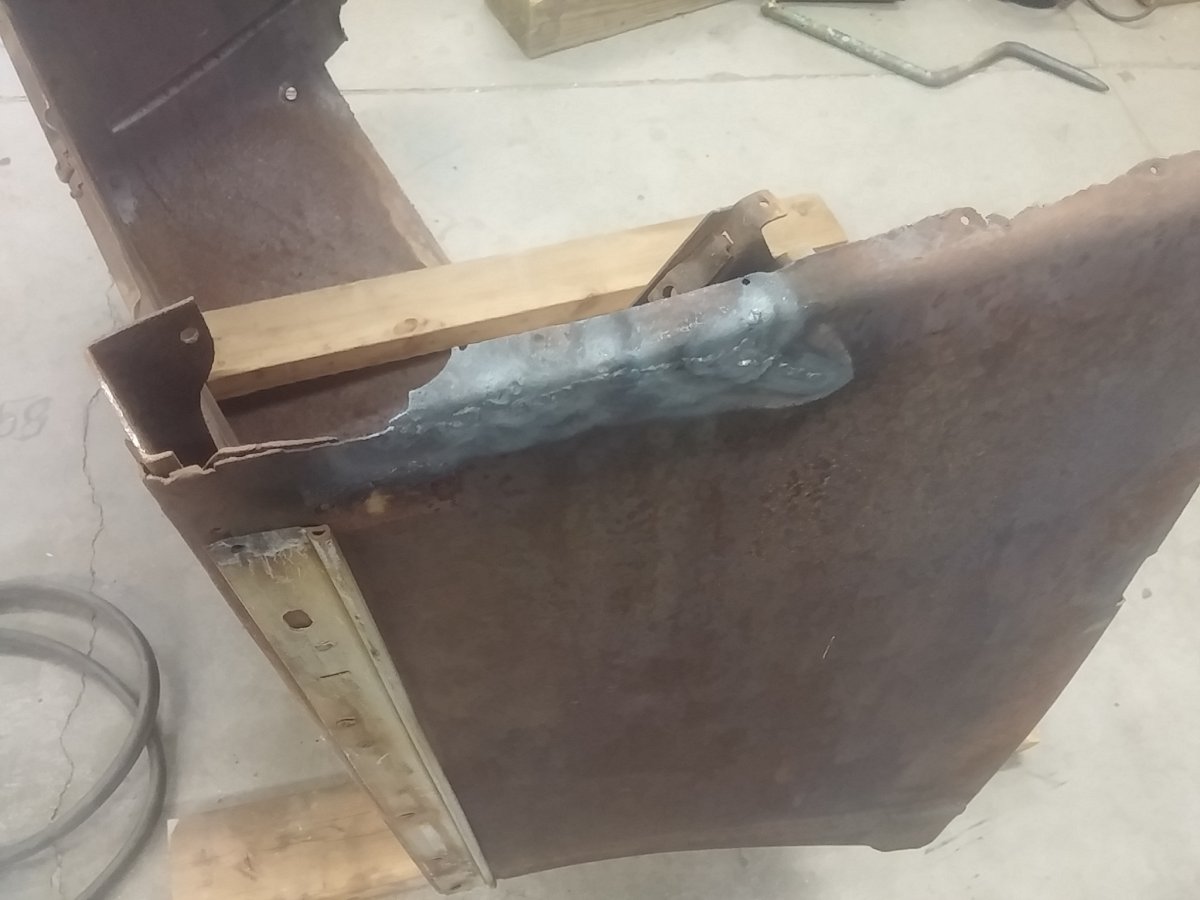

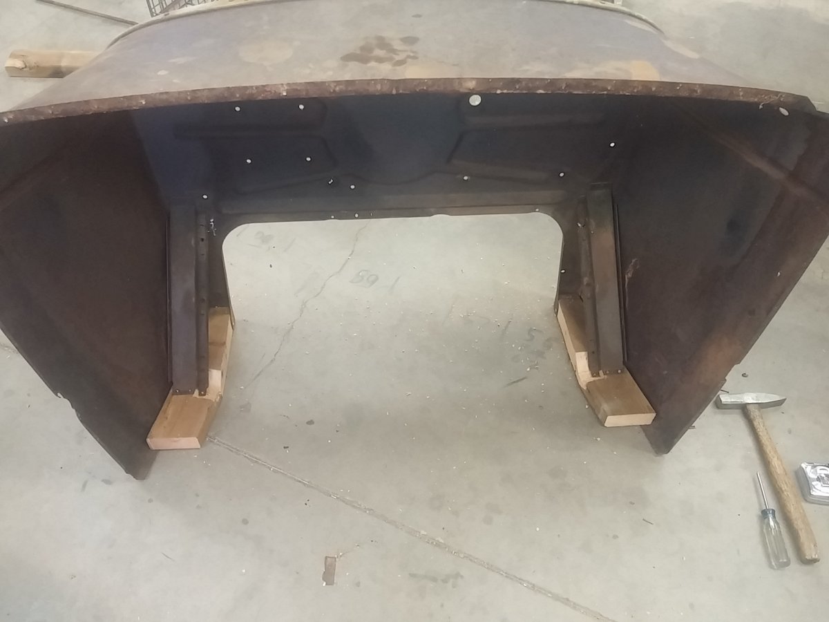

    Anyways, back to the car. I've been working on the cowl today. I took it off, and welded up some cracks along the bottom edge of the sides. I made some wood blocks to tie the bottom sides to the inner support where the toe board attaches at about a 45 degree angle. There is also a body mount hole about in the middle of the new blocks, there was no wood left there at all, and the bolts were just resting in the holes in the frame. Now the cowl is pretty solid, although the back edge is a little flimsy. I made a piece of plywood to fit the back of the cowl, it doesn't fit now, but I will slice and weld the cowl to make the back edge a few inches narrower. Thinking about it some more, I may just fold the metal around this on the sides, and nail it on. And nail it across the top where it has a bunch of nail holes already. I don't have a plan for the windshield, but I suppose my plan could cover up this edge?
    A few pics. Note that I put the frame on stands and got it level, so I have a slight chance of getting things square.

  10. Jim, if you are planning on making a roadster cowl out of your sedan cowl, remember that the roadster cowl isn't as wide in the back- you can easily take a pie cut out of the top to adjust the width (of course, you'll need to take out/reset the cowl vent)!

    Back to work...I did some slicing and dicing. The fit and finish is pretty good for a depression era jalopy! but way below today's standards

    Oxy Acetylene welding outstanding! I haven't done that since I worked in the body shop in the Marines! Where fit and finish was also subject to function over form! Joe

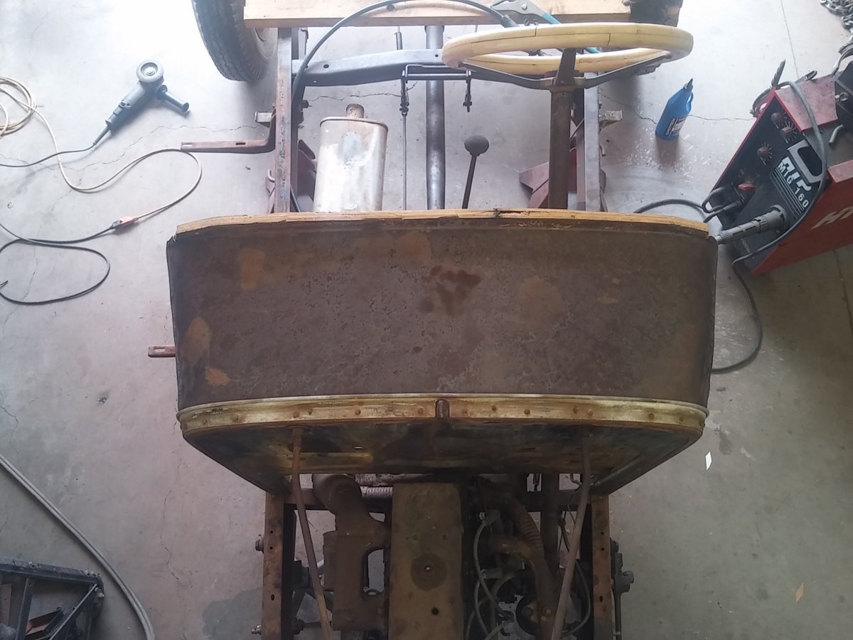

    Finished the cowl modifications, for now. I need to figure out what the plywood wants to look like, this one was more of a pattern, than the final piece. I also might use lumber to replace it, a board across the top, and one down each side. I have some pallets, I might see what they're made of....
    also, the cowl is no longer flimsy, it's solid now. 20160721_135655.jpg 20160721_140047.jpg
    Looking down, from the front
