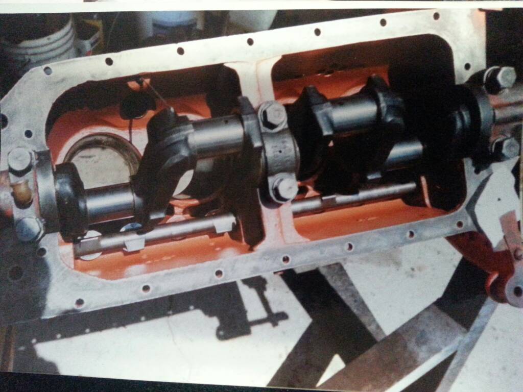

    Thanks anyway! Got some leads on a couple of rockers through a Facebook group. In the meantime i welded it up so I can test start it. If I can figure out how to post pics I´ll post some.
    12814039_10153990710904878_7543363795871194602_n.jpg 12814039_10153990710904878_7543363795871194602_n.jpg 12718298_10153990710954878_2051956243319378450_n.jpg 12795509_10153990710979878_9003304037438368006_n.jpg 12800215_10153990710874878_2025553175942167867_n.jpg

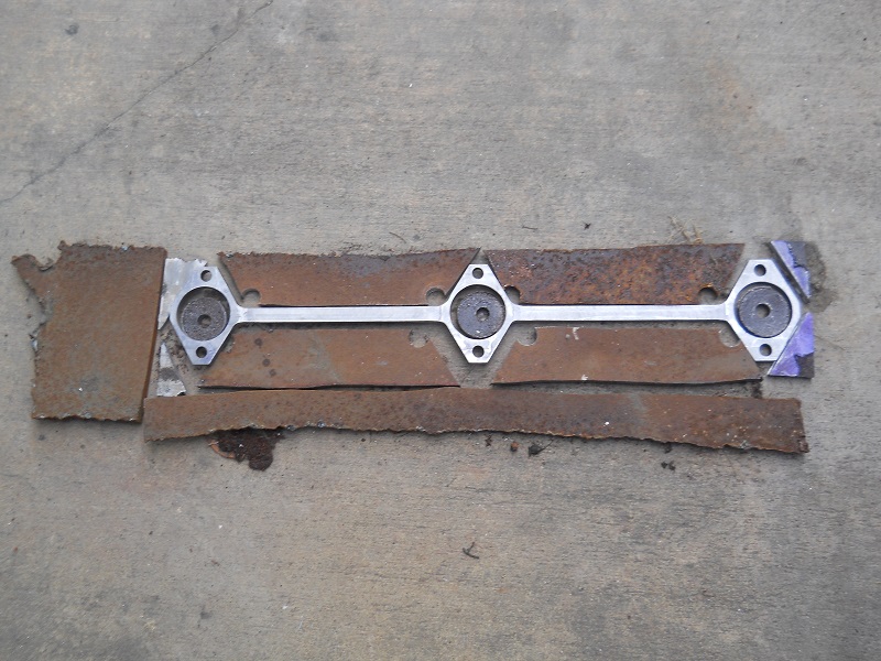

    I have been recovering from surgery since New Years. So I was getting bored and thought I should do something fun. That didn't require a lot of thought. . I decided to try to make a header flange for a 25 Olds head from some old steel left over from when they dug up the storm drains behind my house. Lots of time on the hydraulic press, whacking it with a BFH and twisting it with a BFWrench. Cleaned up at .340 from a kind of 3/8 plate. Before and after pictures attached.

    Pretty nice. I couldn't see a flange in the first picture. I guess that is why I have more rusty old metal around than nice parts.
  14. Rich, how big are the intake/exhaust ports on your 3 port head?
  15. RichFox
    Joined: Dec 3, 2006
    Posts: 10,020
    RichFox
    This is the old case of find a piece of scrap metal and cut off everything that doesn't look like a header flange. 1 9/16 intake. 1 3/4 exhaust

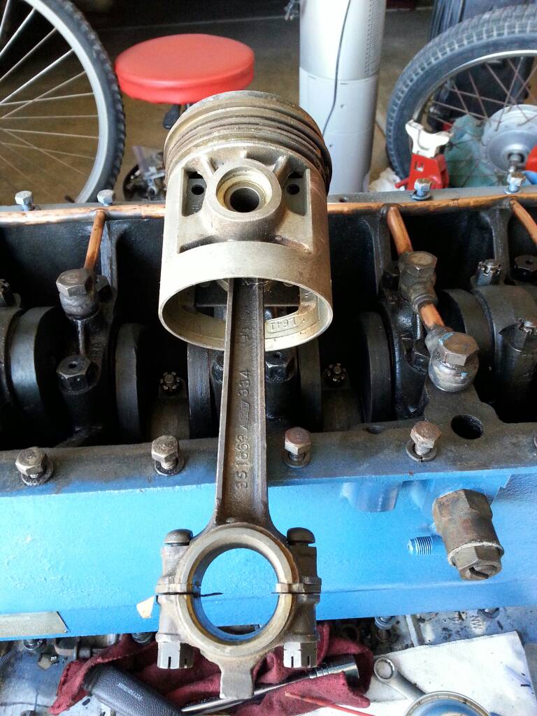

    Rich, l have a question, l have a full race 25 engine, the Oldsmobile head got away but I have everything else and am now using a 28 head. It has a shop cast front cover with another crank gear to drive the Bosch mag, it's full pressure oil with some strange piston's on Chevy rods. Nice bumpy cam custom lifters. Have you ever seen piston's like this? I know the height from pin center to top is what they were going for (compression) hear is pic. Thanks for any info. Dave

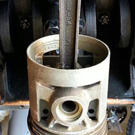

    Looks like a part number L641. This has been common nomenclature for piston part numbers for many decades. You might be able to find a cross reference somewhere to identify it.
  20. SR100
    Joined: Nov 26, 2013
    Posts: 966
    SR100
    Is it aluminum? It looks like a period Bohnalite piston.

    [​IMG][​IMG]
    Pics of the block, looks like a stock crank drilled, you can see the bump stick and the custom lifters. The mag drive and cover. Have fun

  22. ebtm3
    Joined: May 23, 2007
    Posts: 837
    ebtm3
    Now I realize that the previous photo - with the rod and piston laying across the pan joint-- isn't of a C4 lower end. Sorry, my bad.
    I will see if I can find the ''racing'' pistons and rods that came with the heavy crank that I mentioned earlier.

  23. Egor
    Joined: Sep 1, 2010
    Posts: 73
    Egor
    Sorry, I layed the piston on the bottom end of a sleeve valve engine I'm building. That goes into a Willys Knight l have, interesting build they are. Lol

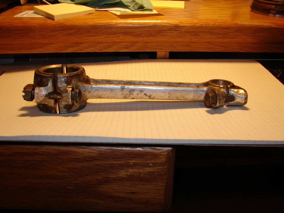

    Aluminum rod, no name but attacked with a coarse file---or it might have been a hungry Pit Bull.. DSC03715.JPG
    Stock length. Piston is the same pin to crown dimension as a stock '28 aluminum one, so when all assembled and in a block (with stock stroke crank) the compression is the same as a '28 ?? Doesn't make much sense to me--spend $$ --and even if it wasn't turned into scrap-- only have a little less reciprocating weight. How fast did they think that they were going to twist the thing?
