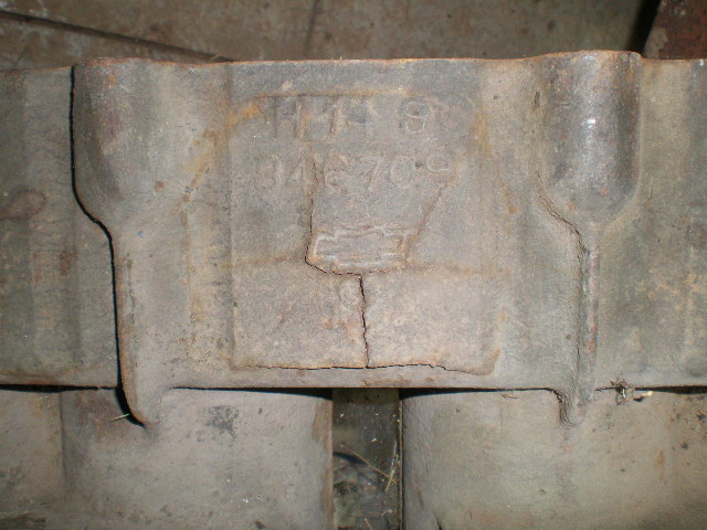

    Norm-
    The H 14 9 is a '26-'27 replacement block, cast Aug 14, 1929

    Casting number 346709 would be a replacement block cast in ‘29, I guess. My resource says 346709 was introduced in February of 1926 and used through December of 1927. So it would typically be associated with ‘26-‘27s, I think.
    For the record:
    K 30 7 = November 30, 1927
    H 9 8 = August 9, 1928
    D 17 8 = April 17, 1928
    H 14 9 = August 14, 1929
    I suspect Chevrolet restorers would be interested in that last one, as my document seems to indicate that there’s disagreement as to whether anything 4 cylinder was cast after the end of regular production.
    -Dave

    "I suspect Chevrolet restorers would be interested in that last one, as my document seems to indicate that there’s disagreement as to whether anything 4 cylinder was cast after the end of regular production."
    Where did that information come from? I'm pretty sure that I have come across '28 heads in the past with '30's casting dates. I think that Ford was still supplying new A and B blocks after the second world war, for a short time- so why wouldn't Chevrolet?
    Yes, I know about Chevy dealers smashing blocks on trade ins, but a replacement block is a repair item.

    Very interesting. That block is broken (froze) so is no good, but had an odd casting area and that was where it broke. Herb, Thanks for the crank info. I'll check what I have. One of the cranks has the "Knobs" on the throws ground off. could this be a balancing effort? Did they have the ability to do that?
    Again thanks for the info. Norm

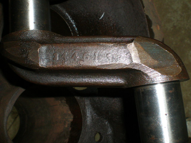

    This is the Brake I was talking about. It seems that a few taps with a hammer would cause the whole area to fall out. I'm sure glad it wasn't one of the other blocks. Included the pictures of the crank that was ground (for balancing??).
    The grinding was only on one side of the crank. Any ideas? - Norm

    Yes Norm, I have seen, and have, cranks with large areas hacked away with a grinder. Enough are around, that it must have been an effort by the factory to balance. And hacked, is being kind------

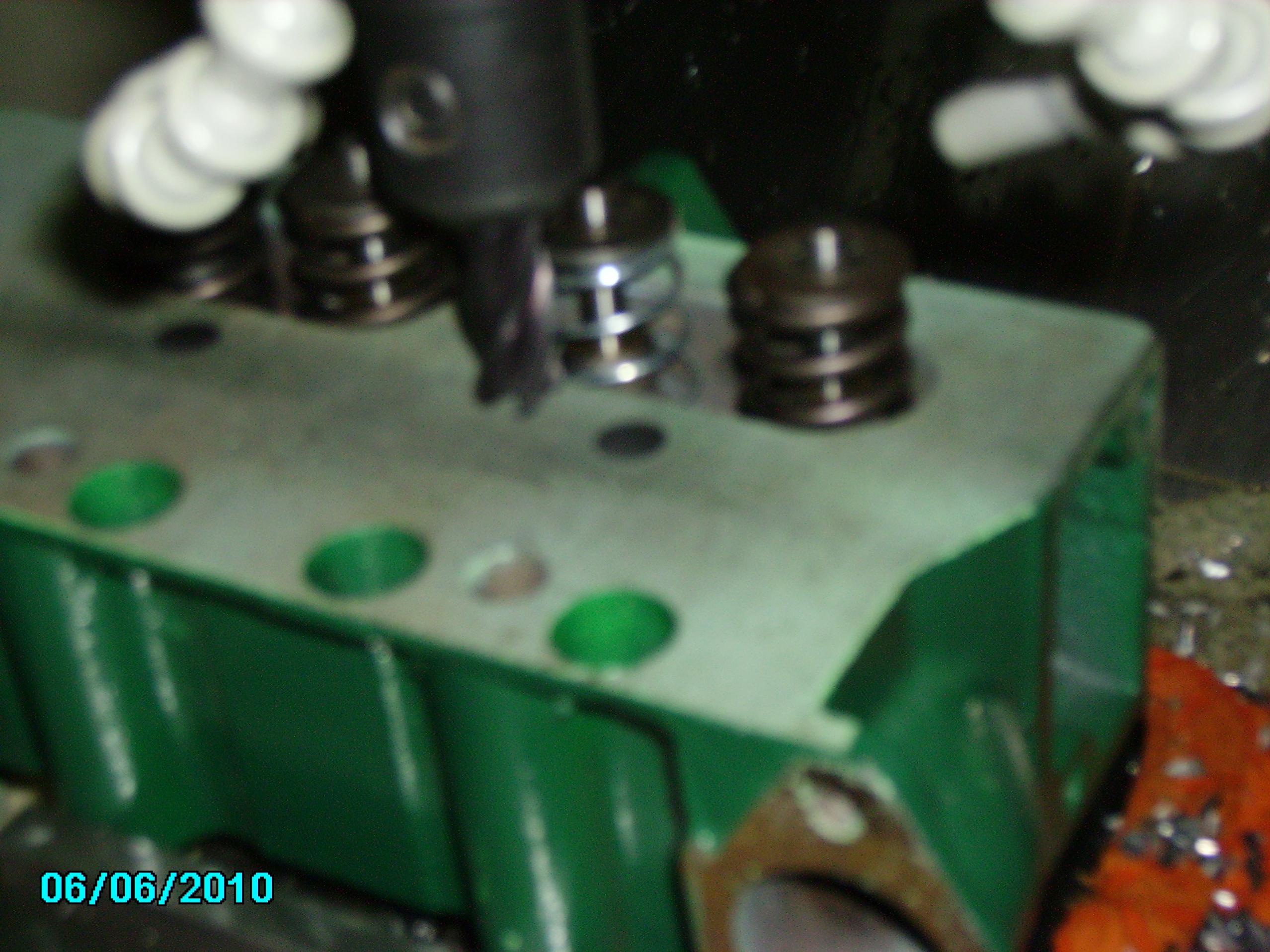

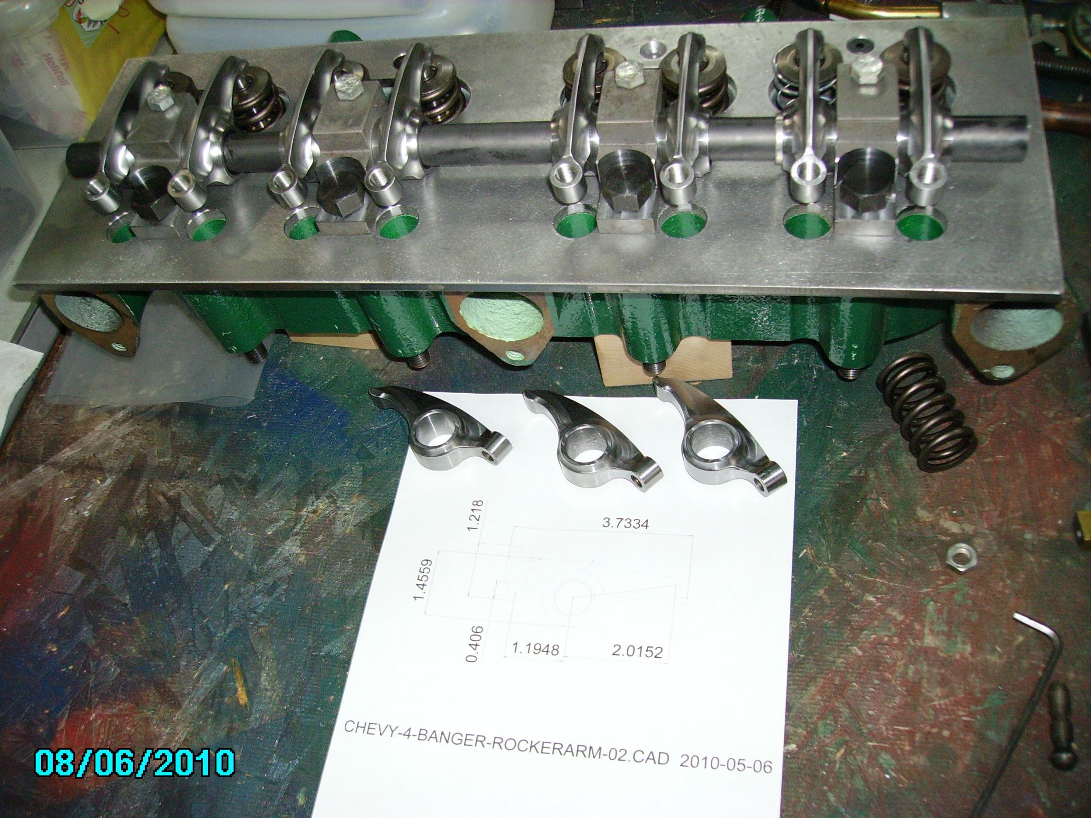

    Here's some pictures of a restoration project I worked on earlier this year. The car and engine are '25, it was a record holder in '48 & '49 at the lakes and also won car of the year awards. People more experienced than I have stated that the later engines with the distributor coming out the side of the block are weaker and prone to block failure when pushed hard. The engine has a modified Olds head with custom 1.72 rockers, custom long rods and 305 Chev pistons and a counter weighted Ford "B" crank. Custom front cover mounts an oil pump driven off the end of the cam. Oil system uses an external oil gallery to feed the mains & cam bearings. Distributor is a converted Mallory. There is a lot of work necessary to make these engines durable. Well, I attempted to send pictures but since I'm new to this I don't understand the URL request.

    would the nice folks who made those rockers be willing to make some more :D?

    Where is the distributor mounted? On the rear of the extended front plate it looks like.
    Nice rockers- I think that they have Mac slobbering------

    Hi, I am amazed at the interest in this thread! I'll answer your questions in the order they were asked, as best as I can. They green paint is custom mixed from X O rust base at the local True Value hardware, I'll try to get the formula for you when I go there next. I spray that paint with very little thinner and no regulator, 125 PSI. You have to work hard to make it run. If 6 people were interested in the rockers I could come up with a price that might be affordable. I picked heat treated 4140 to make them out of because the car went to Pebble Beach Concourse and they didn't have aluminum rockers back then. Also aluminum rockers require either a roller tip or a heat treated insert and I didn't have the time to develop that. The finned valve cover might be available, I could check on it and post the results here if it is. If you guys are interested in more pictures including the inside showing the main caps & counterweighted "B" crank I'll put together a string of pictures next week. It takes a long time to download a lot of pictures at once. There is a post of Pebble Beach on HAMB showing the car, it was restored to as original as possible thru the use of many photos and was not over restored like is the norm, consequently it only got a yellow ribbon. I took a real & currently run "T" track roadster to an invitational "A" club Ford only car show and received minor attention, being upstaged by a metalflake orange fiberglass "T". Yes I'm probably a purist but I'm not trying to impress anyone either. Well, work is calling, taul, Pat

    Thanks for the response! I'm guessing that this is the Spurgeon/Giovanine roadster taht you worked on (you all did a fantastic job on the restoration). we've been sharing ideas/etc for a while now, but you got to work on the real engine itself!!!
    Thanks for what you've told so far and anything else you can share would be greatly appreciated (I'd like to see more of the pressurized oiling system and the timing cover as well)!
