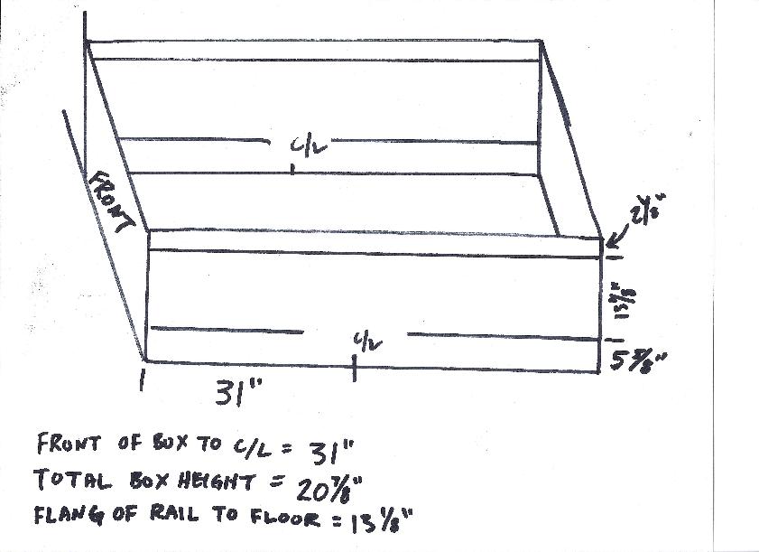

    34 bed is apparently just shy of 21" tall at the outside and about as deep inside as an A bed but about 6" wider & 15" longer with the wheel center further back.

    For my own purposes, Length isn't really too much of a concern since my personal truck build is actually a shortened AA with a 112" WB and 60" of frame behind the cab. A 70" bed probably won't look bad:
