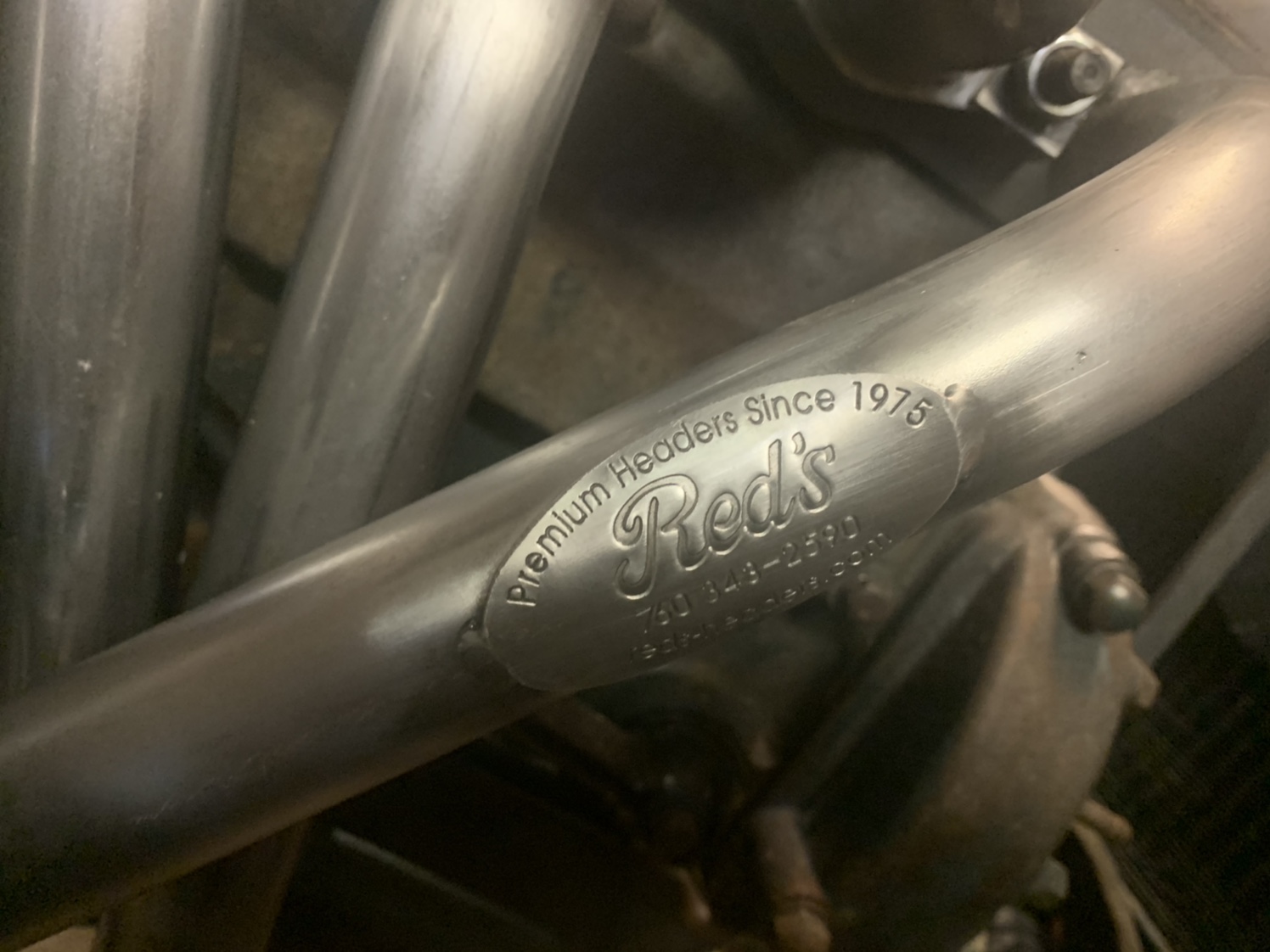

  11. corvair63
    Joined: Jan 5, 2013
    Posts: 98
    corvair63
    from denver
    [​IMG][​IMG]
    Got some more work done. The header finally showed up. I got my stromberg rebuilt. I’m still waiting on the tool to install the proper jets in it before I bolt it to the intake.
    HemiTCoupe and dudley32 like this.
