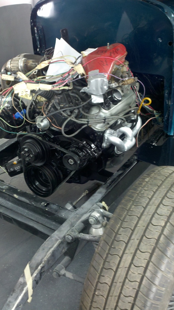

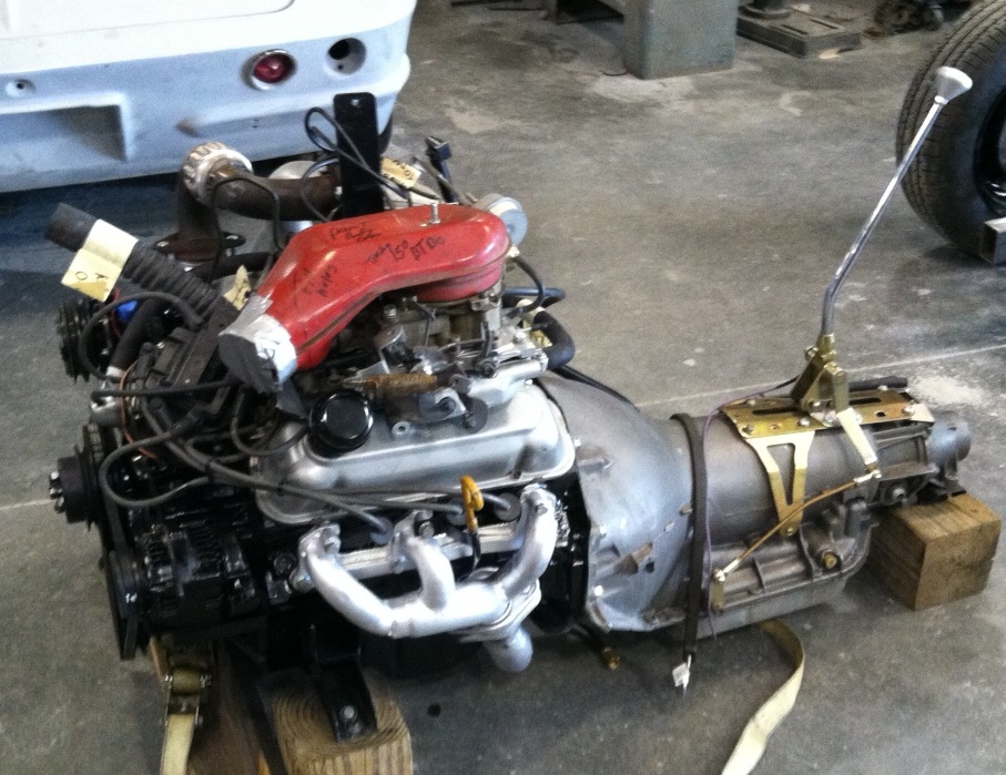

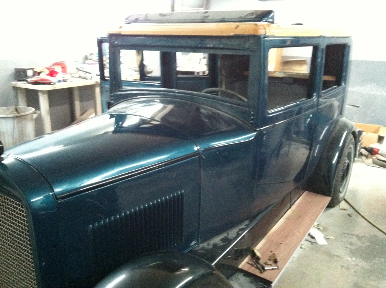

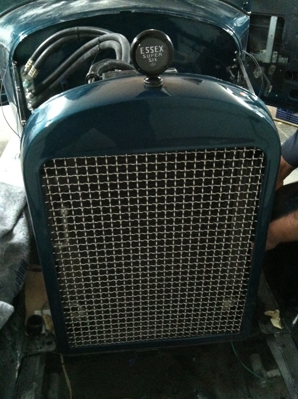

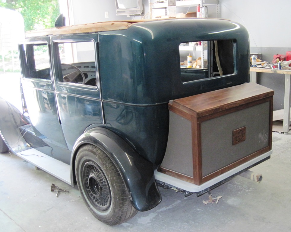

    Heer is my 28 essex with a '79 231 V-6 Turbo that I am just finishing. Would stay away from mthe odd fire engines. These '78-83 engines are plentiful. Go to the Turbo Buick Before black web site for great info.
    dan.
