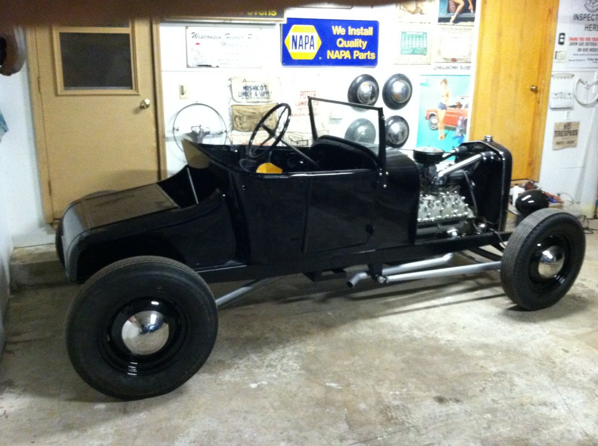

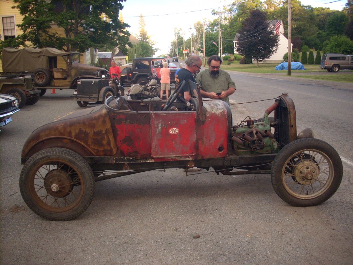

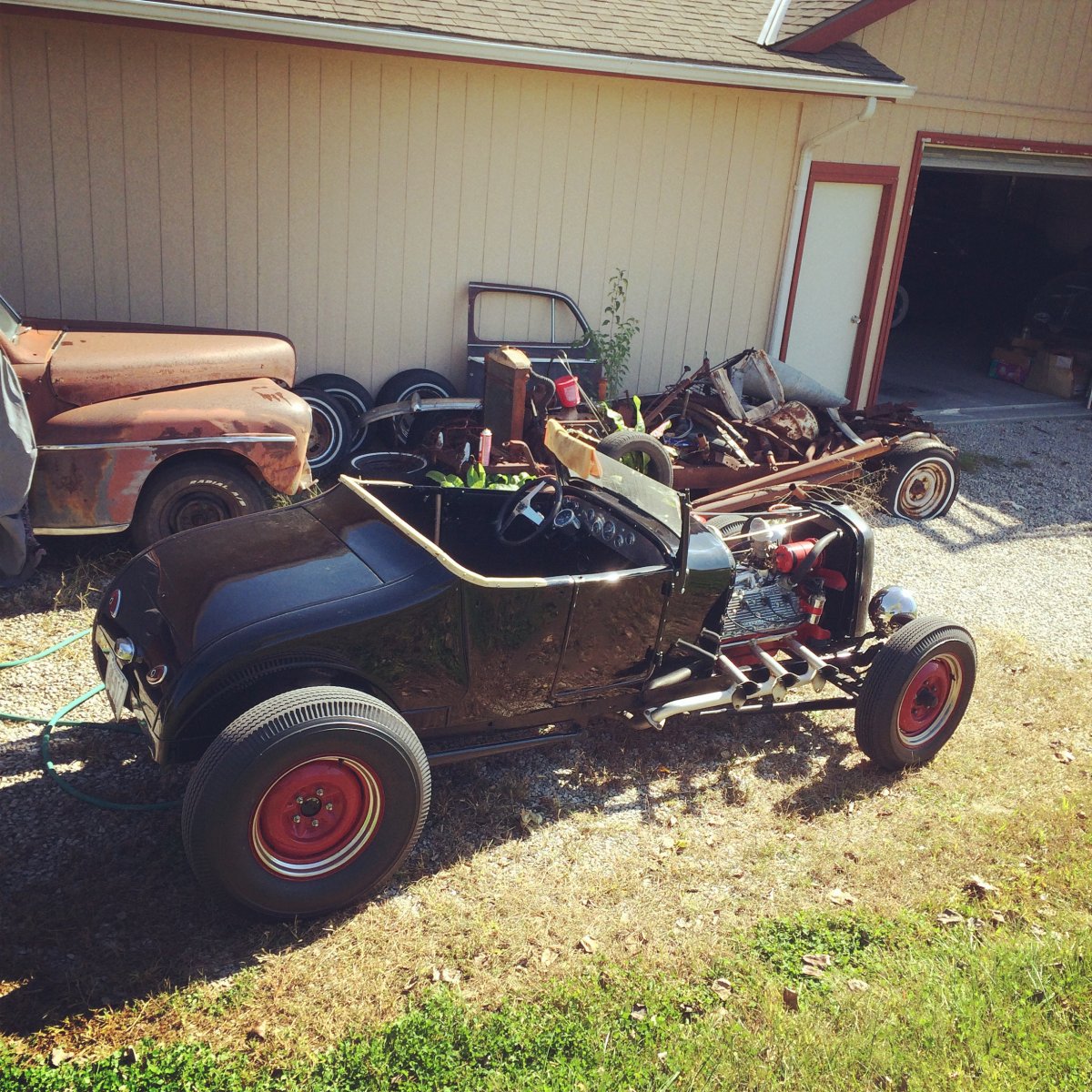

    One with a V-8 and one with a banger, both on "A" frames.
  5. madfish
    Joined: Dec 9, 2006
    Posts: 1,364
    madfish
    That little banger job is poifect. Is that in Mass? What's the story on it?
  6. Mike, they are both cool!

    4 banger-Mass. car built by Rick ( the "Cowboy")
    V-8 - Mass. car built by "Blindowl"

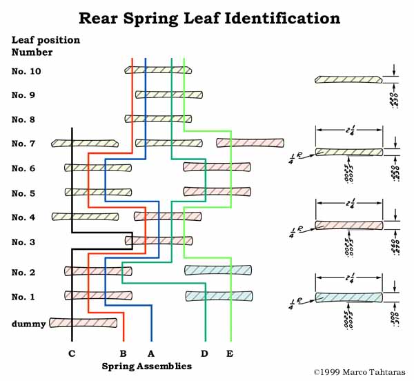

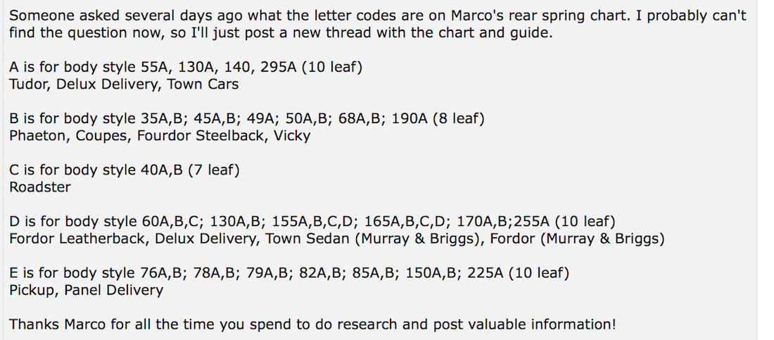

  8. I've been working on putting a rear spring together, or at least coming up with the plan for one. I've been going by a few things. First the info in Tardel's book. That's a little vague though - it says they took out the top three leaves... but the top leaf has the beveled edges. Did they remove that and bevel the new top? Or leave the top and take the next three? To confuse things more, in the last part of the book he says they ended up taking out a 4th leaf too. No mention of which one though. In any case, if he started with a roadster spring that means his rear spring has three functional leaves remaining.
    I stumbled onto a thread on the Fordbarn forum that lists rear spring info: http://www.fordbarn.com/forum/showthread.php?t=62383
    And finally various posts of what others have done, which seems to be all over the map.
    So in the end I thought about it and decided that removing the short leaves would have the smallest effect on spring rate. But I also didn't want to leave too much length between the main leaf and the second one. The whole weight of the rear end is supported by one leaf thickness for that length.
    All of which leads up to my current thought on what I'll try first. I'm starting with a pickup spring, which is "E" on the chart. What I've come up with is using leaf 1, 2, 3, 5, and 10. The rest will be cut short and used as a spacer so the clamps still work. This means five functional leaves... compared to Tardel's three? It's easier to remove things later than add them back.

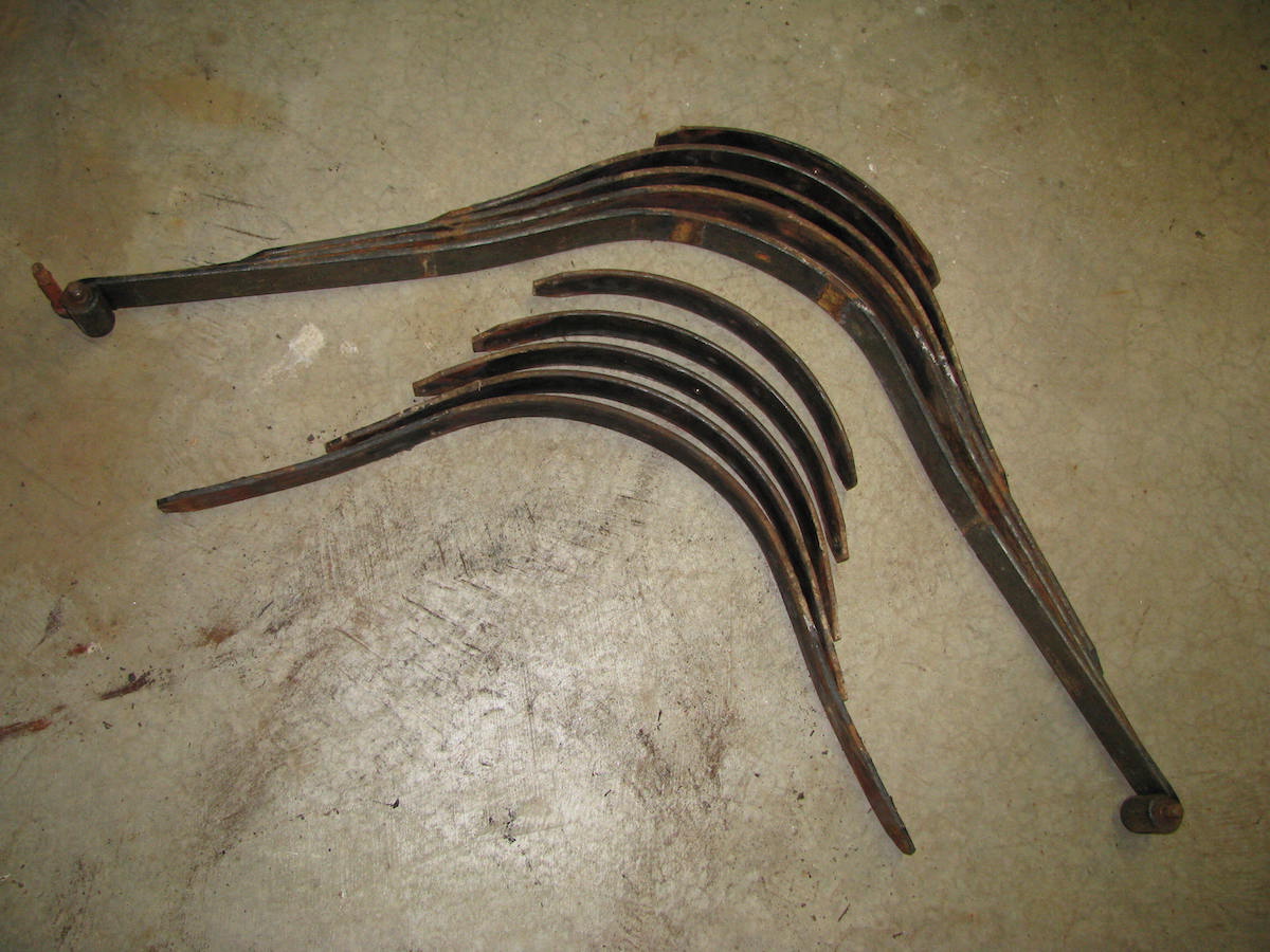

    Here's what the spring will look like, top 5 leaves are what will remain. The main leaf will have reversed eyes, so the second leaf will have to be shortened. I thought about deleting it entirely but going from the main leaf to leaf three would result in too much "single leaf" length holding up the car.

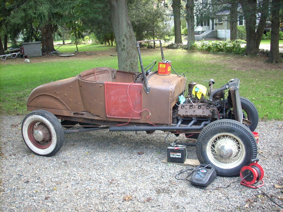

    My '26 is on an A frame, previous owner built some real nice subrails/mounts into the body and also ran a spring-behind '40 rear so my wheelbase couldn't be moved easily, so I'm running a modified 23-25 turtle deck. It's widened and notched for my gas tank, but there's no wheelwell in it so I didn't have to worry about it. Plus they're dirt cheap, I bought this one with lid off of Craigslist for $60.
    Shitty garage pics but you get the idea, the gas tank top shows through that big hole between the trunk lid and the back of the body.

    I didn't take many pictures. Here's a basic comparison of what I was working with. Ground, wire brushed, and pre-cleanup. I ground the ends round freehand on a belt sander. They aren't perfect but then neither were the angle cuts. I think the rear spring will be easier, it's in better shape and will only be five leaves.
    Honestly if I had to do it again I might start with a new spring. I'd still have to take it apart and tweak the ends of the leaves but everythign would be in better shape and I wouldn't have had to deal with the rust and all the resulting dust. Seriously, it was an amazingly dirty job.

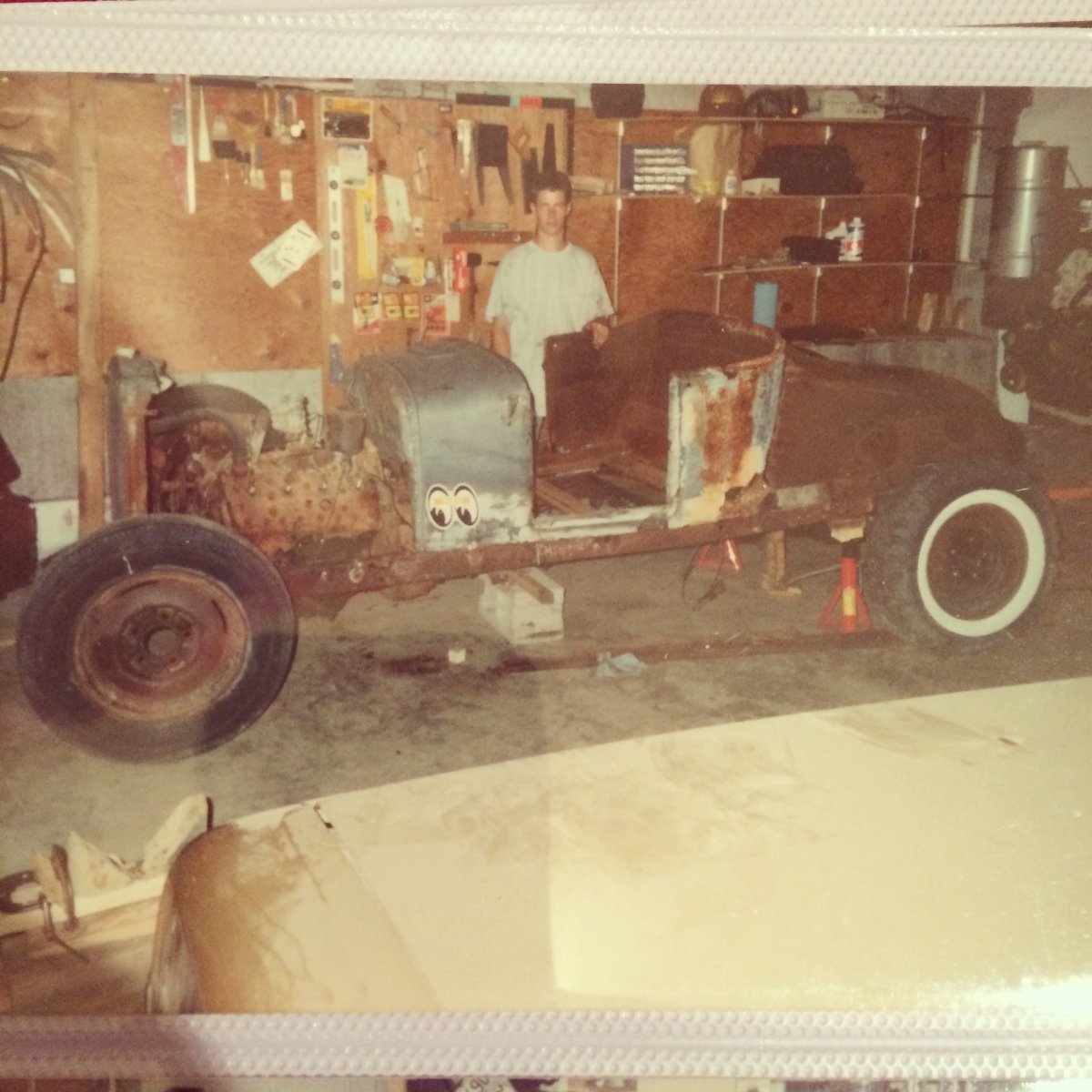

    Nice work on your T. My T was the 1st hotrod I built. Started it when I was 17.
    It's on an A frame. Would have done things differently if i had the chance. T bodies are small and I would have recessed a seat and floor pan below the body subrails. Think about it if you are tall. Built this before the Internet and digital cameras. But a do have a build picture album if there is any info needed, let me know.

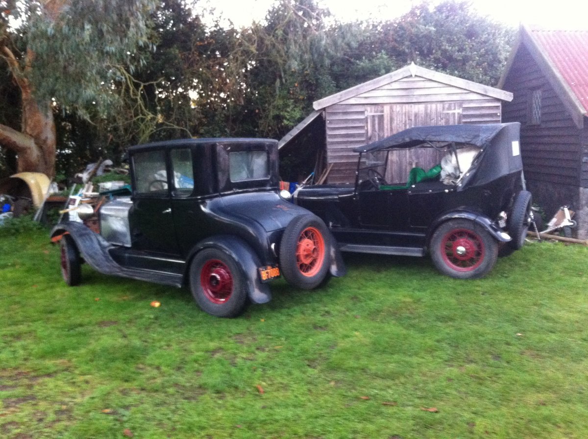

    Thought you guys might get a chuckle out of this one. Vintage 1960, 30 A chassis and power train, 27 front half of a touring, home made PU box, rear wheel are re-drilled Chevy (They had good tires). Fuel supply via a vacuumn fuel pump on the firewall.
    Never registered but lots of miles put on it driving the back roads. Cops weren't a problem, if we saw him we would cut through the fields, he wouldn't follow with his nice new Olds 88.
