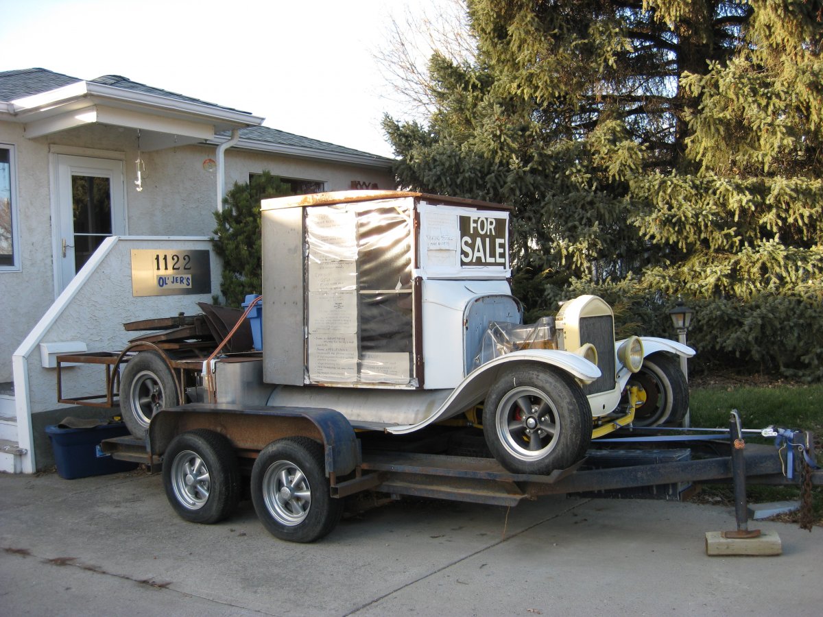

    hershey 2018 041.JPG hershey 2018 042.JPG hershey 2018 043.JPG hershey 2018 040.JPG Here's a TT full fendered truck that showed up at Hershey in 2018 for sale. Not sure the year ??

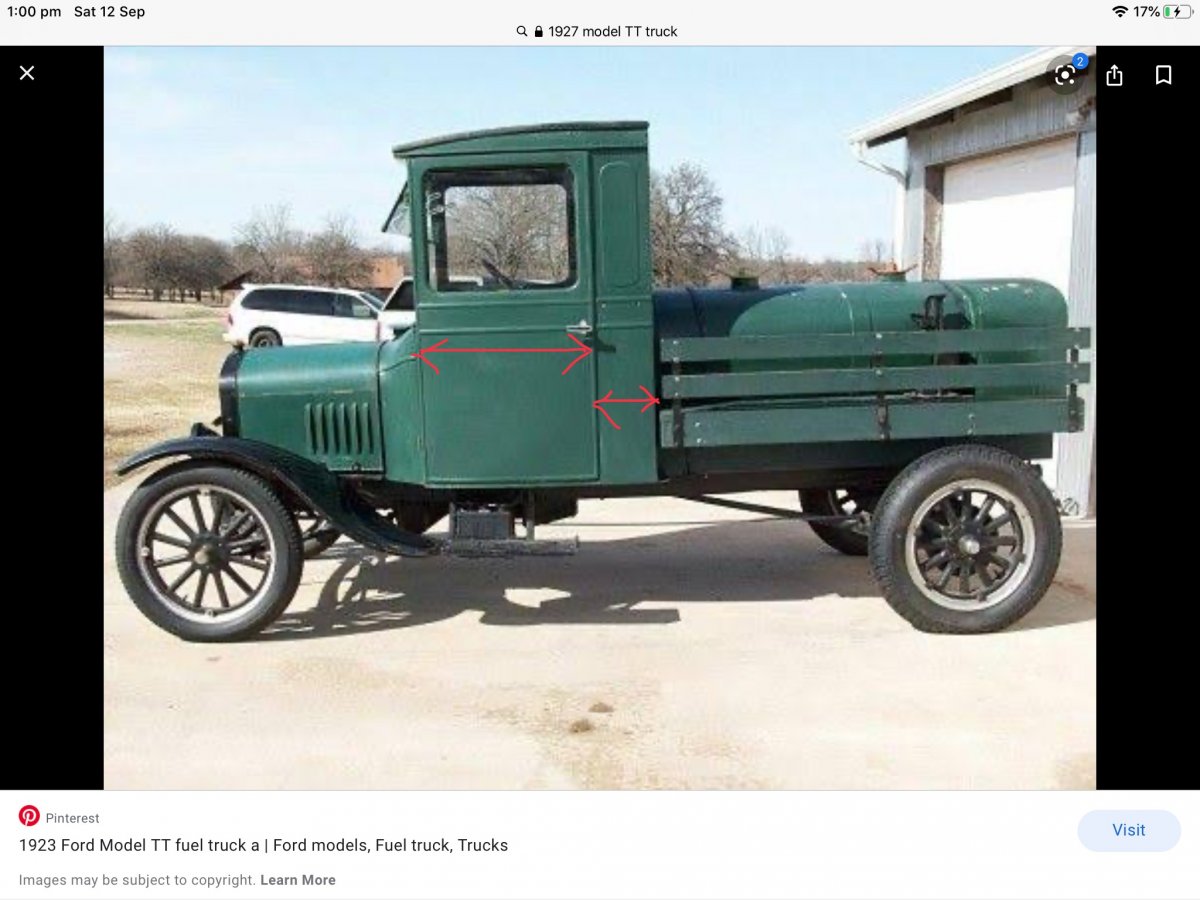

    Here are the
    That would be appreciated. These are the main ones I need. B6CE1EA1-63AD-46A8-BE35-5F480B6B485C.jpeg
    The height of the door from the bottom swage up. The height of the cab inline with the top of the door.
    sloppy jalopies likes this.
  8. chev34ute
    Joined: Nov 13, 2011
    Posts: 958
    chev34ute
    The length of the door, The length of the cab side.

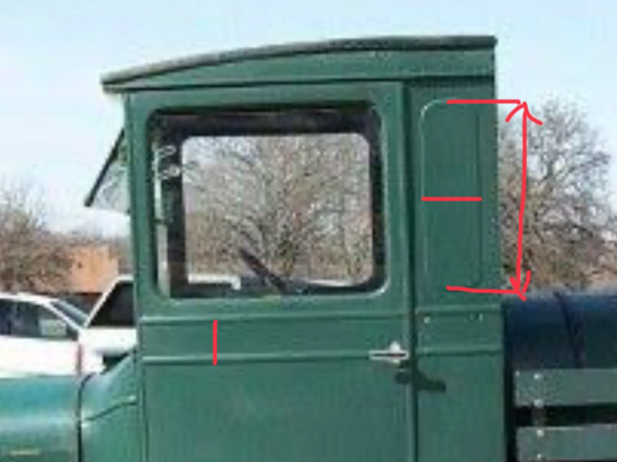

  9. chev34ute
    Posts: 958
    chev34ute
    7F17C57B-DBA7-4D30-B1E4-3D0D09B4E84D.png The spacing between the centre belt lines and the dimensions of protruding moulding on the cab side

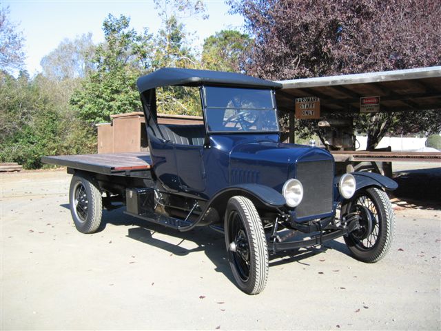

    Pete Eastwood built this TT years ago, I realize it's a roadster and not a C cab . I remember he had it for sale at the LB T swap meet. Had a little modern chevy 4 and an auto trans (I think it was an auto). Very cool truck and built in typical Eastwood fashion....perfect. Pwood32-vi.jpg

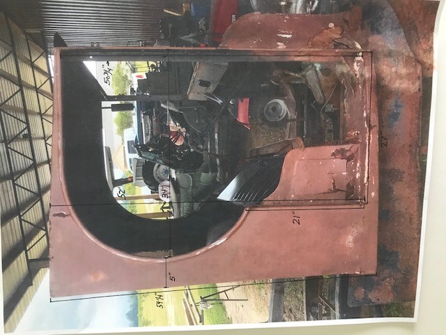

    Sorry it took so long, but here are the numbers i got:
    Height of door from top of bottom swage: 27". Height of cab inline with top door: 53". Height of door: 52".
    Space between belt line swages: 3 1/8"
    Width of swages: 15/16" - 1"
    Overall height of cab at the rear side: 57"
    Vertical swage at rear of door: 5/8" wide.
    Door lip overhangs rear side panel.
    Overall length of cab, front of door to rear of cab: 38 1/4".
    Length of door: 28 3/4".
    Length of rear cab panel (jamb to cab corner): 9 3/4"
    Window opening: 24" w x 19" h.
    Raised panel at rear side of cab: 5 3/4" x 19 1/4"
    Overall width of rear of cab: 51 1/8". IMG_20200924_120300132.jpg IMG_20200924_120103775.jpg IMG_20200924_115840196.jpg
